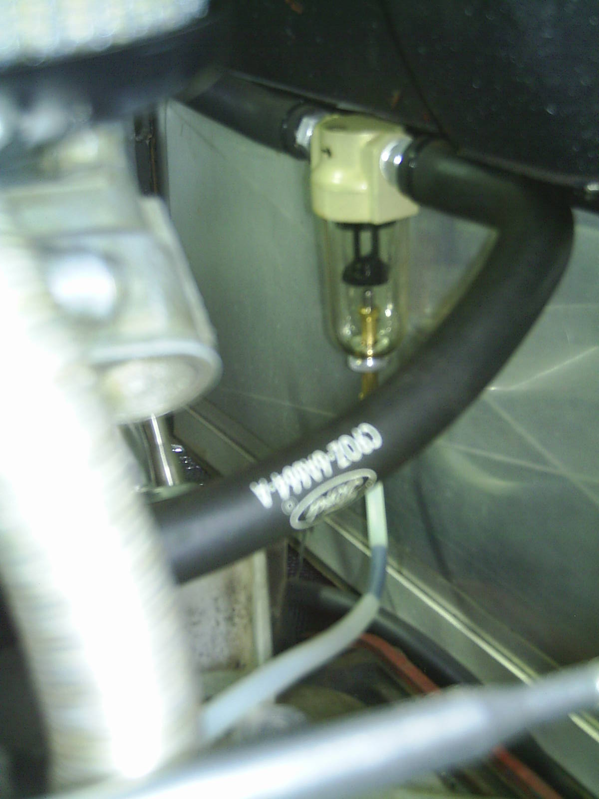

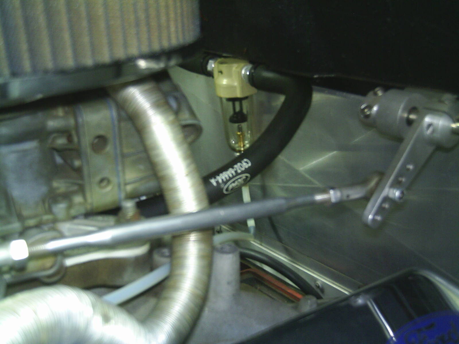

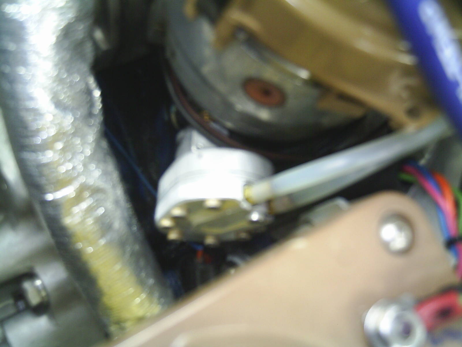

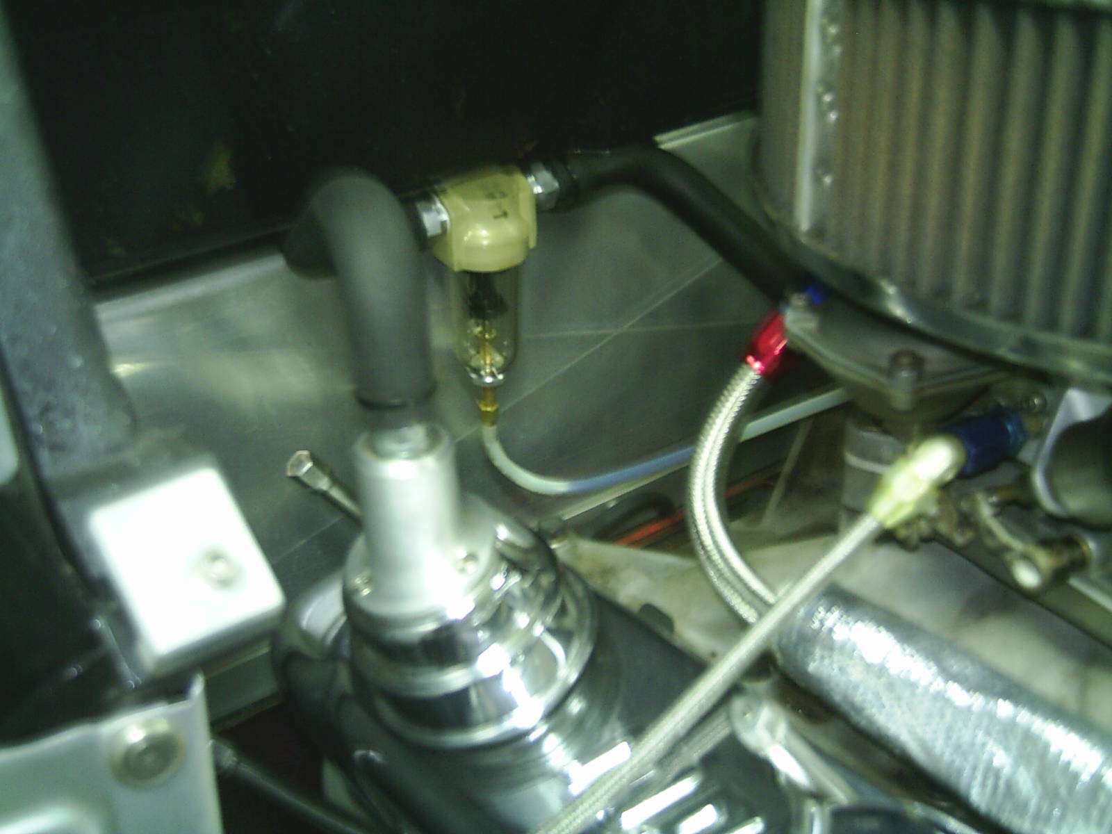

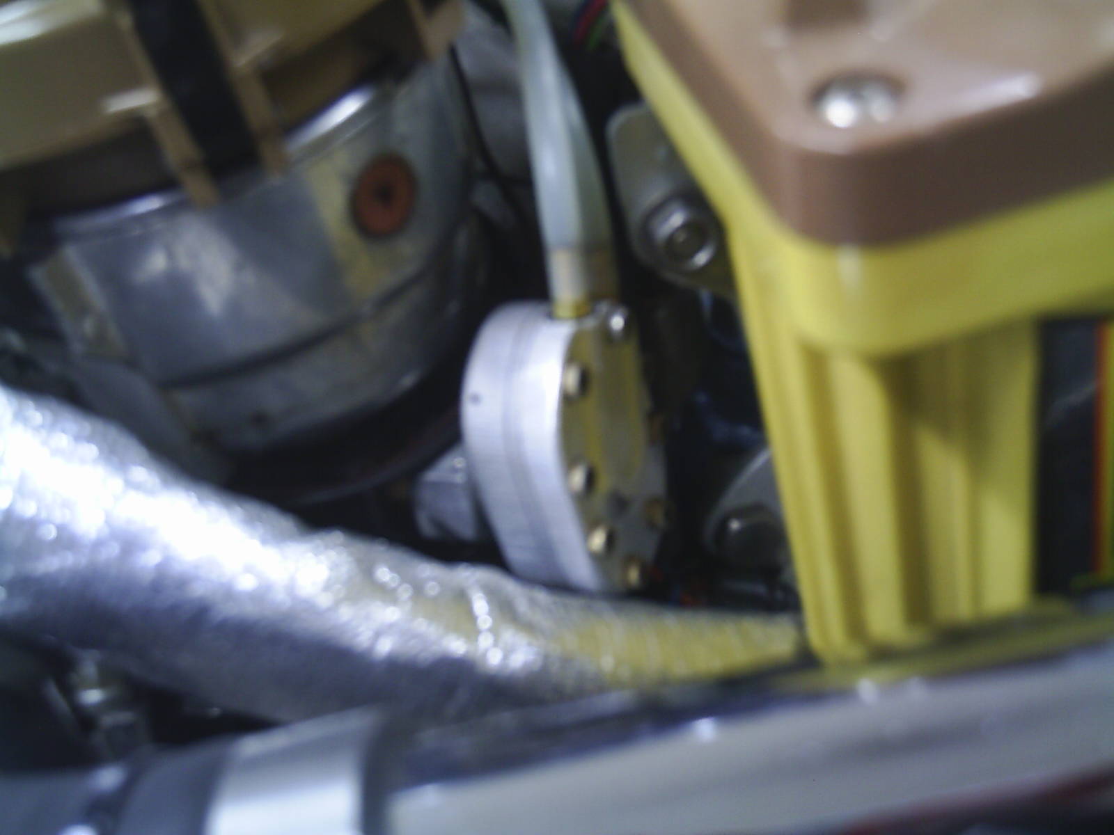

    upload_2025-9-19_17-10-23.jpeg upload_2025-9-19_17-12-50.jpeg upload_2025-9-19_17-13-30.jpeg upload_2025-9-19_17-14-4.jpeg upload_2025-9-19_17-14-52.jpeg
    My evac through Pcv.
