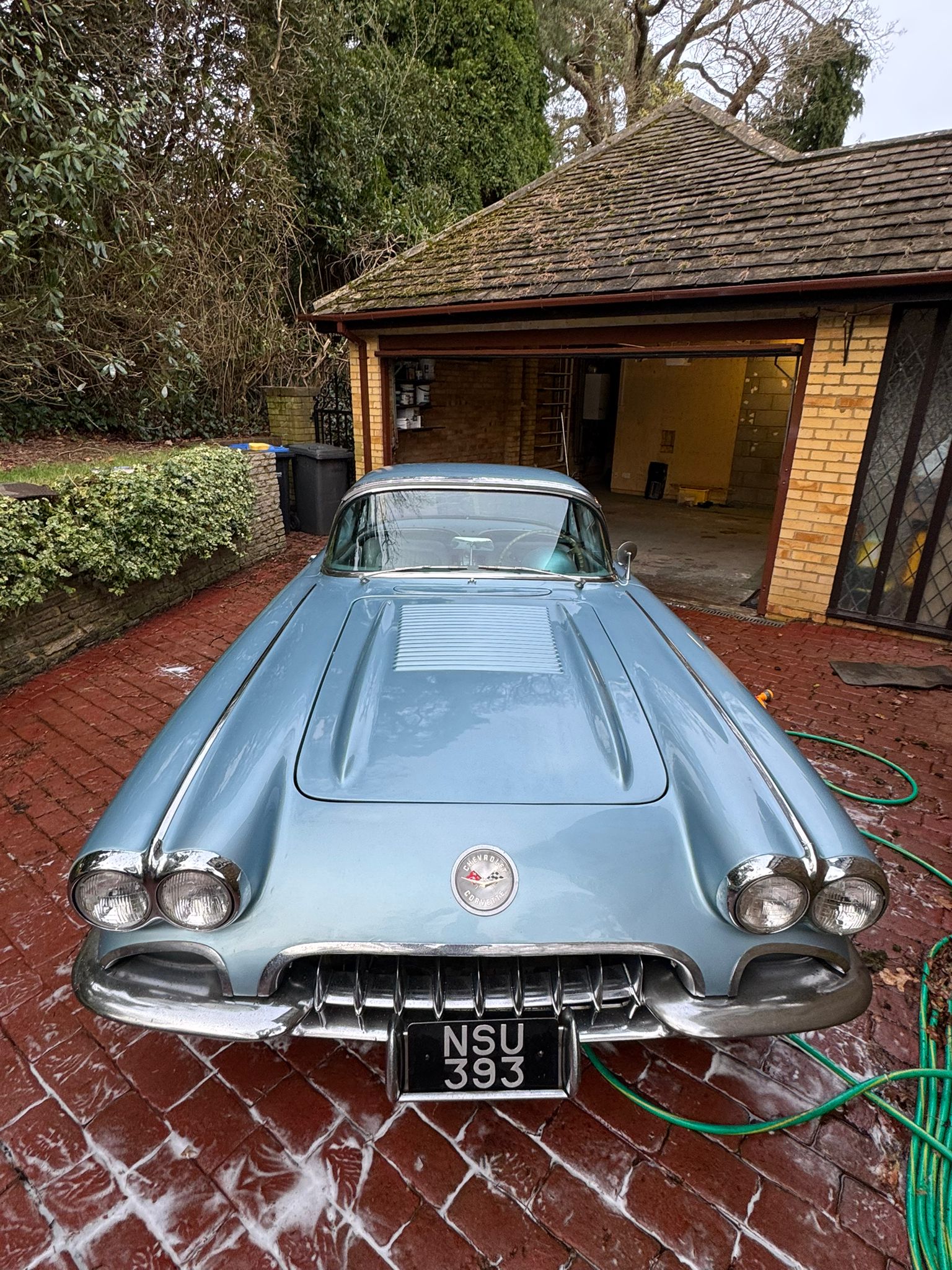

    ( https://www.jalopyjournal.com/forum/threads/58-corvette-motor-advice-please.1331751/#post-15518556 ) ... regards a pal over here in the U.K & a '58 Corvette he has inherited. Things have moved on now a little - The block p***ed pressure tests but when flex honing the bores they discovered a crack in the bottom of one of the cylinder walls which backs on to the water jacket.. He has been offered 2 options-
    "1. That cylinder can be stich welded on the outside of the cylinder and a new liner fitted.
    2. I have another 283 block here with exactly the same casting numbers.
    Option 2, engine state is unknow & may need rebore etc"
    Can I ask you guys your views on option 1 please? Thanks.
