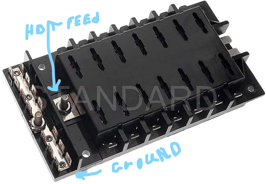

    Hey guys, question. Does anyone recognize this particular fuse box? Appears to me there is no 12v ignition only circuits on my fuse box. Screenshot_20220306-182855_Gallery.jpg I need a 12v acc ignition circuit for a sending unit on a fan relay. If not, I need advice on how to remedy this without replacing the box or adding more wires to the ignition. Thanks.

  8. 24riverview
    Joined: Jan 13, 2008
    Posts: 1,153
    24riverview
    Standard Ignition FH22 but can't find a break down of how it's divided if it even is. I'm ***uming just by looking at it that it only allows one "source".

  18. It looks like it has 1 feed post for the whole panel and the other post on top is for a ground junction block. The ones with a ground post usually are for fibergl*** products like boats.
    What I would do is take off the panel flip it over, make sure the bottom tang is also powered by the rest of the panel and cut the buss bar for the last 2 fuses (so they're separate from the rest of the panel). Drill a hole in the lower tang for a nut/bolt and run your ignition feed wire to that bolt. You'll now have 2 fused terminals that are switched.
    Here's the one I'm going to use on my '28. It's a Blue Sea 5015 For a boat, I'm going to separate some of the fuse power between switched and constant.

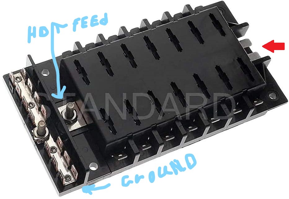

    Bottom terminal?
    The block is a 14 circuit fuse block with 7 circuits running off each side. The bar on the end is the ground connection for boats. All boat DC wiring goes back to a common ground.

  30. I think he's talking about the other end (red arrow), I bet it's connected to the stud for power on the other end of the box. Looks like whatever you put on the power stud feeds the inside terminal of the fuses on either side. Use a test light to check it.
