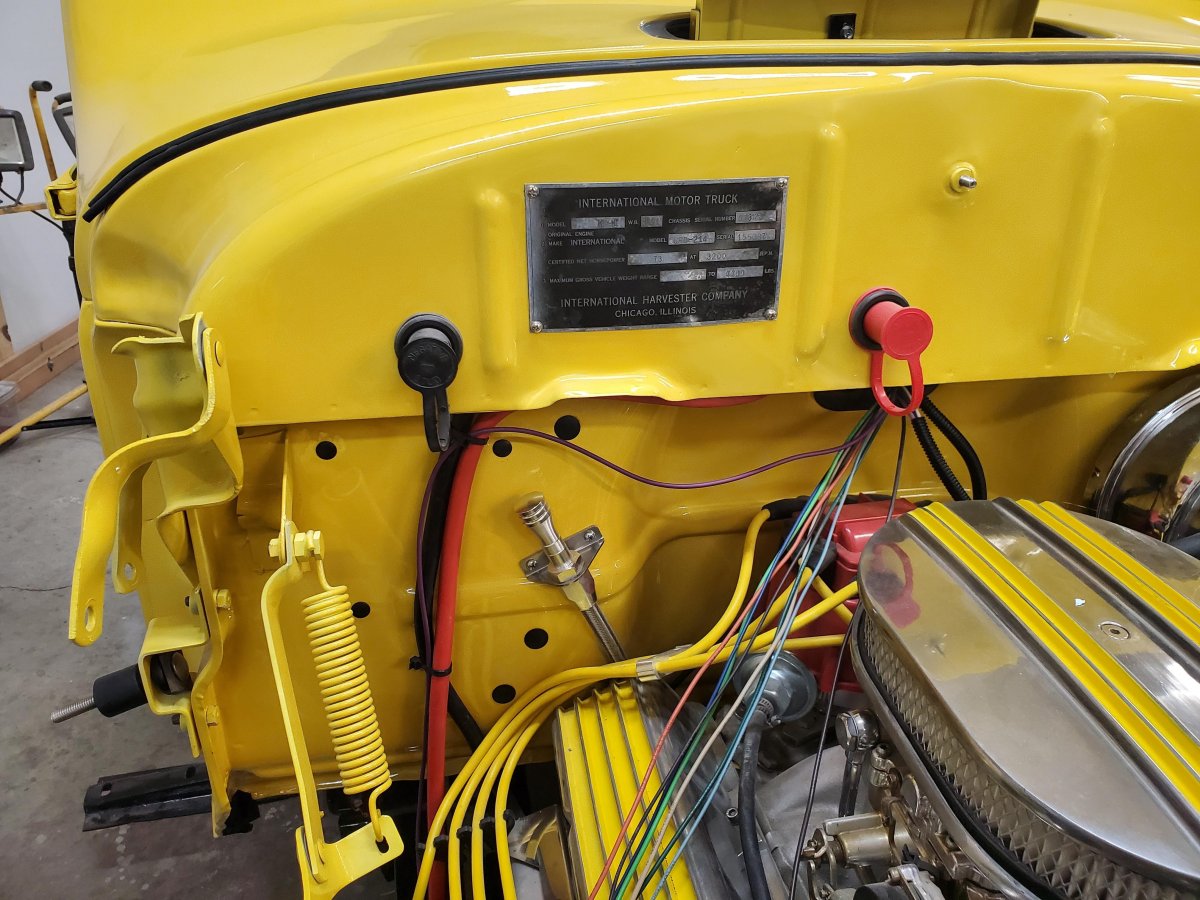

    These are the remote terminals. As you can see they're on the firewall. Where am I going with that starter wire into the fuse panel?
