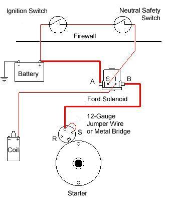

  26. Mimilan
    Joined: Jun 13, 2019
    Posts: 1,274
    Mimilan
    Generally the main H/D cable from the battery to the starter is not fused.
    On your schematic a fusible link would be on the yellow wire from the starter relay [solenoid]
    On touring cars [road racing] it is normal to put the battery in the trunk. So for safety they put a Ford solenoid [starter relay] right next to the battery and then bridge the other solenoid on the starter motor.
    The yellow wire power feed and starter switch wire [on your schematic] will go off the Ford Solenoid.
    This method keeps the H/D cables dead [after the Ford Solenoid] except when the starter switch is activated.
    If you want to put in a battery disconnect! All you need is an inline switch on the same yellow wire.
    Attached is a schematic of the Ford solenoid in a GM car. [for safety you want Battery to"A" to be short as possible]
    The main fused power feed [yellow] would come off "A"
    If you think about it...........Your schematic with a "starter relay" is already like this! Just mount the relay close to the battery.
    And if you use a solenoid type starter it needs to be bridged
    rod1 likes this.
  27. cederholm
    Joined: May 6, 2006
    Posts: 1,761
    cederholm
    Mimilan, thank you for taking the time to review my schematic, I appreciate it! And I appreciate your write-up below. I've been updating my diagram to include fuses (or circuit breakers) and relays. I will post when complete - I hope you can look it over with a critical eye.
    One question, on you diagram below, is the (I) post capable of handling the load of the rest of the car?
    Thanks,
    Carl
