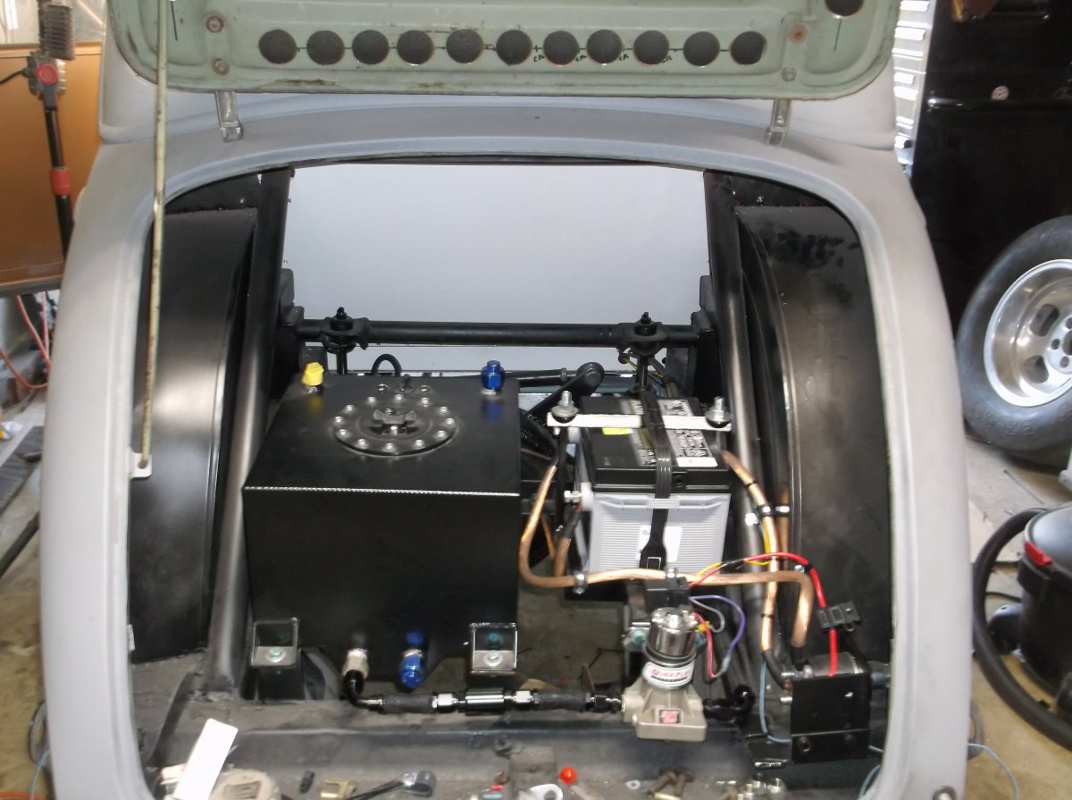

    southcross2631
    Here's a small fuse panel you can use for your car. I used an in line fuse on my electric fuel pump and a 30 amp breaker. I would use breakers for your head lights.
    You can install a hidden Maxi fuse to protect the whole system and it makes a good anti theft device.
    Most car thieve DSCF3494.JPG DSCF3492.JPG s don't carry a Maxi fuse in their pocket.

    Okay, so I've updated my schematic (attached and headlight switch arrived in the mail. Slightly A generic vintage-style unit with attached circuit breaker which is clearly meant to handle most of the lighting circuits, and in my case all the un-switched circuits.
    Couple of notes about my schematic;
    • I'm using a vintage starter ****on that is designed to work as a grounding switch - hence to Bosh style relay in that circuit.
    • I am using a relay for all the switched circuits - even though my load is small, I don't feel good running everything though a 90 year old switch
    • the lines running off the bottom of the page are going to the gauge pod - I have a simple schematic for that.
    One question, on my schematic, were is the best place to wire in my ampmeter? just downstream of the fusible ling?
