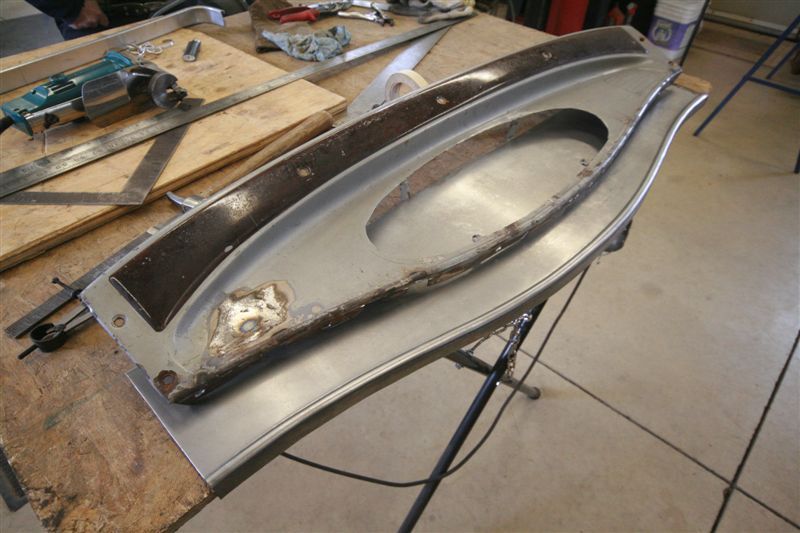

  4. Hey Guys, had a neat job lately to repair a deuce dash and build an instrument panel.....
    Dash has been "hogged out' and some poor repairs...
    First thing was to fab up a new lower section roughly 1" lower than stock...
    trim and fit...

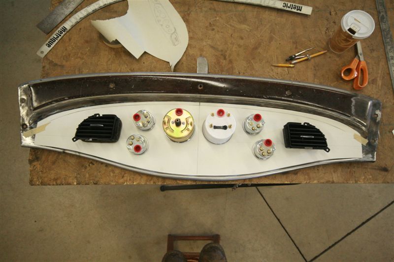

    Now we have a dash to design a panel and lay out gauges...
    Come up with a pleasing shape and have a look in the car
    Now the tedious task of engine turning lay-out...
    A "couple" of hours later...
    On the dash...
    Time for the details...
    Some really cool heat/air ducts...
    Bore the holes in the dash for instruments...
    Holes in the panel and figure out controls and switches...
    So far...

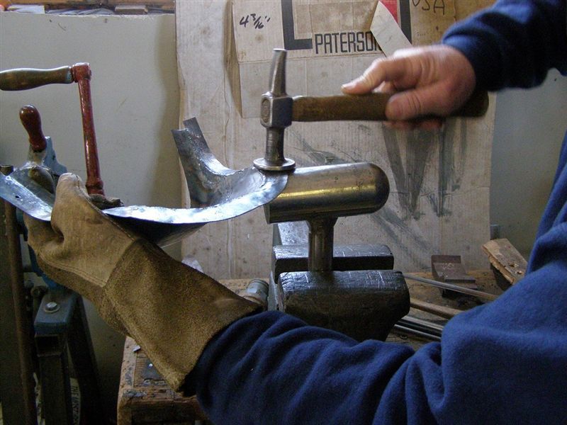

  5. What number tip did you use to do those long runs?
    I like my Dillon (it did take some getting used to) but was always leery of that long of a run.
    Or, did you make a half dozen or so linked beads? Did you dolly as you went?
    Regardless, NICE WORK!!
  6. Thanks Hot Rod A
    I use the number one tip for 18ga and thinner sheet stock.
    Forge welding (hammer-welding) requires that you planish or stretch out the weld as you go...you always want to be in control. You can weld seams of any length...usually the damn weight gets so hot you have to take a break and cool it off anyway... [​IMG]

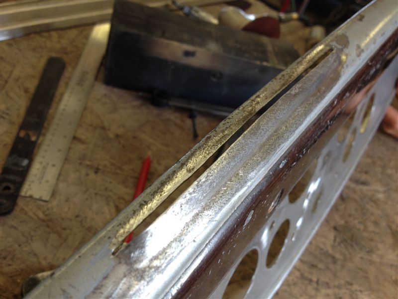

  7. Adding defrost vents to the top of the dash...
    <a href="http://s1105.photobucket.com/user/hammerweight/media/IMG_0339.jpg.html" target="_blank">[​IMG]</a>
    A little metal finish and polish and...
    <a href="http://s1105.photobucket.com/user/hammerweight/media/IMG_0537.jpg.html" target="_blank">[​IMG]</a>
    <a href="http://s1105.photobucket.com/user/hammerweight/media/IMG_0541.jpg.html" target="_blank">[​IMG]</a>
    <a href="http://s1105.photobucket.com/user/hammerweight/media/IMG_0545.jpg.html" target="_blank">[​IMG]</a>

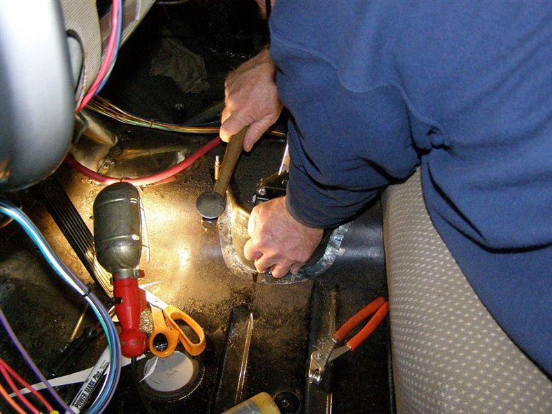

  12. 51 Ford in the shop for a little work, auto floor shift needs a bezel or hump...
    <a href="http://s1105.photobucket.com/user/hammerweight/media/51%20ford/IMG_0818.jpg.html" target="_blank">[​IMG]</a>
    Away we go with a start under way...
    <a href="http://s1105.photobucket.com/user/hammerweight/media/51%20ford/P3070005.jpg.html" target="_blank">[​IMG]</a>
    <a href="http://s1105.photobucket.com/user/hammerweight/media/51%20ford/P3070007.jpg.html" target="_blank">[​IMG]</a>
    <a href="http://s1105.photobucket.com/user/hammerweight/media/51%20ford/P3070008.jpg.html" target="_blank">[​IMG]</a>
    <a href="http://s1105.photobucket.com/user/hammerweight/media/51%20ford/P3070009.jpg.html" target="_blank">[​IMG]</a>
    heatin' and stretchen to install a flange...
    <a href="http://s1105.photobucket.com/user/hammerweight/media/51%20ford/P3070010.jpg.html" target="_blank">[​IMG]</a>
    <a href="http://s1105.photobucket.com/user/hammerweight/media/51%20ford/P3070011.jpg.html" target="_blank">[​IMG]</a>
    Tacking and more fitting...
    <a href="http://s1105.photobucket.com/user/hammerweight/media/51%20ford/P3070013.jpg.html" target="_blank">[​IMG]</a>
    <a href="http://s1105.photobucket.com/user/hammerweight/media/51%20ford/P3070015.jpg.html" target="_blank">[​IMG]</a>
    <a href="http://s1105.photobucket.com/user/hammerweight/media/51%20ford/P3070016.jpg.html" target="_blank">[​IMG]</a>
    weld...smooth..
    <a href="http://s1105.photobucket.com/user/hammerweight/media/51%20ford/P3070017.jpg.html" target="_blank">[​IMG]</a>
    <a href="http://s1105.photobucket.com/user/hammerweight/media/51%20ford/P3070018.jpg.html" target="_blank">[​IMG]</a>
    more later...

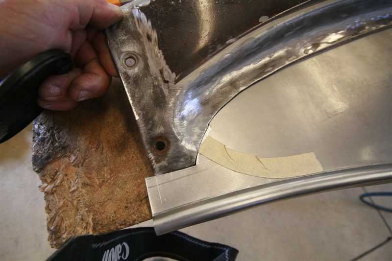

  13. On we go...
    <a href="http://s1105.photobucket.com/user/hammerweight/media/51%20ford/P3070019.jpg.html" target="_blank">[​IMG]</a>
    Continuing to check for fit....
    <a href="http://s1105.photobucket.com/user/hammerweight/media/51%20ford/P3070020.jpg.html" target="_blank">[​IMG]</a>
    Getting some cleco's in...
    <a href="http://s1105.photobucket.com/user/hammerweight/media/51%20ford/P3070023.jpg.html" target="_blank">[​IMG]</a>
    Pattern for the top section....
    <a href="http://s1105.photobucket.com/user/hammerweight/media/51%20ford/P3070025.jpg.html" target="_blank">[​IMG]</a>
    In steel...
    <a href="http://s1105.photobucket.com/user/hammerweight/media/51%20ford/P3070028.jpg.html" target="_blank">[​IMG]</a>
    Tack it on...
    <a href="http://s1105.photobucket.com/user/hammerweight/media/51%20ford/P3070029.jpg.html" target="_blank">[​IMG]</a>
    weld it up...
    <a href="http://s1105.photobucket.com/user/hammerweight/media/51%20ford/P3070034.jpg.html" target="_blank">[​IMG]</a>
    A joggle to add detail and stiffen...
    <a href="http://s1105.photobucket.com/user/hammerweight/media/51%20ford/P3070037.jpg.html" target="_blank">[​IMG]</a>
    <a href="http://s1105.photobucket.com/user/hammerweight/media/51%20ford/P3070039.jpg.html" target="_blank">[​IMG]</a>
    Together....
    <a href="http://s1105.photobucket.com/user/hammerweight/media/51%20ford/P3070042.jpg.html" target="_blank">[​IMG]</a>
    cleaned up and in...
    <a href="http://s1105.photobucket.com/user/hammerweight/media/51%20ford/P3070049.jpg.html" target="_blank">[​IMG]</a>
    <a href="http://s1105.photobucket.com/user/hammerweight/media/51%20ford/P3070050.jpg.html" target="_blank">[​IMG]</a>

    Did you fab the dash insert border with a bead roller?
    Ago

  18. Yes the moulding was done on a bead roller.
