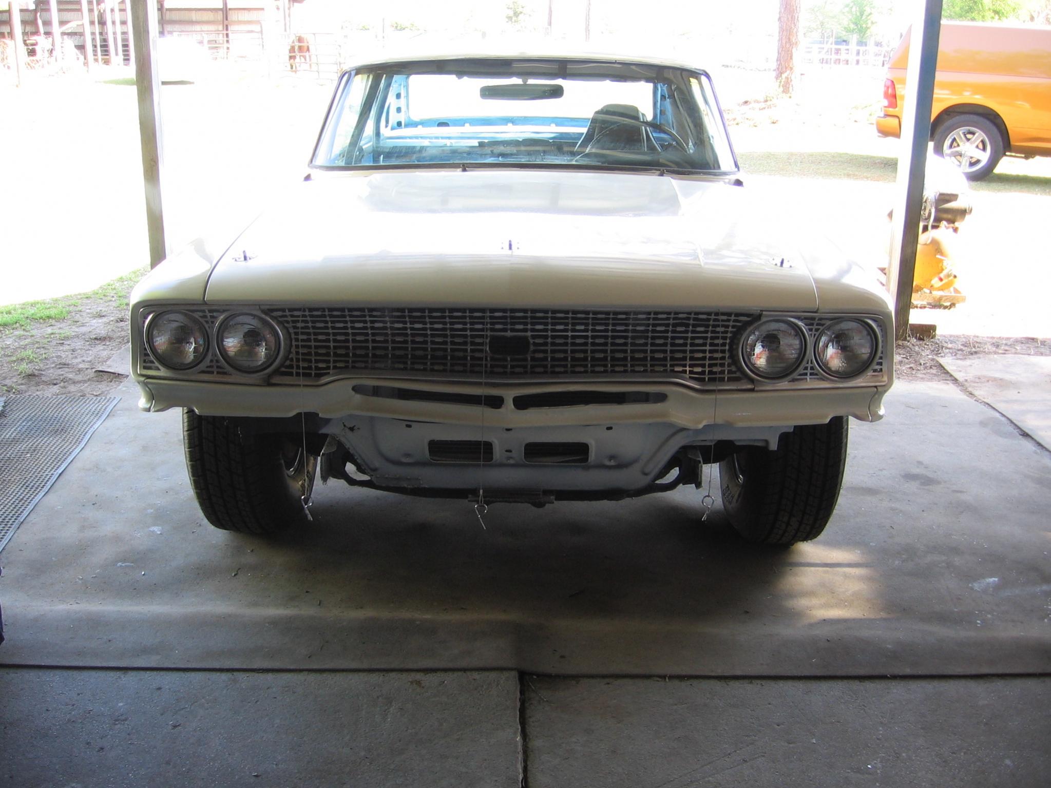

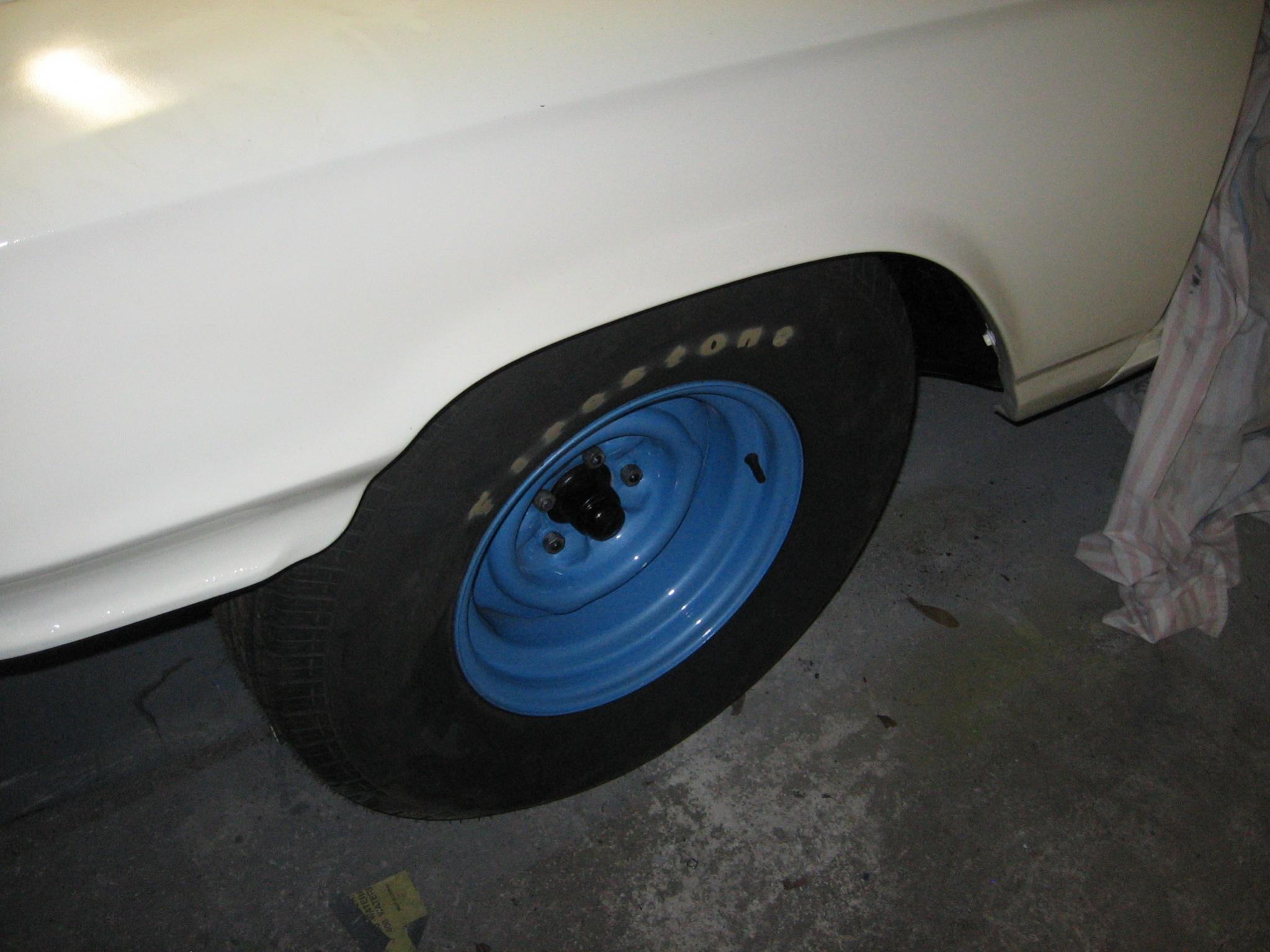

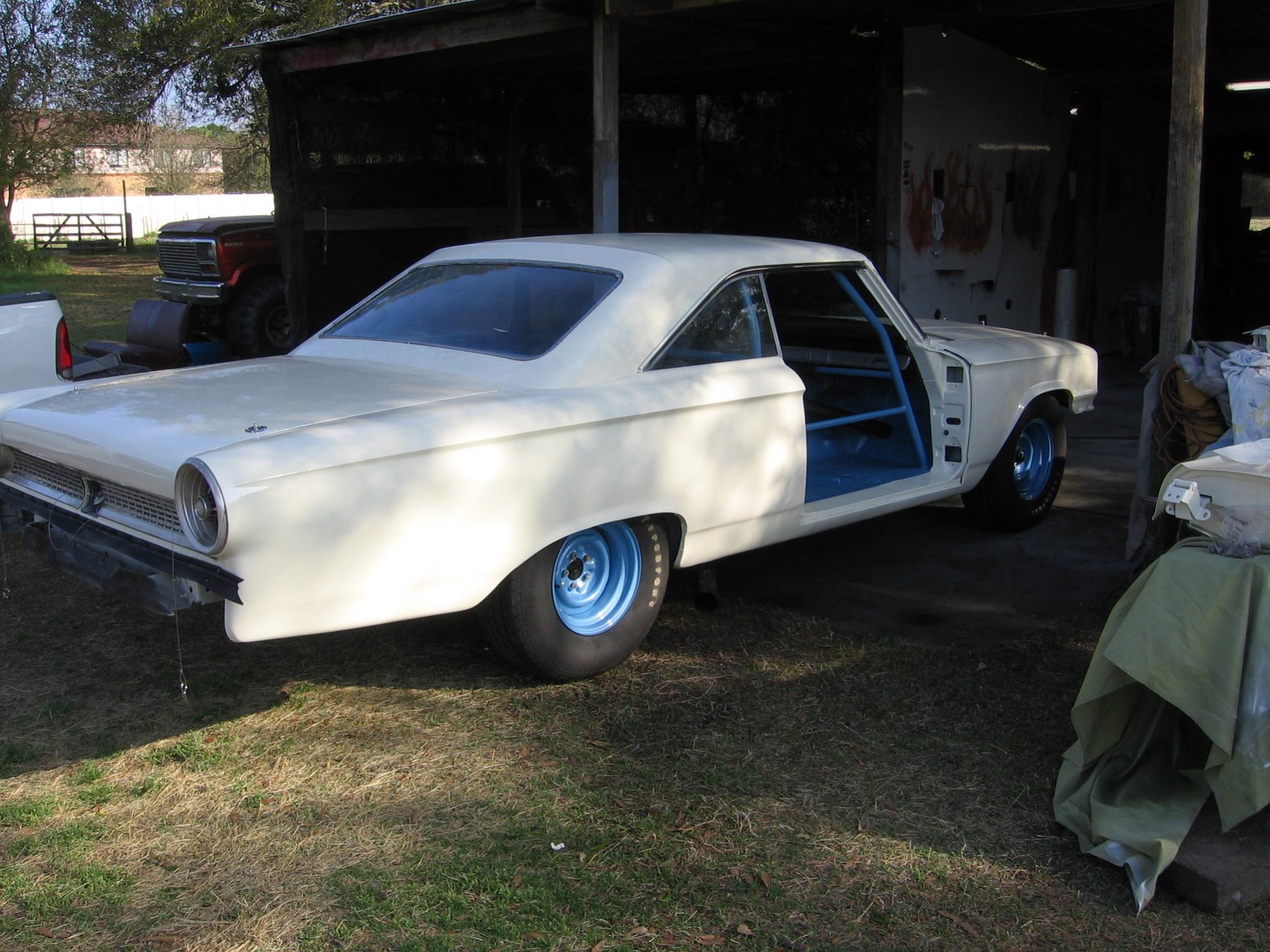

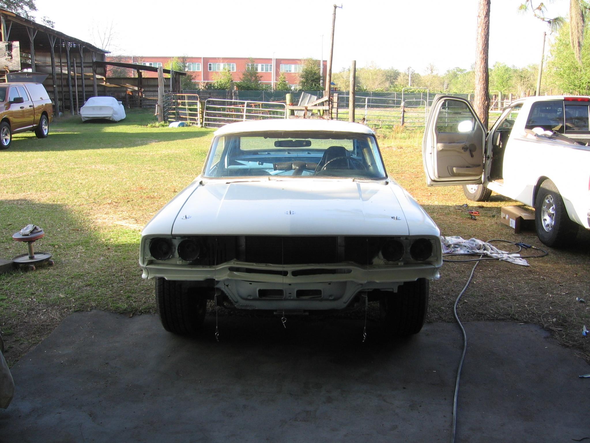

    Well some new images from Wednesday nights activity so I could not help my self and I had to install the wheel & tires on the car hoping the rear wheels and tire size would clear.
    After removing the rear shocks (shot got new ones on order) I lowered the axle (frame was on jack stands), but even with that the tire height would not tuck in the fender /or clear the drum so what do you do to fix this pull out the valve stem let the tire air bleed out and they tucked right in. Added the 35PSI and bolted up the factory lugs.
    The are about 1/2" clearance on the inside from the leaf springs and about a 1/2" from the front wheel wel lower corner but height and width to the inner fender and wheel lip are great.
    The fronts where fine so now she has new shoes:).
    Still have some black spray paint cover up over spray on the frame and other areas then on to hooking up the taillights, cleaning up the bumper brackets and installing the bumpers then the doors, grille, tail section trim.
    Got to pull the headlight switch the factory one is not working no parking lights, no dash ligths, turn signals on the dash on all the time. 20 dollar part be in next week.
    I will roll it out this weekend if it dont rain for some more pictures.

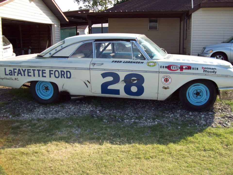

    Fordy Acres I was going to build my 65 Galaxie into a Fred Lorenzen model but the funds to convert it to a four speed and parts were not in the budget.
    I traded her a few years back but the 65 model was my first choice.
    Got lucky with mine it had the right motor and factory four speed and manual brakes and steering. The body and interior was rough but I still paid $$$ for the car due to drive train.

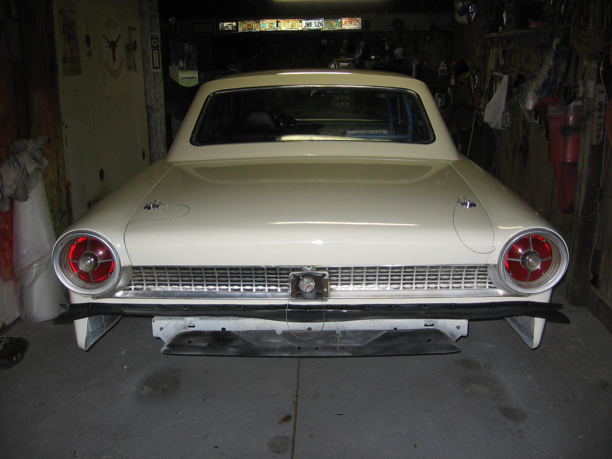

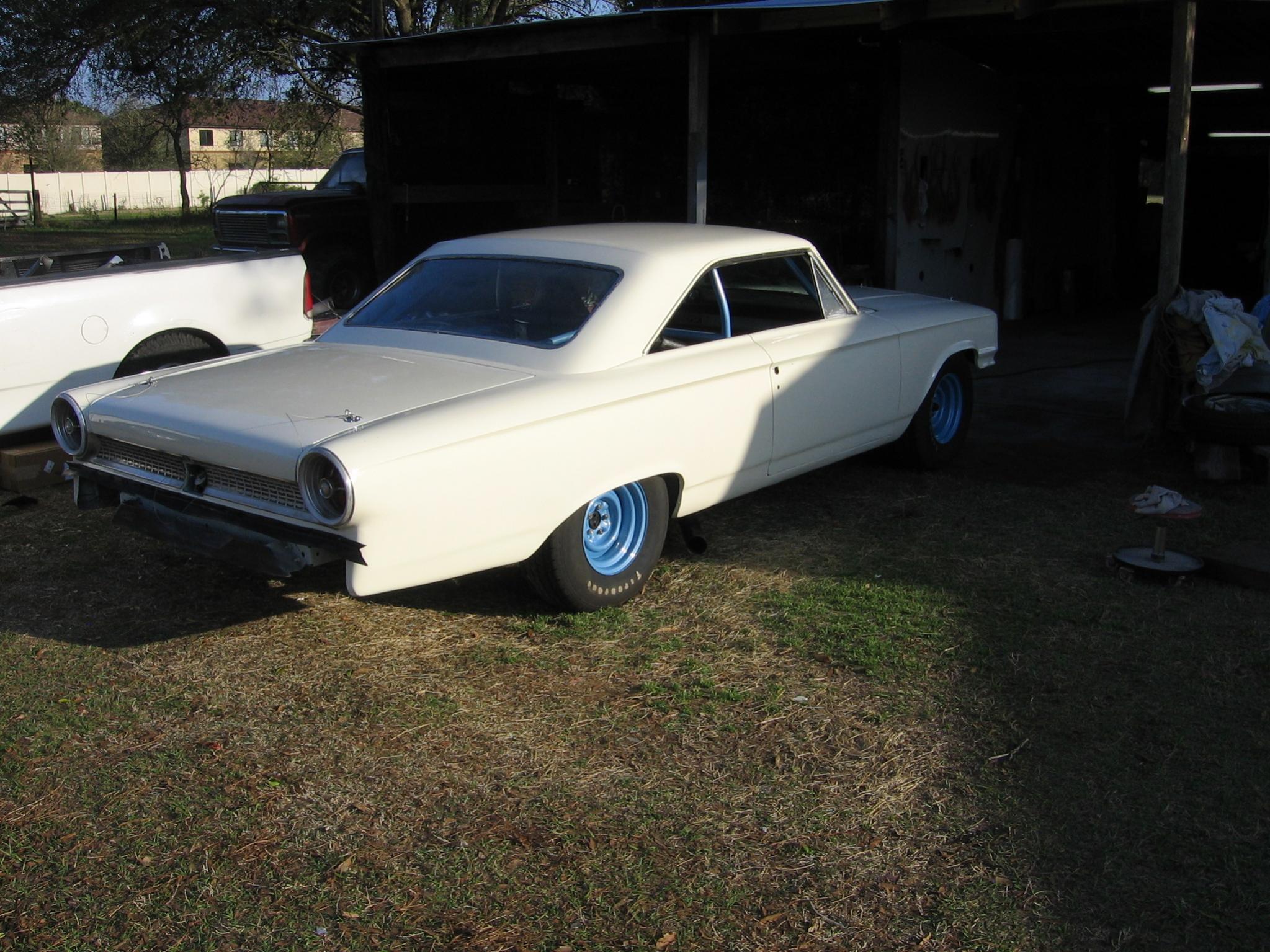

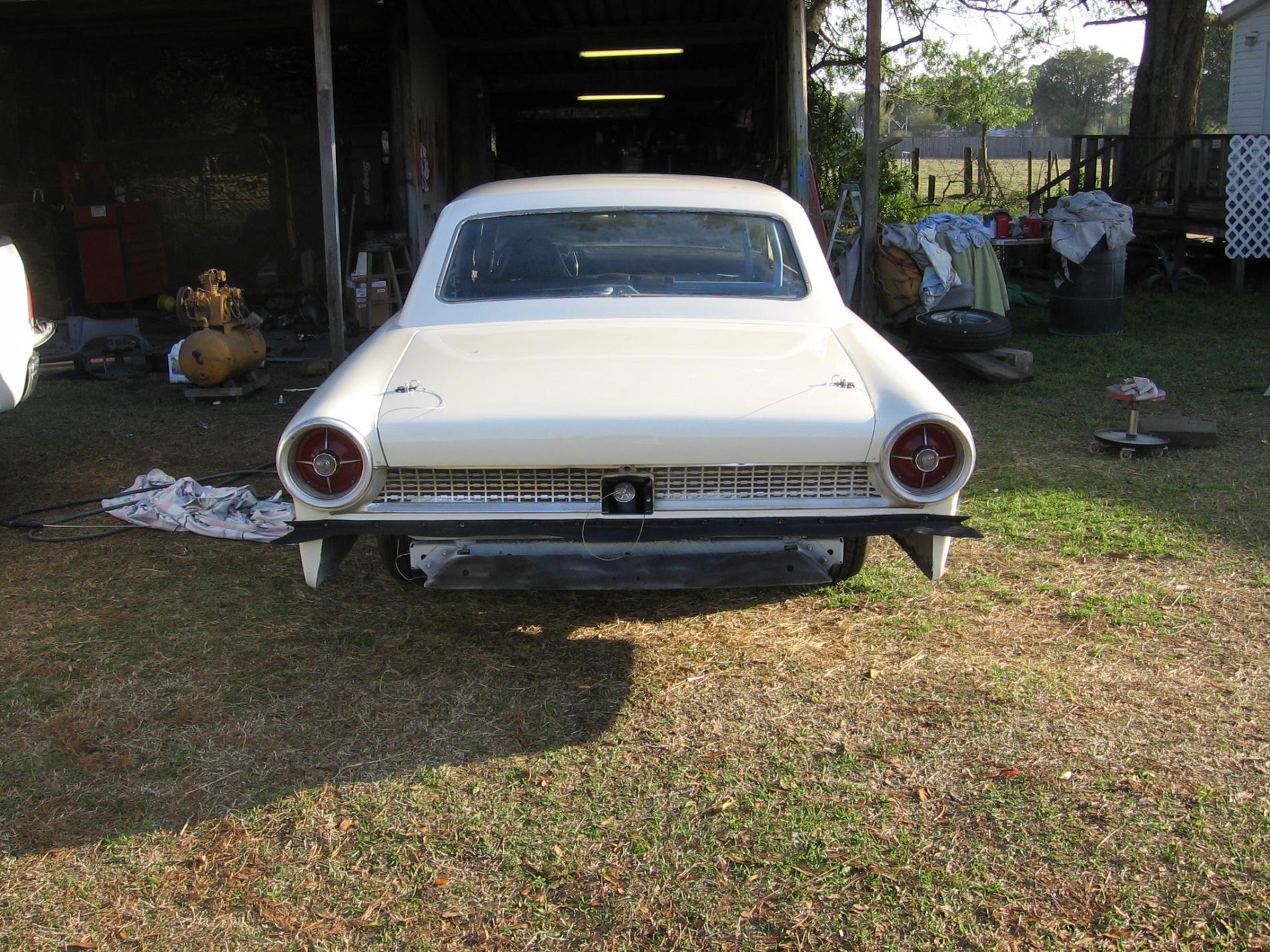

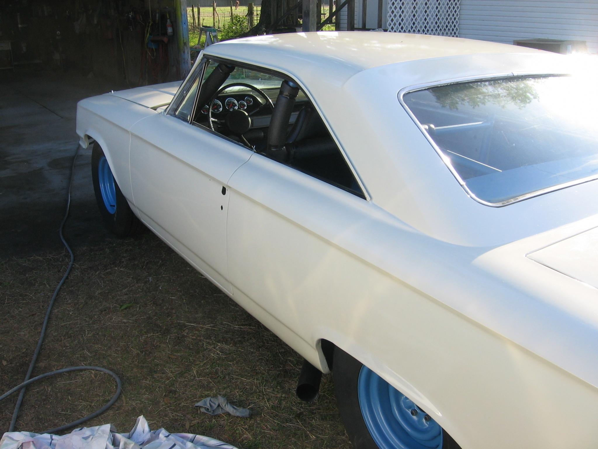

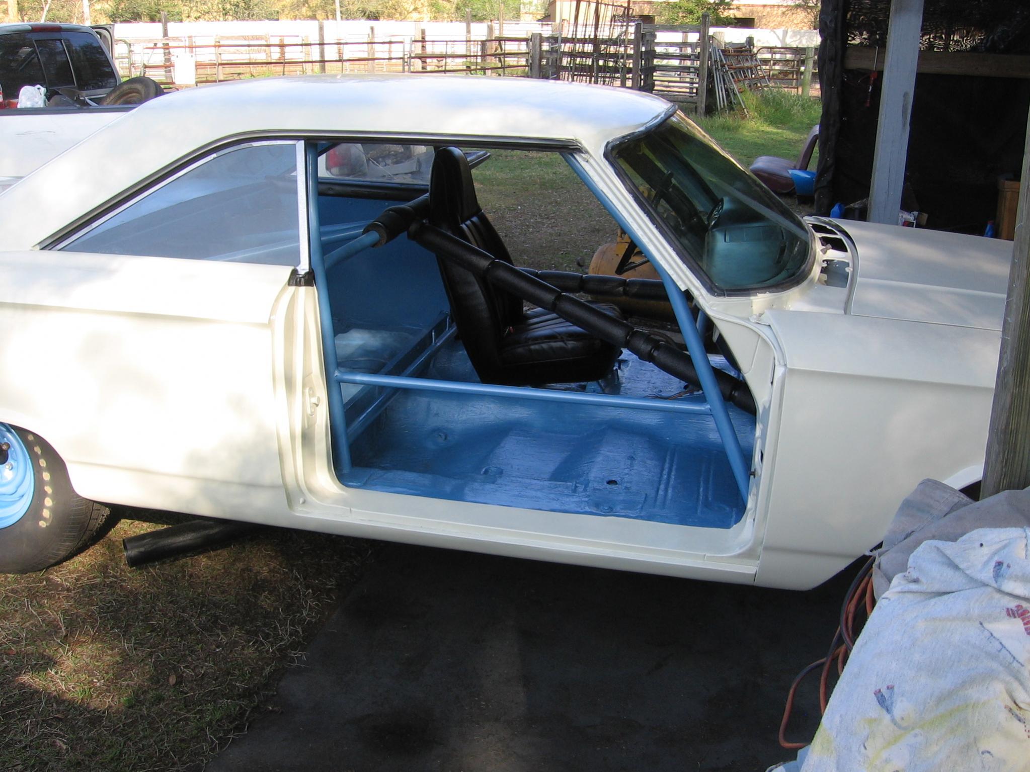

    Busy weekend, got a lot of little stuff done Saturday including cleaning up the shop.
    Lets see got the trunk rear trim installed, taillights wired up and installed with trim covers. Measured and cut out aluminum panels for the trunk for the trunk pins. Of course measure three time then drilled the holes in the trunk for the pins and chrome covers, then mounted the cables and locking pins so they are part of the car and do not get lost.
    Drille and pop riveted one of the hood pin cables to the gas cap looks cool. Got the wiper moving arms into the cowl area but lost the center nut and clip for the arms so I could not install the wiper cowl.
    Added the rear stone guard rubber so I can get ready to mount the bumper.
    Did some more wiring and loom wrap for the horns and new sending units for the gauges.

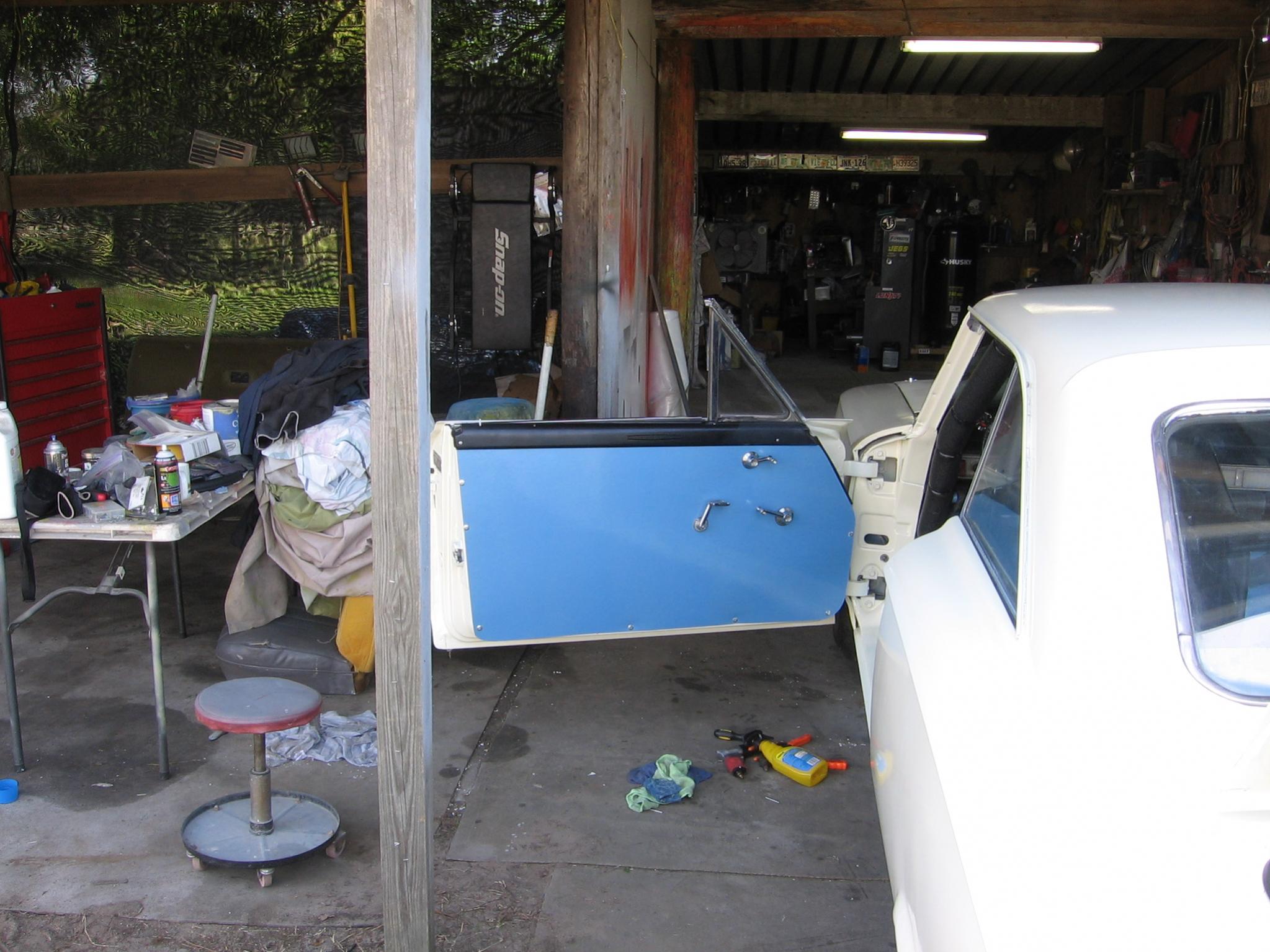

    Today some more misc. stuff then my buddy showed up so we could install the doors.
    Then started cleaning the overspray on the gl*** pretty much done for today I am beat. But I got her out in the sun so you can see the wheels and tires.
    Hope you enjoy the build so far:)

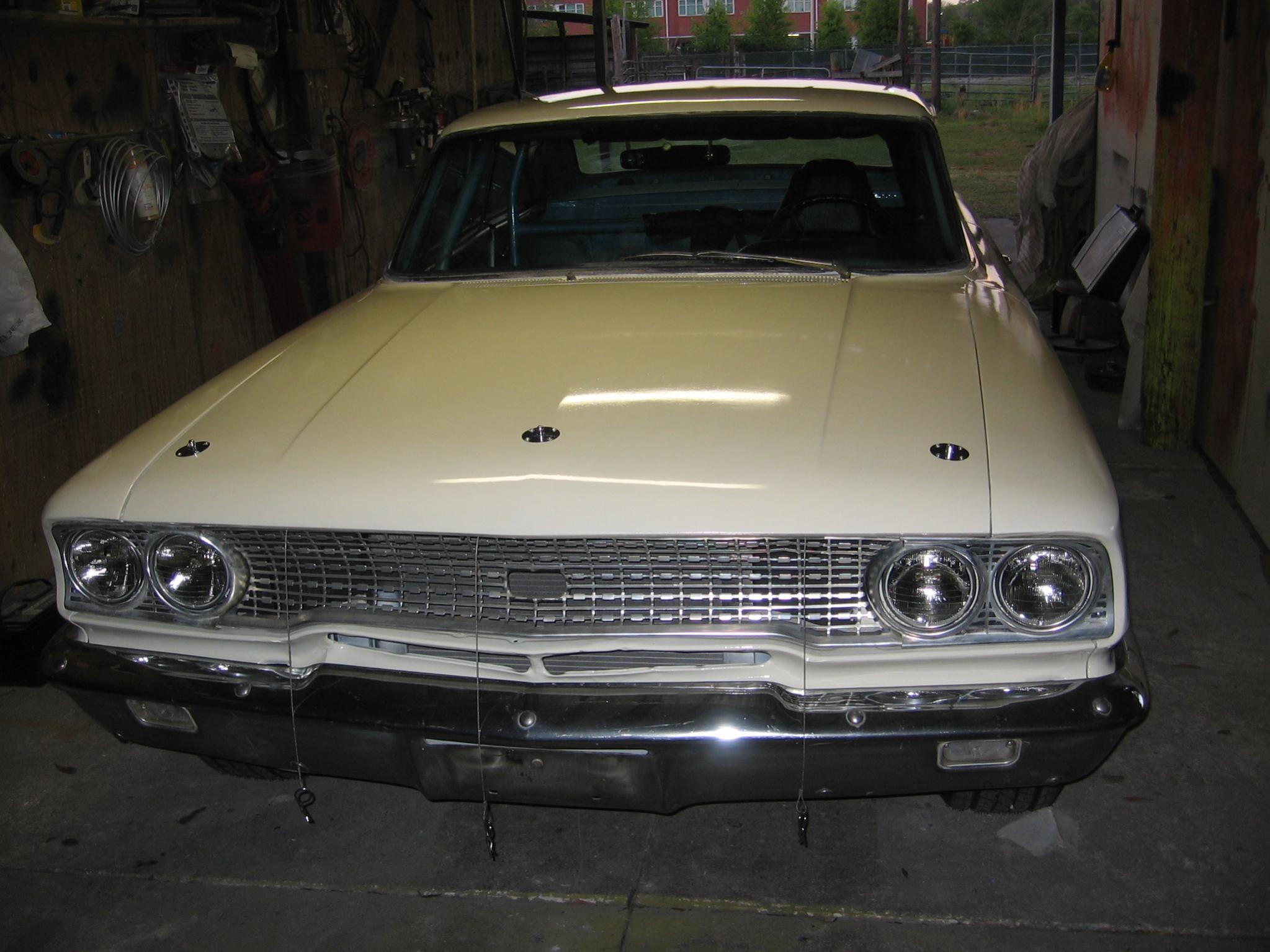

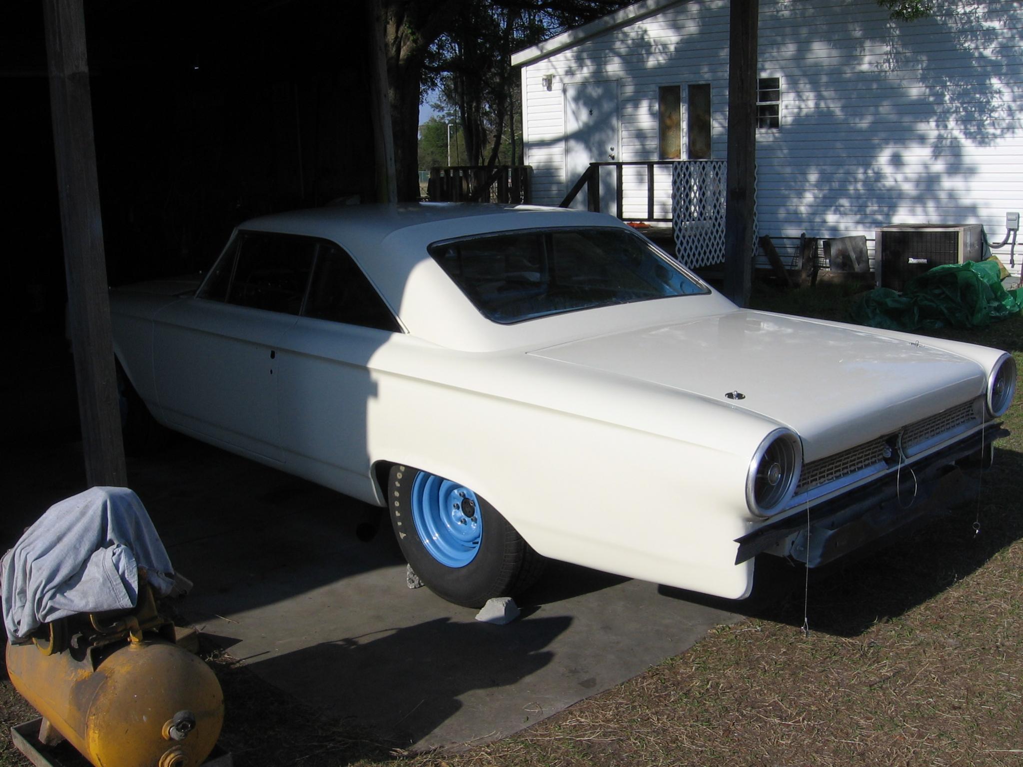

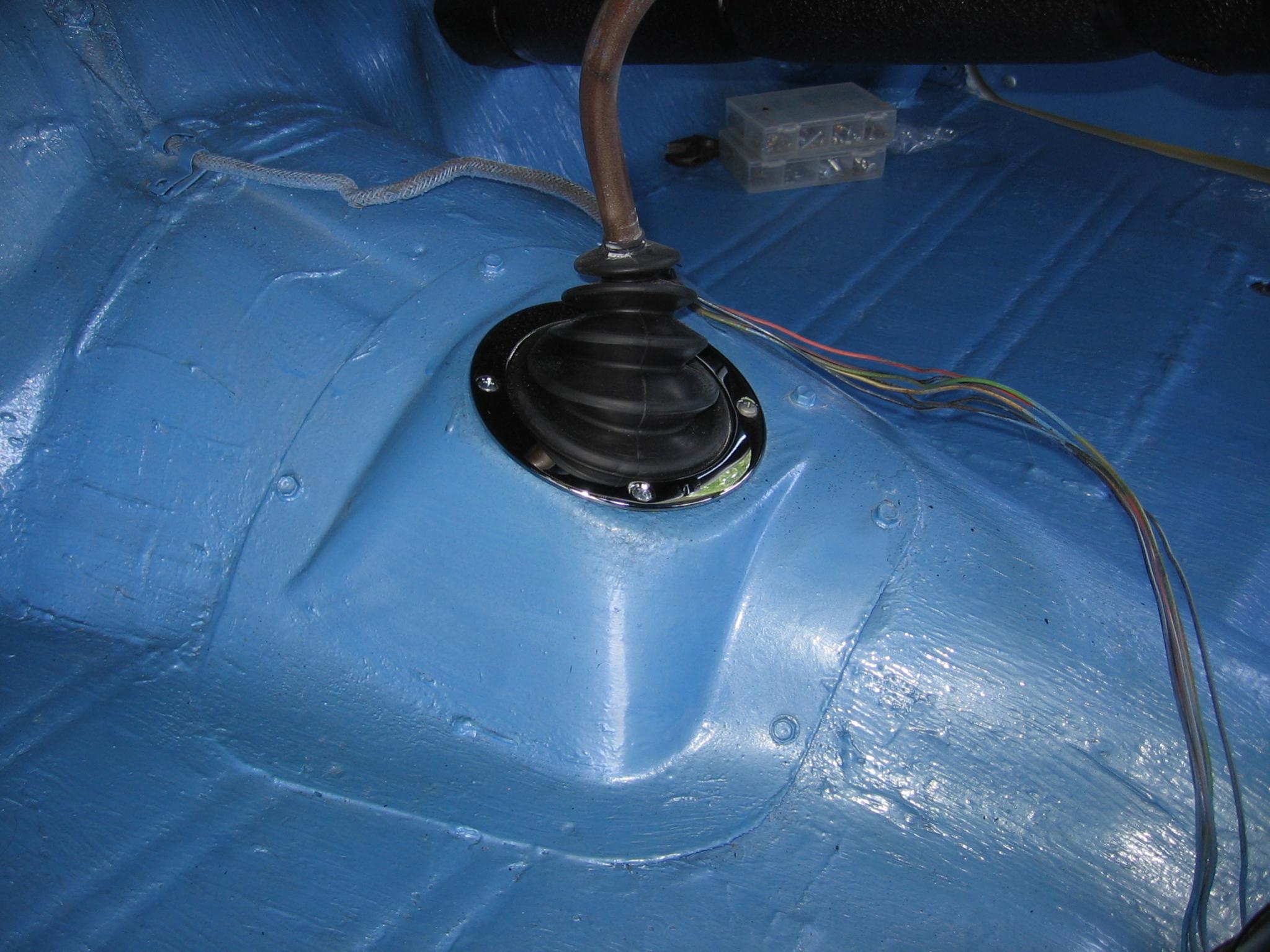

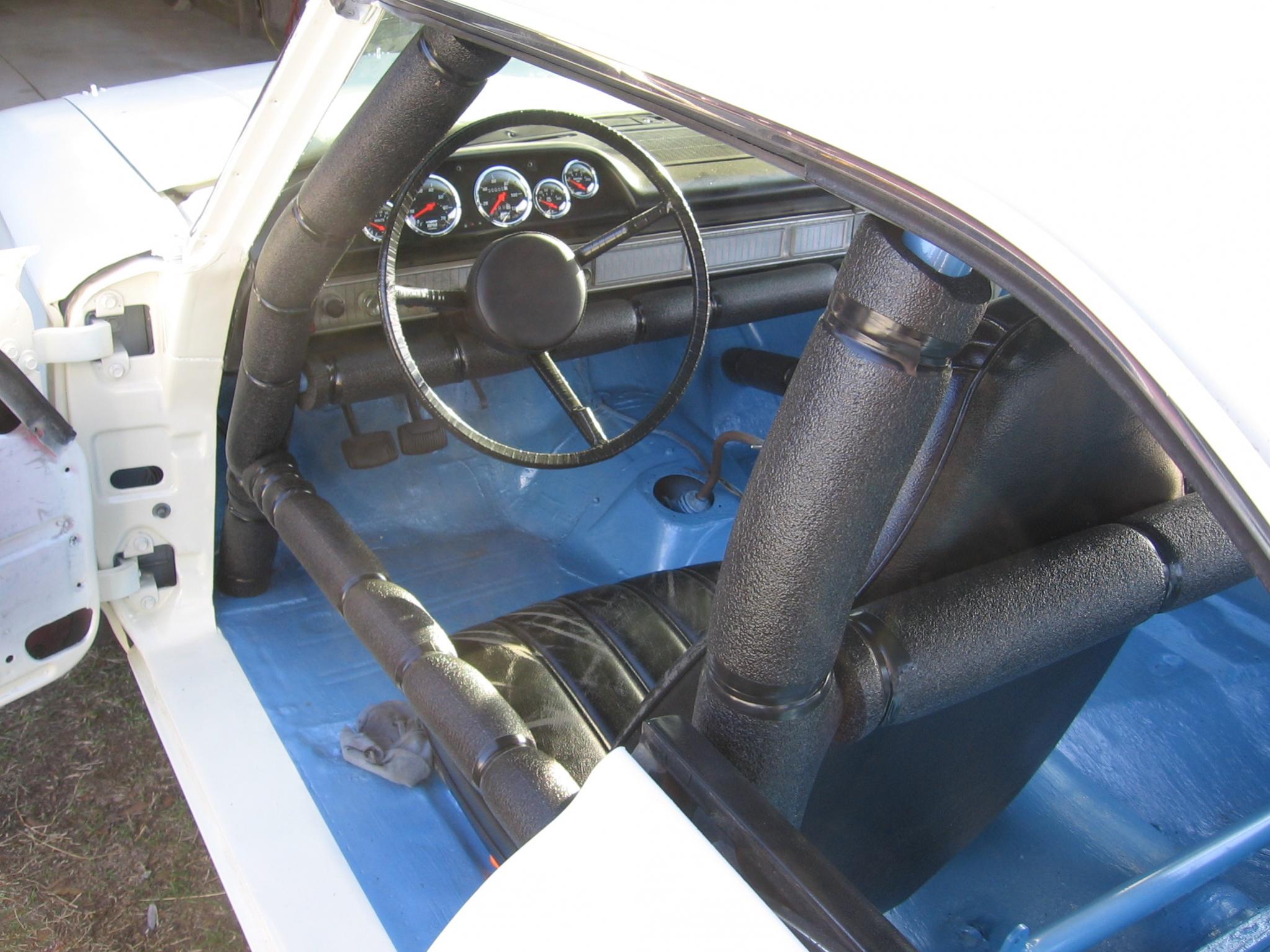

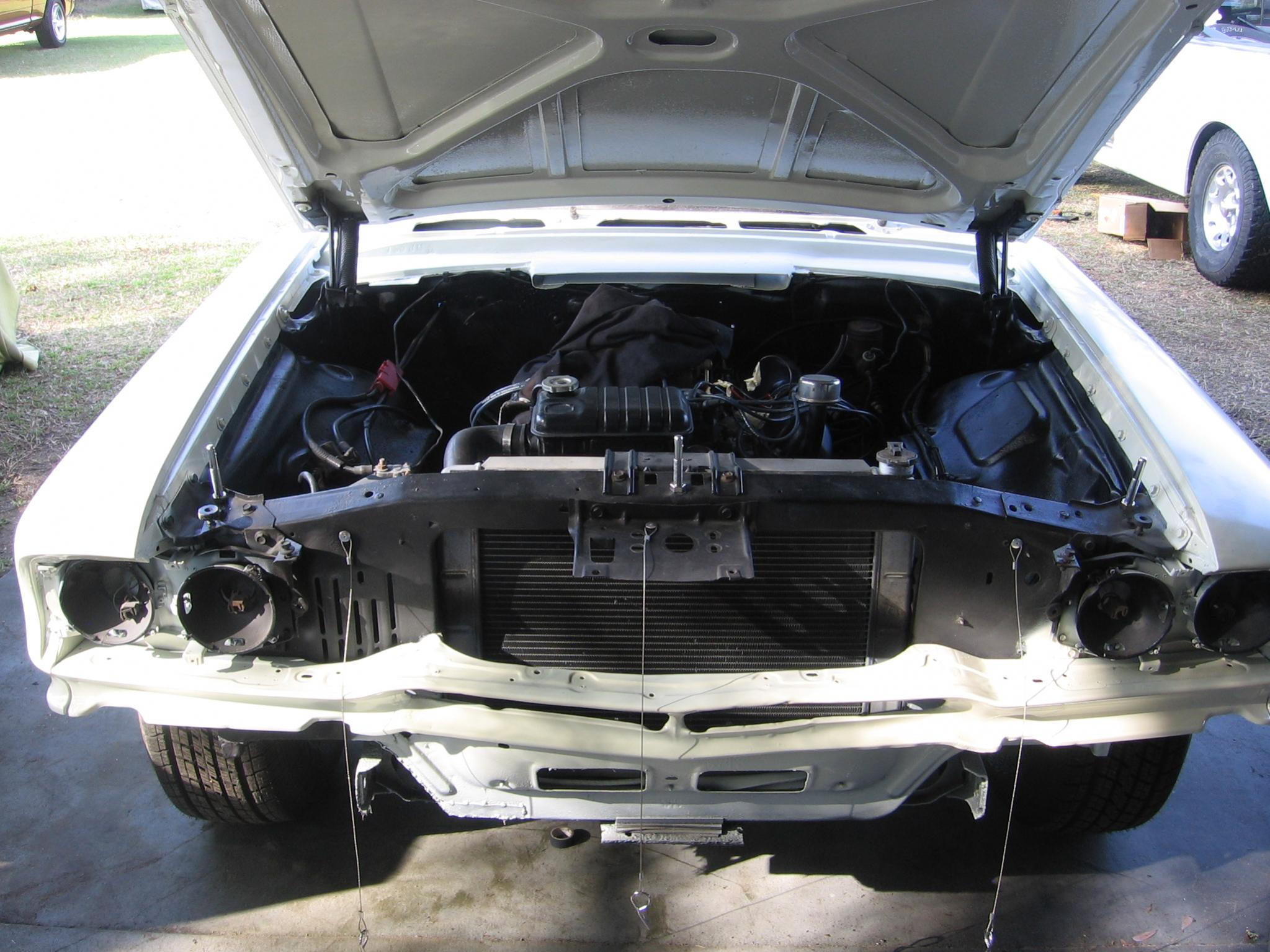

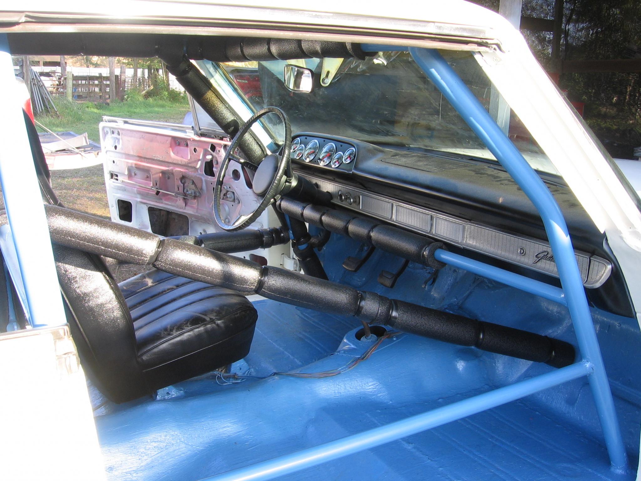

    Busy few days took Friday off to work on the car and it carried over to today and will go into tomorrow.
    Got the new headlamps, grille, front bumper, door handles , locks, pop riveted the door panels and isntalled door trim, interior window crank handles, replaced the headlight switch still no dash trun signal flash constant on still troubleshooting.
    Installed new shifter boot and chrome cover, installed five point harness, will install the rear bumper and move to the motor to install new fuel pump, oil filter relocation kit, new sending unit sensors, fan blade, belt, fuel lines etc,
    Its coming along.

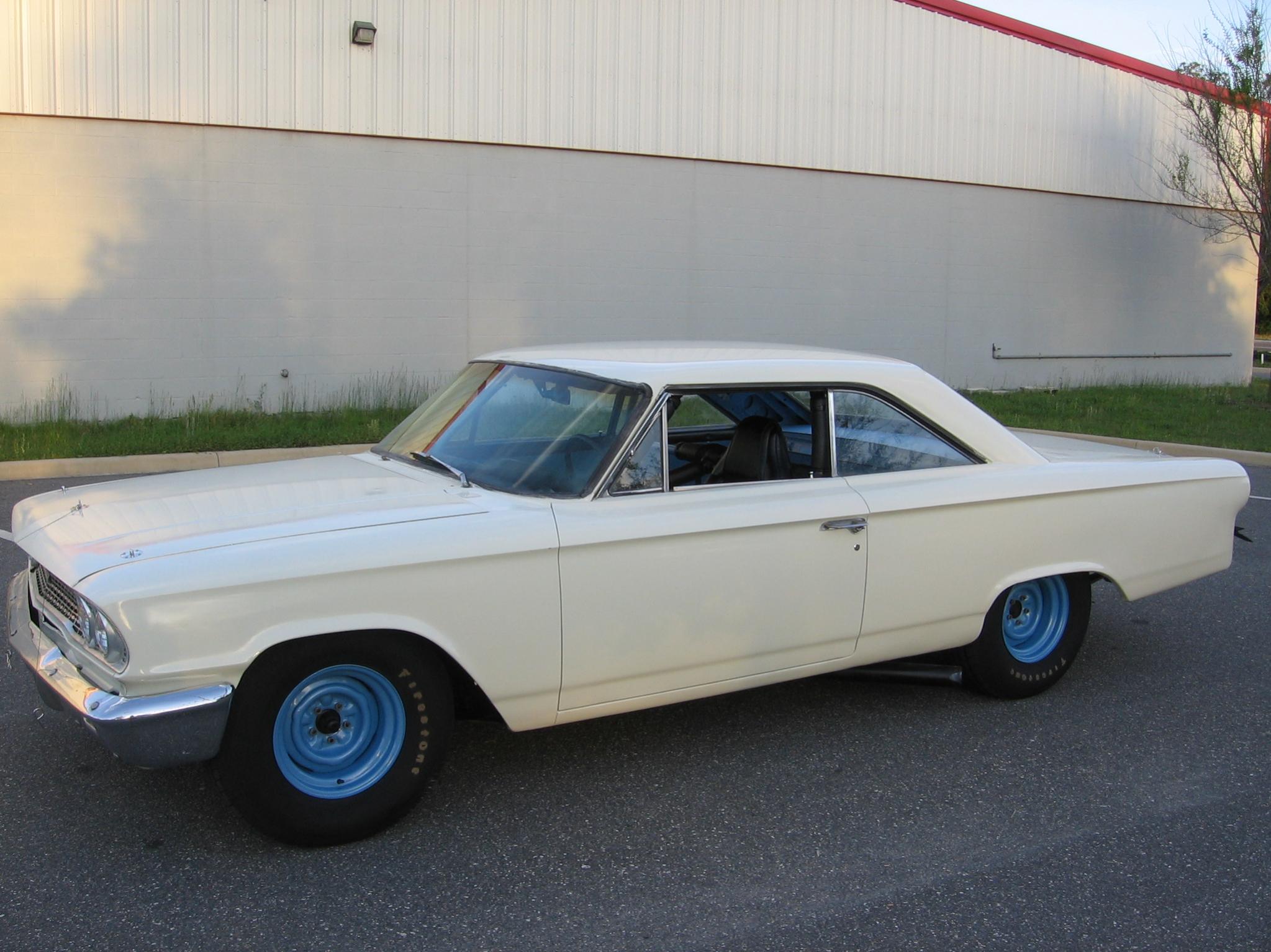

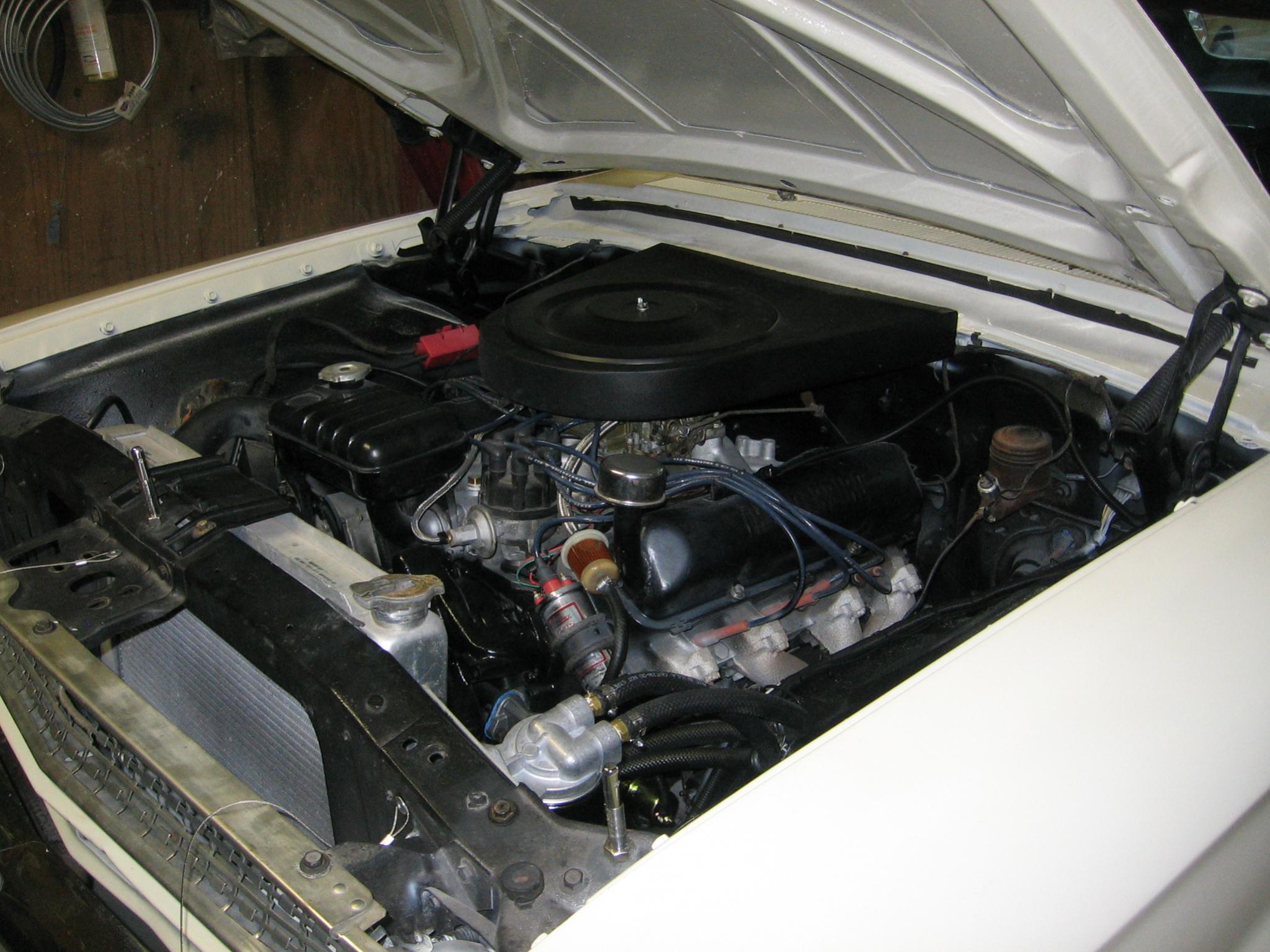

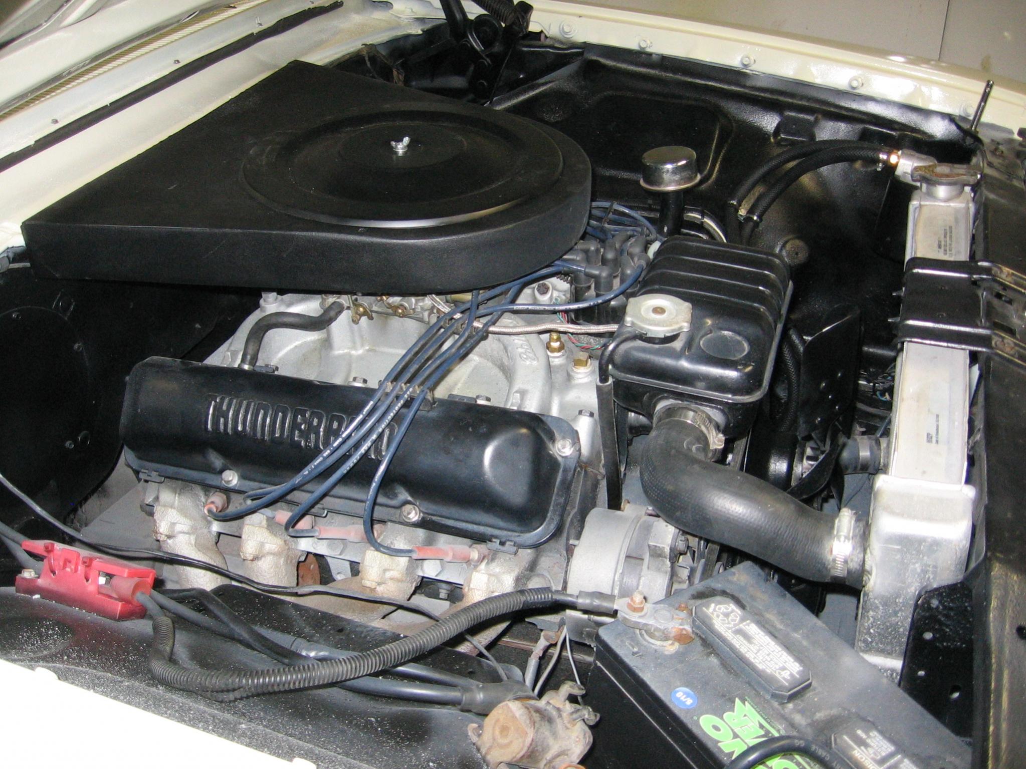

    New pictures, took these after I got home this evening.
    Lots of things completed this weekend.
    - Oil filter relocation installed looks good (race vibe)
    - Oil pressure sending unit installed good pressure (70 psi)
    - BATWING air cleaner installed functions good pulls cool air from cowl as designed and clears hood just fine
    - Fixed carb, bad electric choke and moving parts so we decided it had to go so we removed it and the ****erfly valve so its open like a race carb no biggie it dont get that cold and I can use my foot until it warms up.
    - Added the "Compe***ion Engineering" Decal on the heater delete plate like the orginal race car.
    Took the car down my drive way and found out the tire is rubbing when turned on the wheel lips so its time to "old school roll the lip" with a wooden baseball bat and some people sitting on the fender.
    Autometer service says send the TACH back they can repair it hopefully, so I will send it back if its cheaper then $110 I am good with that.
    As requested an outside picture on the blacktop.
    Shes come a long way since the September project start "raw canvas" and an plan of attack, funds are super tight so race graphics "hand painted $500" will have to wait till I can save up the funds may take a few months may have to see if I can sell some misc stuff get some cash in the kitty jar.
    Hope you enjoy it:)
