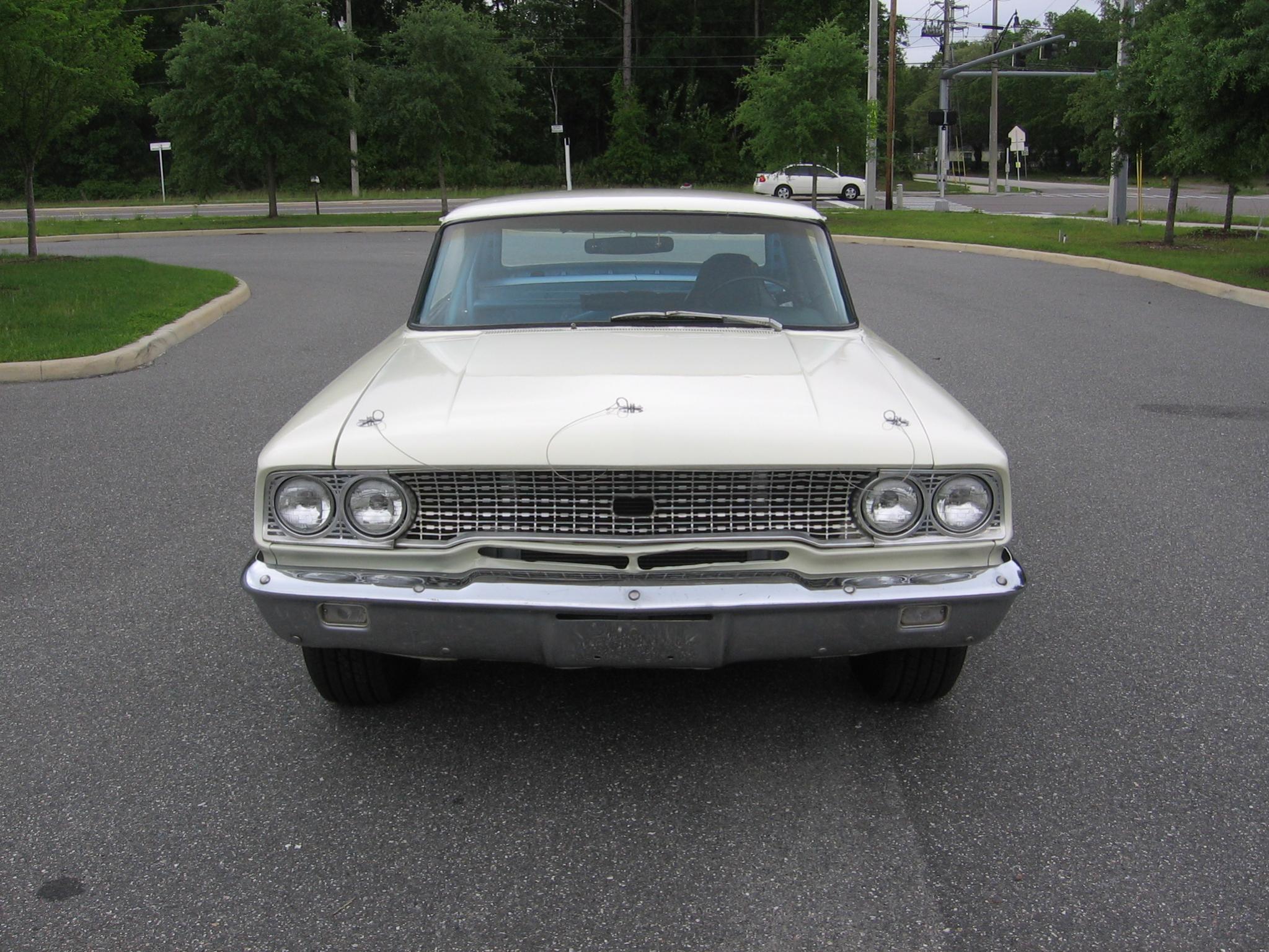

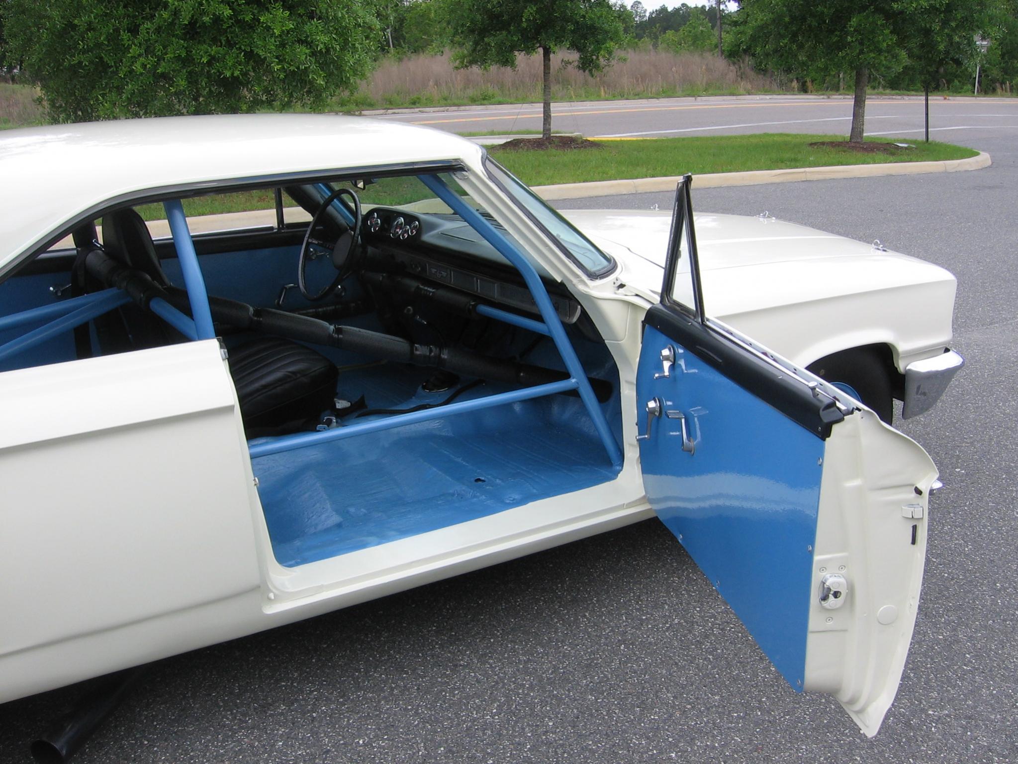

    April 21st new images.
    Got the floor pan wire loom done, cleaned all of the overspray off the glass inside an out, got the reverse lights connector wires soldered up and heat shrinked so the switch works good. Did some cleaning on the interior floor pans got a lot of dirt and crap on them while working in the car. Please diregard the hole in the dash cluster that was the TACH I pulled and shipped to Autometer for repair.
    Forgot to add i resprayed the seat in SEM Black its looks good and no cracking so far.
    Decided to take some new pictures all four corners and interior shots for you guys to see the progress to date, I am still shooting for first week in May for painted graphics cant wait to much white for me right now.
    I figured you would get a kick out of my FL Tag "MPG-HAHA" I have had this for years and its has fit every car so far we dont drive them and worry about MPG do we...
    I know I have a had a few request for daylight close up pictures hopefully these will do.
    Thanks for following the build.

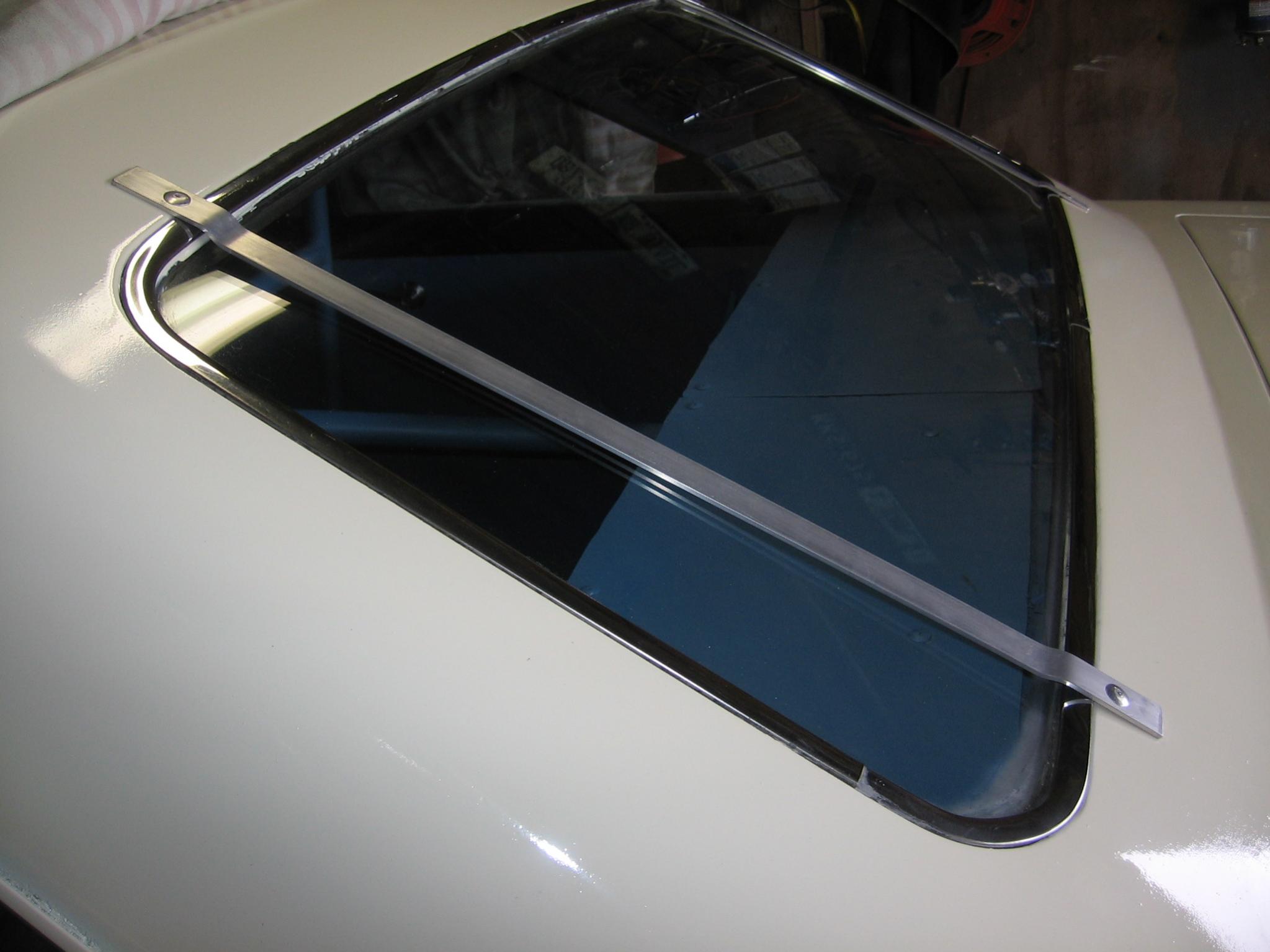

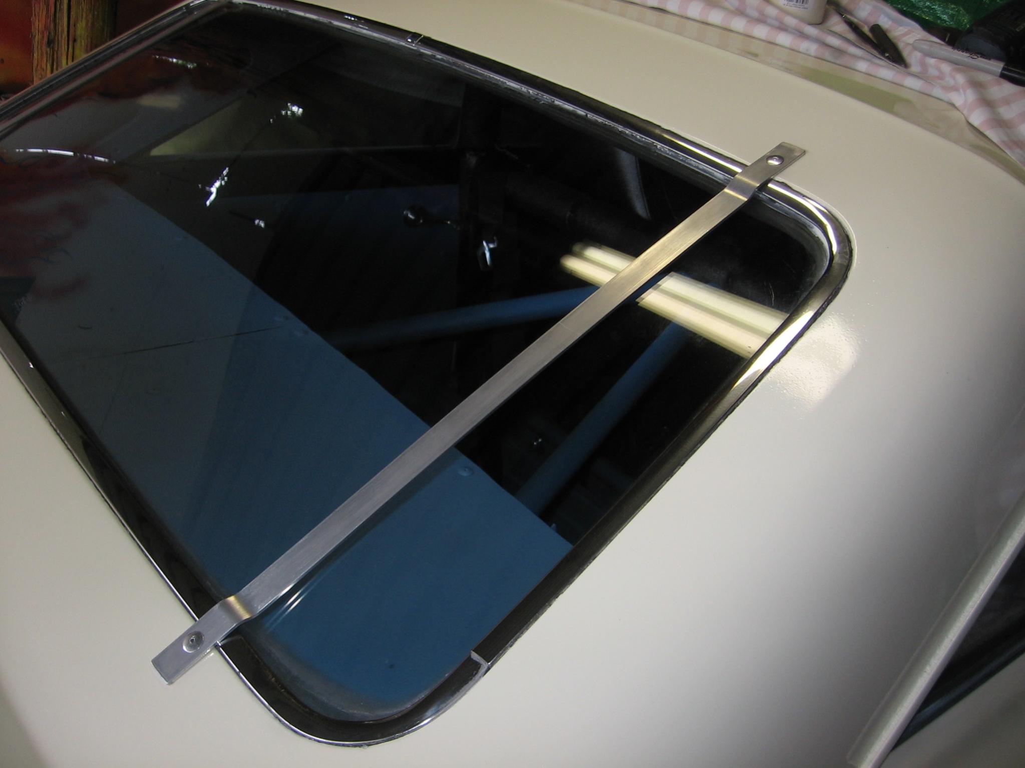

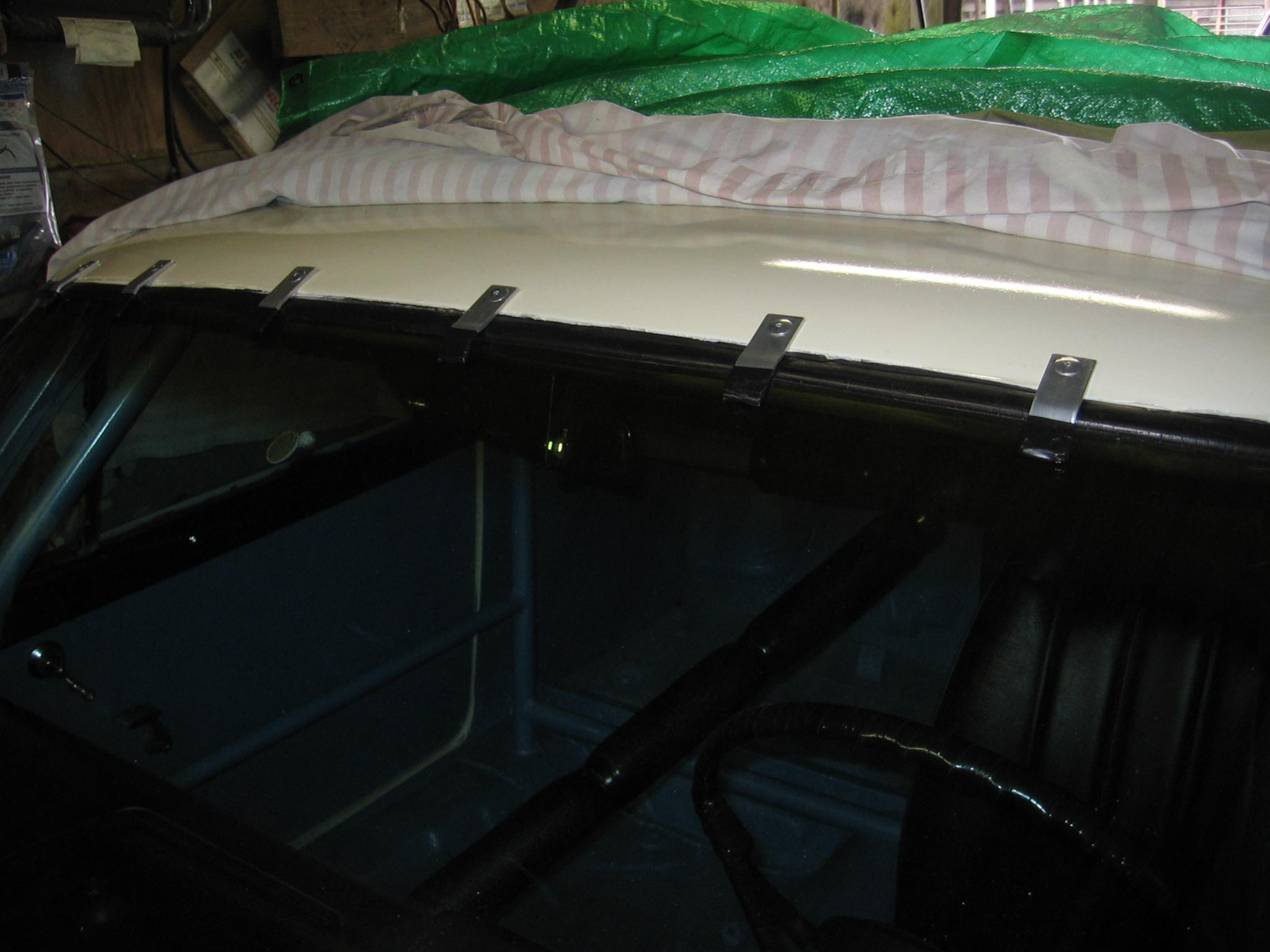

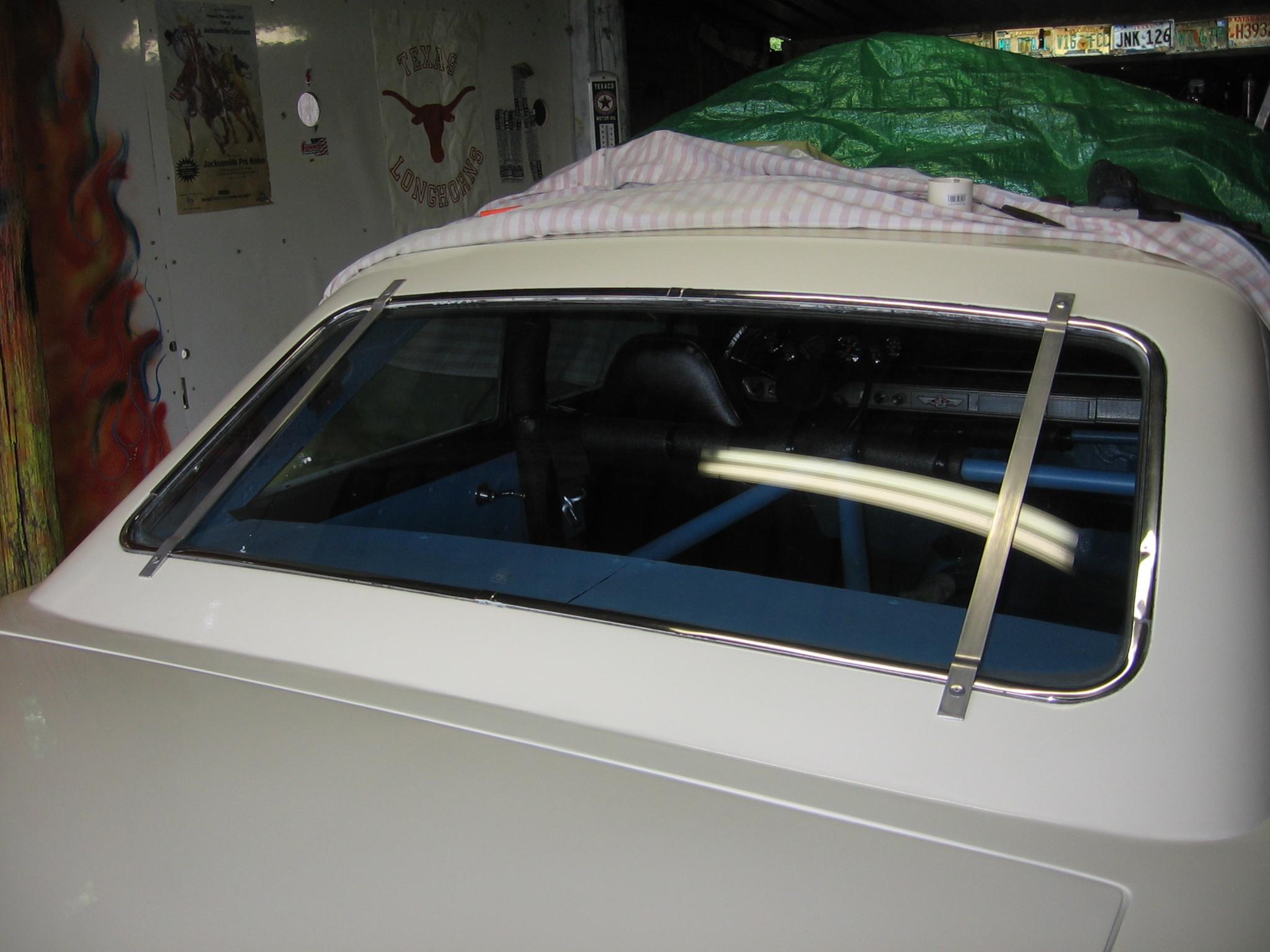

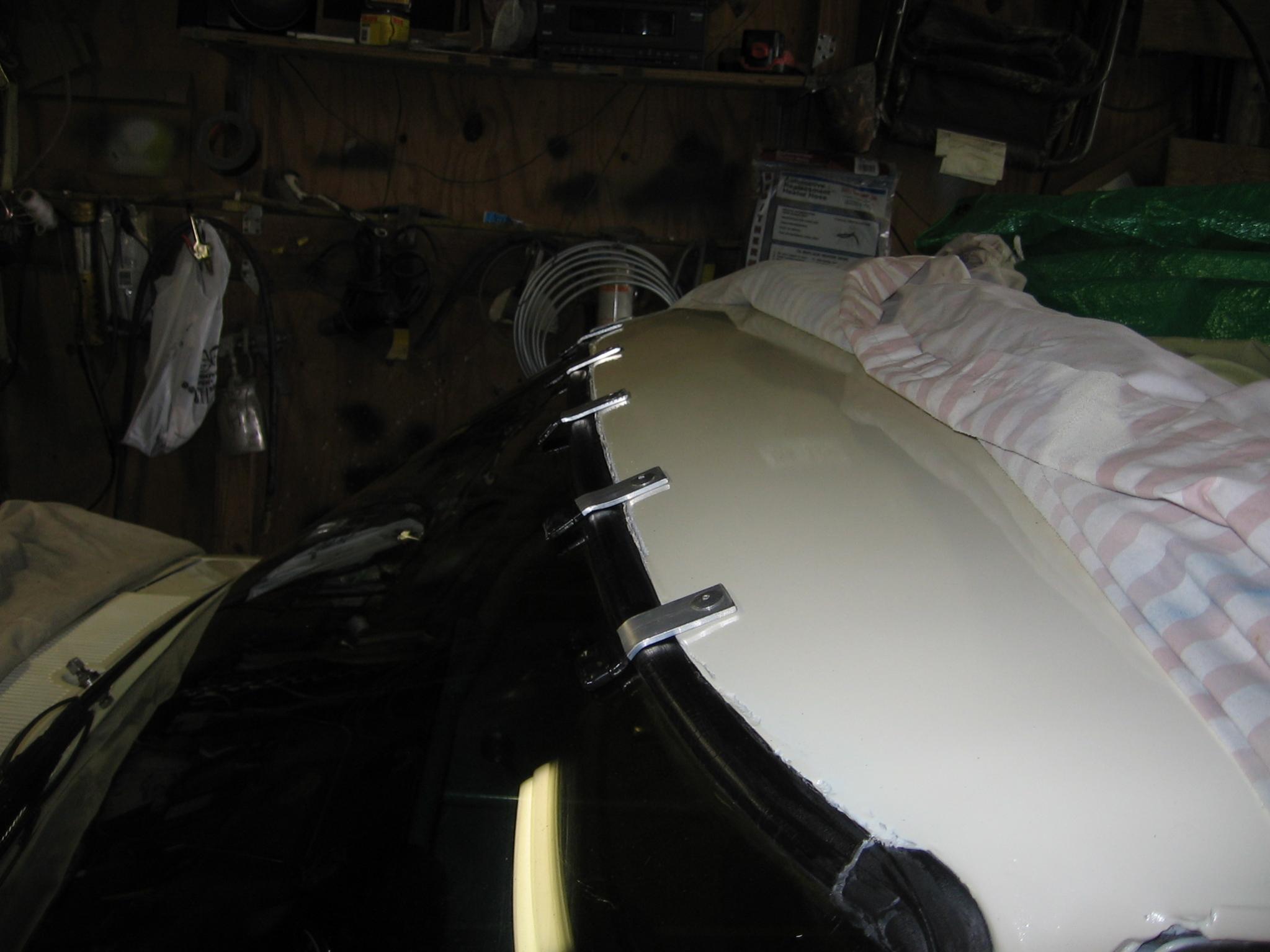

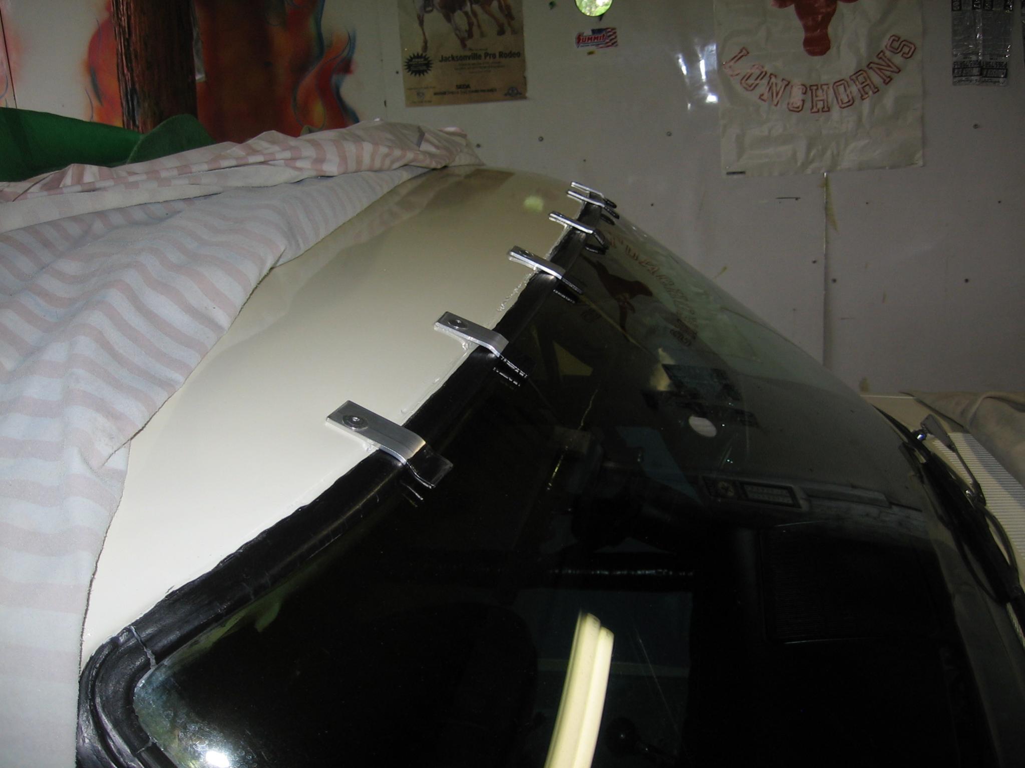

    Some more work today to check off the "to-do" list.
    Went to Home Depot and picked up two 3' long looks like 1/8 thick by 1" wide aluminum strips for the rear/front window tabs.
    Measure 3-4 times then started cutting the rear window slats to length, the fun part was making the bends with my vise covered up with a rag so I didnt scratch up the aluminum, got the pieces cut then bent, drilled out the holes sanded them with wet sand 400 grit installed them I used the large race car style big rivets.
    The front took longer to bend each peice, i drilled out the original front window trim holes to accept the larger rivets, then cut and drilled, added electrical tape on each front window tab so it would not be metal on glass like the orignal race car had. I Added six tabs versus the orignal two on the Dan Gurney race car. Before pop-riveting anything I added a dab of paint in each hole to prevent rust on bare metal.
    Think the tabs look cool and give it the race vibe as intended.
    Thanks for all the positive feedback, hopefully in 2-3 weeks I will have painted graphics on her:)
