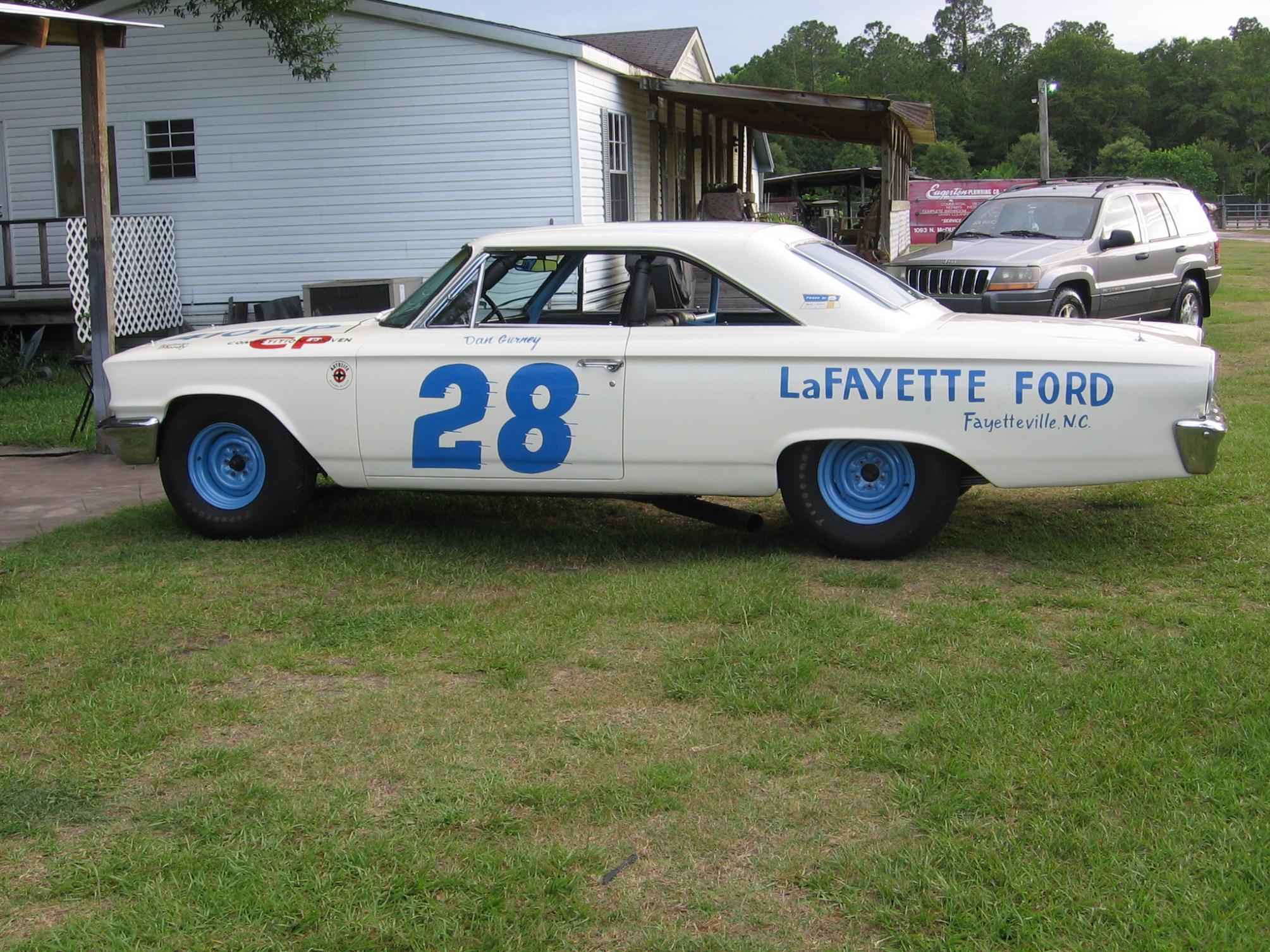

    Man, does this bring back the memories. The early to mid-sixties stock cars were the baddest of the bunch (the '63 1/2 Fastback the best looking, IMHO) It took a real man to wrestle one of these 4000 lb plus beasts all afternoon, especially on a road course, like Riverside (WITHOUT power steering).
    Very difficult to build one of these with the "Build on a Budget" theme and come close to the mark, but you have done so.......Congrats!

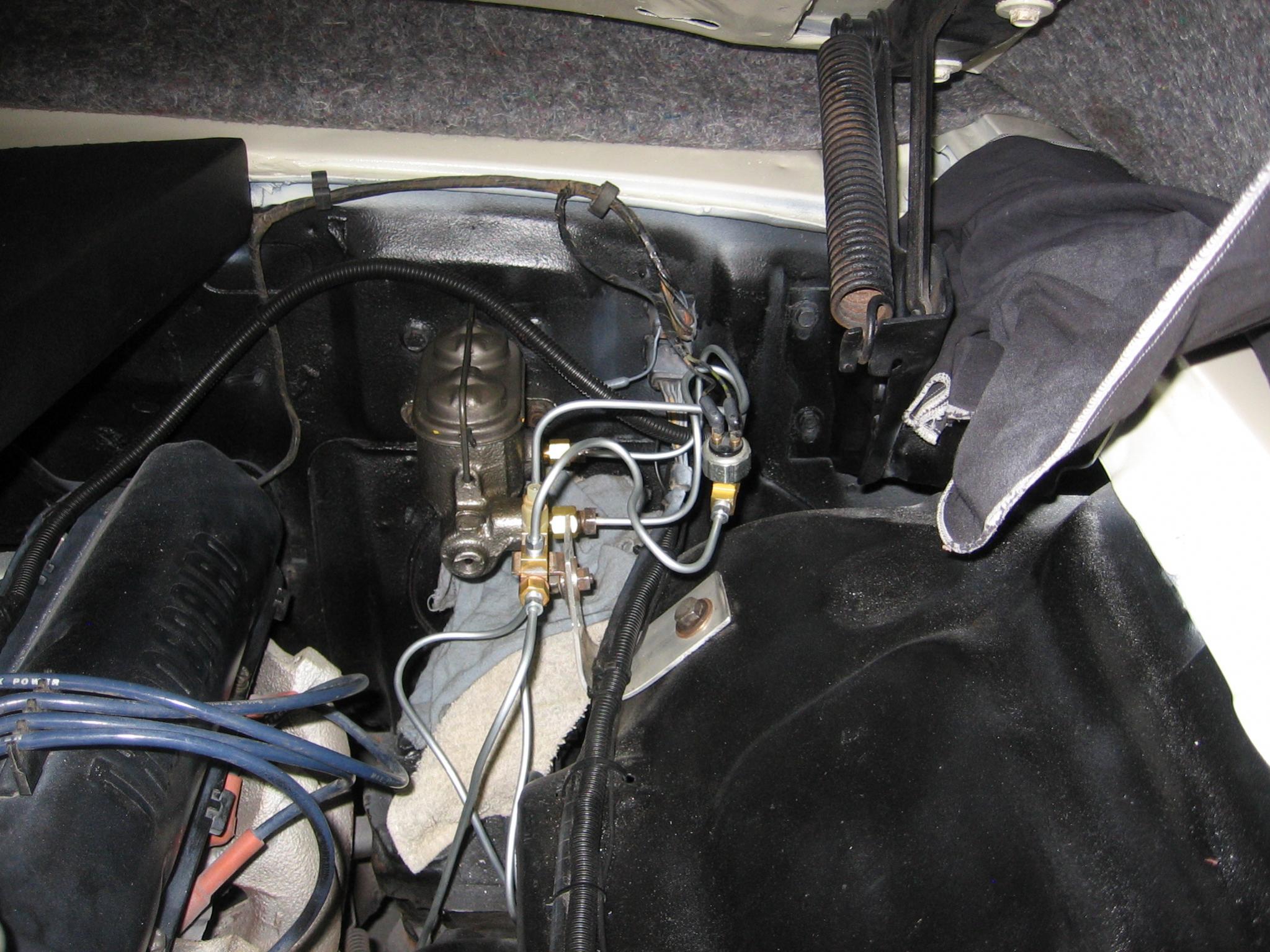

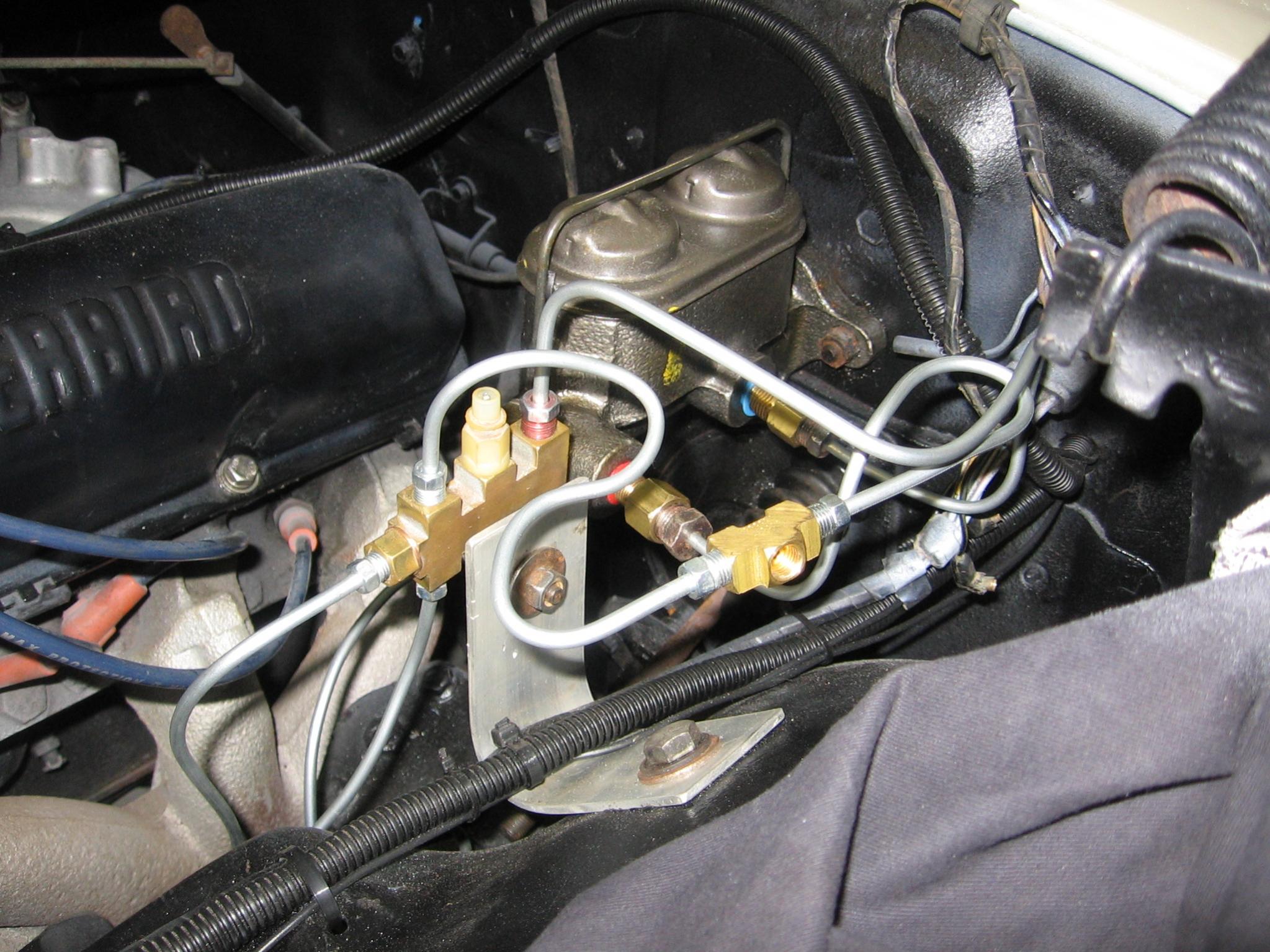

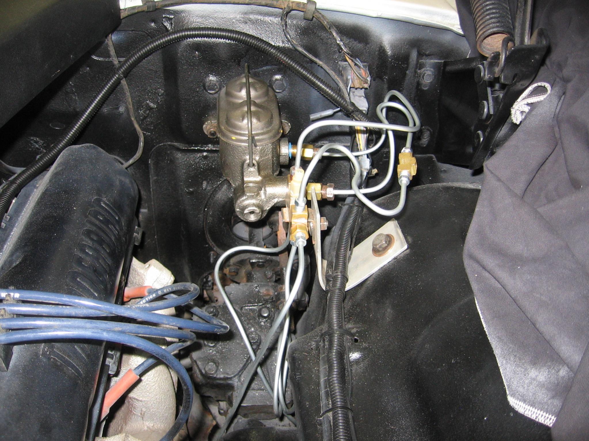

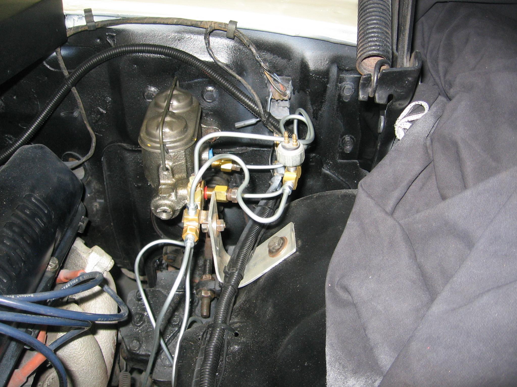

    Some images of the Dual MC conversion, the lines going to the Master Cyliner and pressure switch are loose as i still need to recut threads for the pressure switch to fit the three way connector for the front brakes.
    So I cannot run fluid thru yet until the system is all connected.
    Forgive the layout lots of bends to put all of the lines into the new 5 way proportioning valve.
    Like I said got about $60 in parts when I get done I will clear coat everything to minimize any potential rust.
    Maybe tomorrow I will get everything tightened up and bleed.
    Added two images of the window slats /keepers to give you a better view of those.

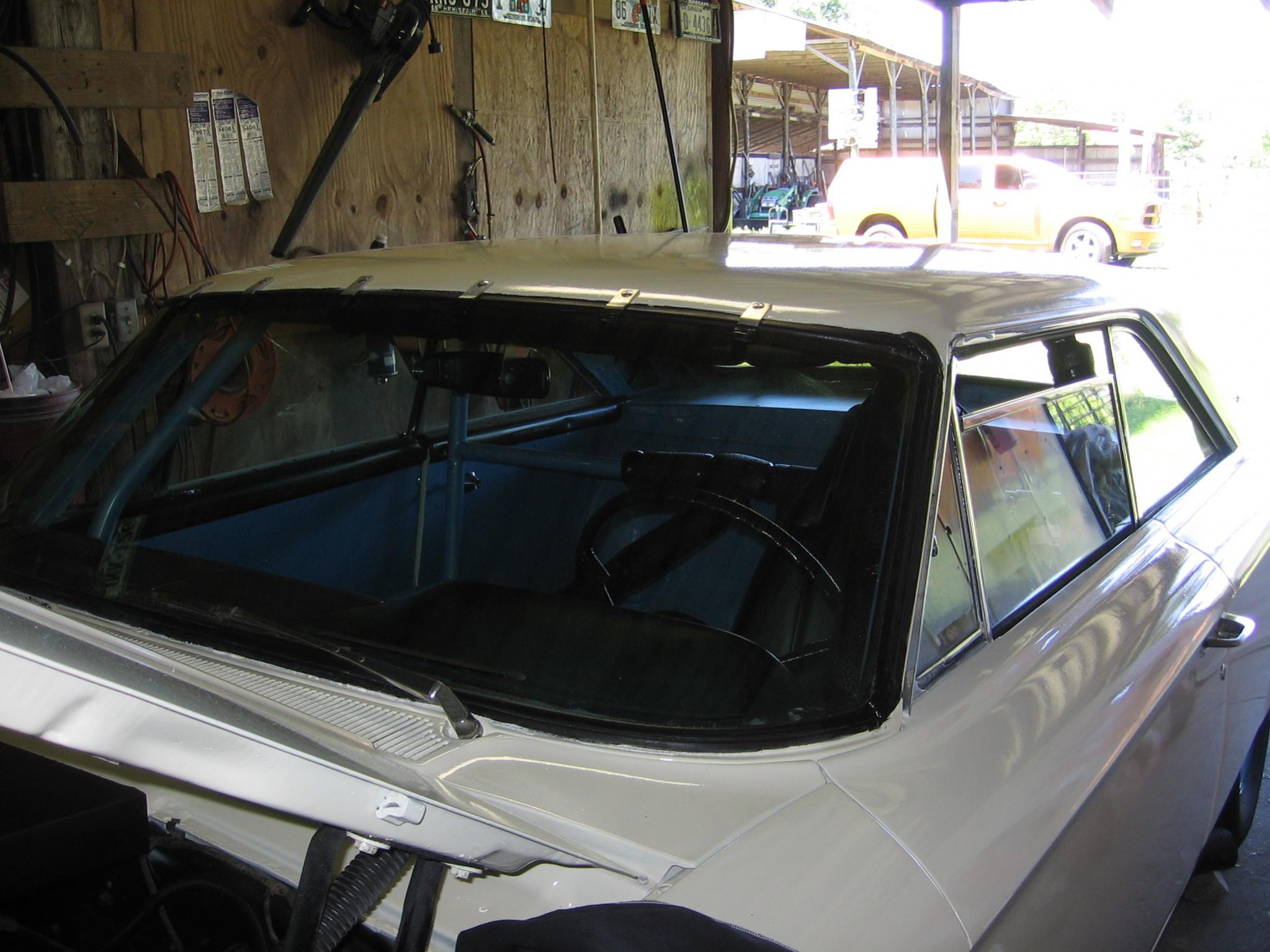

    The original seats in the Holman Moody Galaxies I believe even into 65-66 were Econoline Van Seats heavly padded with both left and right arm rest built into them for the long races. In 65-66 at least the Fred Lorenzen model they added a head rest pad external from the seat for more head support I guess.
    I have seen some "clones" with the Galaxie XL buckets they look good but the correct ones were the Econoline Van seats which in todays world are almost unobtainable, ifyou find one they are beat to ****.
    I liked the higher back bucket seat, I kept in the VAN world and it had to be vyinl so could paint it black with SEM black paint.
    I got a pair of these ($40) a local u-pull-it out of mid 90's Dodge work van you find these all the time they had at least 3 of the vans to pull seats, the pair I got driver side had a tear in the seat portion, the p***enger side was perfect.
    The benefit is the come with the sliders , they look high in the van due the the welded in mounting plates, so when you put them on the floor of the Galaxie they are LOW so you can build your own mounting risers. Mine were easy to build NO BUCKS backyard inginuity, had an old metal bed frame with the feet that you usually put your roller wheels on, they are about 3-4" high cut them off they already have holes in them to mount the seat studs and nuts. Cut each riser, tack welded it layed a board across to make sure it was even, did them one at a time so they were generally level. The seat can actually slide whcih allows for long /shorter leg drivers.

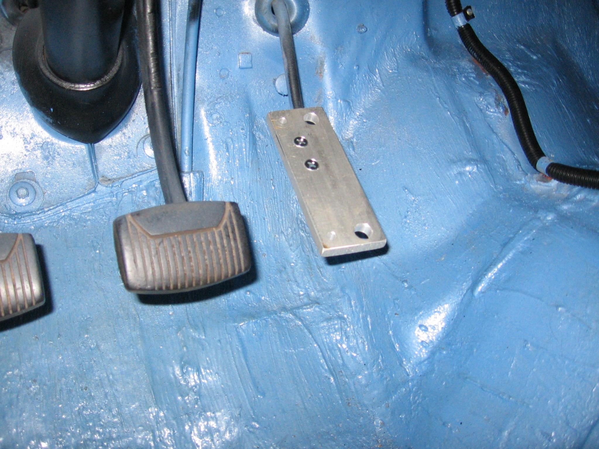

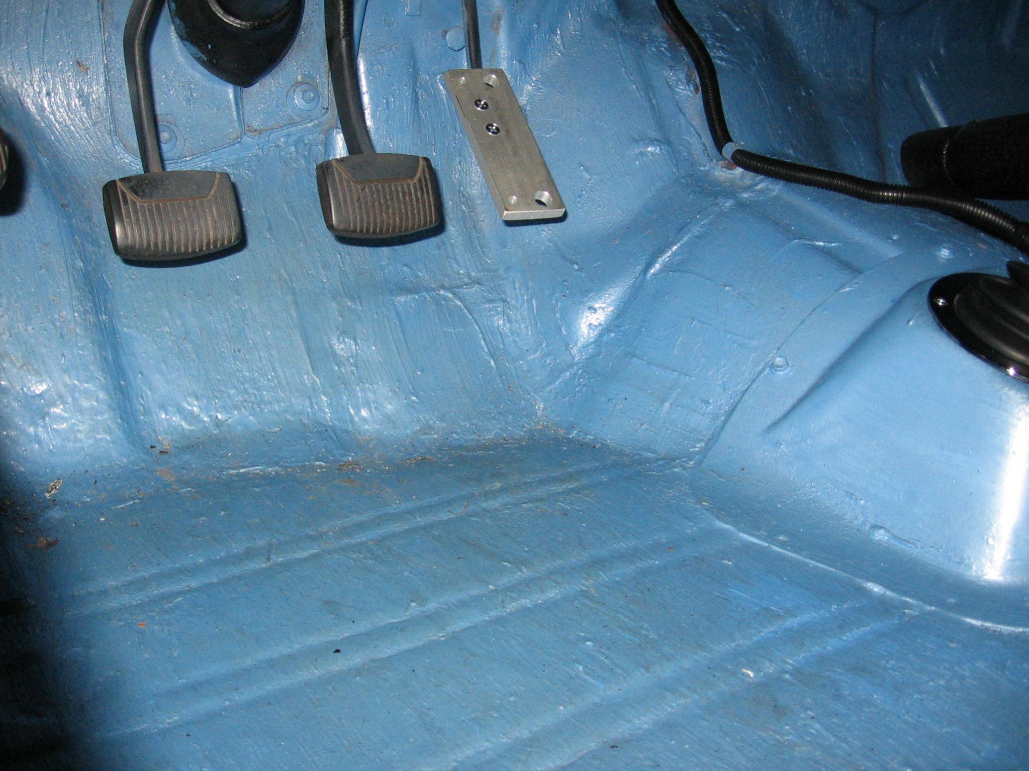

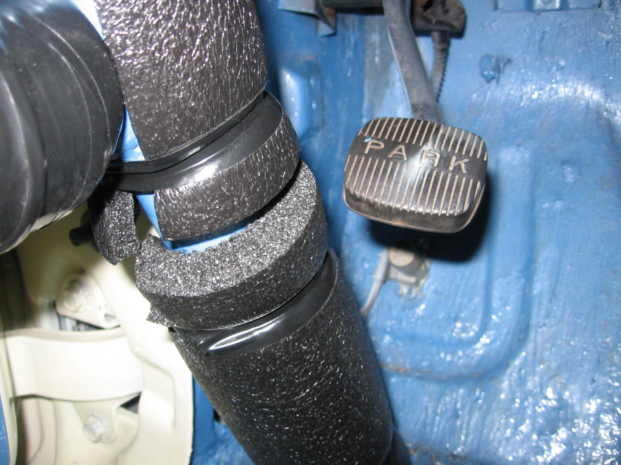

    Well took the day off today to do some little stuff I have been putting off. I have been struggling with the gas pedal issue, I have a brand new re-pop factory long one that bolts to the floor but it aint going with the race vibe. So I had a set of aluminum blocks fabricated for a Cougar project to lower the suspension I never used them so I took one tap some new holes with two aluminum brackets wrapped around the pedal rod added my srcews in countersunk holes a couple of nuts and I got a cool gas pedal.
    Since the car is still a driver I kept hthe ebrake but with the rol bar down pipe the pedal was not easy to depress in an emergency or to just park, so I unbolted it cut out a few spacers out of a piece of pipe to push the pedal ***embly out 3" so it now is accessable to push down.
    I alos installed the high beam floor switch and did some touch up paint in the rear seat area.
    I got the dual MC all bolted up, but still waiting to bleed them, maybe this weekend, my painter guy may get to my graphics next weekend after I get back from business trip out in Texas.

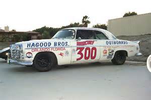

    my old one

    foolthrottle, nice ride the Chrysler 300's are super rare now to build I have pictures of one the real ones from the Amelia Island Concours DeElegance a few years back.
    Had the leather hood straps I think it raced the Mexico Rally back in the 50"s was a cool looking car. Its kind of strange how I got the itch to build one of these as I was born in 1963 and did not even grow up around or see any Stock Car or Nascar as kid or teenager. Something just apealed to me about the look of the early race cars those drivers were super tough they built NASCAR, but today the cars are freaking TEMPLATES , brands dont mean ****, its all about the sponsors and MONEY $$$, as it aint a real car and you dont race on Sunday and buy on Monday anymore.
    I like old school steel, big chrome bumpers loud freaking exhaust and keeping the memories alive for those who lived that era I hope am doing there memories justice, it will be bad *** when I finsih it.

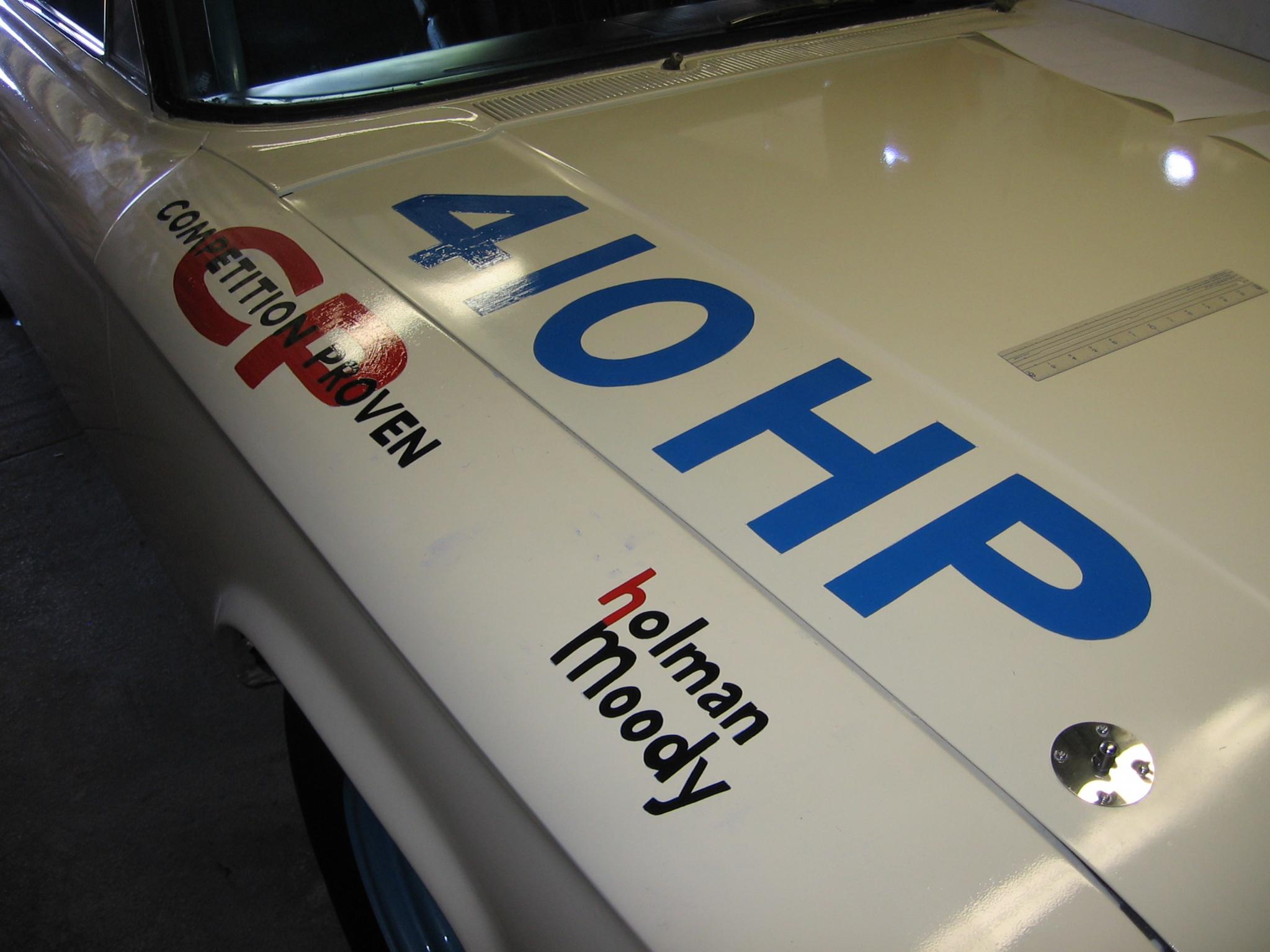

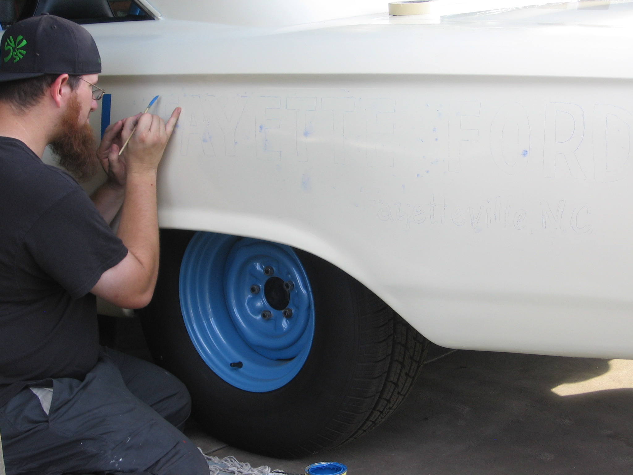

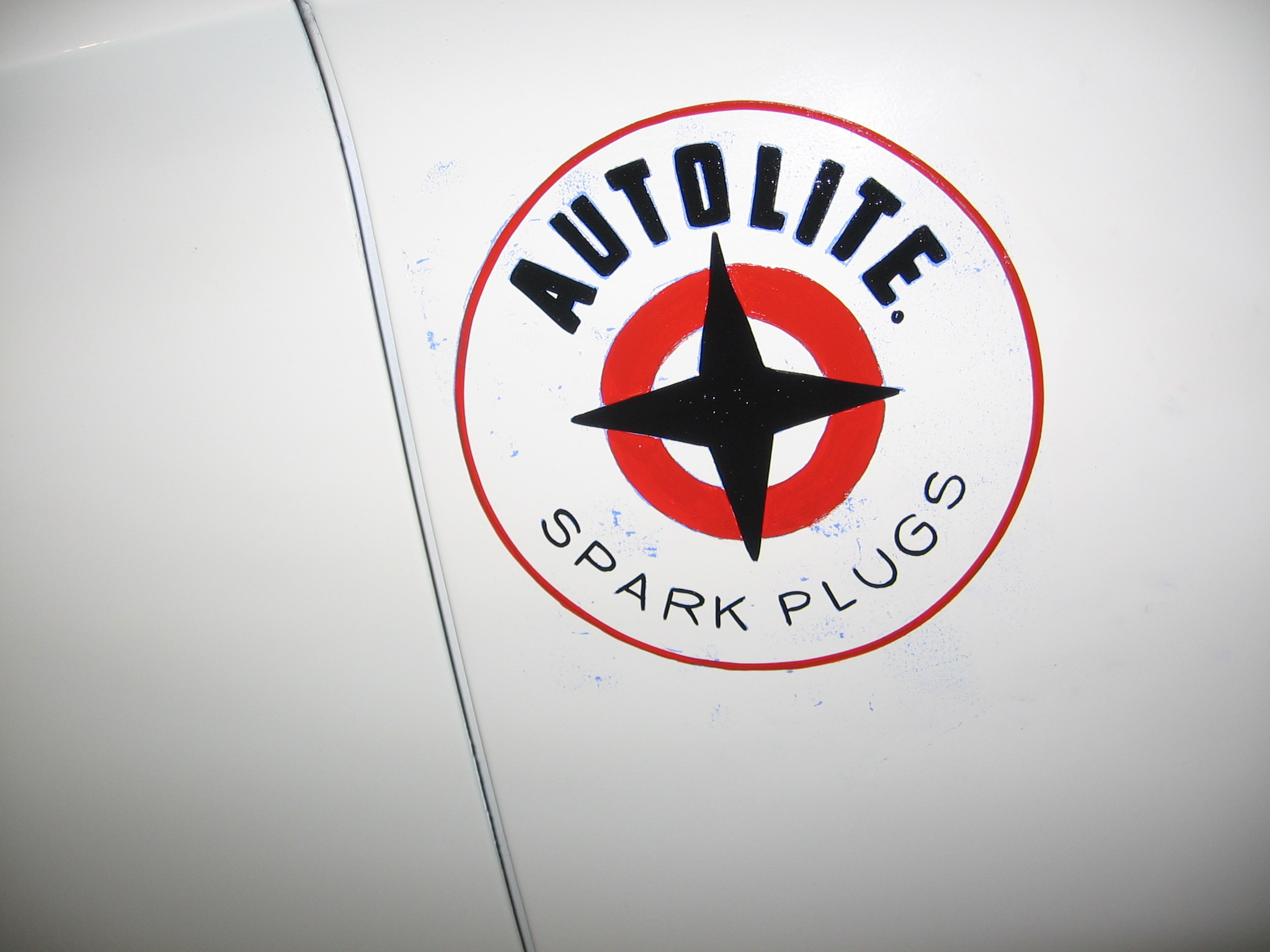

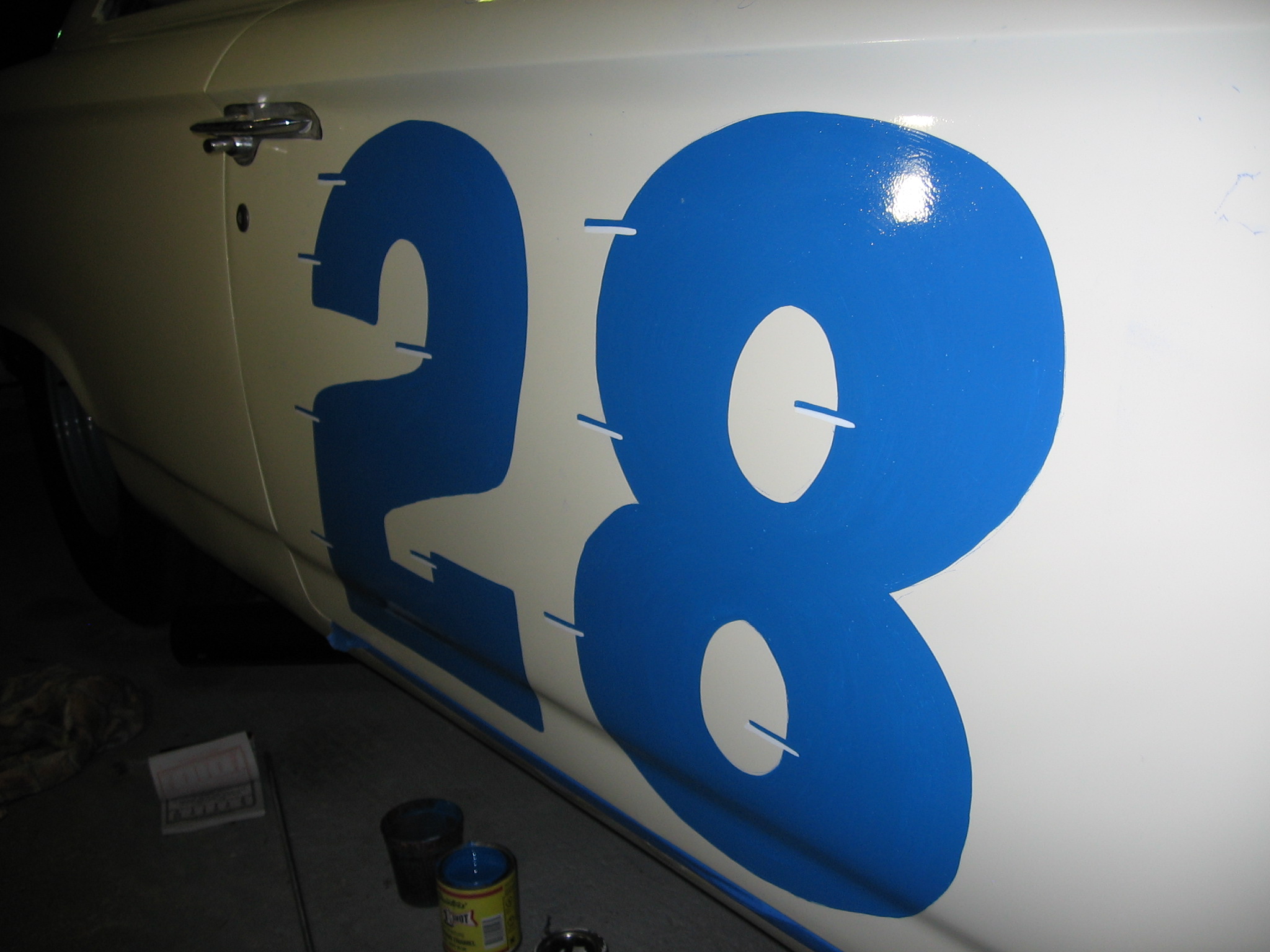

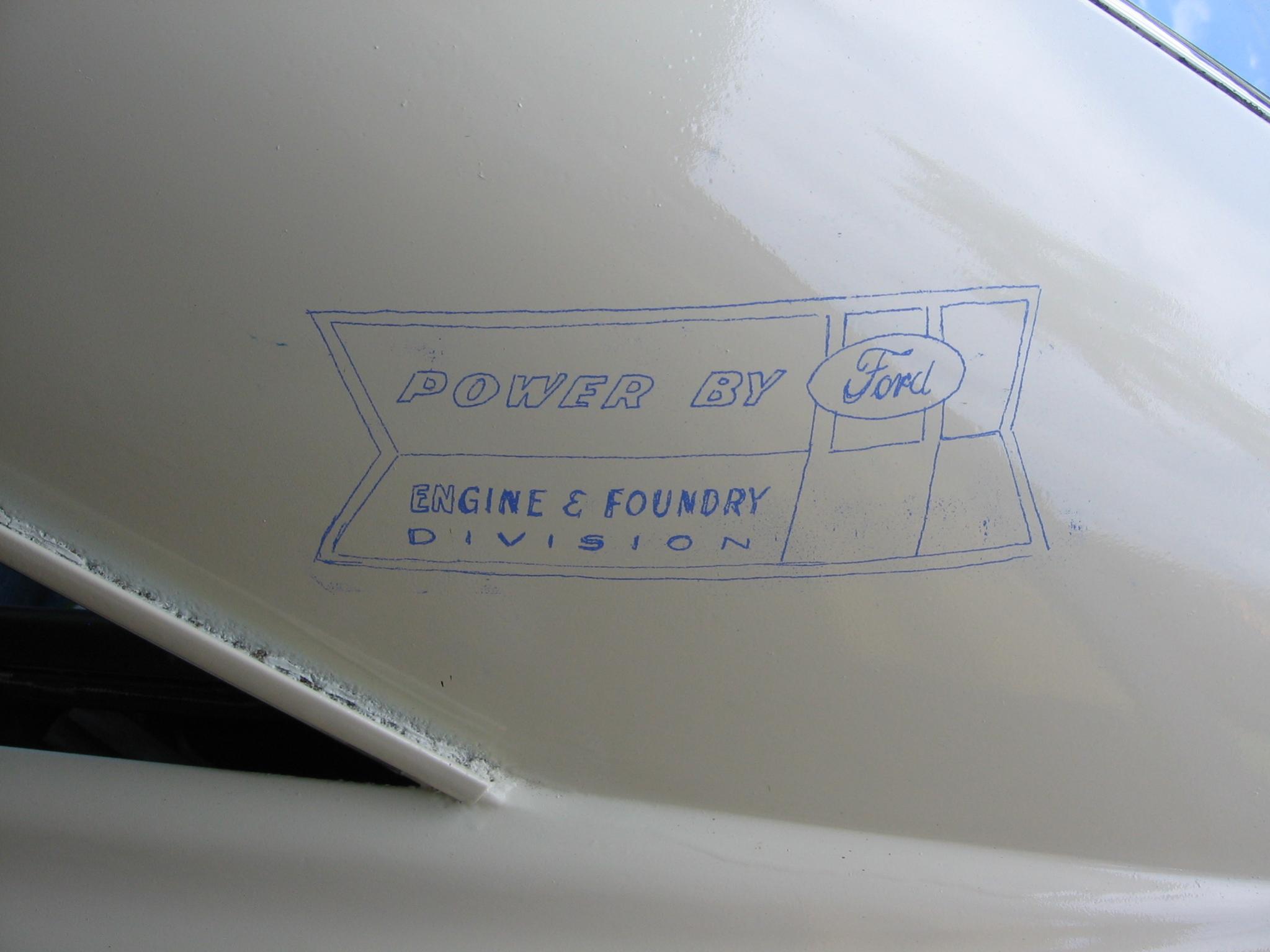

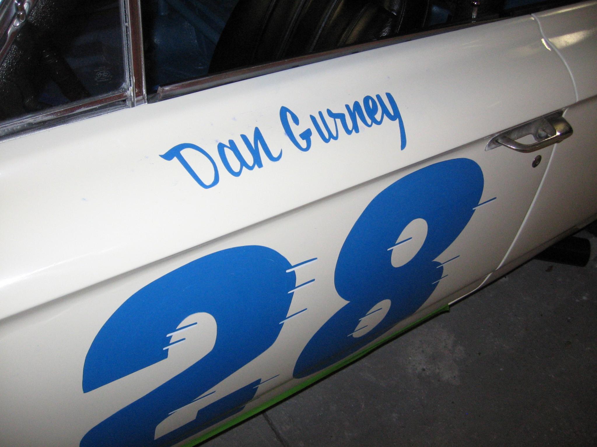

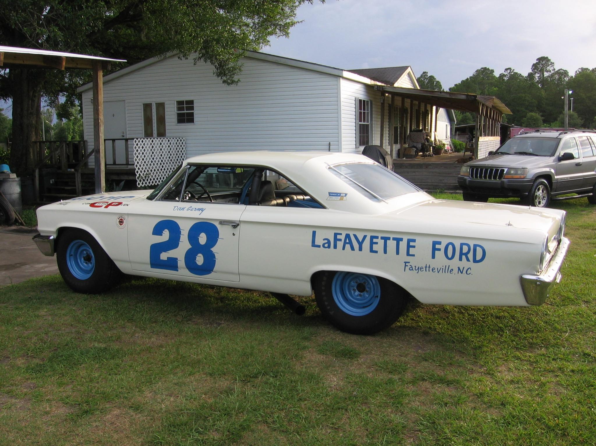

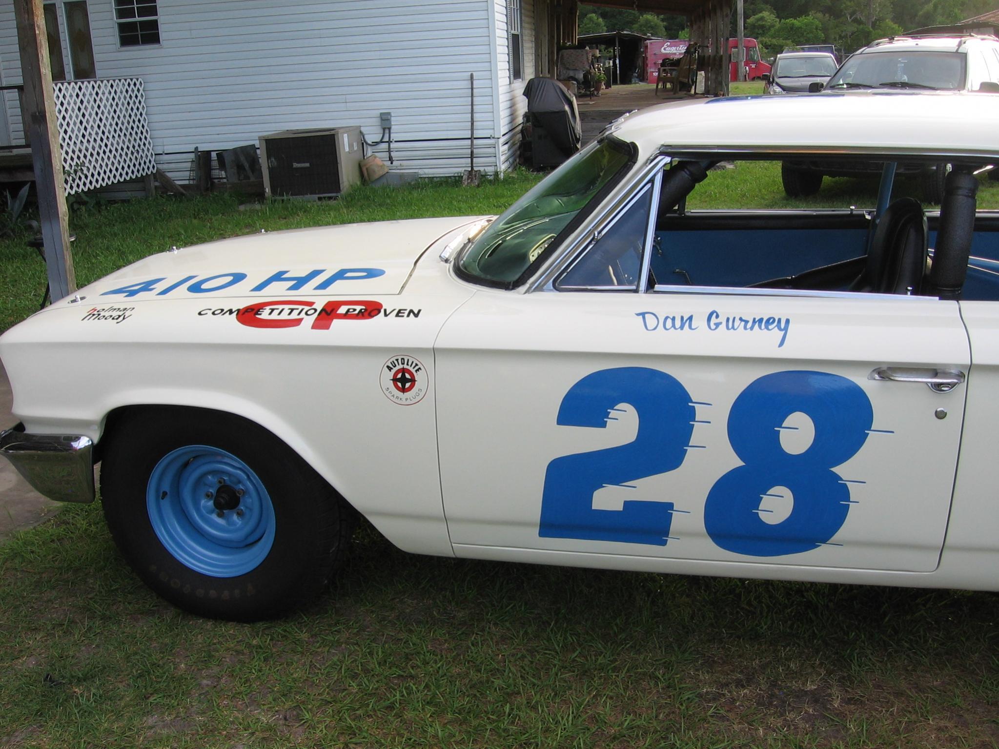

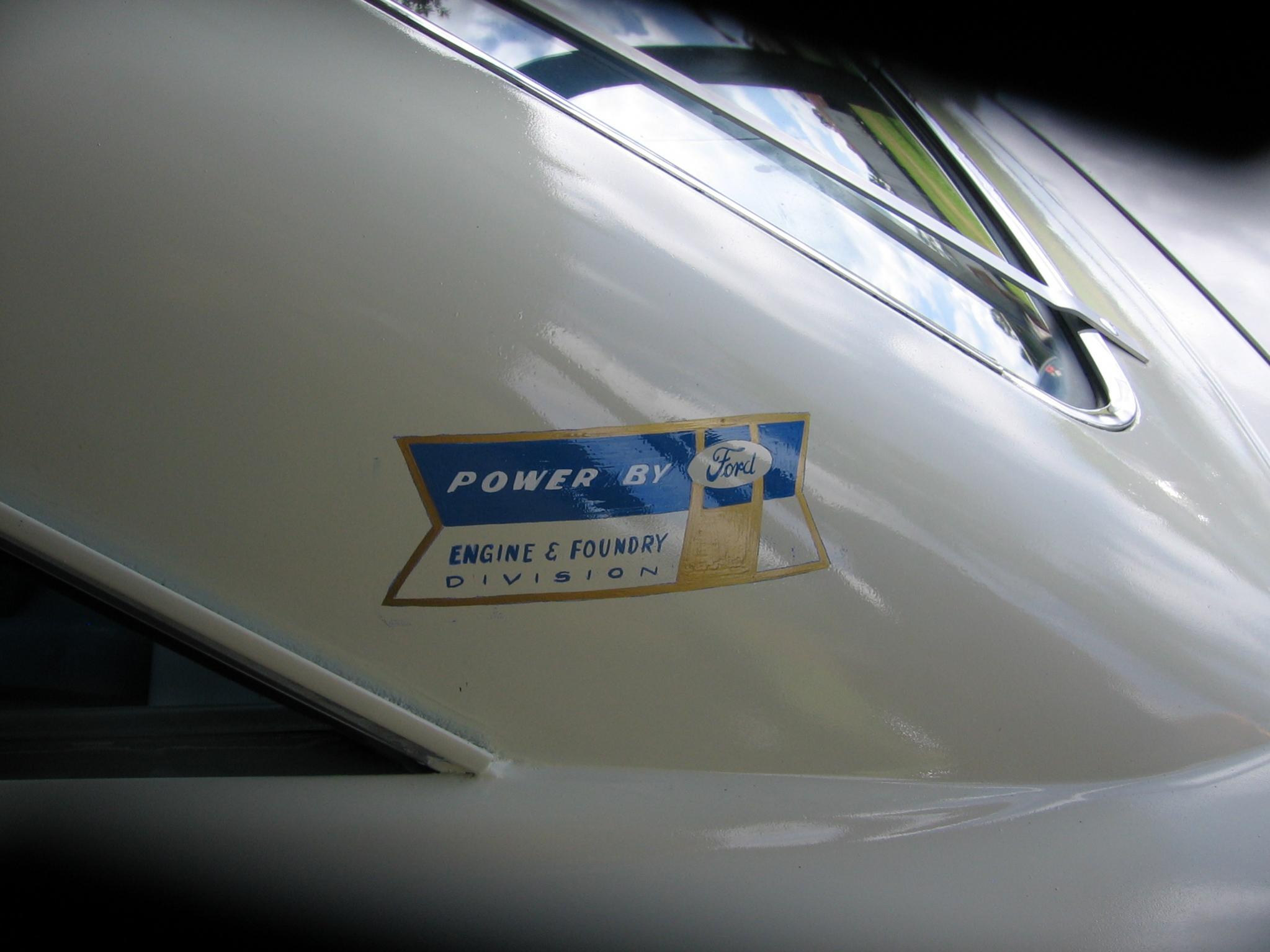

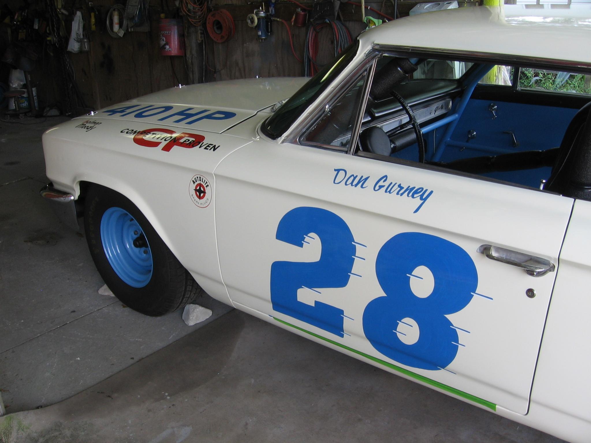

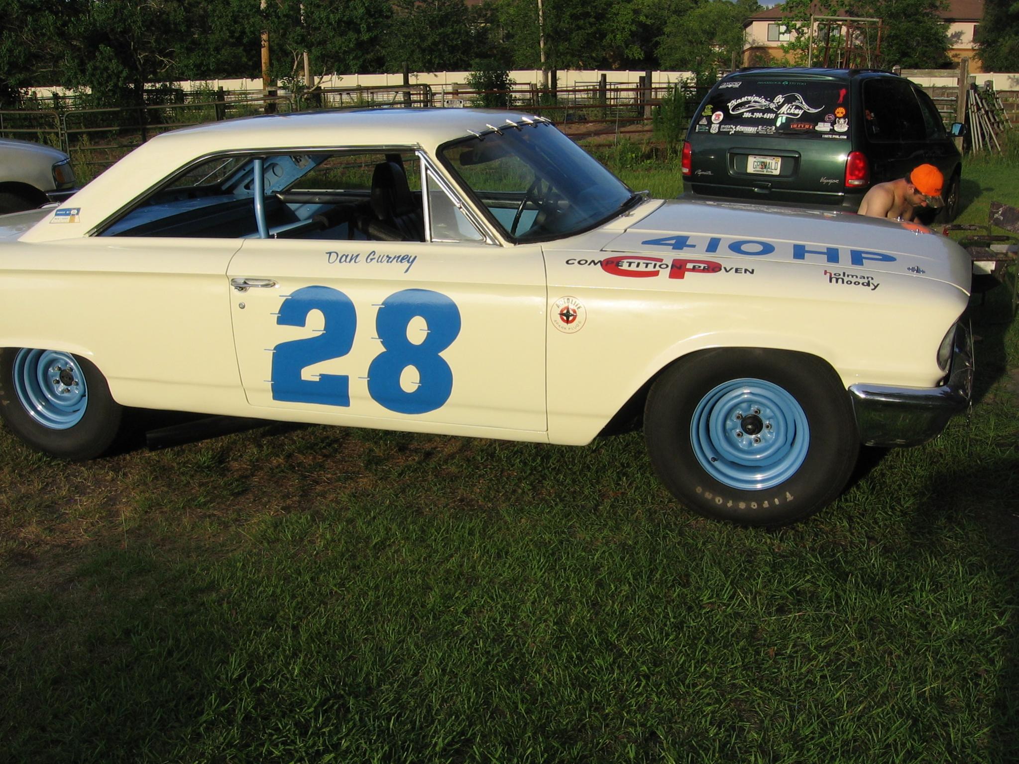

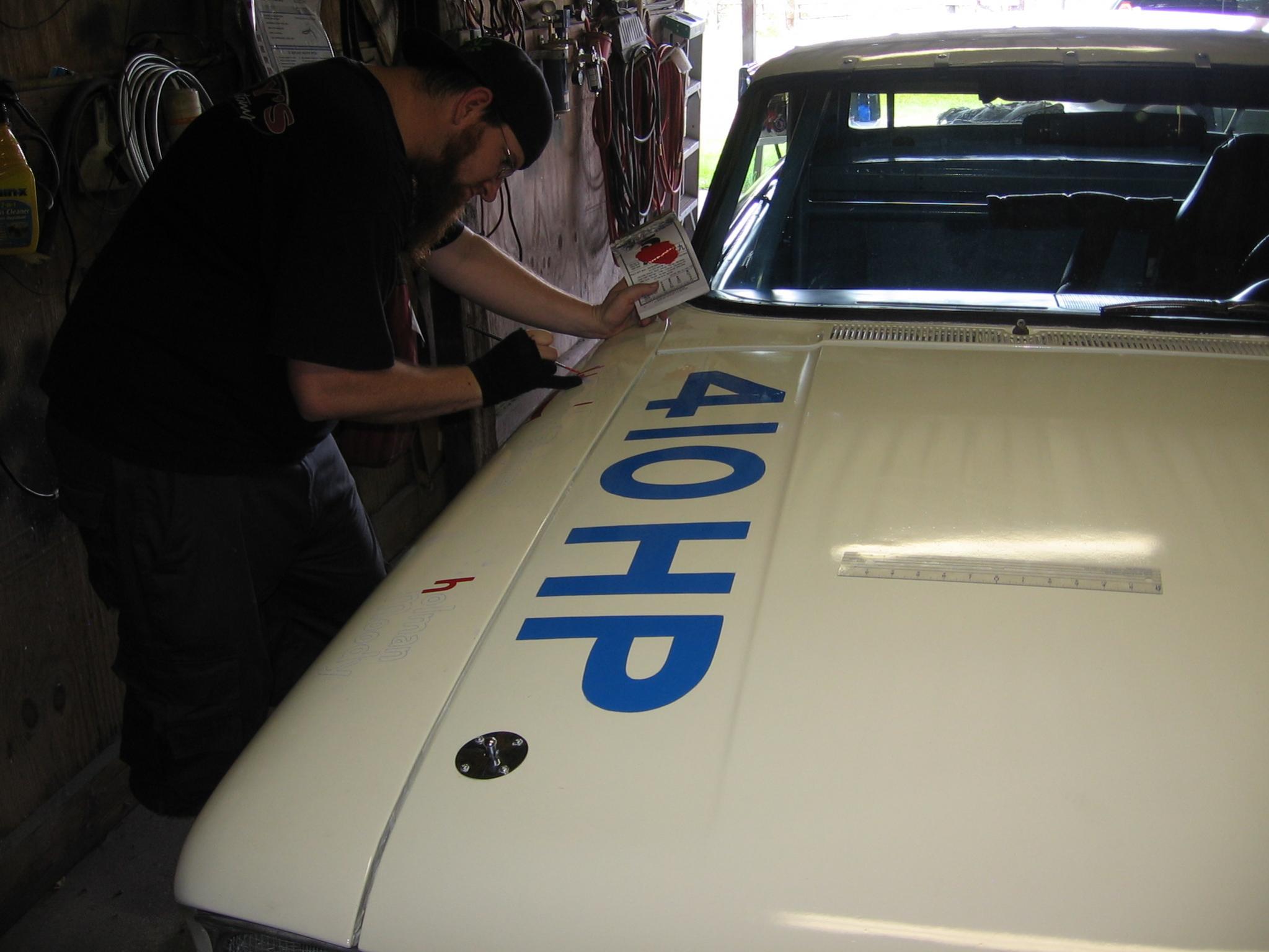

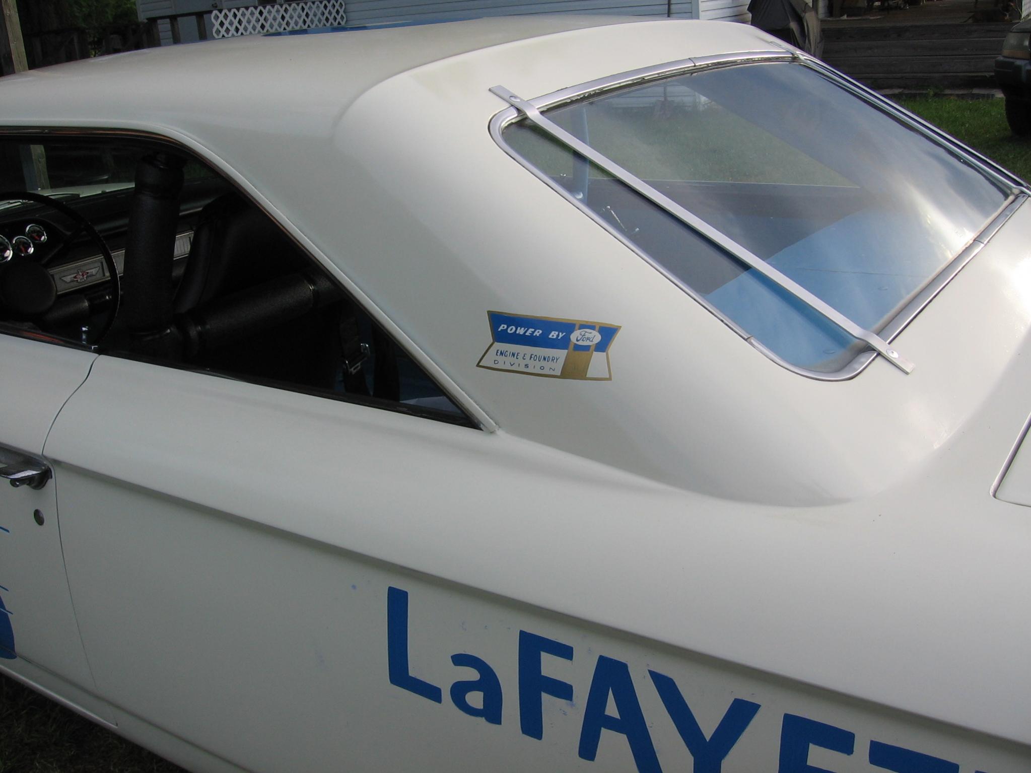

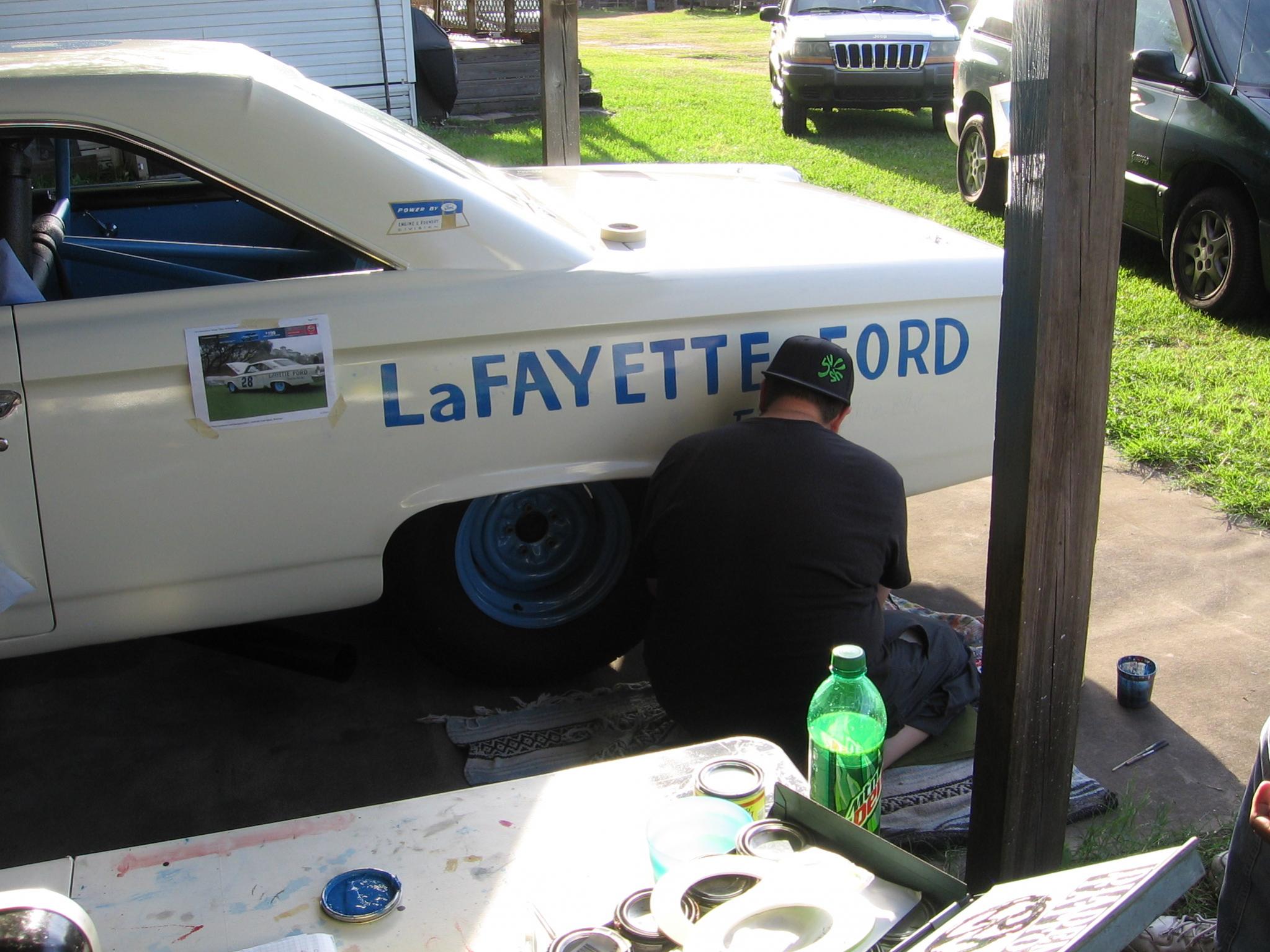

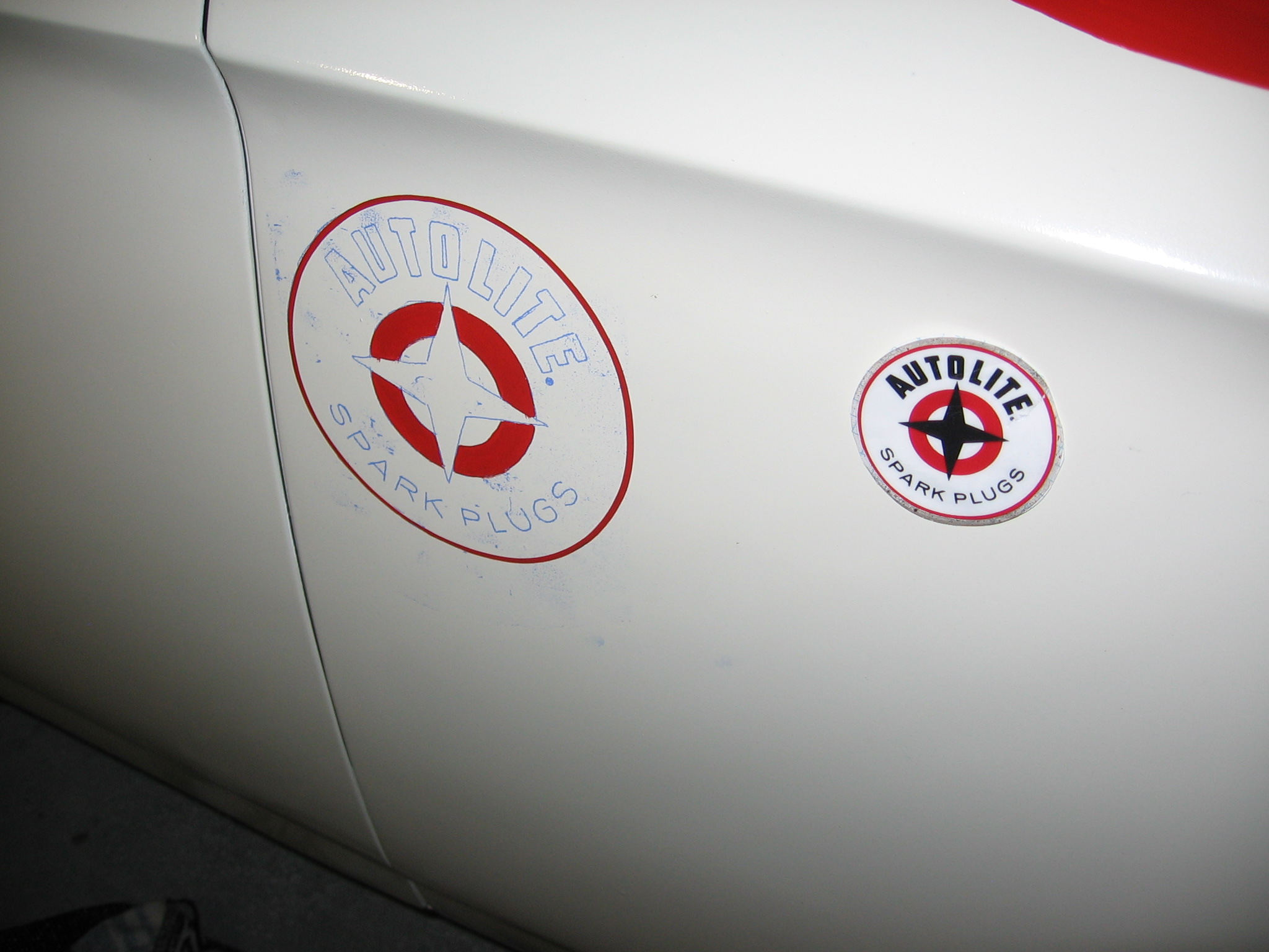

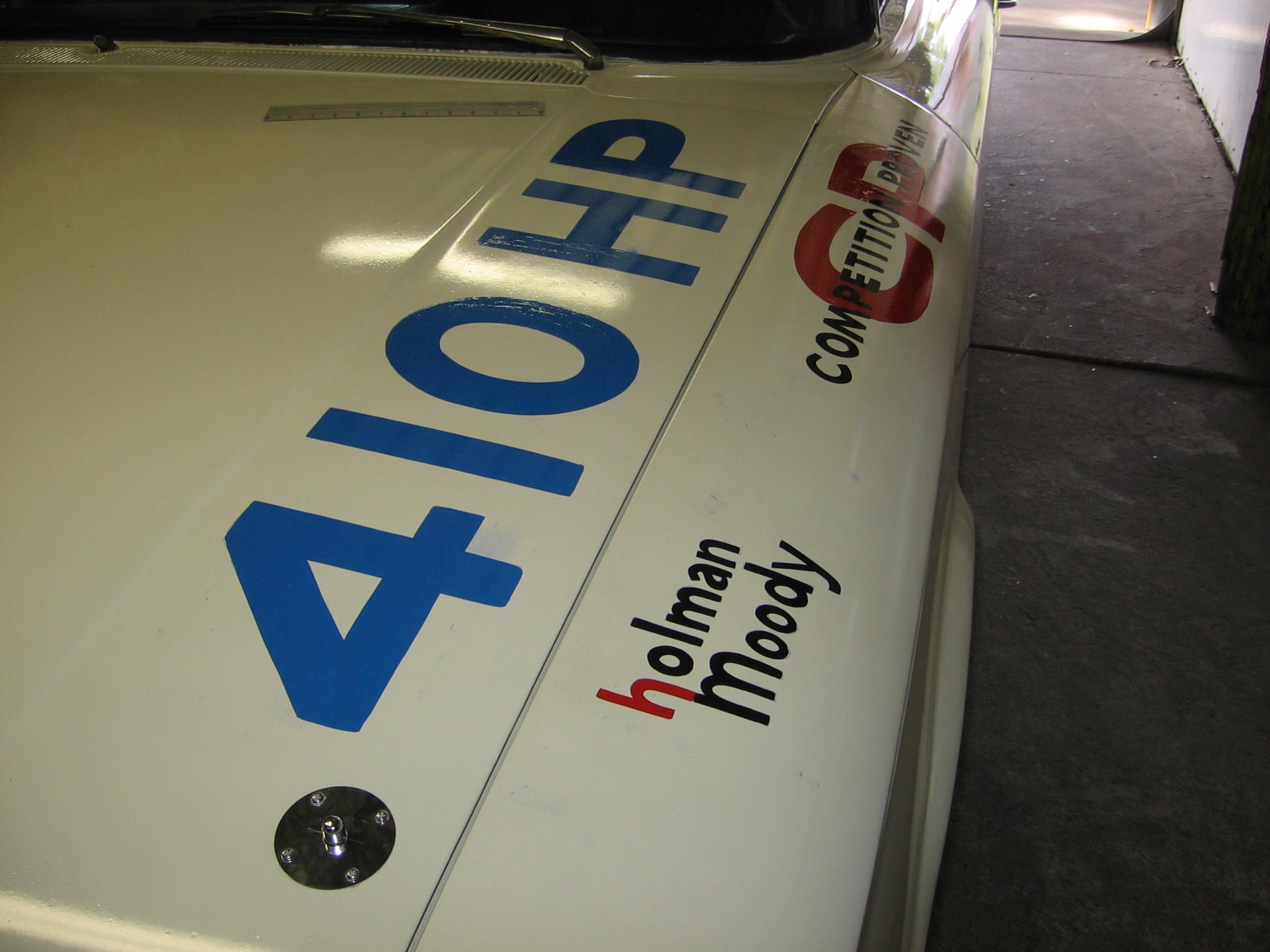

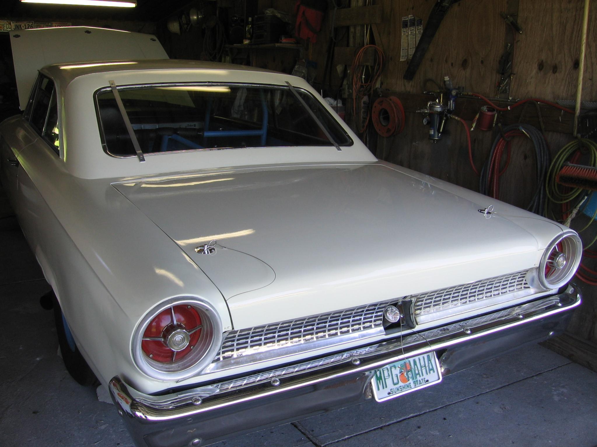

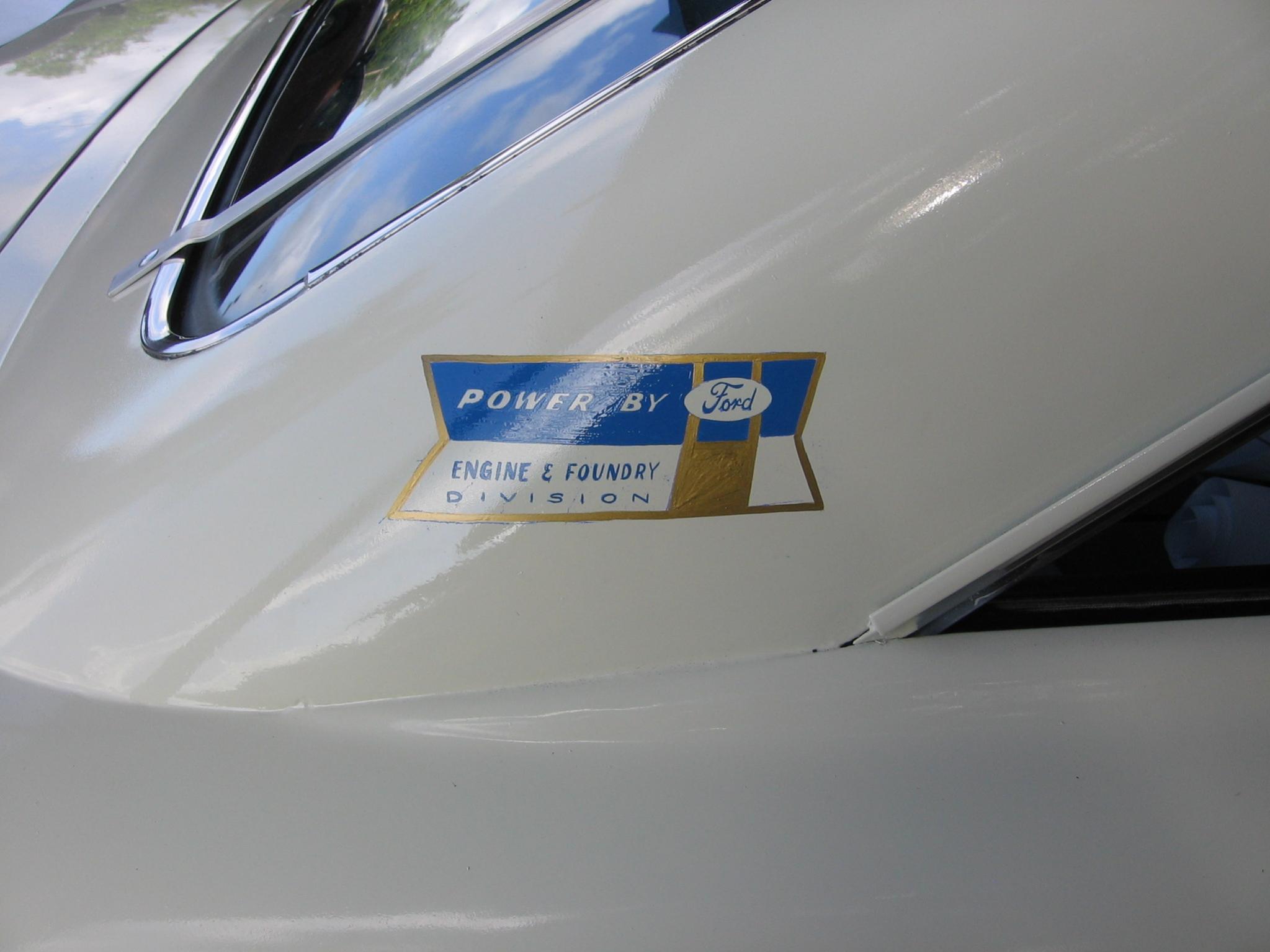

    Well it was graphics weekend this weekend.
    Thought I would share some of the pictures before and after, I will have to do this in a few strings as I have alot of pictures.
    It is complete he had 19 Hours into the whole job, 11 straight yestereday, and 8 today, his biggest issue was getting Kinkos to blow up his images for the templates, they kept telling him some BS and why does his customer want it painted versus decals stupid counter help could not understand how to increase the image sizes, in the end we got it done with what he had.
    All in all it as as close to period correct as we could get it to the original race car, only exception the rear sail panel graphic was actually a decal on the race car and the " Engineering & Foundery" crest was not visible or limited detail so i did not have him try to insert it. The colors are "One Shot" the blue is a little brighter than the orignal car they were more navy blue.
    He is a good artist "Pinstripin By Mikey" and super talented her first time out people will freak out.
