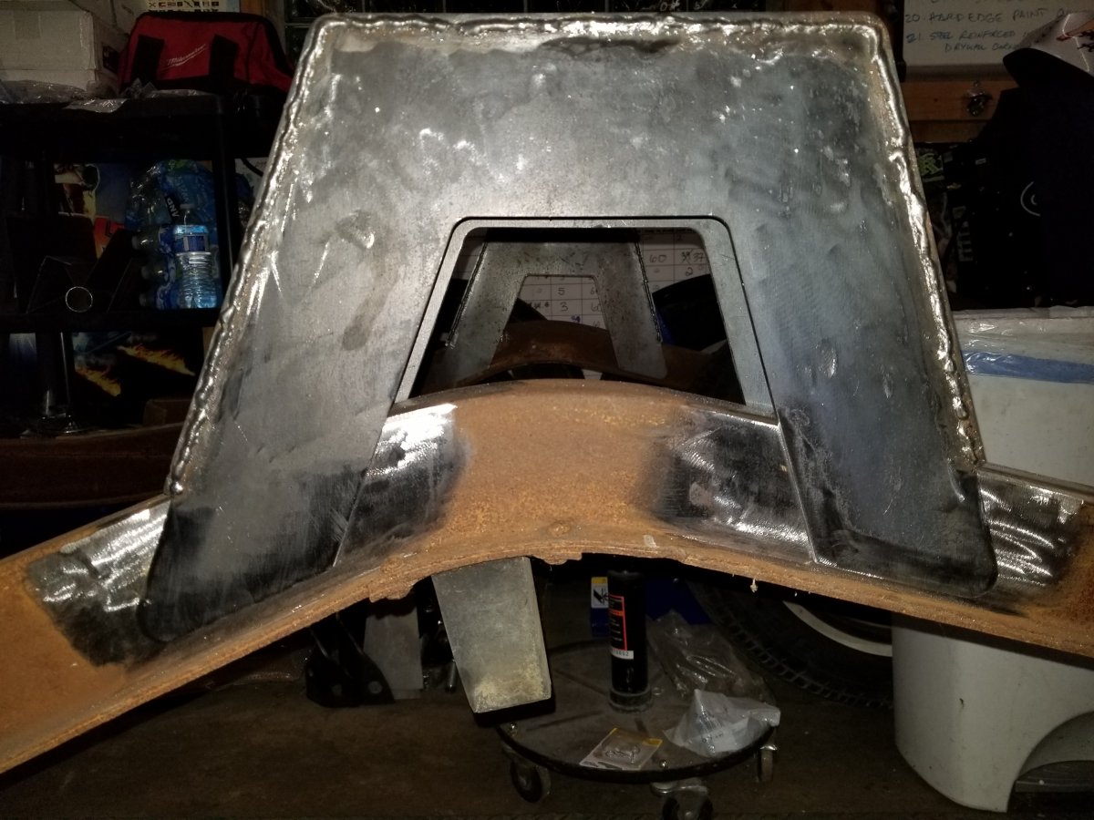

    The problem I'm having now is with the rear notches, I have pre-welded the top hat and sides together and before took the original rear end out I marked the centerline of the axle.
    Here's the question, is there a measurement off the rear edge of the frame to locate the notch? Does the notch centerline sit directly over the centerline of the rear end? It appears that the profile of the side pieces follow the geometry of the frame and I think I have it placed where it is supposed to be, but I'm just not sure. I know a lot of guys use the rear seat angle as a gauge, but since it's a roller, I don't have that luxury. Can anybody help me out with this?

    These cars have 115" wheel base. Center line of the front axle is 16" back from the center of the first set of mounting holes on the front frame rails, or roughly 131.25" from the front of the frame to the center of the rear axle.

    From the very back of the frame ,i have 38" to the center of my Gambino knotch.

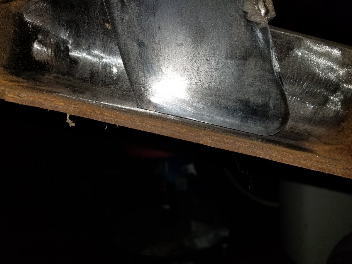

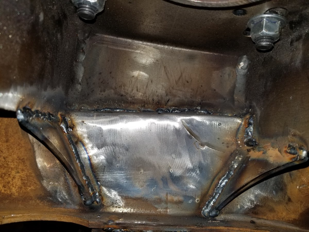

    I've got the body off my frame right now as I'm getting my frame ready to go to powder coat. I can take any measurement you need.
    That being said, your welds on your notch concern me, they look very cold. I'm not sure what your welding experience is, but maybe a bit more practice before welding on a component as important as a frame is in order.

    Thanks ****** and Dan, yea I agree and noticed that the welds looked cold as well, the inside welds created a light blueing on the top plate, but I need to turn up the voltage and slow the wire speed down perhaps, I'm planning to grind the welds on the outside down and run a new p*** along the entire outside. I welded these up first and I am still getting used to the settings on my new (MIG 135) welder. I welded in the crossmember and the front towers this weekend and upped the voltage and saw a big different in the penetration.
    I'm still a bit of novice when it comes to welding. I planned to also bring the frame to a buddy of mine who is far more skilled than I am and have him check and reinforce my welds with his TIG before I even moved the body over.
    Anyway, I guess i'm looking for confirmation of the notch, should the notch sit directly over where the old rear axle sat? The white mark in one of the pics above is the original centerline location, so if this is the case, my notch needs to move back? I'm not in front of the car, but I can measure and verify what the distance from the rear of the frame to the notch is.

  7. Get a tape measure, tape it to the front U joint and pull it back to the center line of the rear axle, now swing the tape measure up into the rear notch, center the c notch on the center line of the measurement you took from front U joint to axle center line, that should do it.

    It shouldn't be too hard to slide under your 54 and get some exact measurements but it is going to be damned close to centered on the rubber bump stop that is on the frame below the notch in the photo.

    Timmyd gave you a number from the front and I gave you one from the back. How do they match up?. If i remember correctly the factory bump stop was not directly over the rear [maybe off center 3/8" or so] ,but it wasn't the stock rear end anyway. The top of the knotch should be wide enough to give you some wiggle room.

    Thanks Guys, I welded 'em in last night, I used all the info that I received from the group and then ended up talking to Alex as well, he confirmed my placement, so I guess I'm in good shape, on to the next piece!!
