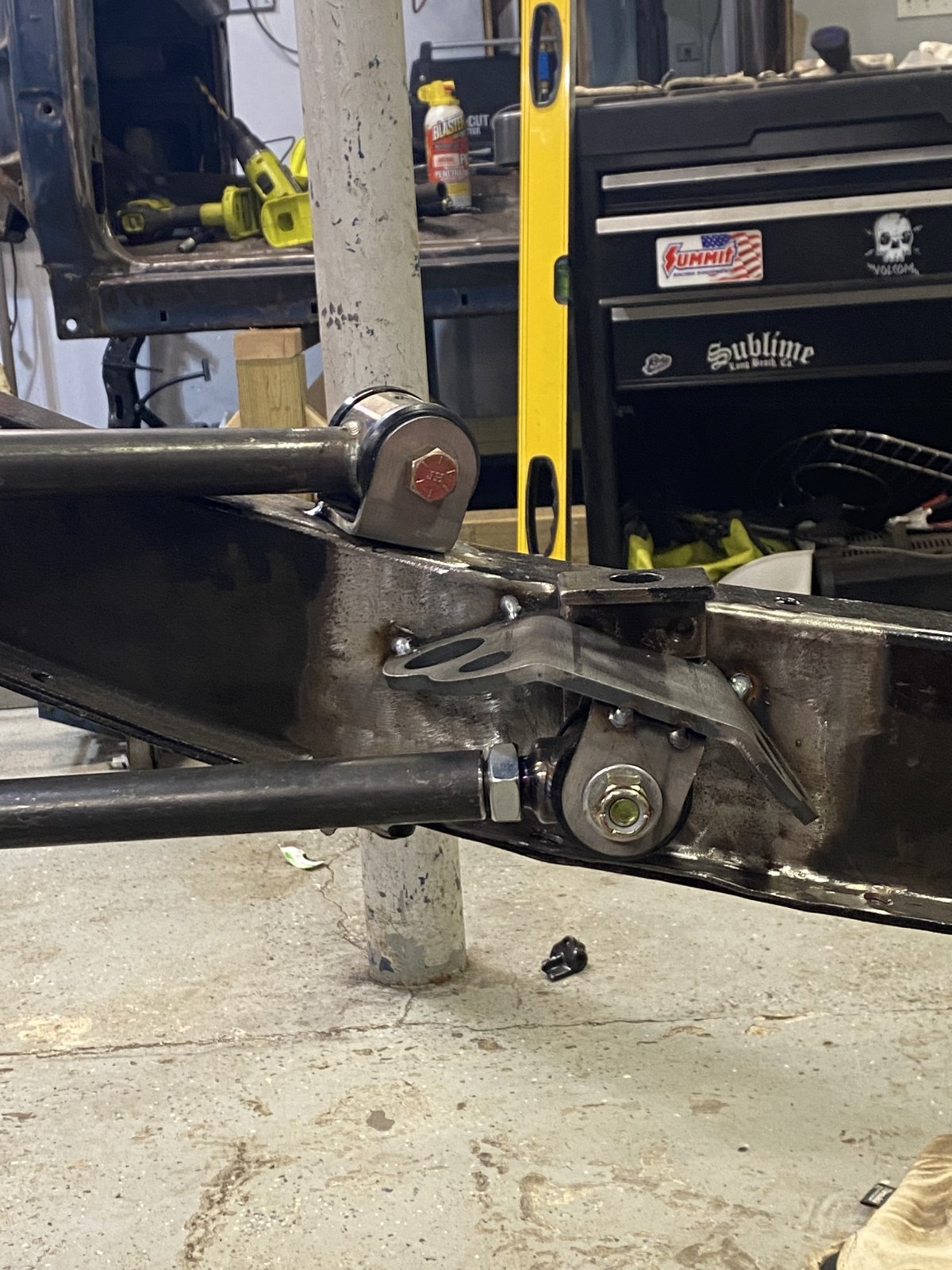

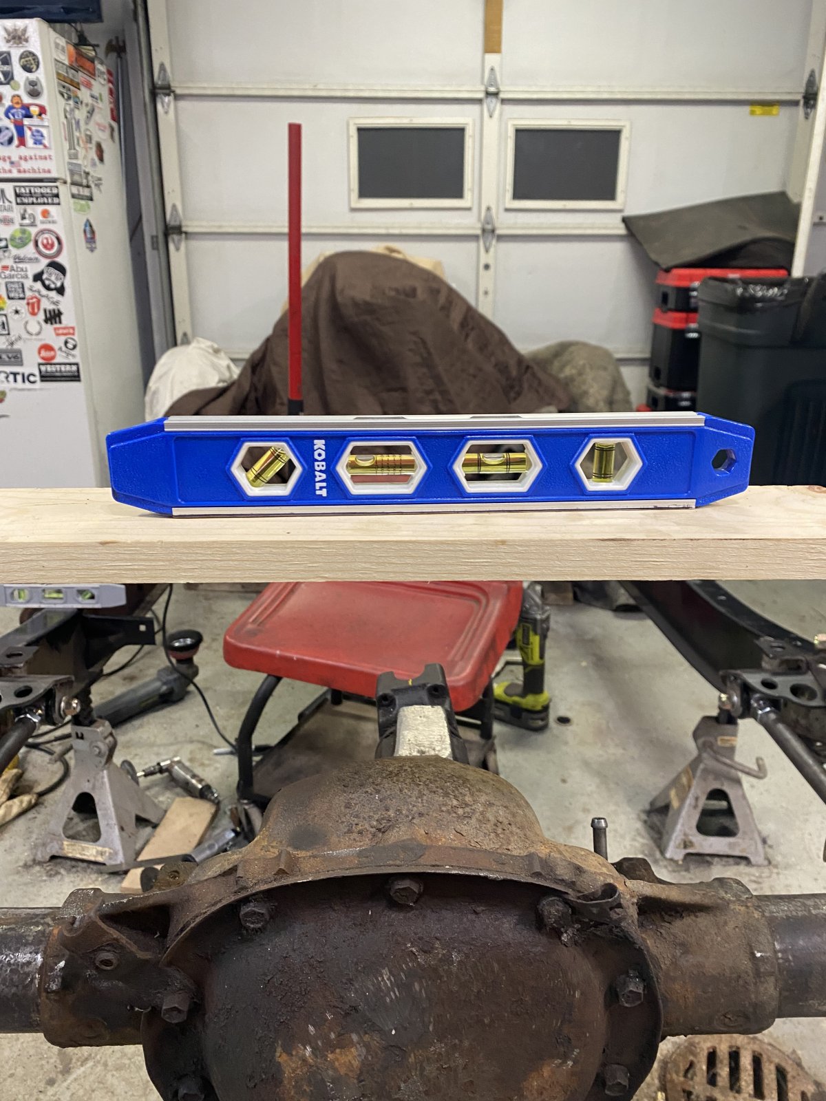

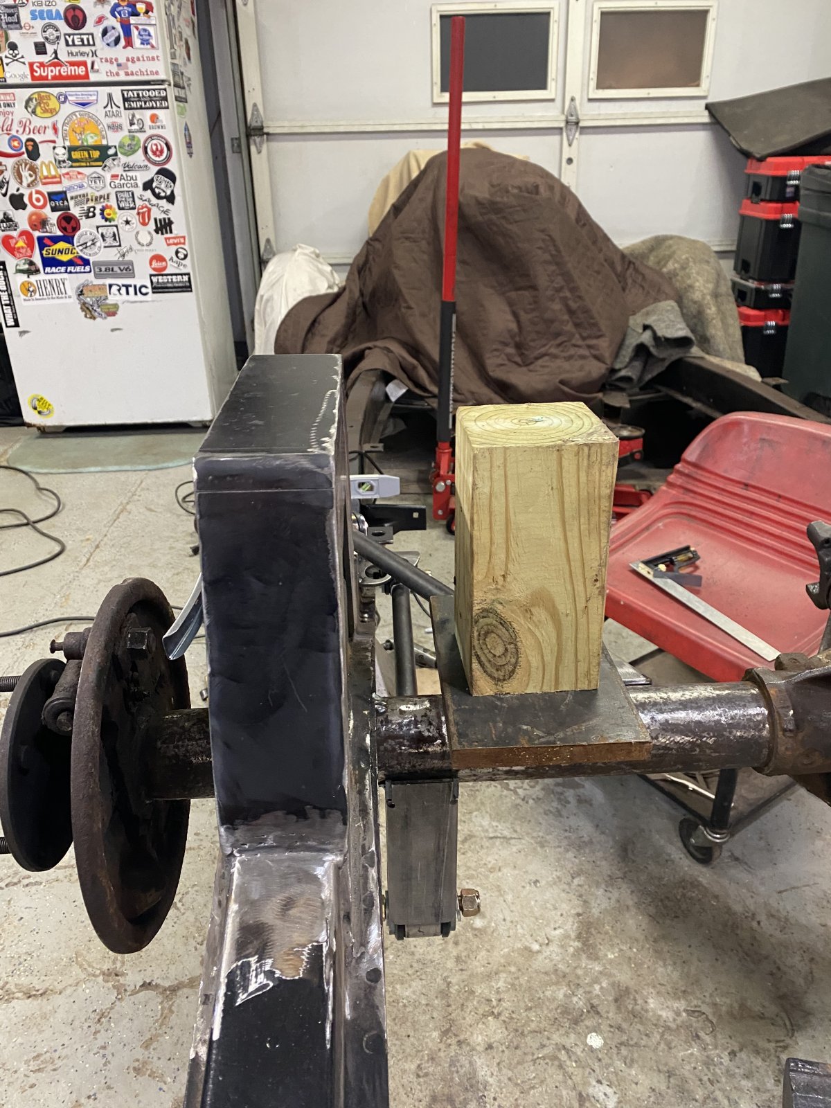

    Got the notch 90% done. Got everything for 4 link tacked in. Have to adjust lower bag mounts in morning.
    Measure 40 times, level it 40 Times, Square it 40 times. Sleep on it, level and square it 25 times, measure 55 more times. Tack it, cut it test it….pretty cool. Got to finish weld everything tomorrow.
    I swear if I woulda wrote everything down and made instructions off my notes, I’d be a thousand-dallionare one day.
    Pretty cool figuring it out and learning. here are some pics.
