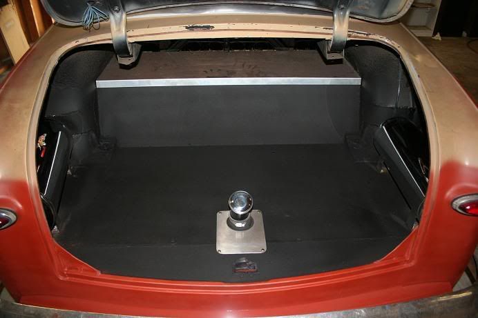

  9. I found this thread the other day. 3 years later I have finnished the inside of my trunk. Here is what I ended up doing.
    I made a removable cover so I can access the the air bags and shocks
    I also added some brackets in the old spare tire well to hold a tool box
  10. schaefer
    Joined: Aug 8, 2003
    Posts: 187
    schaefer
    I like the removable cover, nice and clean
