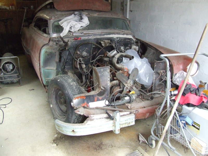

    Well over a year ago I went to look at this old custom. A friend had it in his garage for the last 17 years and had done nothing to it. The way it is, is what it was when he bought it. The 54 is really rough and I knew it so I passed on getting it. A year later I couldn't get the car off my mind so I bit the bullet and brought it home with me. We all make mistakes...
    At first glance she doesn't look too bad.
