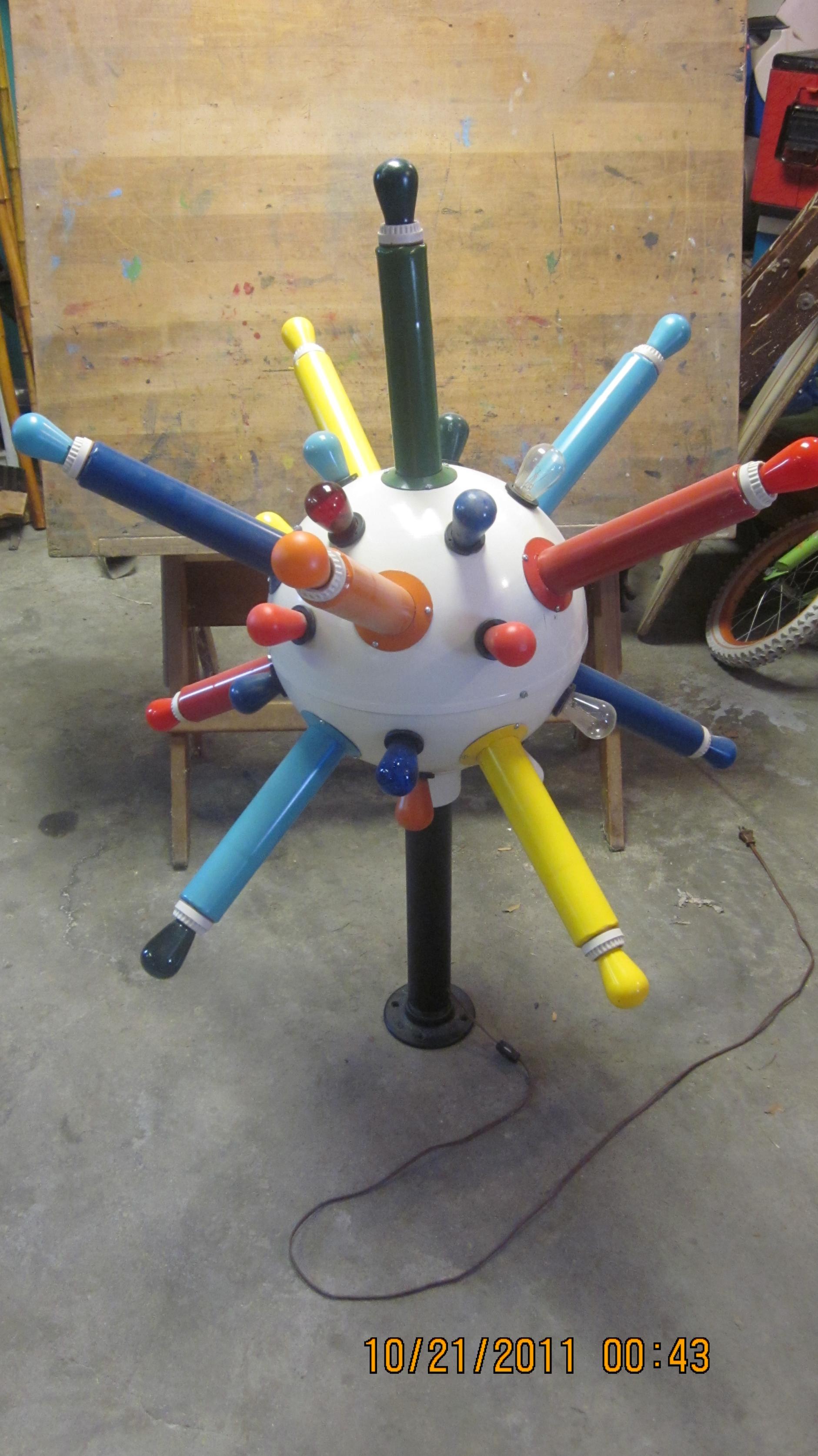

    I've got this sign for the bar I'm building in my garage. I want to build a table to put it on and I'd like the whole assembly to spin. I know it can be done but I don't know how to do it. There must be something out there that allows for this. Any clues?

    Will do my best here. At the base of the pipe you will need a non conductive disk with two brass rings of differant dia. You will connect the lite wires one each to each ring. The power supply makes contact with a brush of sorts that rides on the rings. Hope this makes sence.

    Yes, I should have been more specific. I only want the light to spin, not the table. Can I get these parts at a big box hardware store or ??? Too early to steal Christmas reindeers.

    Think horn button assembly...the plate under the wheel.....

    horn contact from a steering wheel and column

    Research a "brush block", for an electrically de-iced aircraft propeller.
    It'll give you some ideas........................Spring loaded carbon brushes, against copper or brass rings, to transfer the electricity.

    If you want the real deal: http://www.mercotac.com/
    I have used these for the telemetry cables for underwater ROV's and hardhat diving telemetry umbilicals, robots, and a bunch of art projects.

    This was originally a sign, so the best source for a rotator would be a sign supply. Most of the above suggestions would be too light duty to last.

    If you had an old alternator that would be a source of the slip-rings and brushes.

    mirror ball motors sometimes had a outlet on the side. i would geuss this would spin pretty slow. there used to be a company that made motors that would spin slow for store displays, watch's ,jewlery, that kind of thing. they had oulets on the side for lights. you could make the part inside yourself, it's called a commutator ring. brass rings or tracers mounted to phenolic, then brushes or feelers rub on the rings and transfer power. go to a place that sells disco or entertainment lighting or look on e-bay for a peice called a spinner. they have the base you need, allthough spinners spun about 50 to 60 rpm's maybe to fast, but you could get the parts out of it. hope this helps!

    Air bag clocksprings are just wound wires. Cannot spin, they'll break.
    Fab up something with a GM alternator and brushes, thats your best bet.
