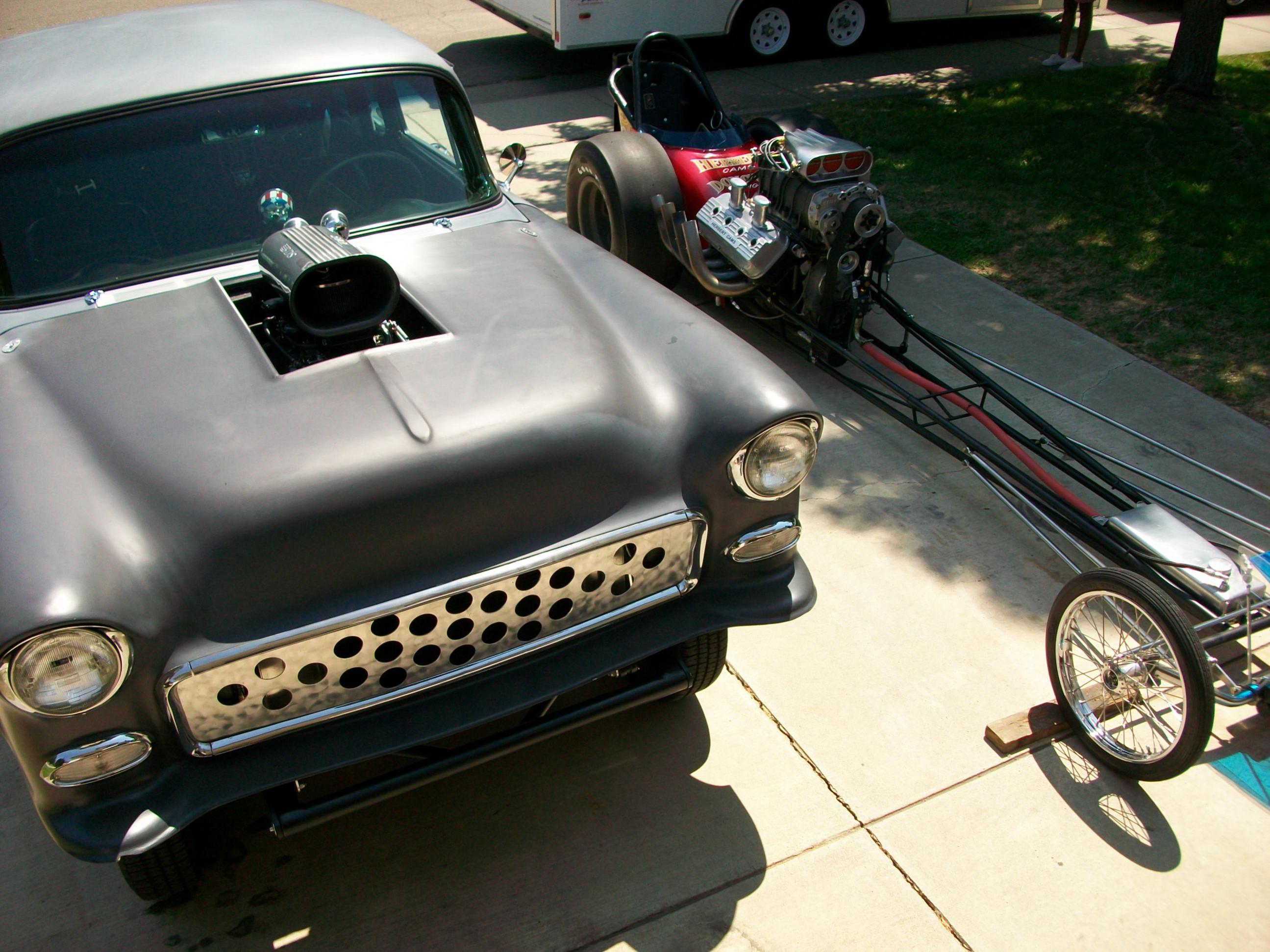

    Here is a picture of Dan's Motor. The 55 is scarey FAST.
  26. Running right or not, that's motivational!
  27. riceman
