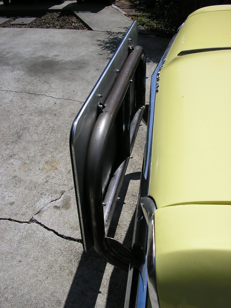

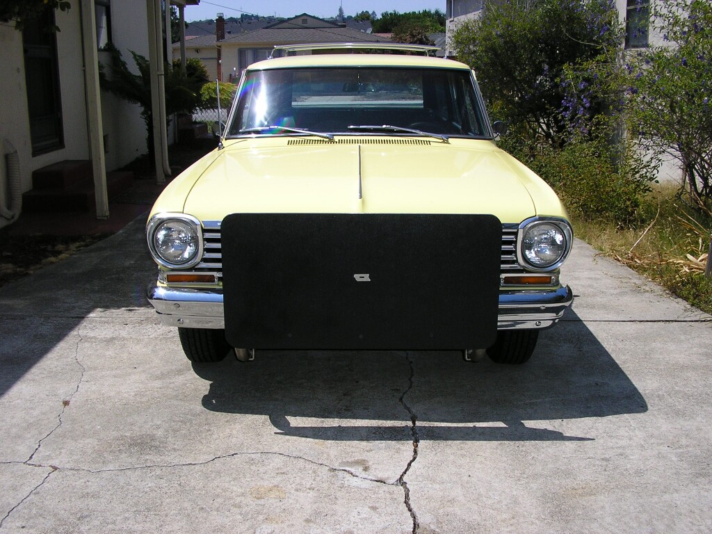

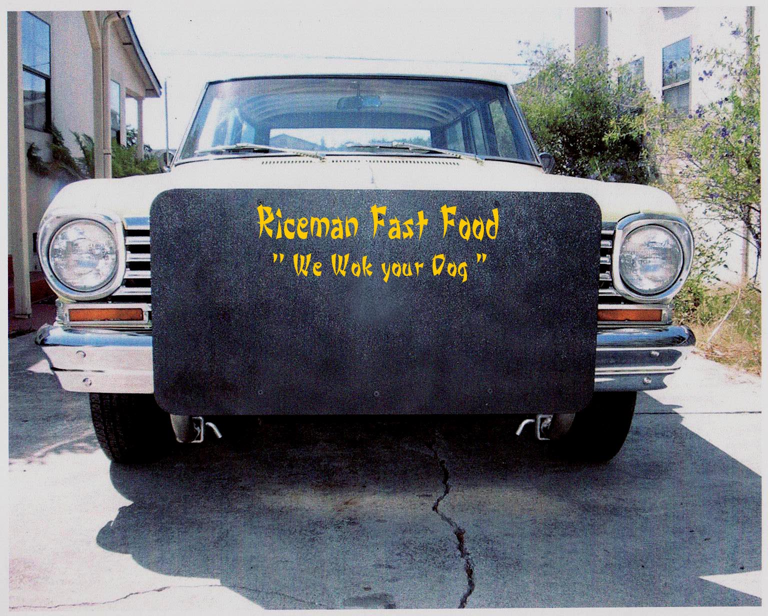

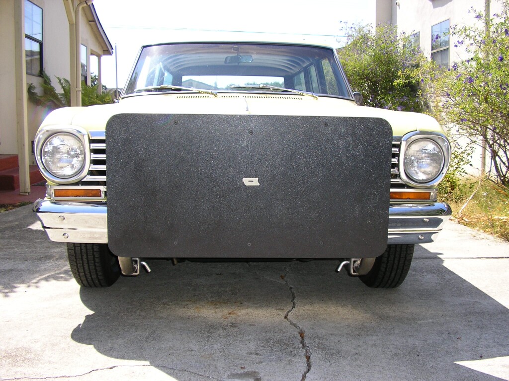

    We may have gone overboard, but there is no question this 22 x 39'' Pushboard will work. The tubing that the 1/4'' 6061-T6 aluminum plate and 1/4 ABS Plastic is mounted to is 2'' diameter x .125 wall with 6'' radius bends. This ***embly slides into 2'' x 12'' trailer hitch receiver tubes that are welded to .125 x 1 x 2 rect tubes bolted to the frame bumper brackets on my friend Mike's WIFES 63 yellow Chevy 2 Moonwagon. We'll use the center hood chrome rib for centering Brissette's grenade. I just Photoshopped the lettering on and no animals were harmed during cooking.

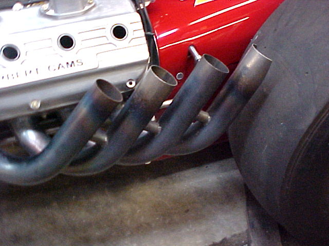

    Roger, The pusher is cool as heck! Neat job. I never noticed the way the headers are braced on your car. Pipes look pretty evenly colored. Lippy (sunburnt and happy) in Ks.:D

    Lippy, the braces are 1.000 x .058 tubing and welded up about 75% around. We left an opening for heat expansion.

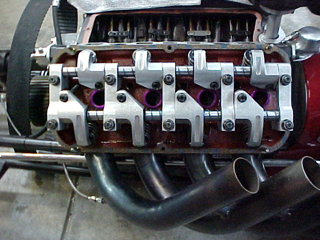

    Here are the John Dearmore built Roller Rocker Arm ***emblies. Tomorrow I have the Smith Bros. pushrods and will have the motor ready to seat everything this weekend. These things are AWESOME ! I know these seem like over kill, but to perserve all the rest is money well spent. There are 75 Cackle Cars already pre-entered for the CHRR. so hope to see you there. Eagle Field event will have to wait next year, Sorry. Thanks for hanging on to this thread.
