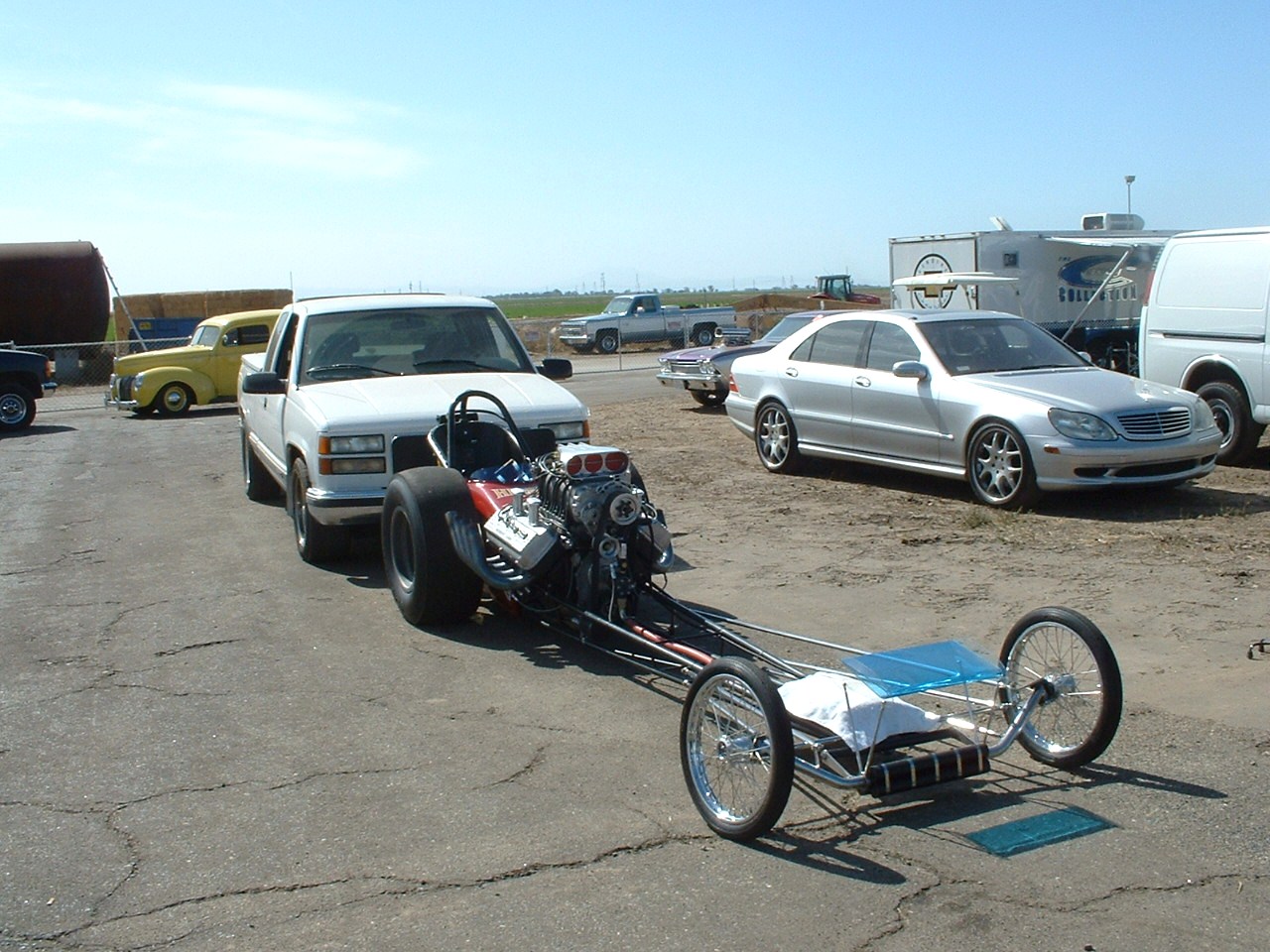

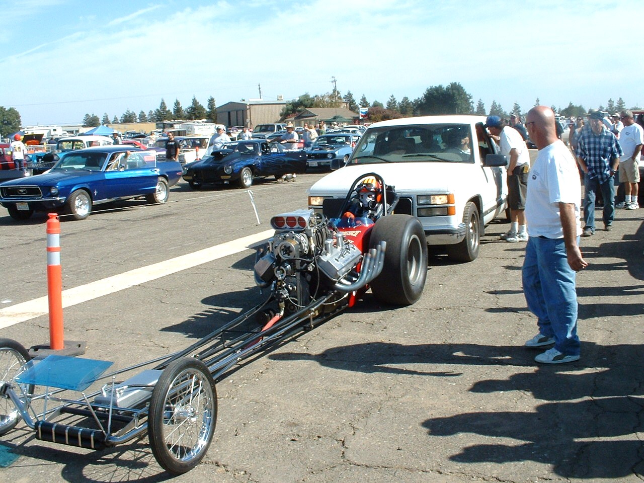

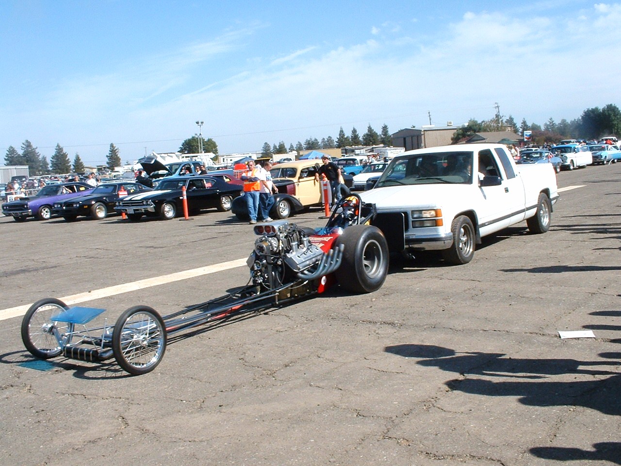

    Today was a BIG step with my Brissette & Sutherland Cackle Car. With Pops Bradford leading the way, and us youngin' learning the ROPES, here is what happen. The first try for warming up the motor never happen, because your's truly forgot to turn on the fuel. Out came the plugs, back the motor down and waited afew minutes. By then Pops was there, I put the plugs back in, backed the motor down again and my friend Ken was in the seat. Yes the motor runs better when the fuel is ON. The starter and I became user friendly. This was Ken's first ever fireup in a Top Fuel Dragster. A very special moment for two Fremont Drag Strip fence hangers. High Fives for All. The next subject was my first push start. We put the axles into the full floating axle housing, refueled, checked the tire pressures, torqued the wheels, checked the head bolt torque and adjusted the valves. What a pleasure it is to have DRE Roller Rockers on my motor. Now all I have to do is remember the firing order. Thanks again John. The moment I started to put on my driving gear, the adventure of my first fire up began. We had a team meeting and I got into the HOT SEAT. With the belts on and not even feeling the heat from 4 layers of Nomex, we pushed toward the starting line. I had Ken back down the motor again and we were ready. We waited for afew more bracket cars to run, a small clean up and Pops got the wave to push start me and there is no going back now. It is the NOW MOMENT ! Pops got up to speed, Clutch out, 70 psi Oil press, fuel on, throttle pedal down for a three count, mist out of the zoomies, ****erflys shut and mag on. The motor catches once, then twice and I drive away from Pops. Another step closer and another Nitro Challenge is toast ! Fuel off , mag off and I make the turn off. The car steered fine and the brakes worked good. No Laundry yet. We pushed back and the next goal was discussed, a burnout. Pops give his blessing if I was ready. So I let the Officials know my intentions and it was no problem. The Race Director came over, safety checked the car over and was given the go ahead. We did a blower start and I rolled forward to get the feel of the throttle and clutch pedals. OPPS, KILLED THE MOTOR , not enough throttle. We backed up, backed the motor down, hooked up the starter again. We got the signal to fire up, I rolled forward with more throttle, Got into the water and got a wisp of smoke and the motor was too lean. The motor popped backed to the blower and I shut it off. Tomorrow is damage inspection. Thanks to all the Standard 1320 members for their support, Jet Car Bob, Denny Forsberg, Potvin Doug, and a special guest apperance by Geri Tarvin. Thank you for a very memoriable day POPS !

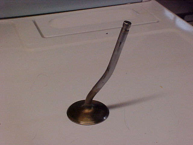

    Damage Report :
    Popped thru the blower and the rotors are tweaked, Bent # 8 intake valve and cracked the guide. Spring and retainer look good but needs new keepers. All other cylinders are fine, # 8 bore is fine. I pulled out the rod & piston to check for damage. The top of the piston has 5 minor marks from the valve head, bearing looks new and no signs of a twisted or damaged to the rod. I have a stock 6-71 I'll put on the motor, New intake and exhaust for # 8 and taking off the 110 pump (13 gal.) and change to a 990 pump ( 15.7 gal.)because the motor is lean and wants more fuel. Adjusts will be made. Almost no fuel in the clean drained oil. 5 blower starts and the battery pack lost 2.8 volts, so the starter problems that we were having seem to be cured. A little reflection on my first push start was 3 years ago talking with Patty Foster. The push start unfolded like he said. I didn't see anyone and I was focus one a pin point at the end of the track in my line. The only mistake I did was to try a burnout and now the challenge to have my Fueler ready and it will be for the CHRR. Thank you all.

    The subject of the wrong spool in the barrel valve has come up. I will be going to a new "K" valve set up for Nitro. It sure seem with what has been plaguing the fuel systen is it is too lean. So off comes the old style Cube shaped Barrel valve and stop playing games with a lean motor.

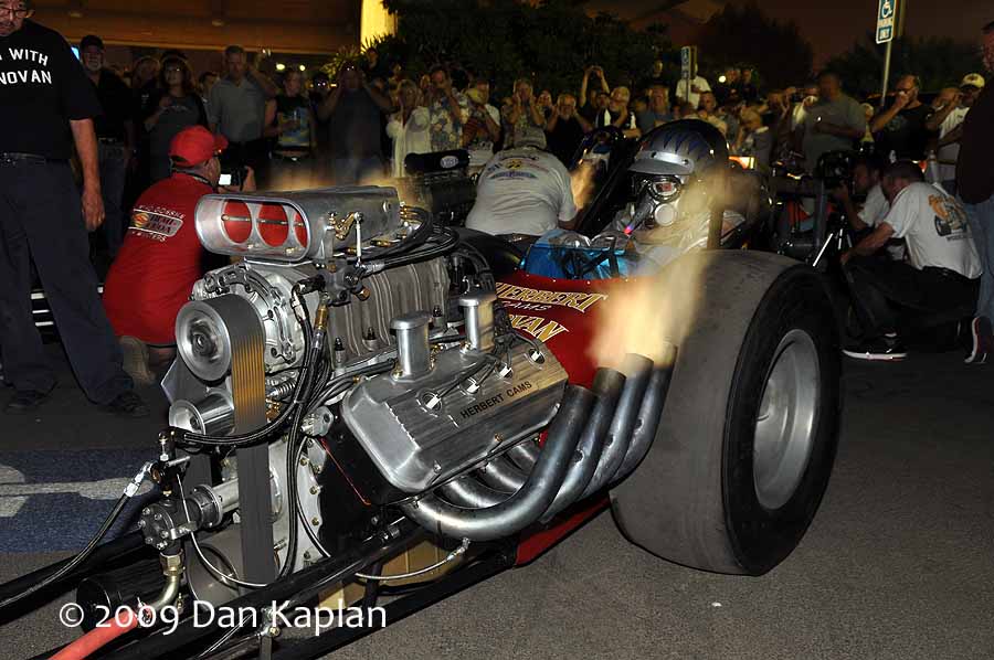

    We got to the Hotel and unloaded. The crowd was already starting to build. Julie, Ken, Nadine, Rich and I all had our " WIN WITH DONOVAN" shirts on and were ready to have some fun. Then THE MAN showed up, Jim Brissette. My heart was pounding ! I wish the Fueler's first driver could have been here, Wild Bill Alexander, but he is on the mend and couldn't attend. Up steps Paul Sutherland with all his driving gear and the "MASK" from the Old Timer Gang. I missed getting a picture of Jim, Paul and myself with the car together. I hope someone got one. We were given the 5 minute to fire up and Paul got in. 44 years have gone by and here I stand next to Jim Brissette and Paul Sutherland together again ready to fire up my recreated Berzerko Bomb. On October 6, 1965 was the day of the 219 MPH p***. I am shaking. I grabbed the wrench and backed the motor off, Mag off, Fuel off and on goes the starter. I tighened up the starter and spin it up for oil pressure. We are good. Steve Gibbs gives me the ''Fire in the Hole", I give it a good squirt of alcohol, ****erflys closed, tighten the starter up, fuel on and hit the starter. I gave Paul the signal to hit the mag. The motor catches, I am bleeding more alcohol till I here the Nitro come up. We are running ! Off comes the starter and oil pressure was good. Paul's red nose was lit and so were all the holes. I let her get some heat and the flames were coming up. I felt the heads and I stepped in front and brought the idle up. Man it was THUMPIN ! I felt the heads again, and racked the motor afew times. I checked the fuel in the tank and it was getting low and the shut off the fuel. The Brissette Bomb fell silent. THIS WAS SO *****IN ! I COULDN'T HELP MYSELF, I WAS CRYING and went over and gave Julie a long hug and a kiss. With Jim, Paul, great friends Ken & Nadine Riley and my Julie next to me, this was 5 minutes of my life I will never forget.
