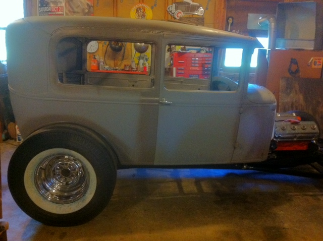

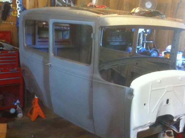

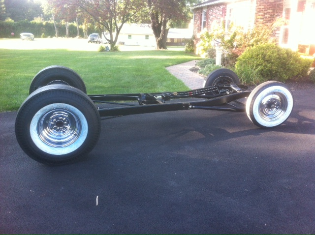

    Well have my roller finished. Body is on stands and Dodge blower motor mocked up. sedan1.jpg sedan2.jpg sedan3.jpg sedan4.jpg

    Posts: 5,214
    roseville carl
    only thing better would have been a blown Flattie............ cool

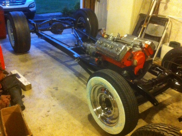

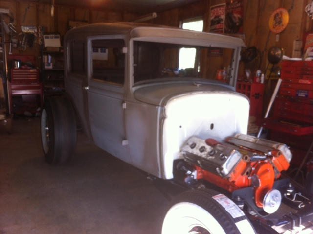

    Put the Dodge hemi with Muncie in ch***is. My friend John and I put the body on today. Watch out tudor I got the bug now! Yes there is a chop in the future 5 or 6 inches chassis with engine.png body on2.png body on 3.png

  17. manyolcars
    Joined: Mar 30, 2001
    Posts: 9,609
    manyolcars
    you dont have enough frame. I have a 392 in a 47 Mercury and it has broken the shock mounts and the radius rods and it steers to the right when I gas it and you need more strength

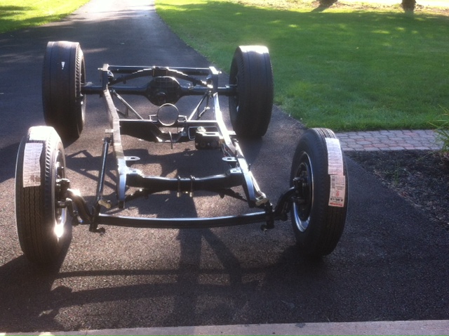

  22. Hmmm . . . frame strength - good points???
    FYI: I can't tell if your frame is boxed or not - appears to be an original Model A frame with a few modifications. There isn't any sort of X-member in the middle to strengthen it and prevent twisting. You'll probably get away with it if you don't flog it, do hard launches, etc (at least for awhile) - but it will twist quite a bit if you apply the power of that blown motor to it and hook it up. The body will take a lot of abuse from the twisting - corners of the doors, etc. You might want to give it a few test runs before you paint the body - just to see how things shake out. I know me - ideas related to 'just baby it' don't seem to last very long . . .:eek:
    Just keep an eye on it - you may find that you'll need a stronger frame like a 32, boxed and with an X-member setup installed.

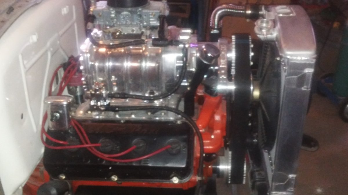

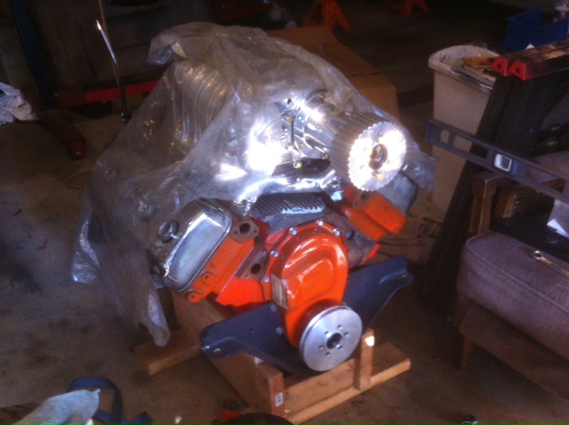

    Well finally getting back to finishing my 30 sedan with a blown 270 dodge hemi.
    Working on getting the motor together. Had to finish my wife's 65 stang convert first. she been waiting 2 years for it. You know that saying happy wife happy life!
    Keep you updated on the sedan build.

    Did you beef up the frame to handle the torque that mill will dish out?

    The frame is a custom made boxed frame. Hopefully the guy that built it knew what he was doing.
    As for the motor, don't think that little Dodge will put out much torque, and it more show than go.
