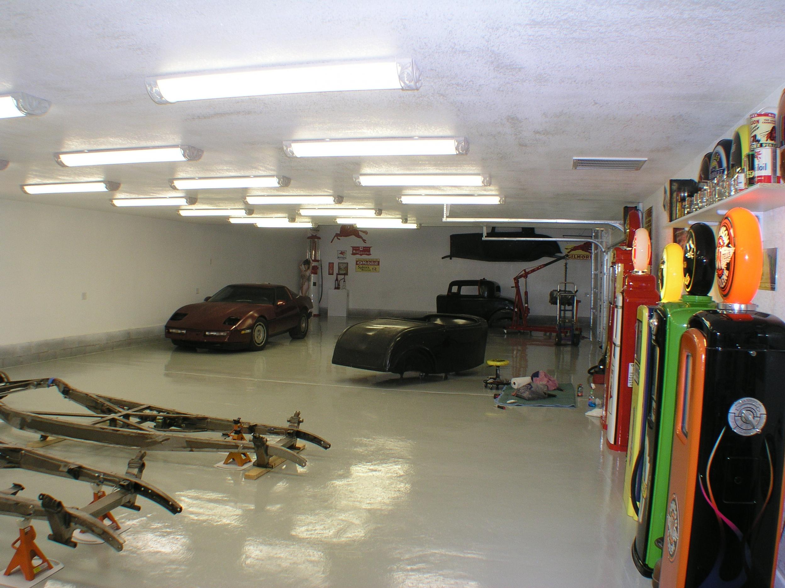

    i used groits garage floor paint. it has been down 15 years, yes 15 years and still looks good. here are a couple of pics from 2 or 3 years ago but it still looks the same. the pics were from one of my yearly moppings. it has held up to brake fuid, carb cleaner, and every other thing i can throw at it. i'd use it again in a heartbeat.
