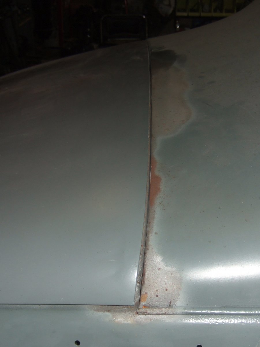

    I agree. I just need to get my head into it. I have some pix in the next post showing my hood fit. The "chrome" is not satin really; it is pretty shiney, but more like good clear coat. That piece is going to be redone because it has some flaws.
  2. joel
    Joined: Oct 10, 2009
    Posts: 2,731

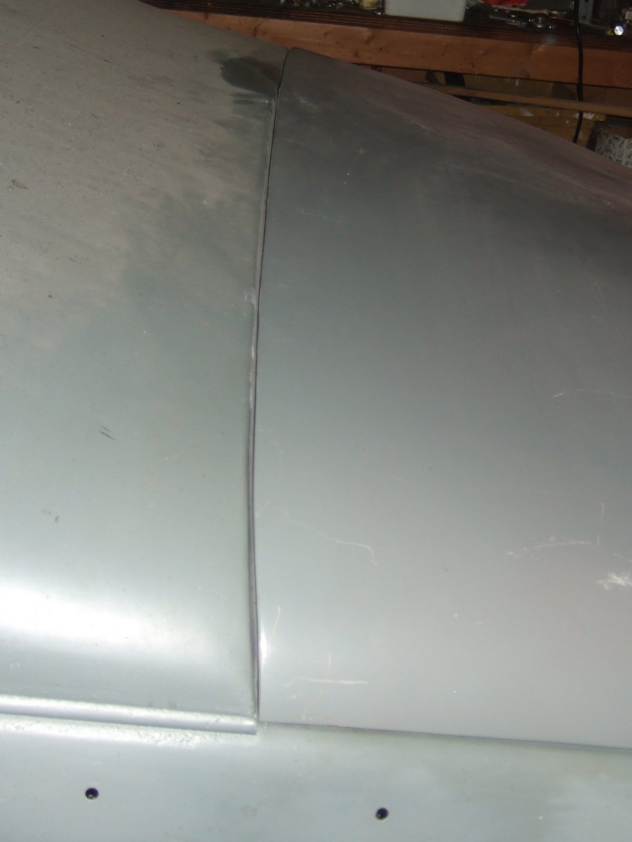

    joel

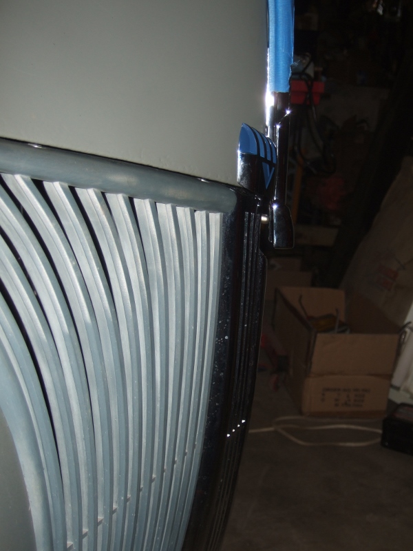

    Here are some shots of the hood gaps (1/4"); I want to move it toward the firewall about 1/8 ", but I haven't decided how yet.
    DSCF9728 (800x600).jpg DSCF9731 (800x600).jpg DSCF9739 (600x800).jpg DSCF9740 (600x800).jpg DSCF9732 (800x600).jpg
    Maybe you can see how much the nose ( V8 emblems) sticks out beyond the center grille section. Moving the hood won't fix all of that, but it's the right direction.

    Hoods on post 1936 cars are difficult, in that there are multiple parameters to deal with (all at once!)
    I adjusted some '32 hoods/shells at my shop, cars and commercials, dealing with what seemed to be 'terminal gaposis' in most cases.
    '39s and '40s took the most time...adjustments usually meant torchwork.
  4. The 39 guy
    Joined: Nov 5, 2010
    Posts: 3,772
    The 39 guy
    I think the hood actually looks pretty good at the front. I elongated the holes in the cowl to move my hood back. But you have to be careful as the hood tends to hit the top of the cowl when you are opening it if you move it too far back. Also remember that you will be adding paint to that sheet metal which changes fitment more than you might think. I think you are pretty close now!

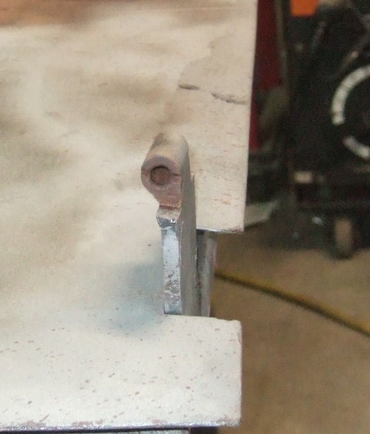

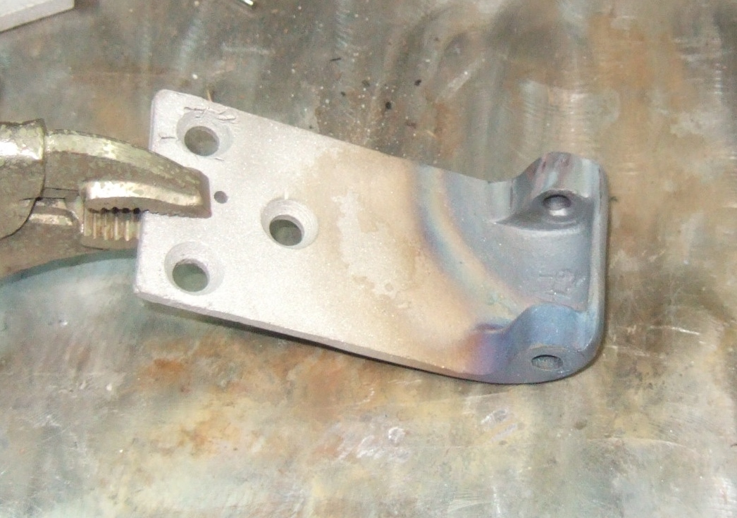

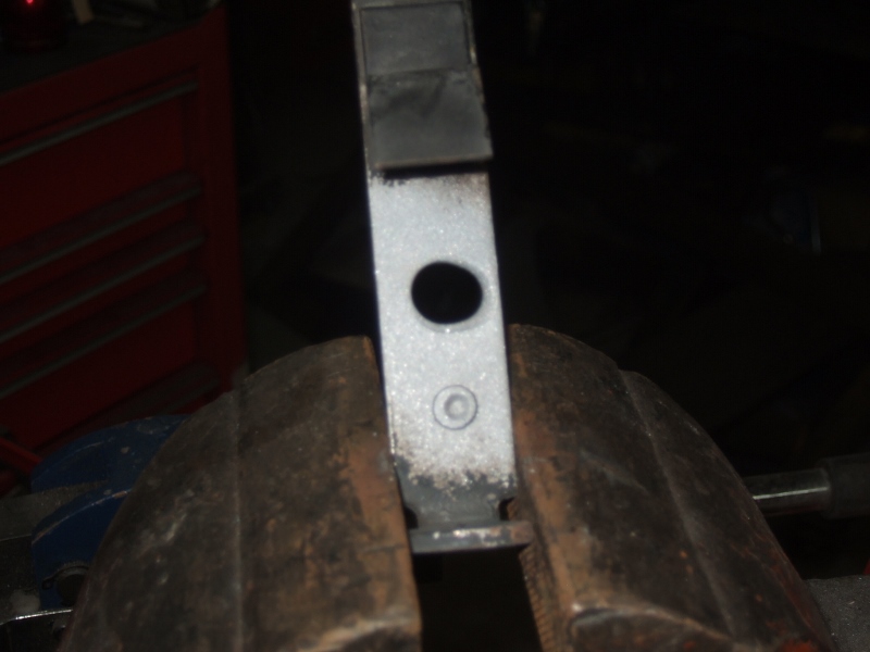

    I changed direction and went to the deck lid alignment. My original hinges were a little sloppy, so I made new oversize pins and painted the hinges before installing them. here are some pix of the fit.
    I added a shim to this side to drop the corner. Things are going well.
    After I installed the trunk lid supports and fit and adjusted the latch/handle ***y. I removed the supports to paint and install new springs I got from Macs. I figured on some wear and this is what I found.
    Part of the fix.
    The pivot pin.
    Now I'm deciding whether to build it up with weld or make new ones.

    I welded the hole and the pin.
    DSCF9752.JPG DSCF9753.JPG Sorry for the blurry pic.
    I need to work on close ups for detail.
    This morning I installed the rebuilt trunk supports. 39 guy called it; the replacement springs wouldn't hold up the trunk lid. Next is plan B

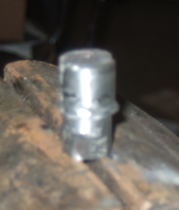

    Rather than reworking the spring, I was looking at making new pins and bushings with a shoulder ,which would provide more bearing area for the pin. I was also planning to "clock " the spring slot about another 25/30 deg ccw. I welded the pins this time. "Great minds think a like"

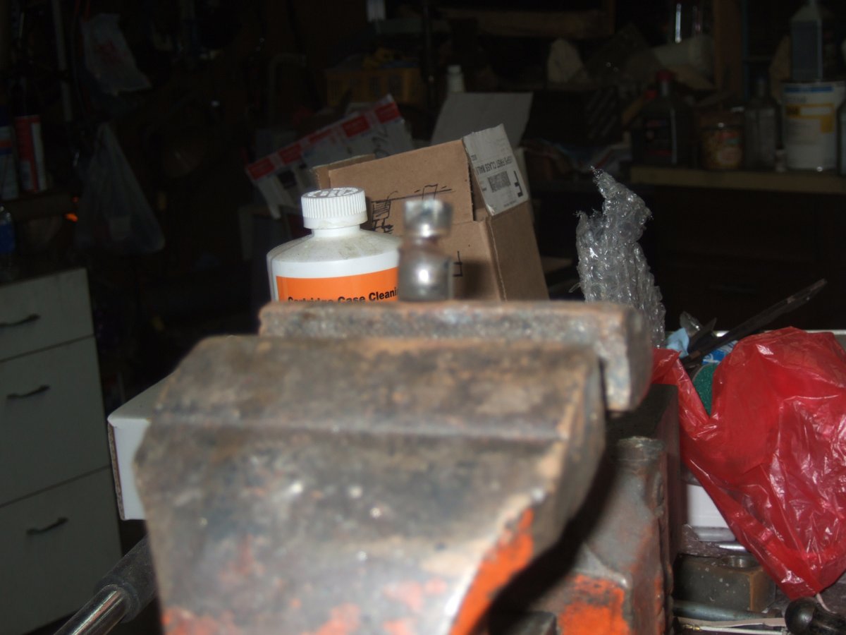

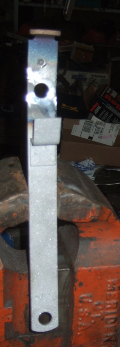

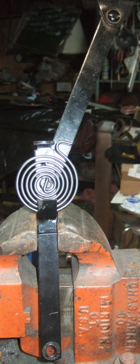

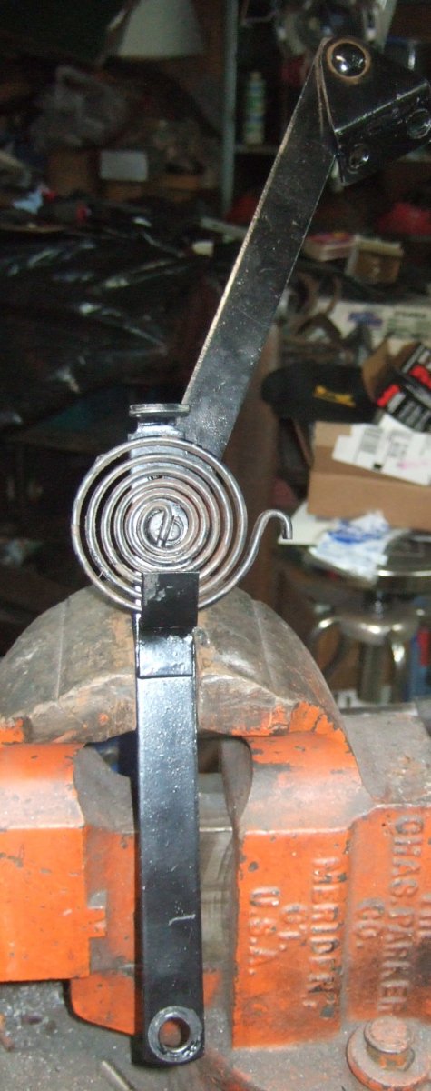

    I found my problem and the pix explain
    DSCF9759.JPG This is the new spring. below is the old spring. Notice the difference in clocking of the end loop with the center slot in the same position.
    DSCF9760.JPG The old spring has more preload and thus is already as 42 Merc described. I installed the old one on one side and the trunk lid stood up like a wedding d**k. Soon as the paint dries, I'm done with the trunk fit.
    34toddster likes this.

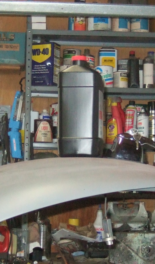

    I'm super happy with the reworked lid supports. DSCF9761 (800x600).jpg DSCF9762 (800x600).jpg DSCF9763.JPG The last pic is a gal. of oil extra load. No problem.

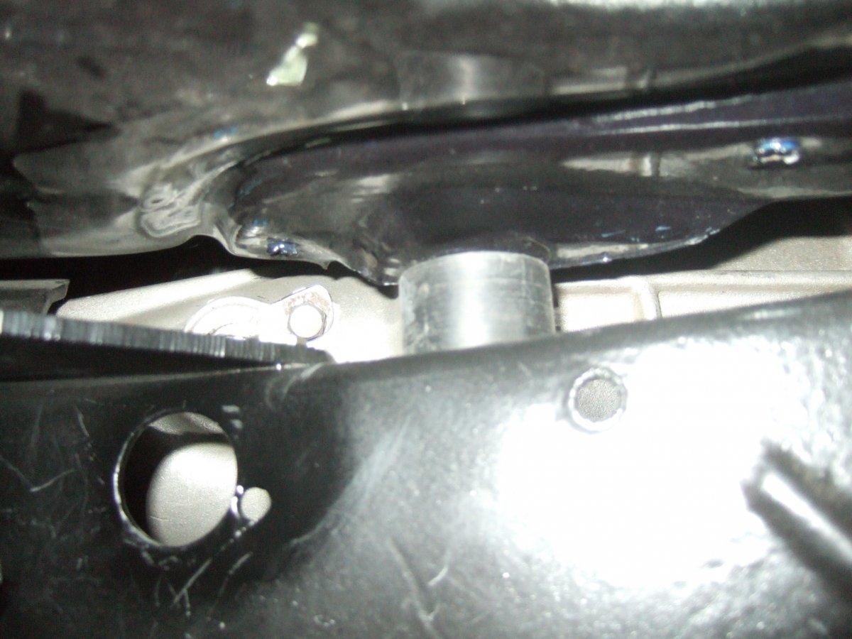

    I went back to aligning the hood and it fits the cowl pretty good . The rest of the sheet metal needs to move around some more. I decided to hang the doors in case i needed to re-shim the body at the B pillars. It took about 5 hrs to get the pins out of the hinges with a hinge pin press. When I checked the holes for wear some needed work and I couldn't find any oversize pins from the normal suppliers. I shrunk the worn holes with heat and a hammer. it worked pretty well and I resized the holes with a reamer.
    DSCF9764.JPG Before the rework. It's hard to see, but the hole is stretched vertically. DSCF9765 (600x800).jpg Door is fit and latched. It took half a day to clean the latch and 2 days to find them both. DSCF9766.JPG
    This is the left side lower and the lower boss was probably the worst worn ( upper one in the picture).
    One thing; when you do this it stretches the metal length wise also so you have to file and fit to get the hinge parts back together.

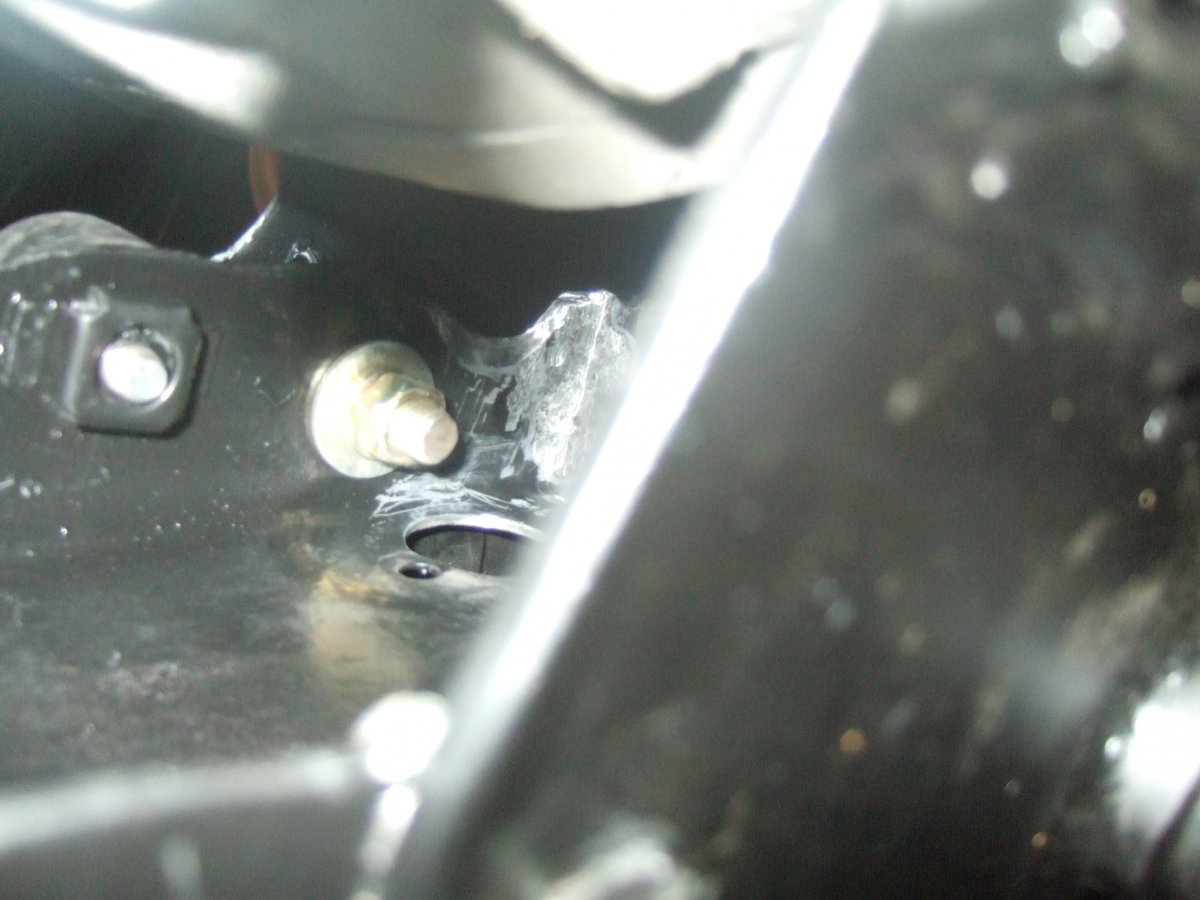

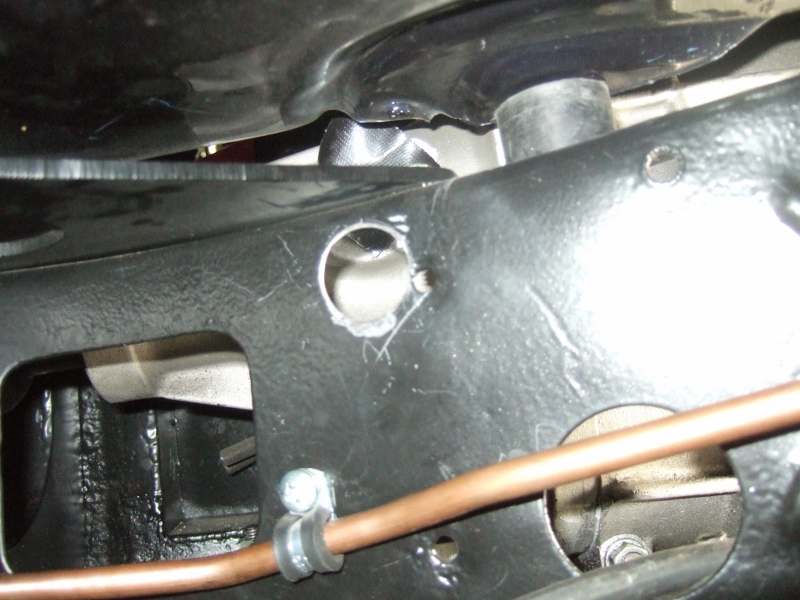

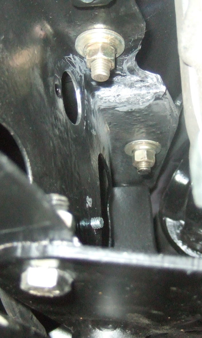

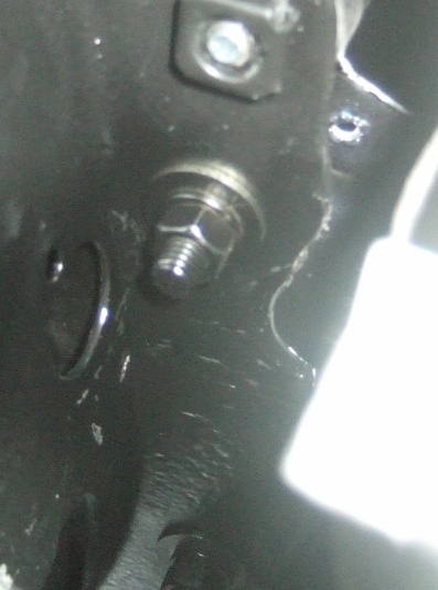

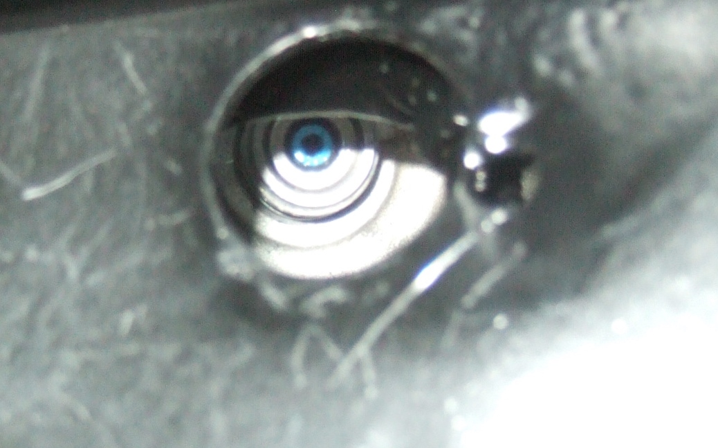

    I have a couple of things going on. I finished hanging the doors and despite my best efforts, I may have to move the metal in the cowl on the drivers side. Pic to follow.
    While looking for something, else I ran across a new speedometer cable. I tried it for fit (length) and to check That I had access from under the car. When I raised the trans mount, I overlooked this part. At first it looked like a right angle adapter might be the answer, so I called Speedometer Service Co in Milwaukee. Roger was very helpful and provided the new driven gear for the trans. To make a long story short, I wasn't able to use a 90 deg adapter. After grinding on the X rail as much as I could, there was not enough room. Plan C was always to cut a hole in the frame and loop the cable through the frame and back to the trans and since I already removed part of the frame , that's what at I did. Pix below
    1 1/16 hole to clear cable nut and the lower edge of the speedo drive hole. The upper lip of the frame and the X reenforcement plate of exactly in the way.
    Inside the frame rail with clearance effort.
    This was done with a extended shaft die grinder.
    After paint touch up.
    More to see the access restrictions. I realize this should have been and could have been fixed much easier and probably slicker with the body off; I ain't going back.
    The new 90 in. speedo cable is on its way.
