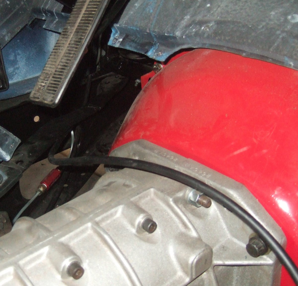

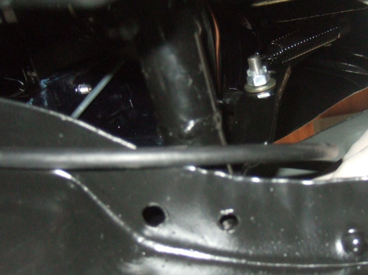

    I got the new speedo cable last week and installed it, along with some finishing touches. I added an i/8"thick rubber strip to the wood toe boards and installed the lower steering column mount. See below.
    bottom p*** side
    top
    general layout of 90 in. speedo cable
    The last 3 pix are under the floor pix DSCF9783.JPG DSCF9784.JPG DSCF9785.JPG
    It took a couple of hours to get the drivers side toe board in; the rubber made things tight, but I think it will seal well.

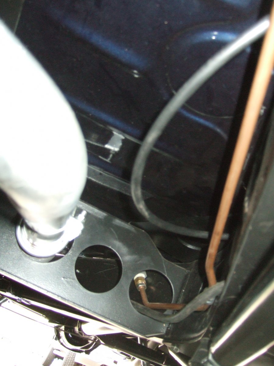

    Hey Joel what is that copper line for?
  5. joel
    Joined: Oct 10, 2009
    Posts: 2,732
    joel

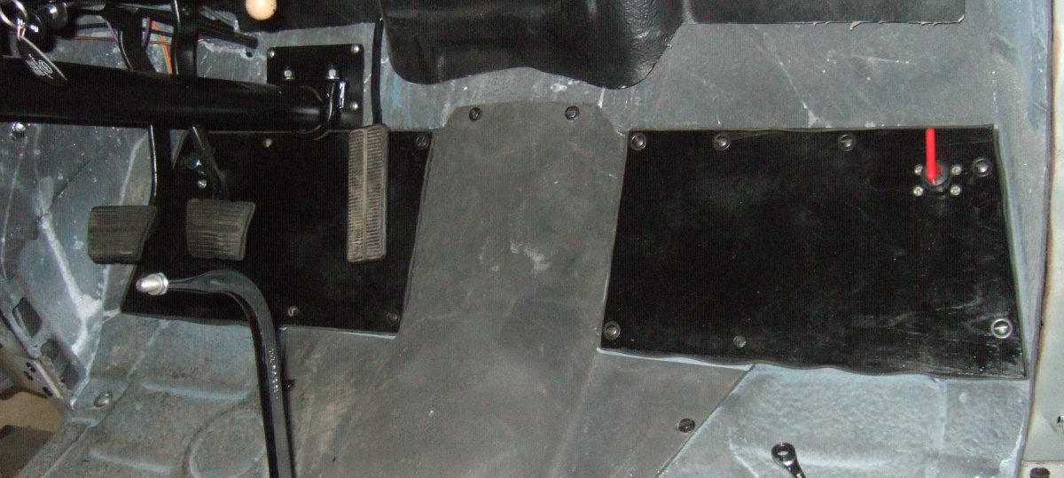

    That's gas line; it's copper plated steel. Here's a pic of the toe boards
  6. The 39 guy
    Joined: Nov 5, 2010
    Posts: 3,772
    The 39 guy
    Thanks Joel, You probably mentioned that before but I blame my old mind on forgetting that detail. I was wondering what the hole was for on that p***enger side floor panel. looks like a good place for the switch ... sort of hiding on plain site. Ingenious as usual!Looks nice all ****oned up!

    You spotted my safety switch. The plan is to run the stock type rubber floor mat, so it should blend in.I'm still messing with the front sheet metal and finishing little things when I need a break. I'd love to post something on that but I'm still looking for a solution.:confused:
  10. Bandit Billy
    Joined: Sep 16, 2014
    Posts: 15,919
    Bandit Billy
    Nice work on the car Joel! The only people that know the location of your switch though is just about everyone with internet access. Don't post your PIN. Joking around, love the car and the thread. Good luck on the remainder, and consider deleting that post.
