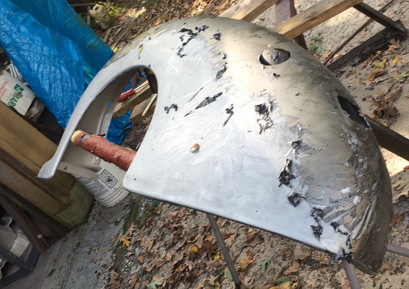

    I blasted my new LR fender and made a couple of small repairs . I mounted the fender so I could see what else might need to be done.
    IMG_0613 (800x437).jpg IMG_0614 (800x780).jpg IMG_0615 (800x441).jpg IMG_0616 (800x441).jpg
    The crack in the far right pic will get welded after I can see the shape of the bottom edge.
    By the way, the ****py blasting is due to the fact that I can't find dried silica sand for my blow through blaster any more. This means it is difficult to blast at lower pressure (60psig) that allows less distortion.

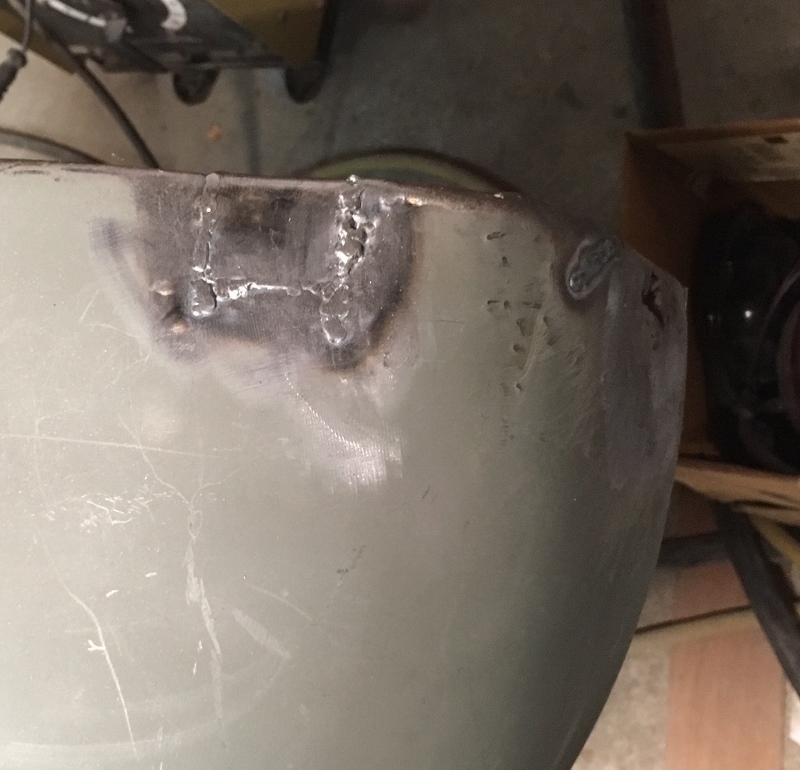

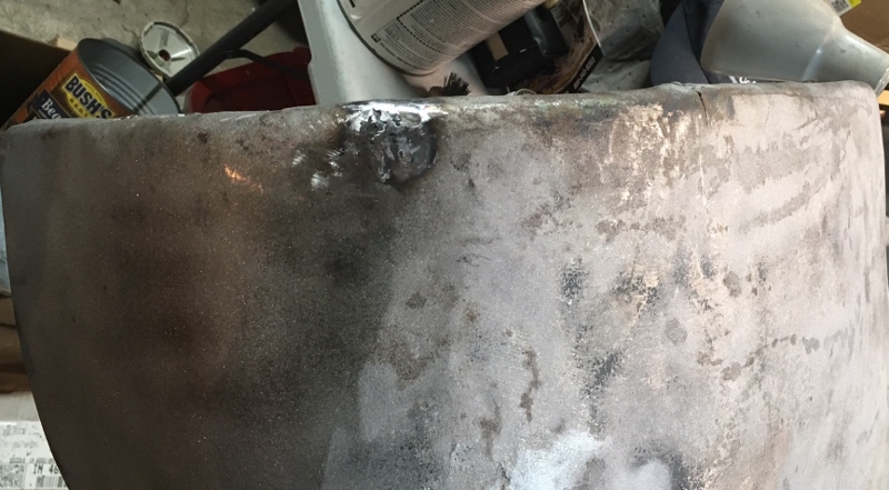

    joel
    Here is a quick update. I'm catching up on the "new" rear fenders. The left is close and I switched to the right side rear to weld up some cracks and a couple of small patches.
    IMG_0693.JPG IMG_0690 (800x515).jpg IMG_0691 (577x714).jpg IMG_0692 (800x770).jpg
    The cutout in the 2nd pic was required because a crack repair was done by brazing and it broke again. The rust through in the top pic was covered by a glob of lead on a not properly tinned surface. After I get the rear fenders in DP, I'm back to the body. BTW the delay was due to my 41 pickup. ;)

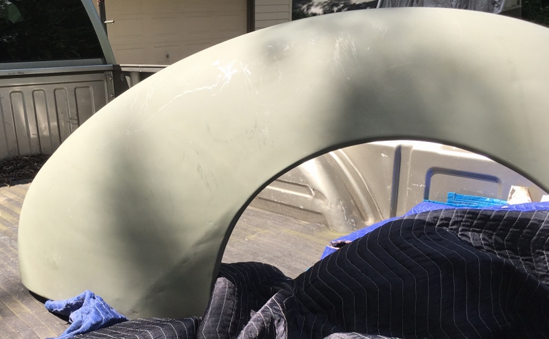

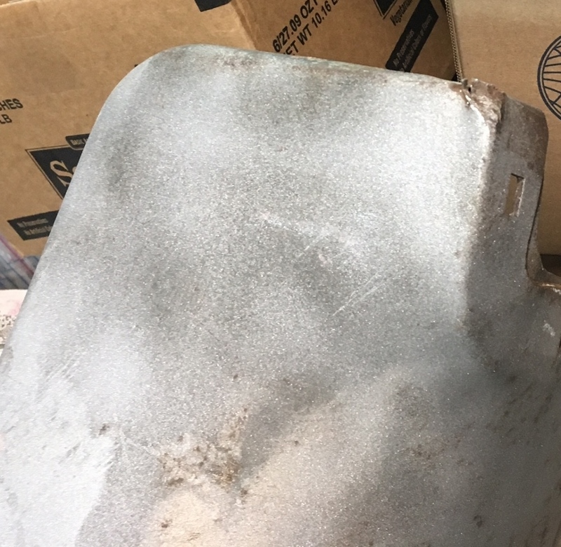

    I got the new fenders from Carpenter early this week and called them to find out about the paint on them. I was told I could wipe it off with Laquer thinner, but I ended up with paint stripper and a razor blade. Then I finished the whole outer surface with a stripping disk . The weather is supposed to be good tomorrow and I should get the DP on them
