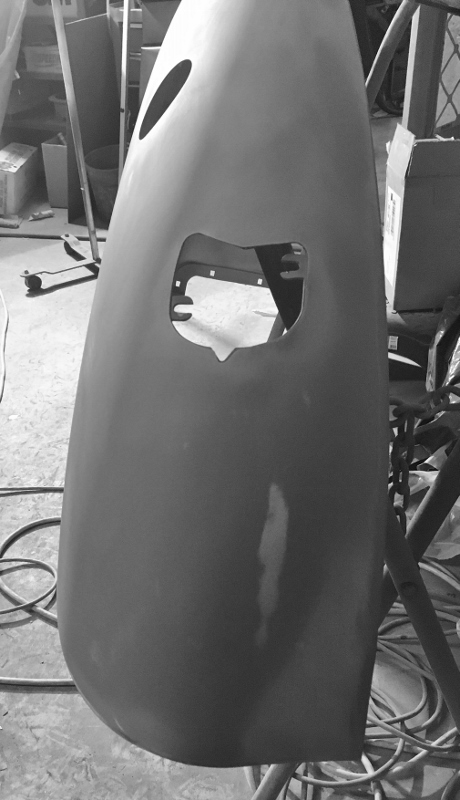

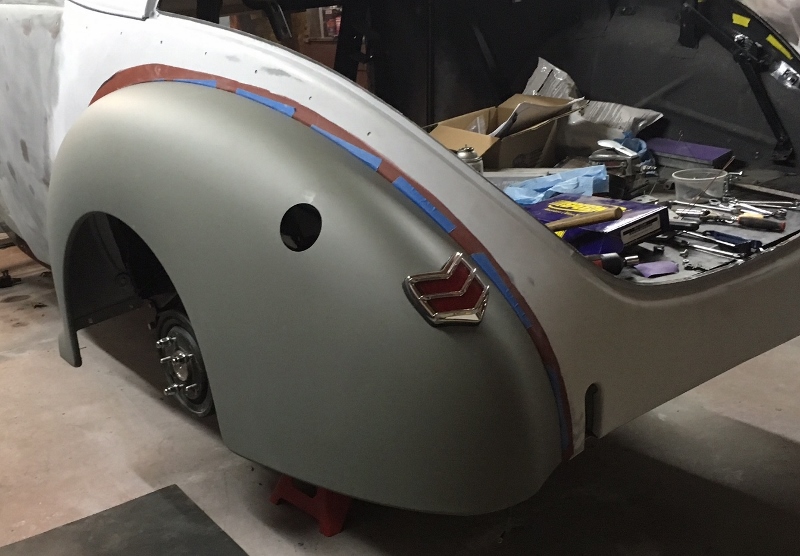

    Here is the drivers side pix. I found a small dip just below the gas filler opening, otherwise just like the other side. I don't think I'll need any filler.
    I should have done this last fall.

    Looks great Joel! It's really nice to know that these parts are being made and that they actually fit!

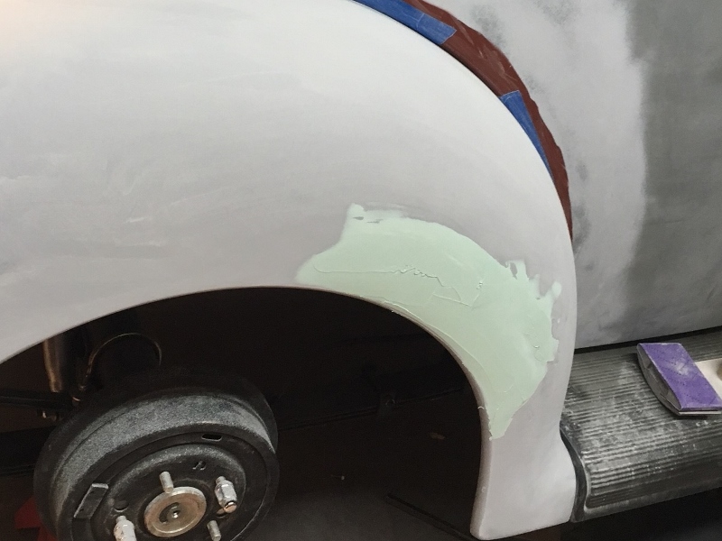

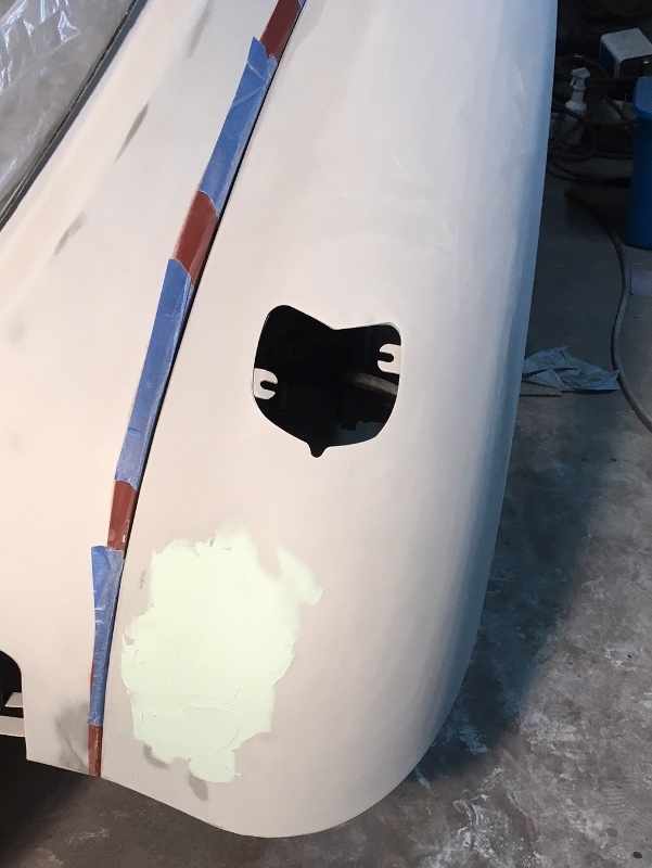

    I spent a little time taking out the low spot on left rear. Tomorrow I will put some k38 on both. The sun will be out so I can spray and take them back in to cure.
  10. joel
    Joined: Oct 10, 2009
    Posts: 2,729
    joel
    Well, K38 on the left and no filler so far. I found a couple of spots on the right and I'll do that tomorrow.

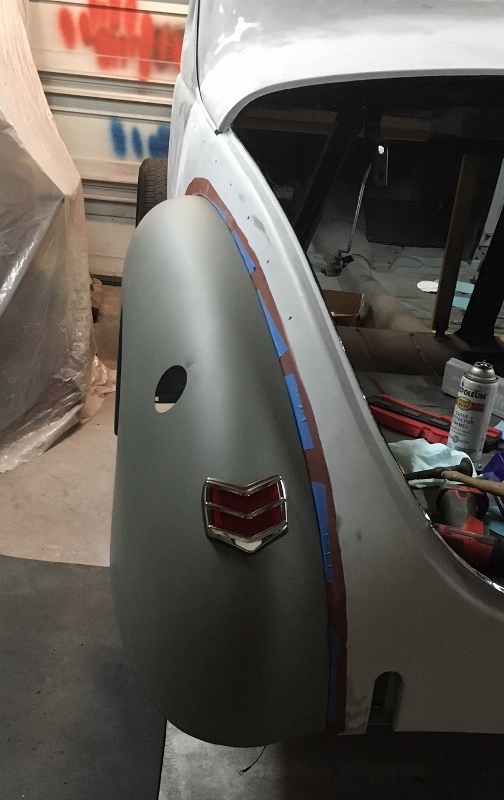

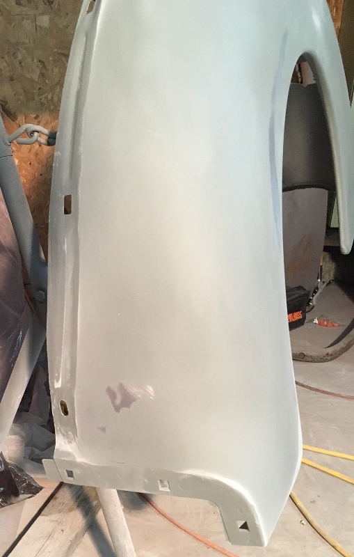

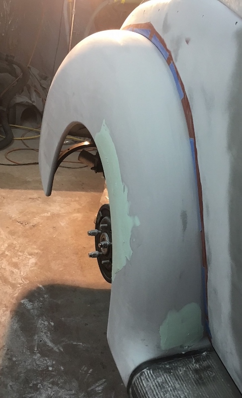

    I added some pix of the fender I blocked just to see how straight it was. I had about 2 mils of DP to work with.
    bare spots above the wheel opening.

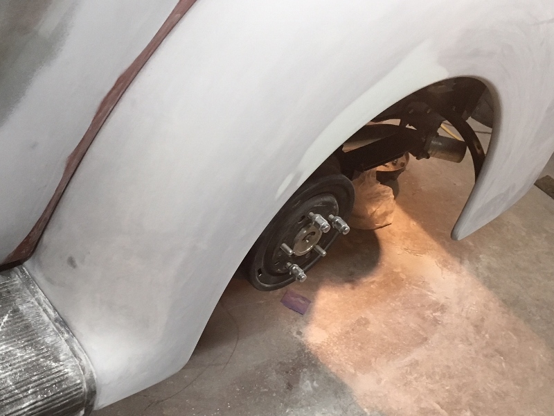

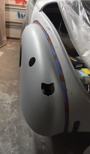

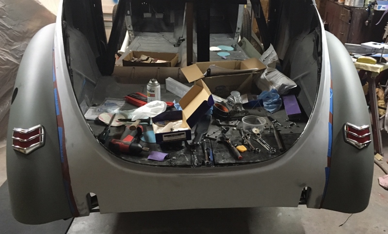

    Small update.
    This is the 2nd application of surface; the first blocked out pretty good except I had to add a little glazing compound above the wheel opening and in the rear below the tail light at the bottom. I checked the running board fit and it's good. One more blocking and then sealer.

    Nice work Joel! it is amazing to me how perfect a panel can look in primer until you start to block sand it. I am very tired of sanding on the mercury at this point. Finished the hood and well into the doors at this point. happy Thanksgiving!

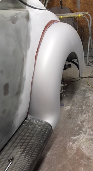

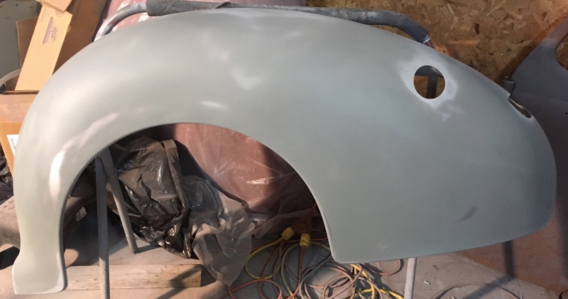

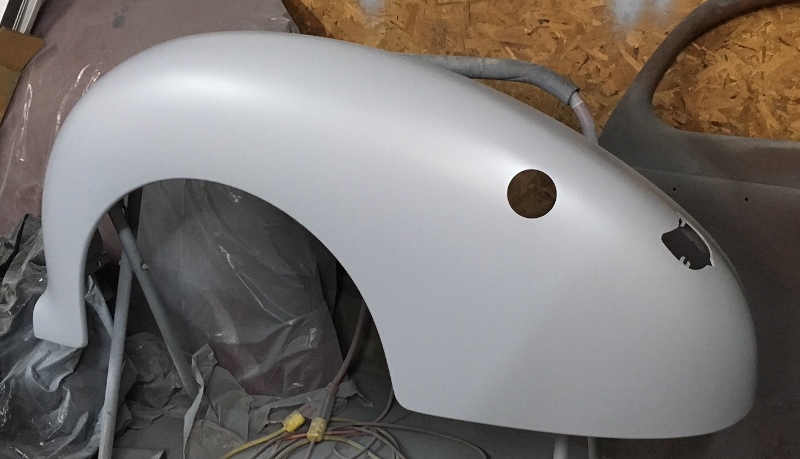

    Here are some pix of the fender progress.
    I added a little glazing in 3 locations, but I am not complaining about the quality of the fenders. They fit well to the body and the boards; they just need a little touch up.
    This area was the least perfect.
    There was a small "flat" here on both fenders and if you are using a polyester filler prime, you might not have noticed it.
    2nd time on this side. There is a little "flat" about 4 in. up from the running board and 1 in. out from the body. I'm sure everyone watching is aware of this, but I'll say it anyway. Bolt the fenders to the body to do the finishing. I even tighten the bolts in the same order each time. ( yeah, I know, ****)

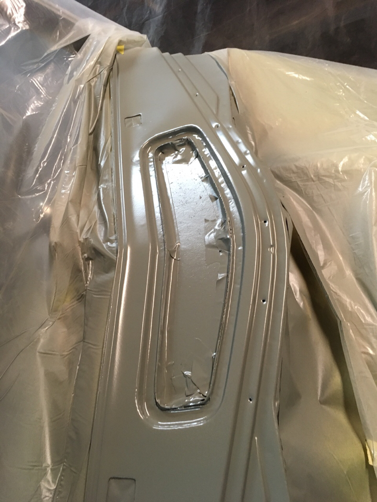

    Ok, I ‘m back on this project. I am going to finish the cowl vent seal channel. After trying to figure out a better way, I just started filling the pits with epoxy prime and sanding it down until I hit metal.

  19. 1-SHOT
    Joined: Sep 23, 2014
    Posts: 2,898
    1-SHOT
    from Denton
    Did you get all the rust out of the pits ? If not you will have some problems later. You can use a good 2K primer and block it out. I like PPG NCP 270 S red or 271 S which is grey.
    Google the instruction sheet and you will see how good it is. It cost more than the cheap stuff but in the long run it's better. I have used it for about 20 years in a production shop and never had a come back from it.
