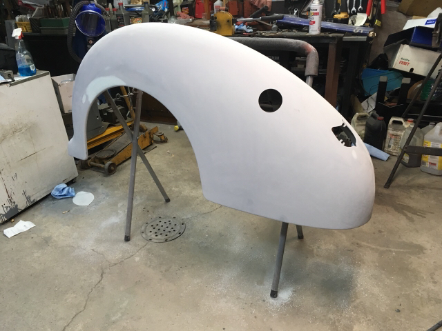

    The weather is warmer and it's easier to warm the garage enough to prime. Here are pix of the left rear blocked and ready for sealer and the right is getting the last coat of surface, final sanding, then sealer.
    When they are sealed, they get stored someplace and I finally go to work on the body.
    It's the best I can do
    ready for the last surfacer

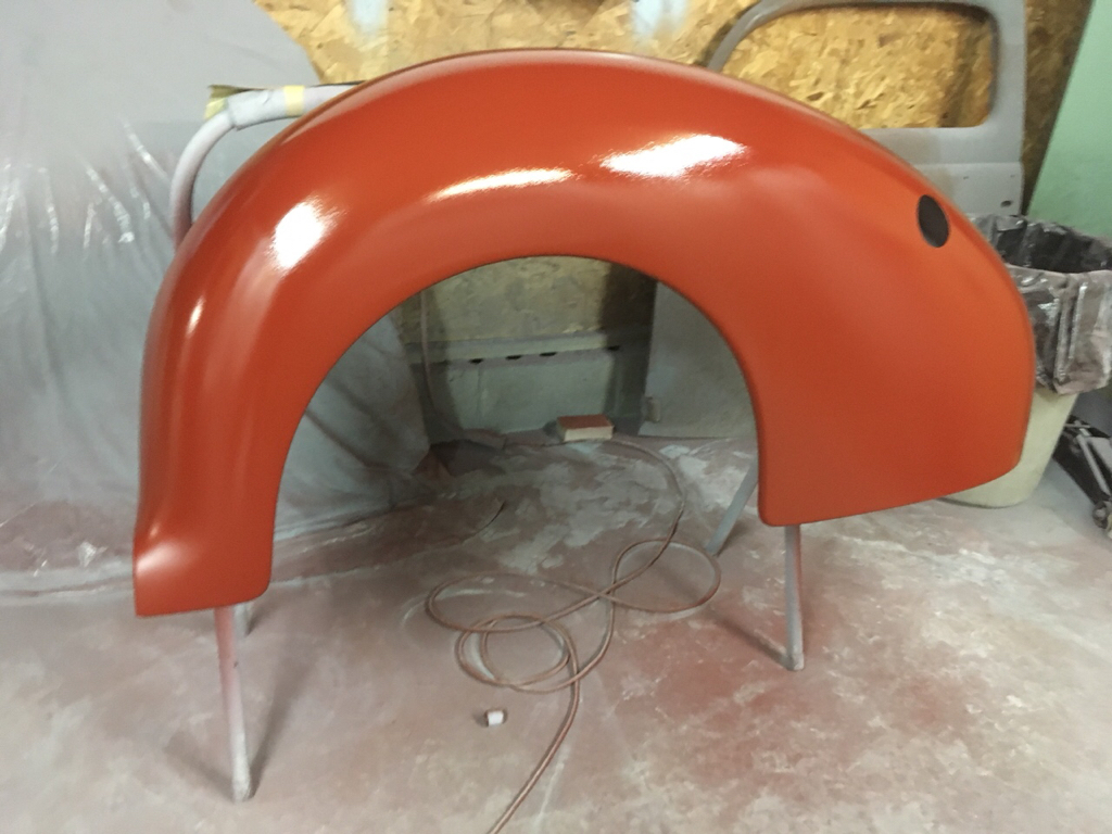

    I finally got the rear fenders finish sanded and sealed. [​IMG][​IMG]
    Now it’s on to the body,after moving some stuff.

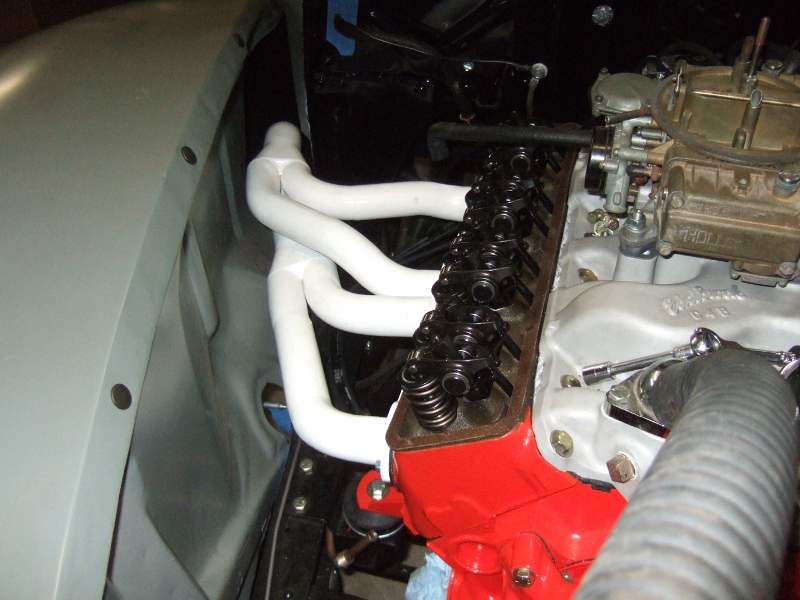

    I made them. Post #8, on the first page of this thread, has a picture. The flange plates and tubing ( J bends, U bends ) came from Speedway. I had the design in my head since I was 18. When I started the thread I had a small digital camera and I didn't get many pix. My phone changed all that a couple of years ago.
    Here is a couple of pix when they were first installed.

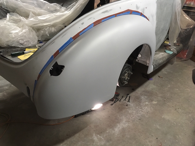

    Ok, I’ll catch up a little bit. I have about 4 hours masking and at least 8 sanding, but I put some DP on the drivers side cowl up to the body seam. IMG_0940.JPG
    Tomorrow I’ll be able to add some filler.
