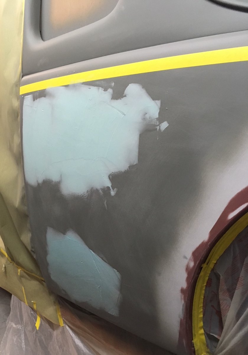

    After some sanding and sealing up some sheet metal gaps ( factory stuff ), I added more K38. Tomorrow, I'll sand the areas where the front fenders mount and add the DP74 as a sealer. Maybe I'll get to the color tomorrow.
    The black is seam sealer.
    Next was 3 coats of K38
    I'm painting the rocker panels now also. I think it will save some masking time going forward. We'll see. So far , it seems I spend as much or more time masking as I do sanding.

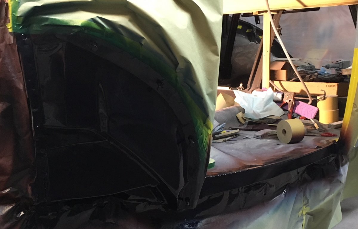

    Just finished spraying the 2 areas I've been working on.
    I put a light on this side so you can see the blue. The other side has no extra light so it looks black.
    Now I rip all the masking off, cover up the painted parts, and back to priming.

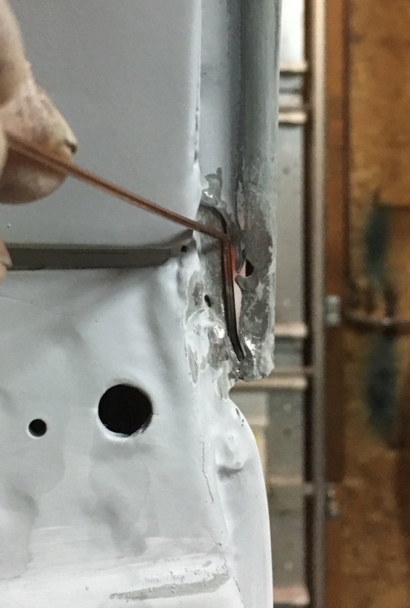

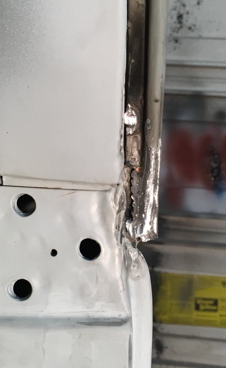

    Here is a picture of something I've known about and avoided for decades. At first I said " screw it; Ford put it there and it's staying", but now I'm near the finish and It bothers me to leave it alone. Incase you don't recognize it, this it the front end of the drip rail and it was caused by an employee with a stick welder attempting to attach the end to the cowl.
    I'm thinking about using some 1/16 tig rod to somewhat fill the gap and stick it fast with the mig welder. Thoughts?
    BTW, that little connection at the bottom has broken loose.

  10. The 39 guy

    Joel, I am having trouble figuring out exactly where that is. Can you take a picture a little farther away so I can see the location better. your filler rod idea should work though.

    Thanks Joel! Now it makes sense. It is not in a place that readily be seen but still something I would fix. Hope you show us the finished repair.
  13. I'm with The 39 guy, fix it and make it nice.

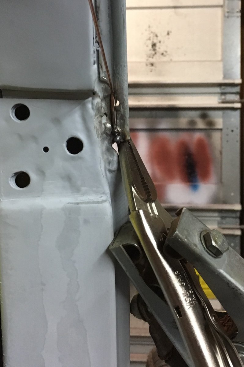

    Ok, I just got done with the repair and it’s the best I can do. The pictures are in order and you can see that I had to go over the welds several times. The die grinder caught and broke the welds to the body twice. It broke the factory spot weld next to the work the second time. I’ll have to add seam sealer along the inside. IMG_0963.JPG IMG_0964.JPG IMG_0965.JPG IMG_0966.JPG IMG_0967.JPG IMG_0968.JPG

    Turned out to be difficult repair Joel.... Did you consider cutting out the bad metal and welding in a small steel patch piece?

    I did consider buying a section of drip rail and using about 1 1/2 to 2 in. to replace the bottom piece. It meant tig welding the joint between old and new ; which would require sand blasting a small area to get it cleaned enough to tig. Actually, that was my back up if I couldn't make the weld and grind work.
    I'll take another picture after priming and sanding.
    If rust was involved, I would have welded a new piece in.

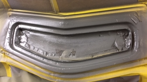

    I was sanding the cowl vent area in preparation for spraying K38 on the top surfaces.
    Post 499 and 513 show when I started on filling the pits in the cowl seal channel. Now for the rest of the story.... Apparently, the room was too cool for the DP to cure or I applied it too thick and as I sanded the seal channel I found cracks in the bottom surface. When I pushed with my finger, it broke through and I had to dig out all the primer.
    IMG_0996.JPG Cleaned and sanded
    IMG_0997.JPG 2 coats of DP re-applied
    IMG_0998.JPG 2 coats of K38 with more than 24 hours of curing time in between. The down side is I screwed up the first time; the way up side is that I stumbled onto the mess now... before the paint.:D

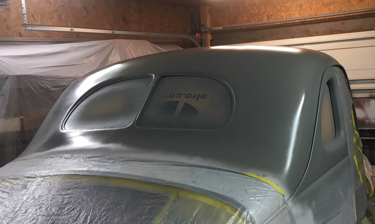

    Well I finally got two good coats of K38 on the top of the body. Tomorrow I’ll work on the sides. IMG_1010.JPG IMG_1011.JPG IMG_1012.JPG
