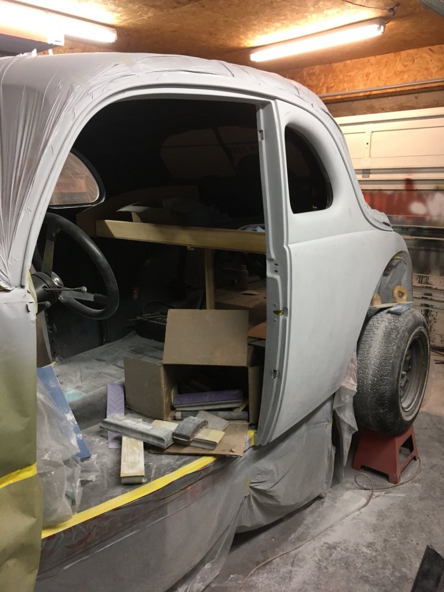

    I'm still working on the quarters, but it's getting closer.
    The whole panel was sanded with 320 and a couple of low areas showed their ugly heads. I'm working those down now. There is a couple on the other side also. The area around the windows and the drip rails are sanded. I'll put some K36 on the lower quarters and re-sand them. Then I'll do the top. Hopefully no more "touch ups".

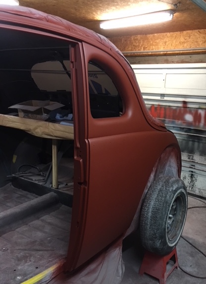

    I finally have the lower body ready for sealer....I think. I’ll go over it tomorrow again and seal it. IMG_1015.JPG IMG_1017.JPG IMG_1018.JPG
    After I do the sides and back, I’ll take it off the stands, remask the sides and block and seal the top.

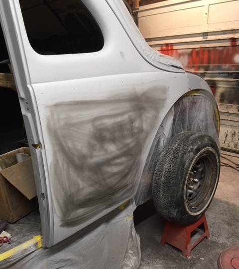

    thanks Hivolt; I know this body work is boring and tedious.
    At least todays pix are a different color
    This is to prove I used guide coat and I actually had to sand a little more with a long block this morning.
    Pulling tape tonight and masking the red parts in the morning.

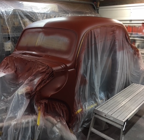

    Here it is ; the last part of sanding on the body. I re-masked the whole car and cleaned a couple of small spots where prime blew through cracks and gaps. As the surface builds up on the tape, it loosens it up. Here is how it looks now.
    BTW that plastic mask is a 3M product and it's pretty useful. The overspray sticks to it and doesn't flake off. Use the "hand masker" device they make for it.

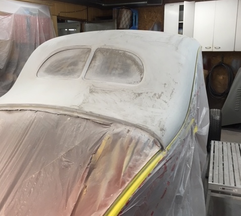

    I finally got the top blocked and the red sealer on. I removed most of the masking to better clean the car out before paint. I'll probably lightly sand the sealer, at least in spots< in case there are any bust bunnys in the sealer.
    The last sanding
    Sealer on
    I'm going to get it outside and blow it out good while I'm cleaning the room. I might wash off in front of the firewall. Sanding **** gets everywhere.
