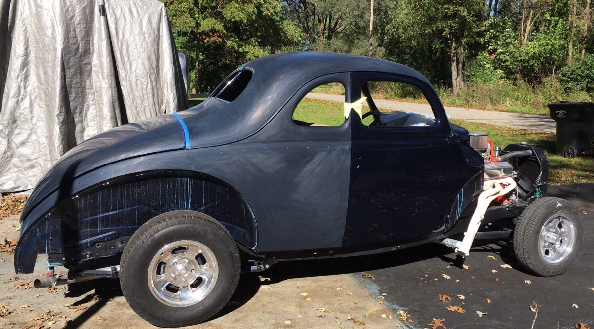

    I have the body cut up to 2000 and was buffing the drivers door when the Makita died. I tried to get it apart but failed. I am pretty sure it’s the switch or maybe a loose wire. So I bought a new one from Home Depot. They had the best price and 2 days shipping.
    The plan was / is to get the painted stuff on the car so that I can paint the rear fenders. IMG_1064.JPG
    Here is how it looks now.

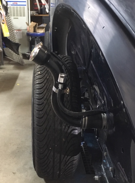

    After the buffer failure the other day, I installed the tank vent hose. A non-paint related project was needed. There is the same setup on the truck ( done by PO ) mounted with a zip tie.

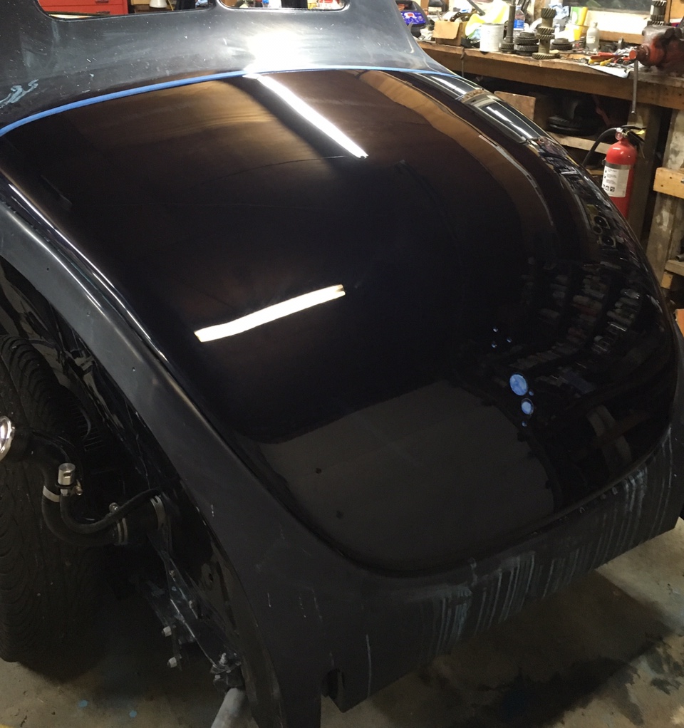

    With my brand new buffer, I finished the drivers door and my son helped install it. I buffed the deck lid today. IMG_1068.JPG IMG_1067.JPG

    Paint is looking great Joel! Tell me more about that vent please.

    I got the the piece on the end of the hose from Summit and it's a vent/rollover valve. Since the tank is from Tanks, it has it's own rollover valve that also acts as a vent, which allows you to run a non vented cap. The only " tricky" thing is the vent hose needs to stay level or above the fitting on the tank. If there is a low spot, you might get fuel splashing into the vent hose and forming a liquid "trap".
    I think the above scenario is not likely, but better safe than sorry. It is possible to over fill the tank until fuel rises into the filler pipe.

    Pix of car about 3/4 buffed with just compound. IMG_1080.JPG IMG_1079.JPG
