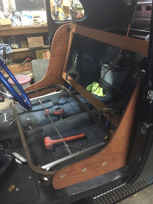

    Update. The paint is buffed all over with compound. I installed the door latches and am getting ready to do the gl***. I am in the cue for upholstery, so I have been ***embling the new wood to the seat frame. I want to be ready with the seat if the upholstery guy calls. I'm adding some machine screws and T nuts in place of wood screws in a few places.
    Where the clamps are; brackets were fastened with wood screws. I think that's asking a lot of the screws.
    You can see the Tnuts in the side pieces; that's the way Ford did it there. There is plenty to do.

    Alright Joel! That is a big project out of the way. Should be fun stuff from now on.The seat frame looks nice a stout.

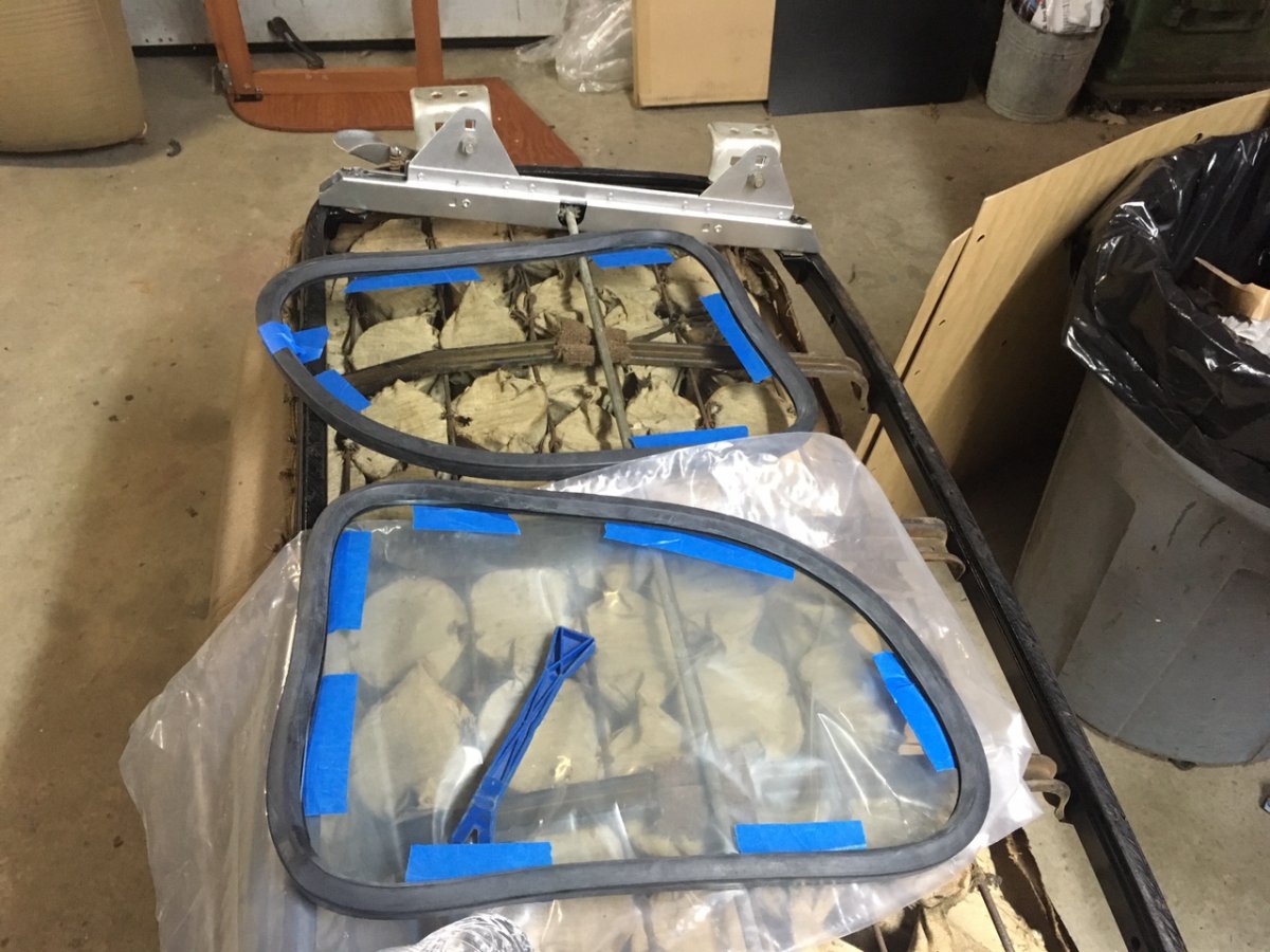

    The new wood is all bolted down. I want to clean the metal frame and paint it yet. There’s a little tune up to do on the springs also IMG_1090.JPG IMG_1091.JPG

    I have always liked the hinged backrest seat. It looks like it provides better access to the storage area than the split back bench. That new wood sure looks nice.

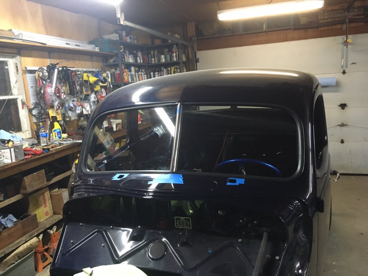

    I ‘ve been working on the cowl vent alignment and the fit of the new wiper transmissions. I re-routed the wires on my Newport Engineering wiper motor also. Lots of time under the dash
    Next is the windshield gl***.

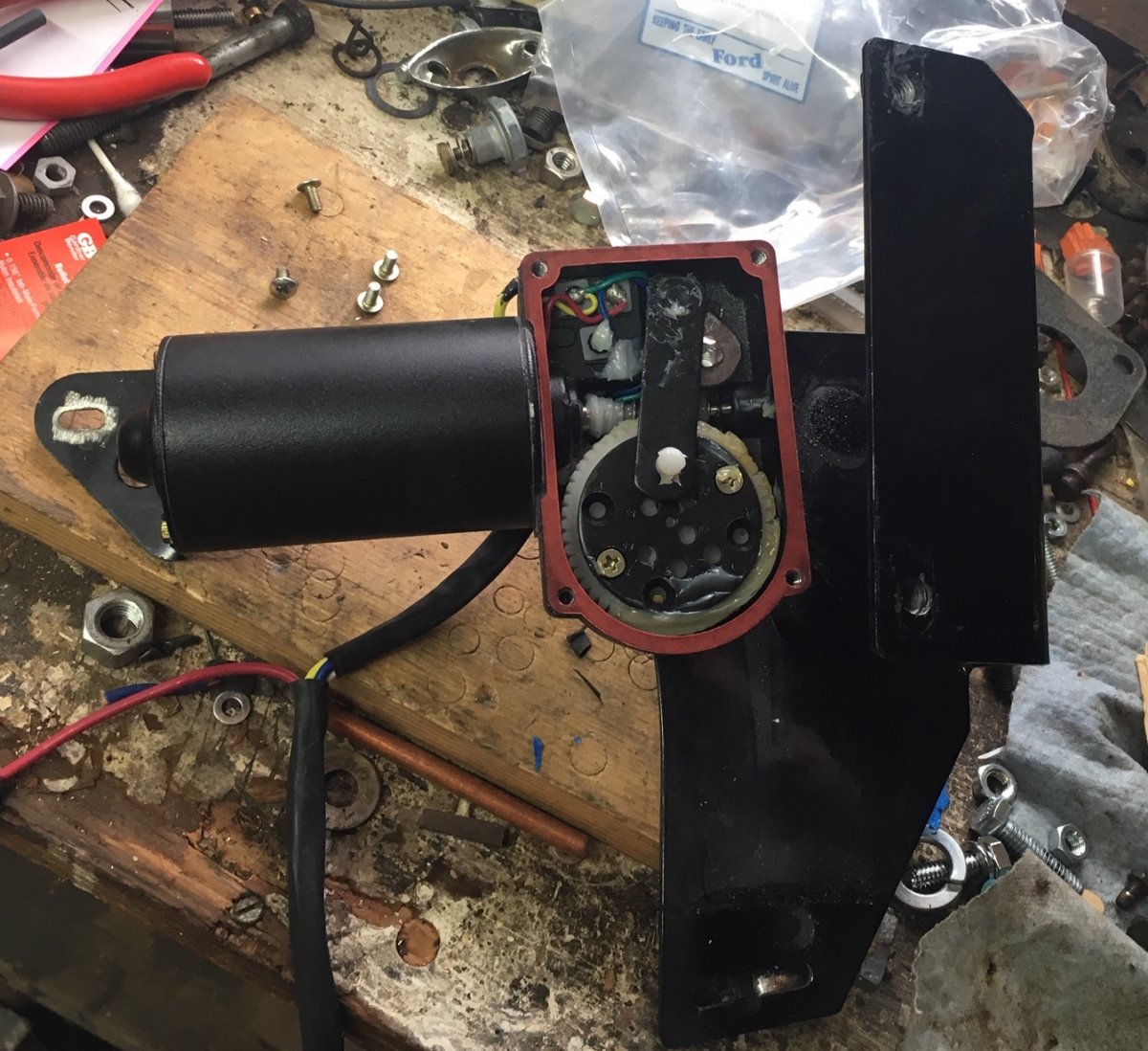

    I installed the wiper system and tested it without the arms and I noticed that they parked facing each other. This means they would be parked at a 15-20 deg. angle. This is a Newport Engineering system that uses the stock transmissions and linkage, so I contacted them To see if the park position could be changed. They told me what to do and walked me through it on the phone. The wipers now park pointing away from each other. Great people.
    I was going to take pix of each step, but I didn't want to waste the techs time. Basicly, you remove the rod at the top and rotate the plate with the holes in it 180 deg. by removing the gold Phillips head screws. This re-clocks the drive pins on the output of the motor. I'll have some pictures of the wipers installed when they arrive.

    Everything is looking good. You did good choosing Newport wipers. They are not only the best wipers, they are some of the best all around people in the hotrod parts business.

    That's some good tech right there Joel! Thanks. That reminds me I need to fix my wipers before spring. The set screws were not tight enough and are slipping on the drive shaft of the coupes wiper motor.

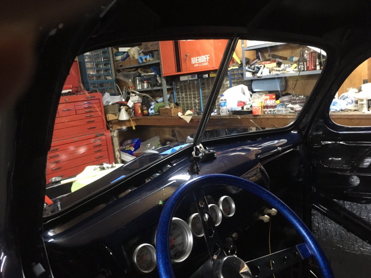

    I finally got them positioned and here is the picture
    Not perfect, but ok.
    I'm not happy with my quarter window sealing. Did you use sealer between the seal and the body?
    I think part of the problem could be the shape of the gl***; I did shim under the bottom on the p***enger side, but it's still not tight against the body. Any suggestions?
    loudbang and olscrounger like this.

    Notice that the pocketing on the cushion springs is not the cl***ic burlap. I've been tempted to use a more durable or slippery cloth to pocket my '40 springs as well as the listings, front and back. Anything other than availability or having it in stock to make that choice? I really need to do pictures as I have so many other issues with the seat. Fred A

    I didn't have to mess with the spring sacks; the original seat I used was so nice that adding a few hog rings will be all that is necessary. I don't think the material those sacks are made of matters for function. The sacks on my seat didn't appear to be burlap anyway; they were more like muslin(sp). The upholsterer said he was going to able to use all the original padding as is. If you're building one of these seats and need pictures, I may be able to help.

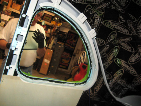

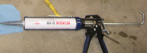

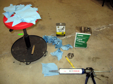

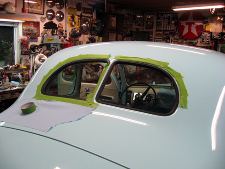

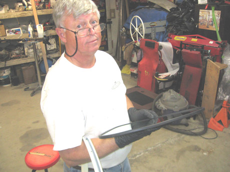

    Since I have a lousy memory I went back to my book and copied a section for you. feel free to delete this post after reading it Joel so I don't mess up your thread. hope this answers your questions. BTW osrounger won't steer you wrong
    The gl*** had initially been installed without any sealer so we took a step back yesterday and applied some sealer.
    Don...." You are going to take a picture of this?" Yes... we put sealer on the inside of the 1/4 windows and along the inner edge as shown in the previous picture.
    I was finishing up and decided I should take a picture of the preparations. I was glad I took the time to protect paint. Being a rookie at this stuff I made a mess.
    I cut some shop paper towels into four pieces and soaked a little paint thinner on each piece before wiping up the excess caulk. That yellow trim tool came in handy for picking the seal flange off of the body before inserting the caulking tube tip.
    I went down to the local car gl*** shop and asked the installer what he used to seal flat gl***. He recommended this DOW BETA Seal U 418 Urethane sealer. He also recommended buying this heavy duty caulking gun from Lowes 9about $15.00. His second recommendation was to warm the stuff up before trying to use it. I warmed it up in my little toaster oven to around 100 degrees.
    In retrospect I would probably take the car to the gl*** shop to get the windows sealed. That stuff was hard to get out of the tube and once unleashed was hard to clean up...... The gl*** guy has a $500 electric caulking gun to squeeze it out of the tube and would hopefully control the application resulting in less clean up. The job came out alright though. It says it takes about 13 hours for this stuff to cure well enough to drive the car.
    I applied sealant between the overlapping center flaps on the front window and my wife helped me install the stainless divider. That was the easiest part of this project. I hope it all is watertight now as I seem to end up in downpours at least twice year going to and from shows across the Cascade Mountains.

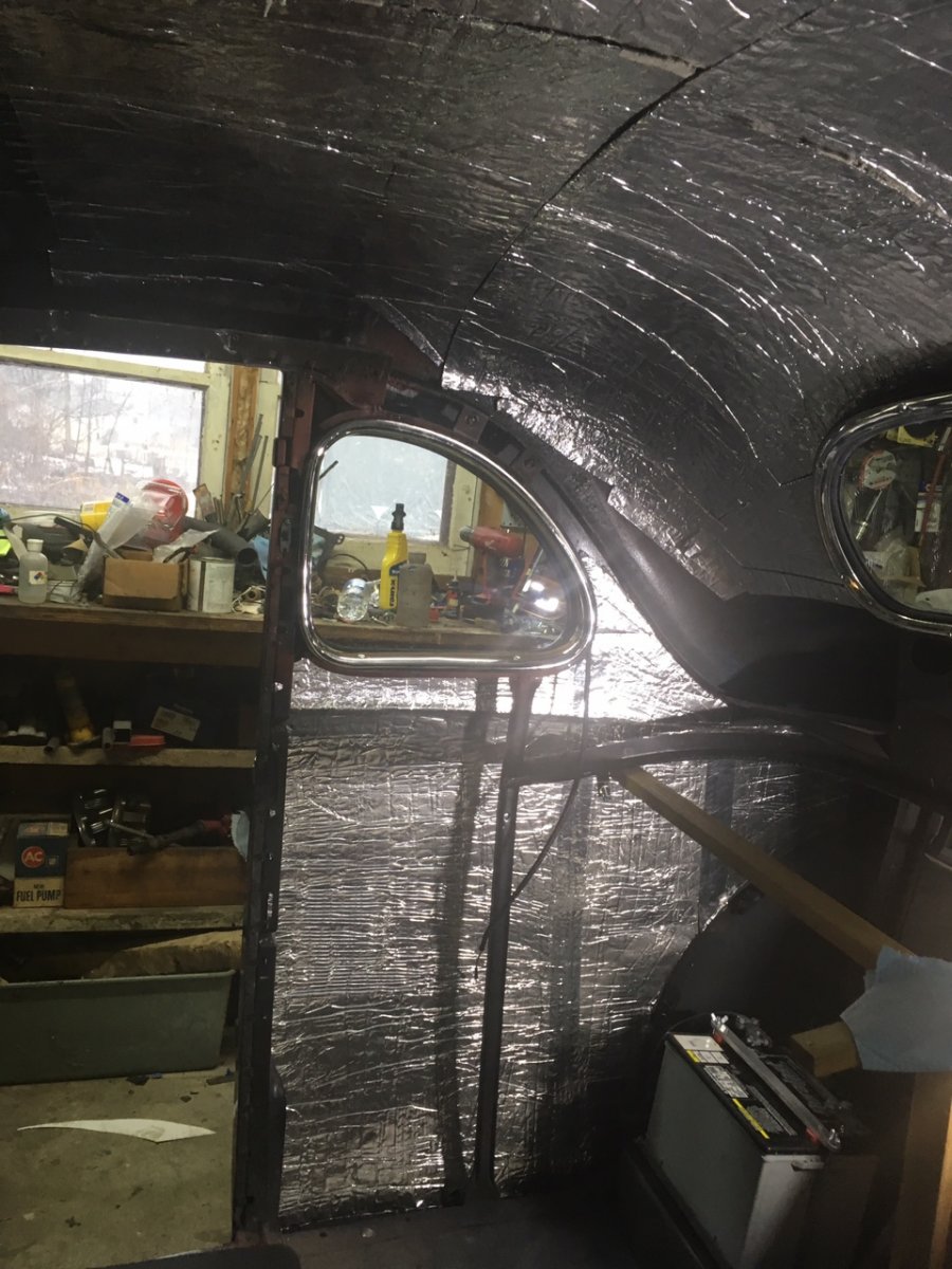

    I have been adding insulation to the car, finishing the battery hold down and installing the trunk mat.
    It looks like the quarter window gl*** will have to be re-cut. I plan to do the vent windows while the car is at the upholsterer.

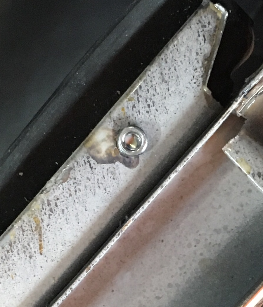

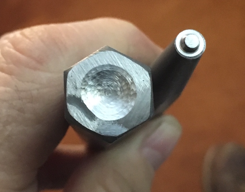

    This might be useful to some. I bought a cheaper punch set from Advance auto figuring the steel might have some heat treat to it. I made a couple of rivet tools to do vent window re-***embly .
    I used Carbide cutters in the lathe, but maybe you could use small files and a drill press if other equipment is not available. They machine easily with carbide and work pretty well. The anvil side was done with a carbide burr and a die grinder.

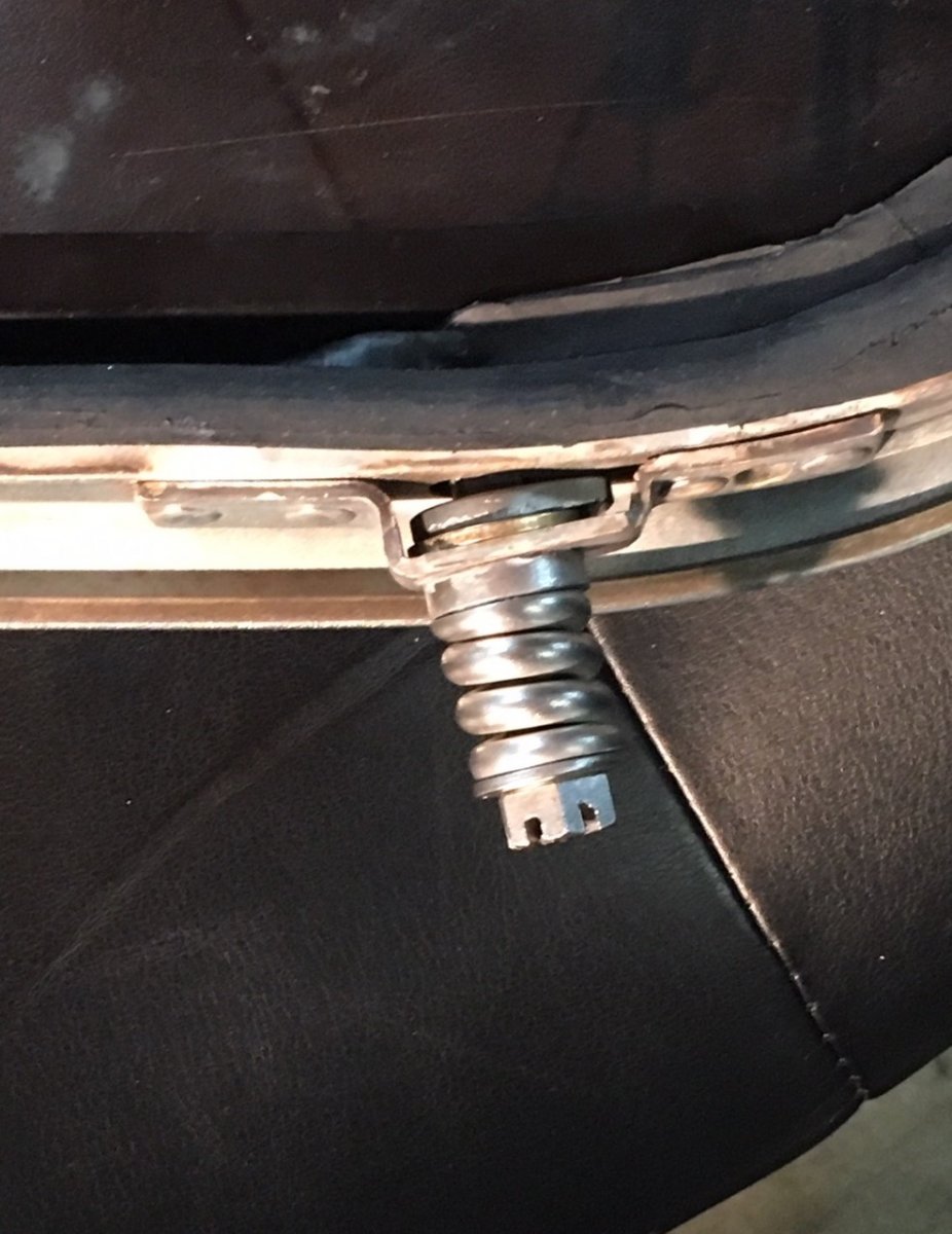

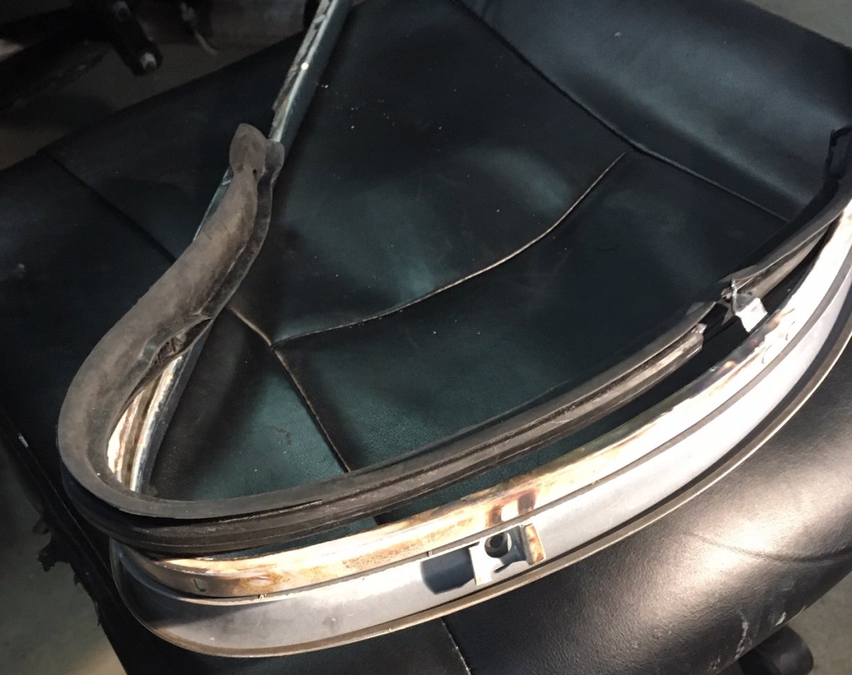

    Well, it's 3 weeks gone by and I'm still working on the vent windows. I checked my new gl*** against the patterns that Drake sells. It was good and I installed it in the frames with 1/16 setting tape. No problem.
    Then the work began. I had 2 sets of seals; one Drake and one from Carpenter. I used the Carpenter first and wasn't happy ,so I removed them and installed Drakes.
    The top photo is the spring and washers ***embled with the nut. I added a washer to raise the vent window frame so it engaged the seal better. Next is the rivet finished with my punch. The above photo shows how I started the seal install. Install the rivets at each end first' then work the seal into it's channel from each end with the last area being the tight curve at the bottom of the photo.
  29. Looking good, keep at it.
    What insulation did you put up on the roof? Use contact cement for that?
