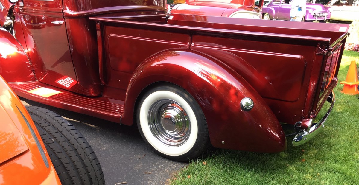

    I had to move the truck to the front part of the garage and I took a picture of the two together. The truck is about 5 in. taller. It must be the cab. the truck tires are taller even though both vehicles have 15 in. wheels. No, I'm not chopping the truck :(.

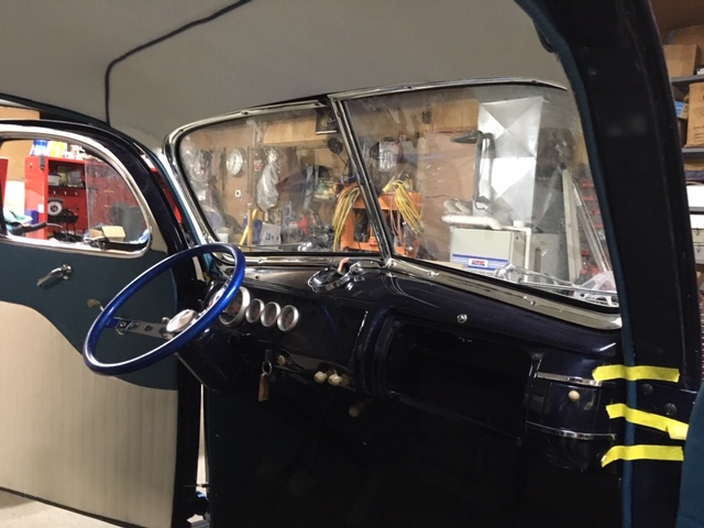

    Finishing the install of the garnish moldings. The windshield pieces were challenging. IMG_1265.JPG IMG_1266.JPG IMG_1267.JPG
    I have to re mount the tach and install the rear view mirror.

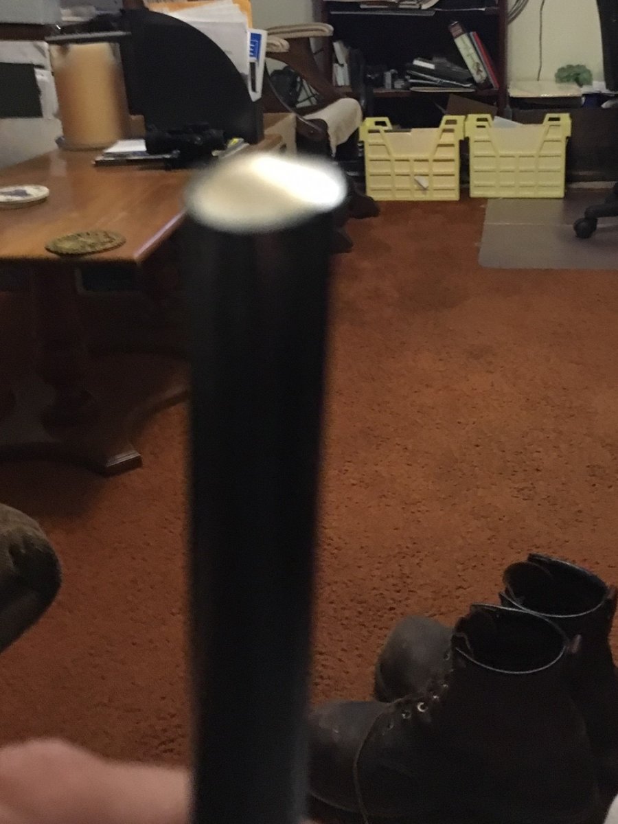

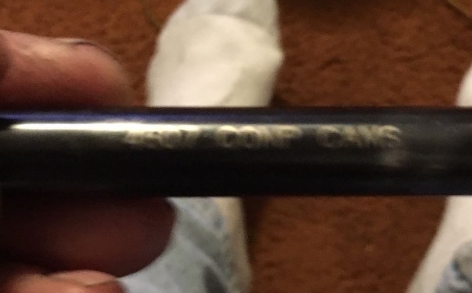

    I got a couple of pix after a test drive. I had a roll back ride home from the cruise in because the car wouldn't start (no fuel). The consensus was fuel pump failure, but this was the culprit.
    This was supposed to be the correct push rod for my roller cam. Here is a link to it's replacement
    https://www.summitracing.com/parts/cca-4609 . The car is back running after an oil change and I'm still evaluating collateral engine damage.

    It's good you found that problem close to home Joel! I have never heard of the need for one of theses roller push rods before. Looks like a great idea as long as you can get the right length for the job. Have you checked the cam lobe yet?
    The car is looking great!
  27. joel
    Joined: Oct 10, 2009
    Posts: 2,738
    joel
    Thanks, Sam. I'm thinking there wasn't much contact with the steel tube of the Comp pushrod because of it's design,so I feel confidant that cam damage it small if any. But I've been wrong before, so I'm trailering the car to Louisville to restrict mileage. When I get back, I'll inspect the new pushrod.
    The roller cam in the engine can't be used with a stock hardened pushrod; it will damage the lobe on the cam. This is my first experience with this type of cam although I purchased it in 1968 for this car.:rolleyes:
