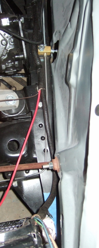

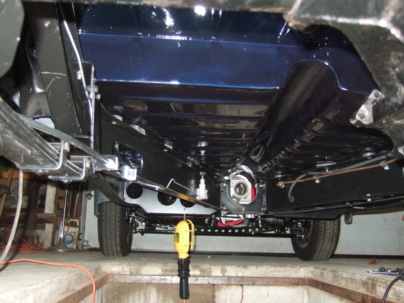

    I had to order filters for my fresh air pump, so the engine paint will have to wait a few days. I made a battery tray and ran #2 welding lead for positive cable and #4 for ground.
    I used some thermal shield where the cables p***ed near the muffler ( inside the bottom lip of the main rail on the right) in the pic above. The middle pic shows the ground and the fuel line along the inside of the X.

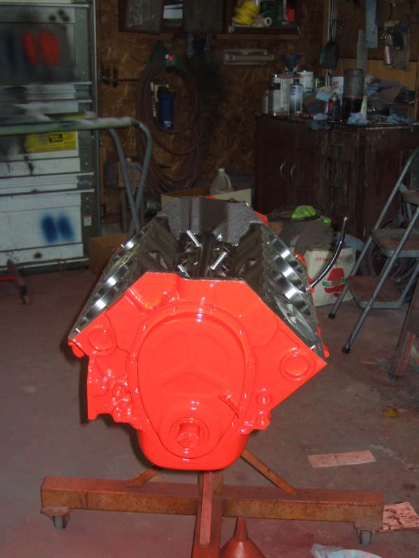

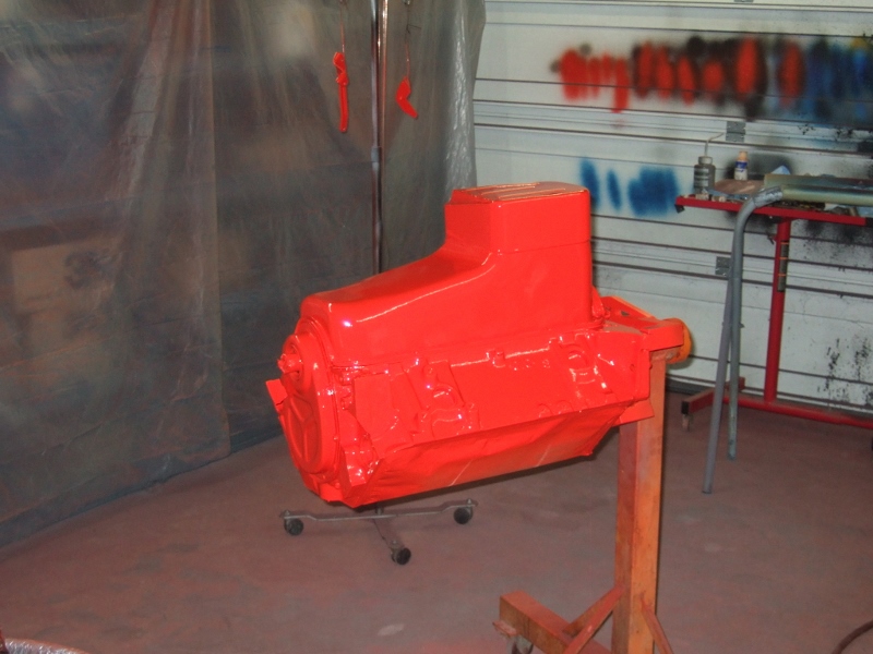

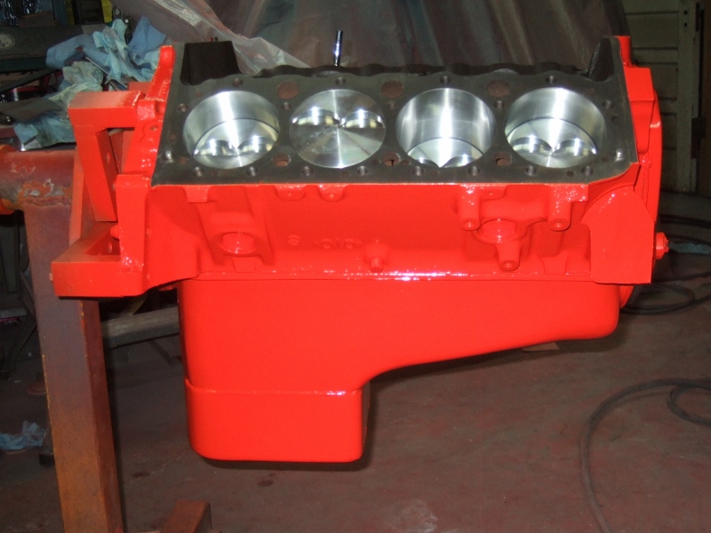

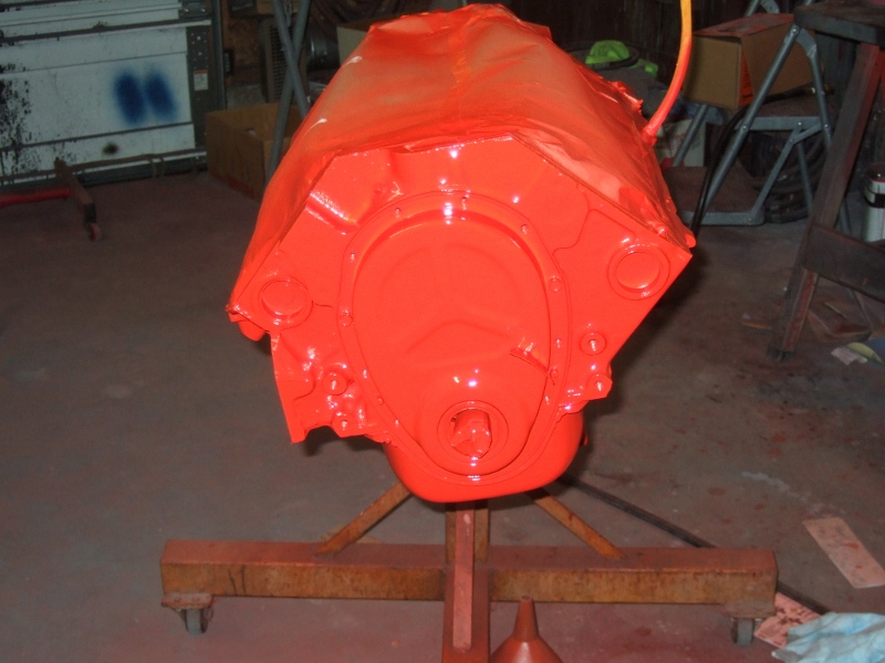

    I painted the engine today; well the short block anyway. I'm still working on the heads. I was doing some port work last winter and one is almost done.
    Next is the masking off. It's a .040 over 327 large journal in a 68 0010 block with a Chet Herbert solid roller cam ( .500 lift).

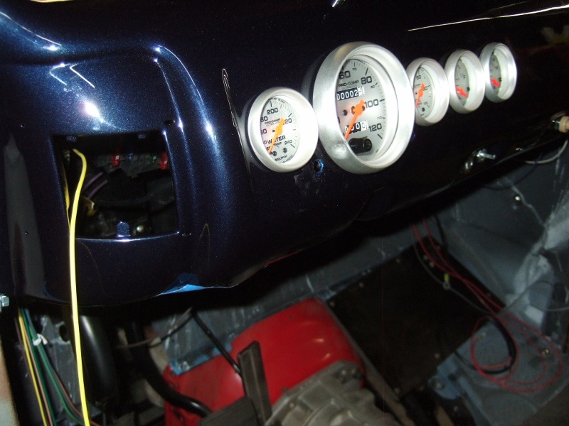

    Here is a small update; I did some wiring and drilled the holes in the dash for turn indicators
    The next pic is self explanatory; I had to step away for a couple of days after the drill chuck dented a brand new gauge.

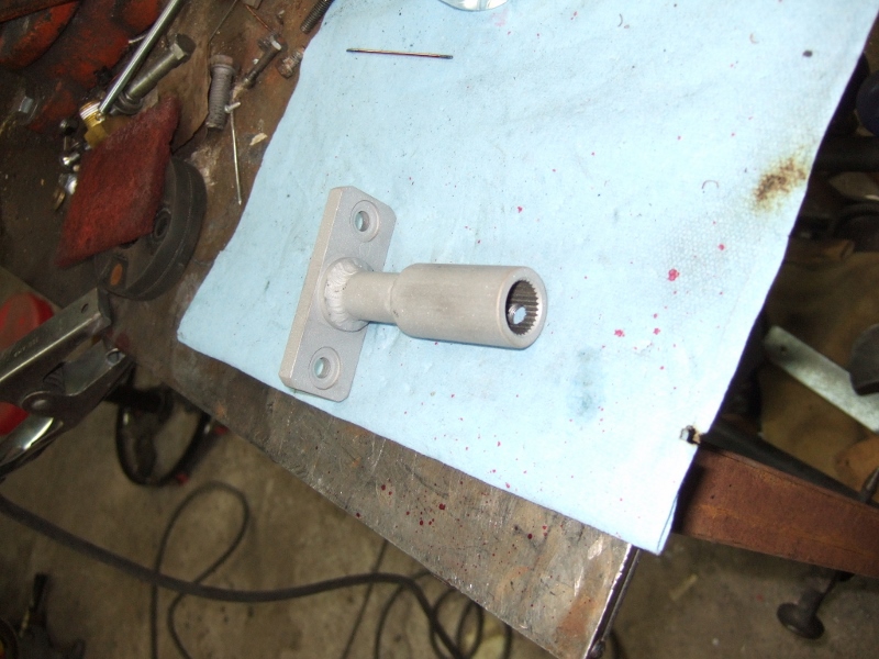

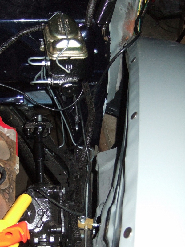

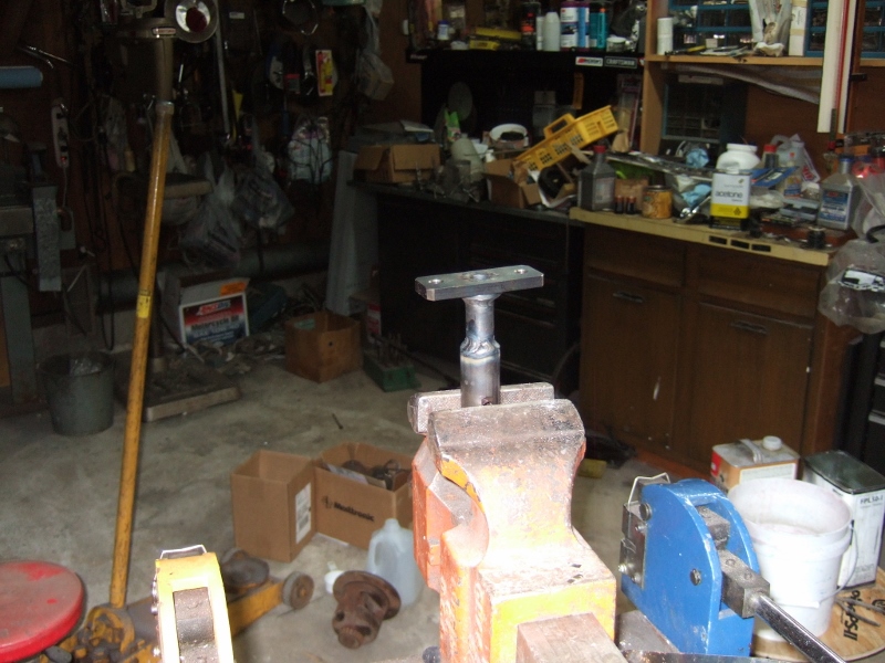

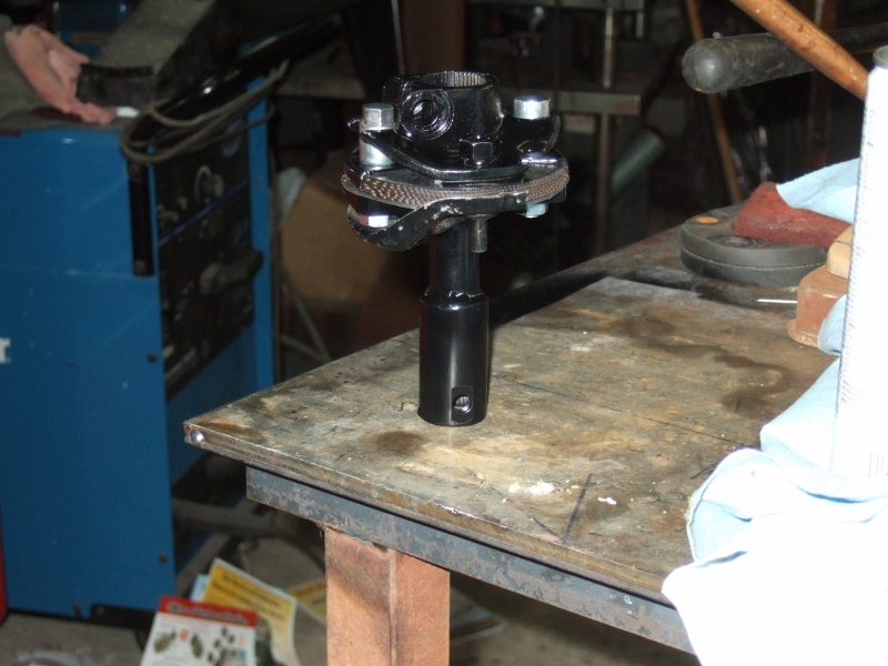

    While cooling off, I made a new bottom section and rebuilt the rag joint. I just finished painting it and I'll put the pieces together tomorrow.

    The ragjoint is finished and back on the box; I'm back on to the guage wiring. I used a rebuild kit from Autozone, so I'll see how long it lasts.

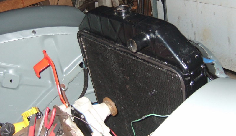

    Small update on the wiring. I to cut the harness for the headlights and install "bullet" connectors for each headlight bucket. I don't care for the plastic covered crimps, so I cut the plastic off and soldered them. It took longer to cut the plastic off than anything else. DSCF1148 (601x800).jpg DSCF1151 (800x460).jpg
    I cheated and used shrink across the radiator so it would fit in the channel.

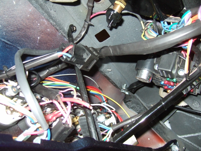

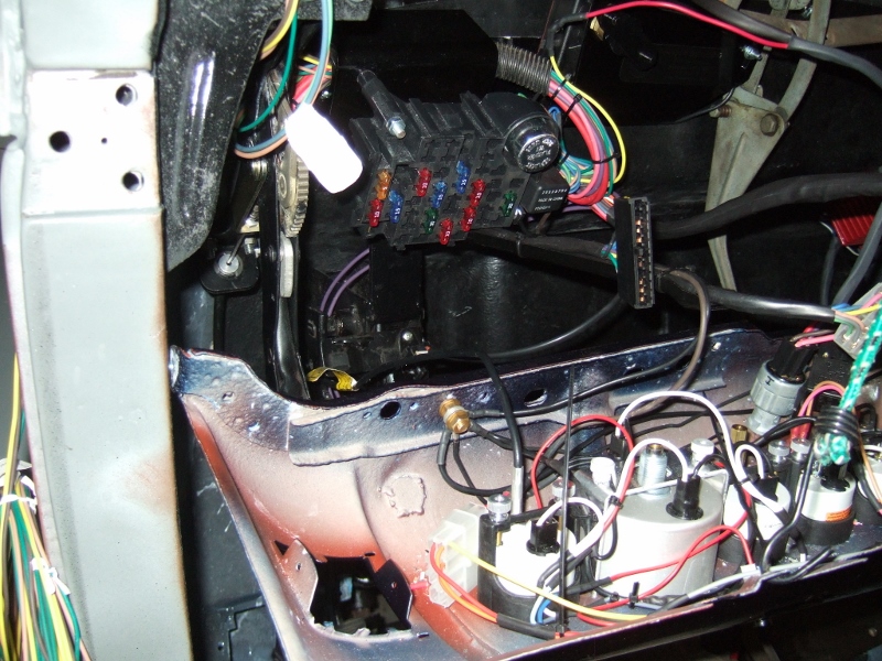

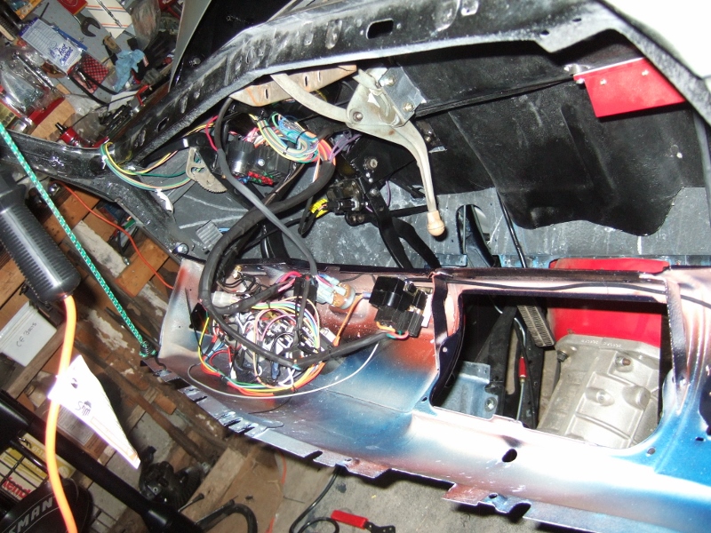

    Small update here. I took the dash and firewall forward wiring as far as I could until I get the engine in. That's next; finish and paint the heads, check pushrod length, mill intake. I also have to put the trans back together.

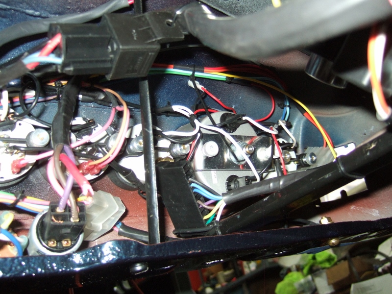

    I made the dash wiring so it would unplug and be pivoted down for changes/ repairs DSCF1152 (800x600).jpg DSCF1153 (800x600).jpg

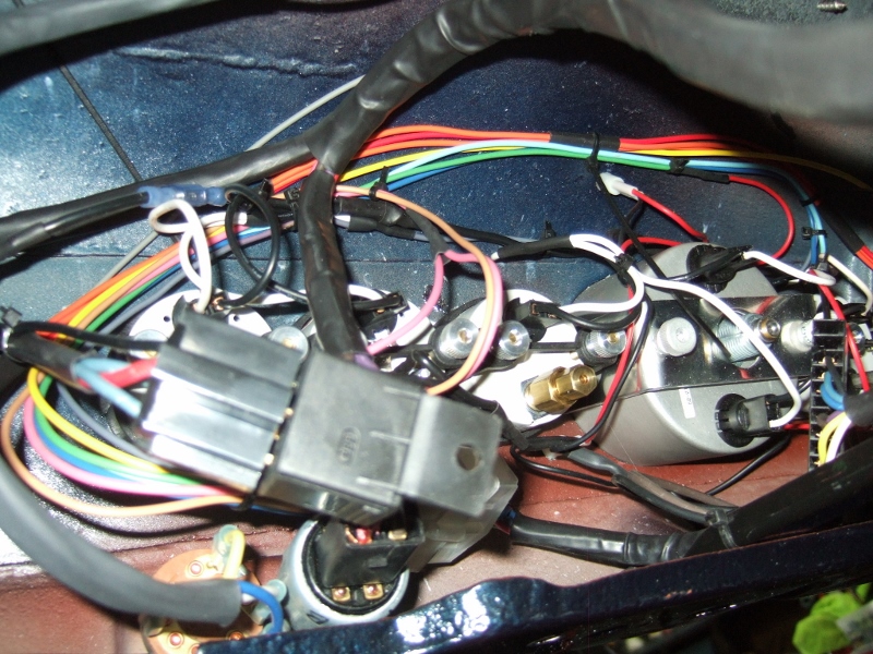

    Here is the dash up in position ; the pic is from on my back underneath. It looks messy, but it will be easy to service. Some of you may notice the red wire hangin out; I crimped these and didn't solder. 1 didn't hold. I'll have to de-pin the connector recrimp and solder. DSCF1156 (800x600).jpg DSCF1157 (800x600).jpg DSCF1155 (800x600).jpg

    I like your dropping dash for maintenance idea. It is never fun trying wedge the old carc*** between the seat and gas pedal to investigate a problem. It looks like unbolting the dash would be easier than taking the seat out too.

    love the idea of the dash being hinged like that.awesome.did you use a actual hinge or does it just pivot on the end bolts?

    I stumbled onto that while mocking up stuff. I thought about what I would have to remove to pivot the dash down. I think the garnish molding around the winshield and 4 screws at the upper edge of the dash is all it takes. Now that I have a plan ,I'll probably never need it ... and that's OK.
    Yep, just pivots on the mounting screws.

    I had to replace the wiper motor in my 40 a while back. No way to do it from below with out dropping a/c and still working around everything else. So I did just what you discovered. Dropped the steering column down abit, removed the garnish moldings and upper screws then loosened the two lower side bolts and pivoted the dash down enough to access wiper motor. Worked very nicely. I am enjoying your thread, keep up the good work.
