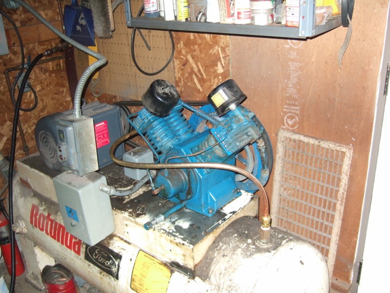

    PITA update. while grinding on the second cyl head, my compressor made a couple of ominous noices. It's been about a year, so I changed oil and noted some silvery stuff in the oil. I tore the head off and could see some carnage so I tore it down and made a list of parts. It took a while to get them ordered and shipped, but a little over a week later, I'm back in business.
    It's a 30+ year old Emglo pump( over $600 in parts). Back to work.

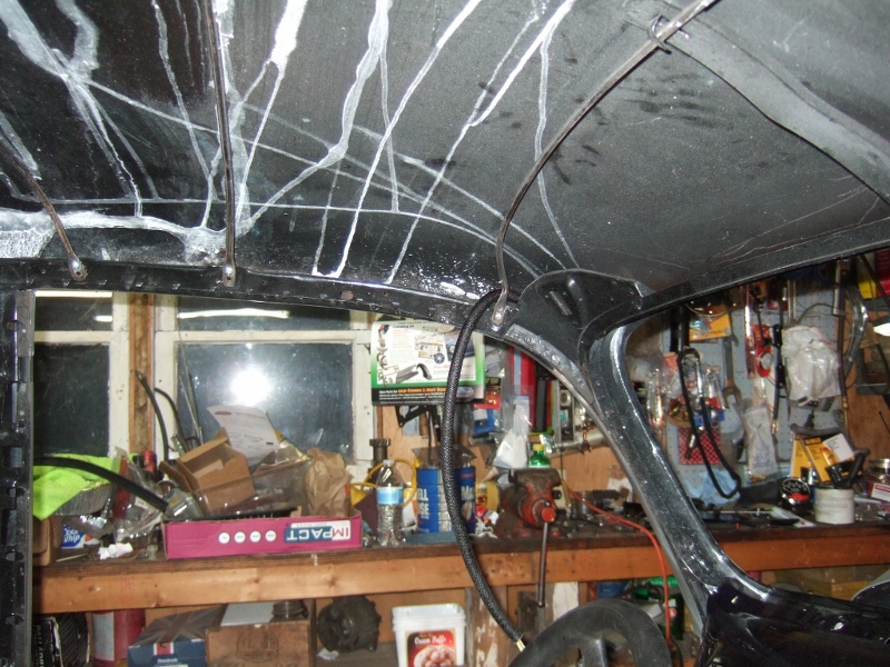

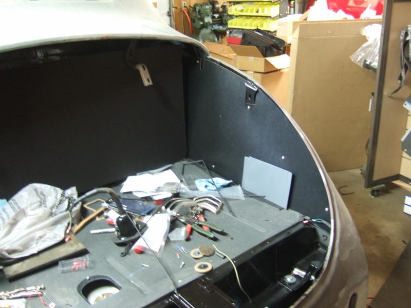

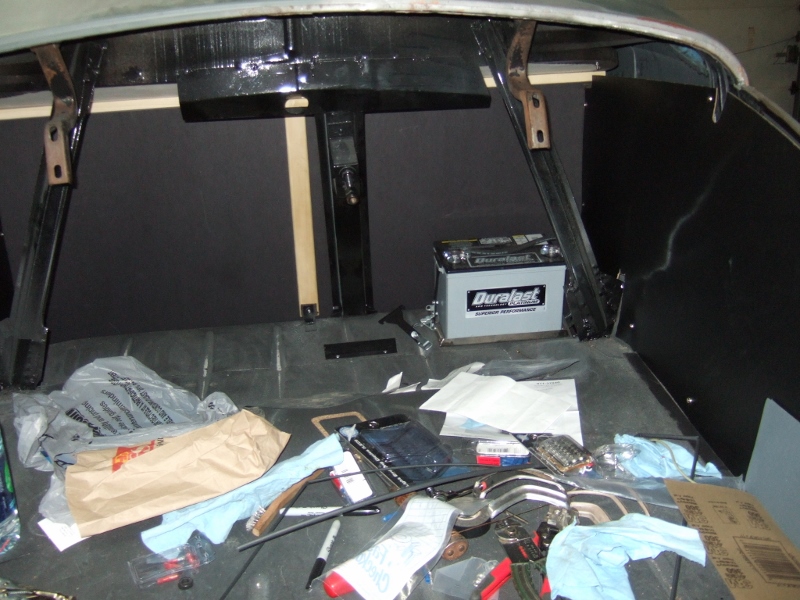

    I have a little update finally. I got caught up in the wiring and it's nearly done. I ran the harness to the rear and hooked up the tail lights with a stub to the deck lid handle for the license plate light.

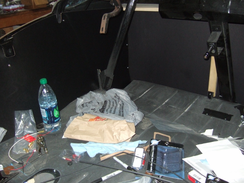

    I bought an interior "panel " kit from Lebaron Bonney and installed all except the doors. I put in the screws and trimmed for fit so that when the paint is done, I can put them in easily.
    DSCF1247 (800x600).jpg DSCF1248 (800x600).jpg DSCF1249 (800x600).jpg DSCF1250 (800x600).jpg

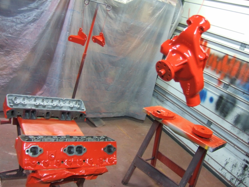

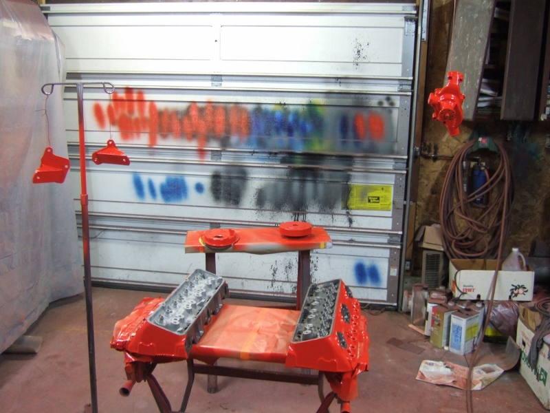

    Yesterday, I finally painted the rest of the orange parts for the engine ( the port work on the heads wrapped up last weekend) and I spent a couple of days attempting to weld the plenum divider back into a C4b. I'm debating how much more time & effort I want to throw at it.
    DSCF1245 (800x600).jpg DSCF1244 (800x600).jpg DSCF1240 (800x600).jpg DSCF1242 (800x600).jpg DSCF1243 (800x600).jpg

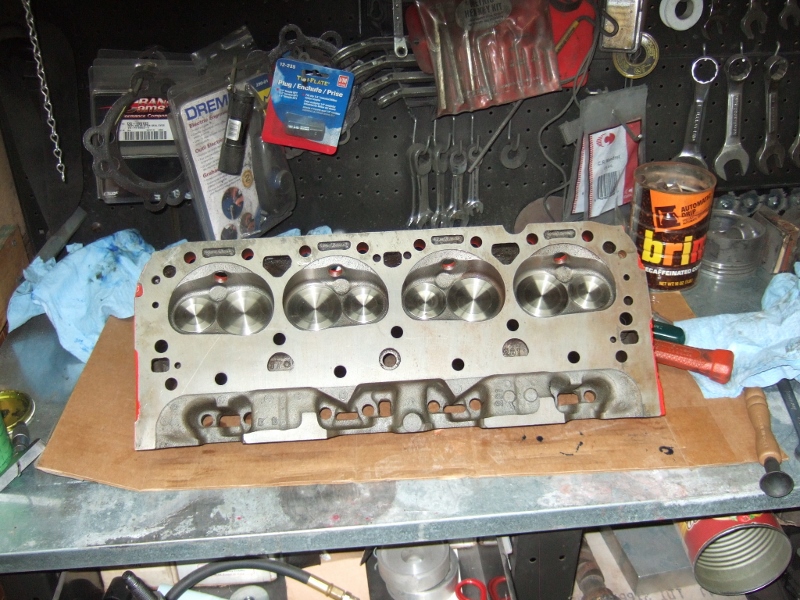

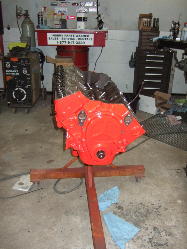

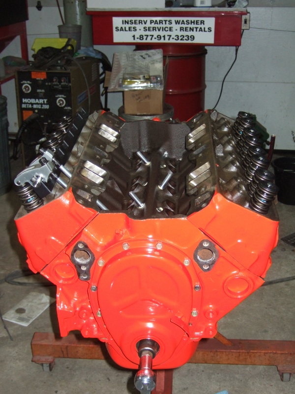

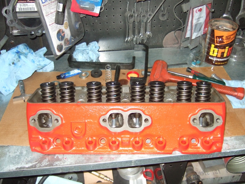

    .I made a little progress. One head got ***embled today. It was 70 deg. here, so I washed the heads with soap to get rid of the grinding grit and sprayed them with WD and blew them dry with air. I lapped the valves and got one head done.

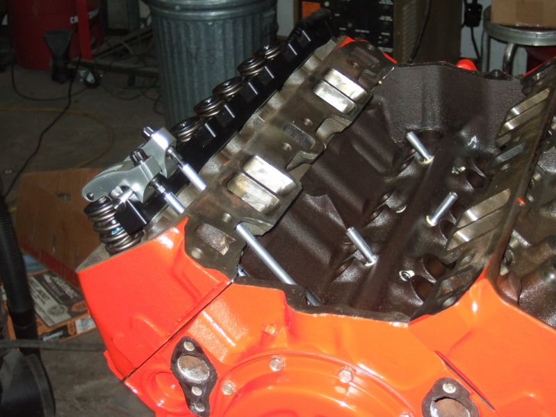

    Oil pressure is 35 psi with a cordless drill. I ordered pushrods yesterday, then I added oil and a temperary oil pressure gage and set up the drillmotor to turn the pump. I started getting pressure almost immediately, then pump started ****ing air. I only put 2 quarts in and 1 probably went to filling the filter, so I added a quart and ran the drill for about 2 minutes. I saw oil comming out the holes in all the lifters. So far, so good:)

    Enjoying following this build. I'm a flathead guy, so am a bit Chevy ignorant. What are those shiny post things in the valley?
    Thanks.
    Mart.
  10. joel
    Joined: Oct 10, 2009
    Posts: 2,732
    joel
    Those are little aluminum pipesd screwed into the center drain holes in the valley; there are 8 holes and 4 are plugged. the pipes are in the other four. They allow crankcase pressure into the valley/ cyl. head area, but the oil has to return down the holes at the valley ends. It's supposed to reduce the oil mist the crank runs in. I thought it might also help reduce oil carryover in the PCV system. I think roundy-round guys do this; it's not stock.

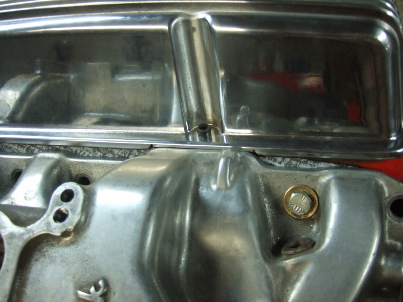

    Here is a little update for the guys following this. I had some interference using the shaft/ rocker set up and I didn't want to waste the Cometic head gaskets, so I used some Comp " Ultra magnum " rockers.
    I have some old Cal Custom valve covers, but they won't clear the rockers. I'm going with the ones in the pic for now; maybe after I'm on the road, I'll make some spacers to use the old covers.

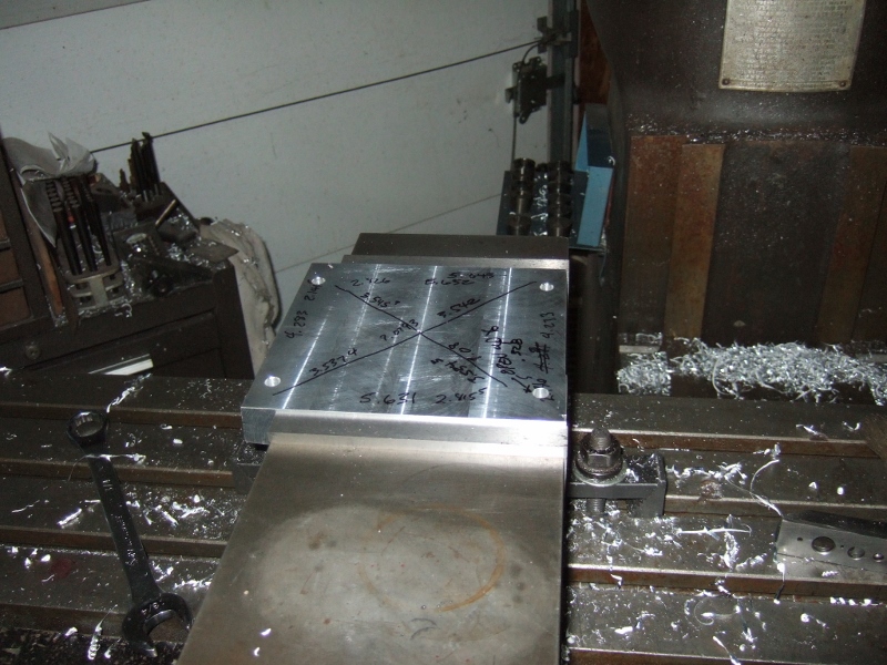

    This is the first operation for milling the intake. I squared a block of aluminum and milled 3 degrees onto the surface to go against the carb mount surface of the manifold. The next pic is drilling the mounting holes perpendicular to the 3 deg surface.

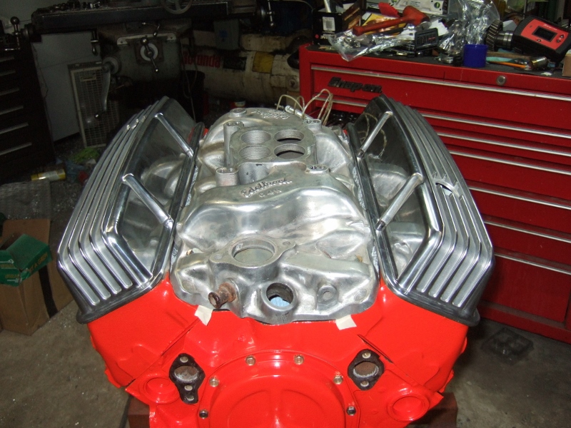

    I then removed the manifold and test fit it on the engine. It seems to be about right, although I still have to machine the flat rails on the end of the manifold. I also found that I had to remove a lip from the valve cover rail to clear the manifold runners.
    So, it looks like a little more machining, some cleaning on the manifold , maybe fix one of the carb stud holes and I'll be bolting on the carb.

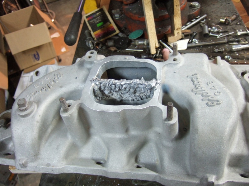

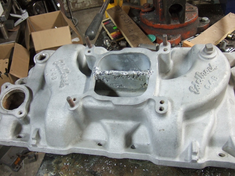

    Hi Joel, I am a little confused (That's not unusual) This manifold looks different than the one you were welding in in post 125. Why did this one require the machining. A mill is one of those tools I have not acquired yet but would like to have. I just have a hard time justifying the expense and space issues for the small amount of work I would think I would have for it.
  15. joel
    Posts: 2,732
    joel
    You're right, it's not the same manifold. I went through the welding process because that one was the earlier style and it was in the worst shape ( needed the most repairs), but realistically why go through all that for a unit that is hopefully temperary. I want to use the Manafre down the road.
    The machining is required because I had the heads milled .020" to get the static compression above 10:1. I had access to a mill and all it's supporting cast for over 25 years at work ( after hours ) and after I retired it seemed like I couldn't do anything without one. I think it would be more economical to find a person/shop that can provide the service and quality you need. JMHO.

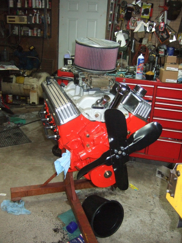

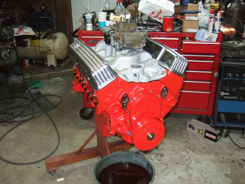

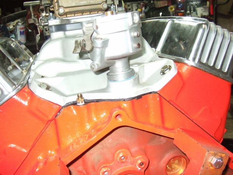

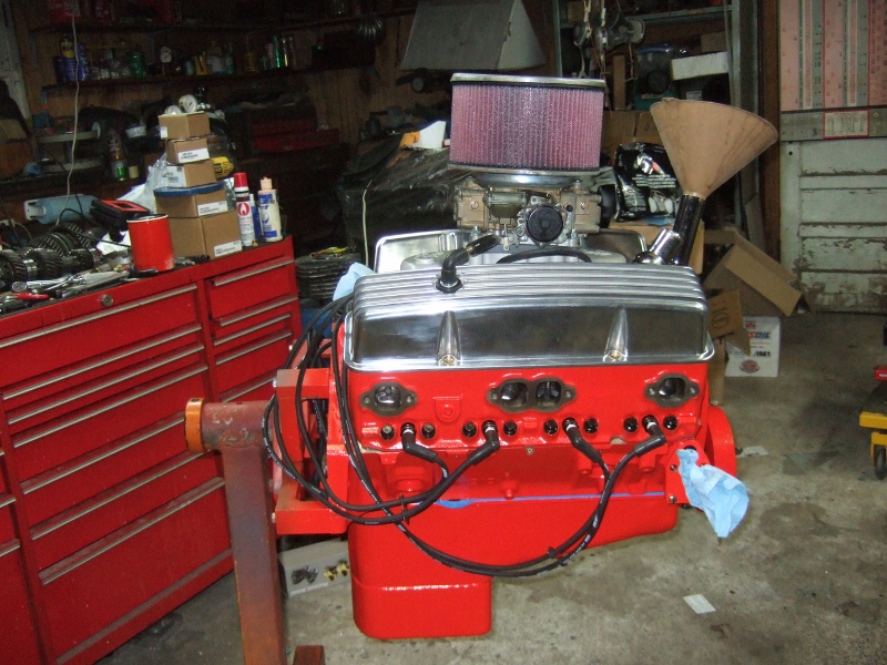

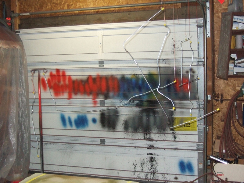

    Finally ,the engine is complete carb to pan. I have plug wires and air filter element coming Wed. I used a clear epoxy from Eastwood to protect the manifold and I pulled the brake lines and cleared them also. Tomorrow I'm going to get a thermostat and o-ring for the thermostat housing. I also made a shim for the dist.
    clear sprayed on brake lines.
    shim is .045"

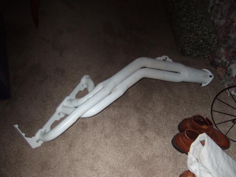

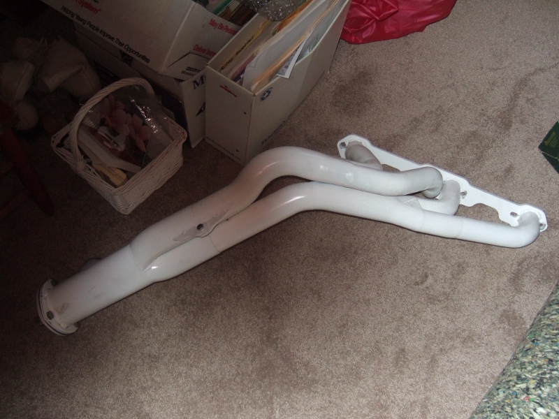

  23. joel
    Posts: 2,732
    joel
    HotrodA is correct; the dist. is a 4 lobe Mallory YC. I have enough parts to use it , but I've been looking for replacement consummables ( points ,rotor, cap ).
  24. joel
    Posts: 2,732
    joel

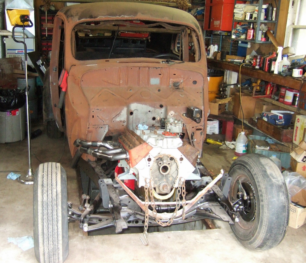

    The headers are home made. I bought the flanges and tubing from Speedway, but I made the transitions. DSCF0014 (1024x880).jpg
    This is the only pic I took during header construction. I had to make them 2 piece to install them after the car is ***embled.
  25. OL 55
    Joined: Nov 4, 2005
    Posts: 14,824
    OL 55
    Very nice. I should have figured that after looking through the build thread. You're one of those tallented fellers that I hate so much! ;) :)
  26. joel
    Posts: 2,732
    joel
    Thanks for the kind words; I think most of the time, more stubborn than talent. I first thought of that design when I was a kid, but when no one made it commercially, I was stuck doing it.;)
    P.S. I have since seen a company on the web ( can't remember the name) that makes those transitions.

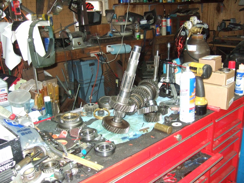

    Last is the cluster shaft & a couple of gears

    Thanks for the update Joel, The motor looks great! You must be a genuine gear head judging from that pile of trany parts!
