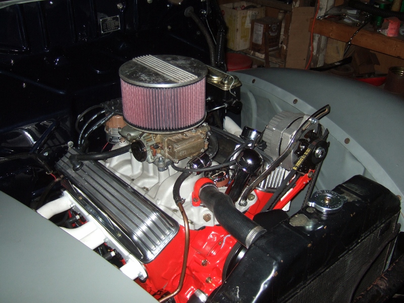

    Soon, I hope Jason. I got to set a few things; timing and some carb adjustments. I had a vacuum gage hooked to the carb base fitting and with the timing @13 deg btdc it was idling at about 950 rpm and 9 or 10 inches of vacuum. The temp got up to 190 and the 4# cap was p***ing a little water out the overflow.
    I think I need a newer radiator. It's an original that's been recored. The radiator shop pressure checked it and the top tank balloons at about 5 psi. Oh well, it was worth a shot.

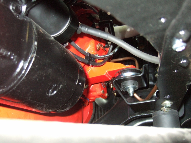

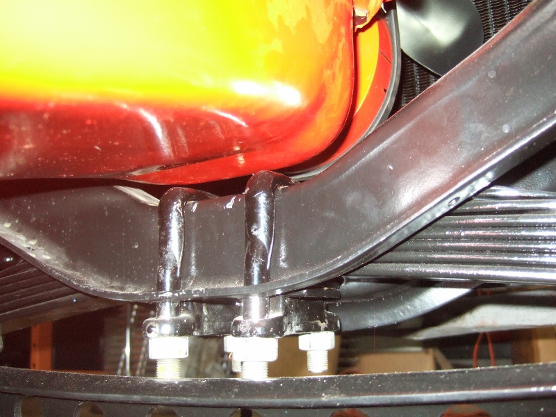

    Pix of the mounts installed and the pan clearance.

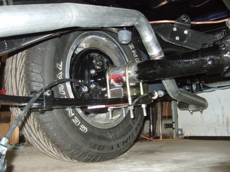

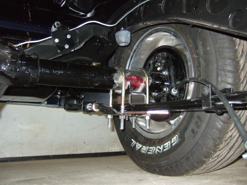

    More pix of the rear end, lowering blocks, etc. and all ready to tack the spring pads to the axle.

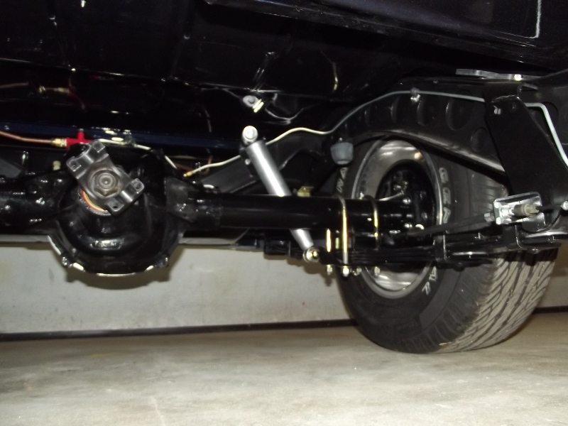

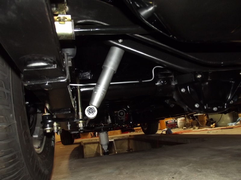

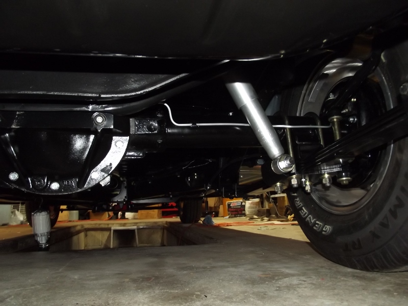

    Here it is; the rear end is done , in , bolted down with shocks, sway bar and the brake lines installed. I broke my little Fuji digital camera and lost some of the pix. Here is what I saved.

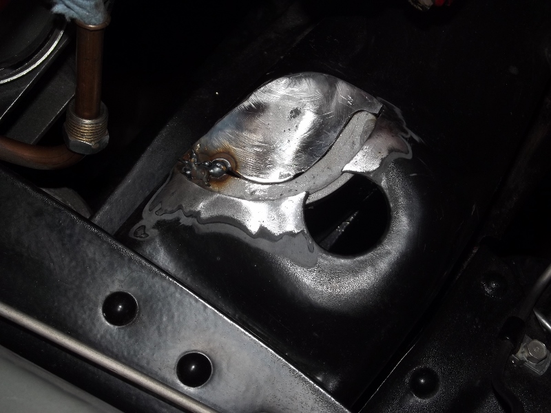

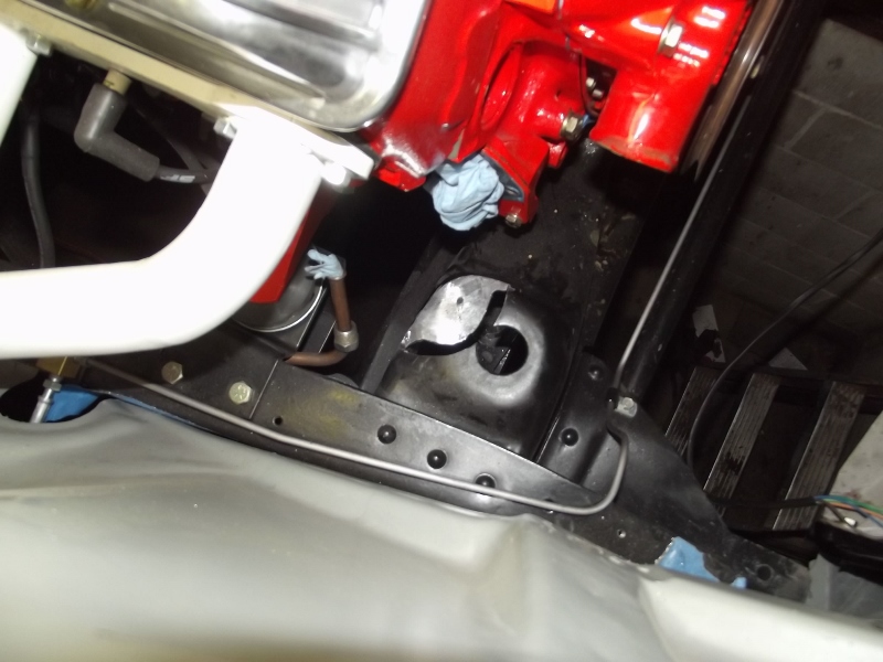

    The next pix are of the modifications to the front crossmember for increased fuel pump clearance . I had dropped the front of the engine to improve the u-joint operating angles. ( post 205)
    I cut the clearance wider, the depth is ok. This is the patch
    The patch is tacked in place.With some welding and a little paint, I can put the fuel pump back in.
