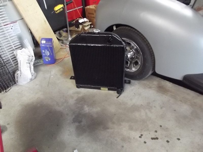

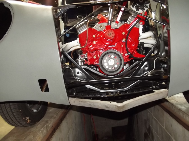

    I went around the block yesterday; that was good. I have to work on the Z bar ratio a little more and I'll have to make a offset rod to compensate for the changes. I have a few pix of my latest activity.
    This the modified fender support after dropping the cross bar to compensate for lowering the front of the engine 1/4"
    The new Custom Auto Radiator and after setting it in place.

    Hi Joel, I've been following along, cool build with 'lots of info. I jsu noticed your radiator and that you have the inlet and outlet on the same side, will the flow of water be good enough for cooling? I ask because ideally I need that setup on my 40, but was concerned about the flow, as i thought it would be better entering one side and leaving the other. Who made your radiator, looks like a 40 which is preferable for me. I've had mine re-cored, and love the br*** tanks, but am a little concerned about the pressure.

    This is a link to the guys that made my new radiator; I highly recommend them. They put a baffle in the top tank that directs the coolant to the drivers side before it can p*** through the core. My stock re-core would only take about 5#. The new radiator will take 15#.

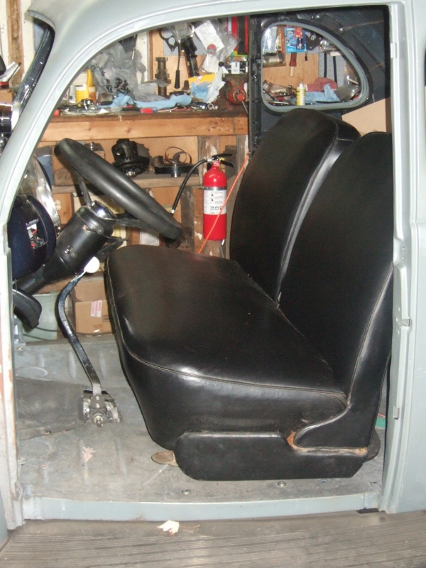

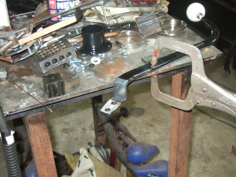

    I got the power valve (4.5) and will install it this afternoon. I've reworked the shifter handle to get more leg clearance

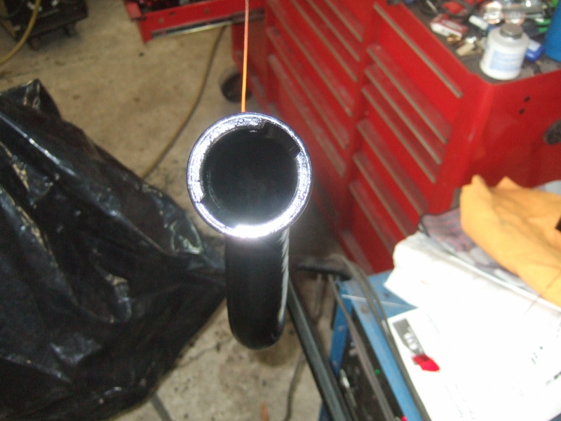

    I also cleaned up an original fill tube for the gas tank and painted it. I have 1/4 tank of gas and I was smelling gas when I opened the building in the morning; it was faint , but it was there.

    Do you have a vented cap? I'm using a "Tanks" tank with the vent on the top of the tank and I don't want to route that vent hose through the inside of the car, so I'm plugging the tanks vent and using a vented cap, like original. When I last had this car running, I didn't have a garage; I have no idea if smelling fumes is normal...:)

    I have the same Tanks Poly tank and I ran the vent line outside the body and have the vent inside the drivers side rear fender with the line tight against the inner fender panel. I get very little gas smell in the garage. The cap is non-vented

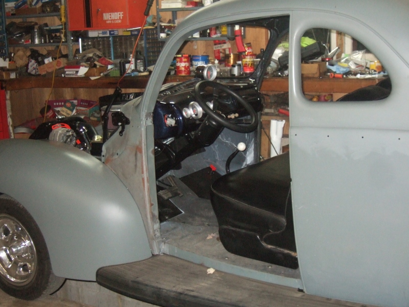

    I installed the 4.5 power valve and adjusted on the carb a little. I think that did the trick. I found out the panel covering the shifter needs to be changed to allow the boot to fit on the stick right. Now I wish the body and paint was done so I could drive it.:(

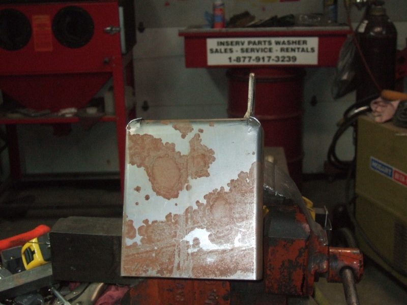

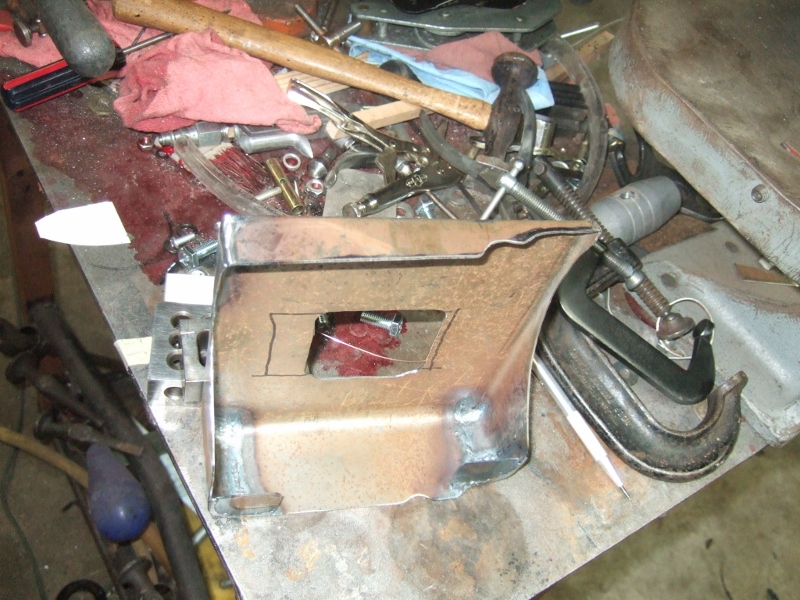

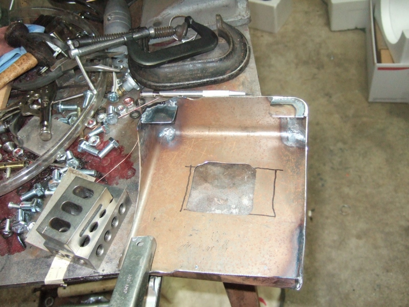

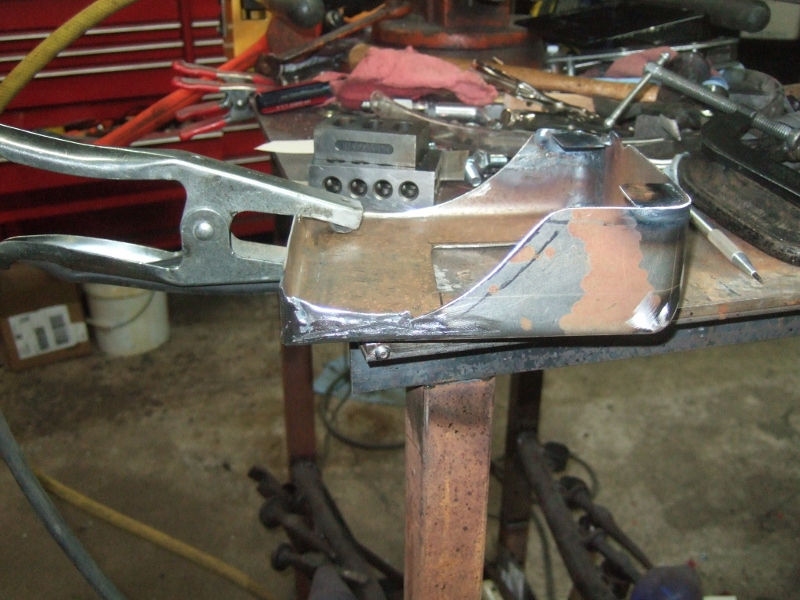

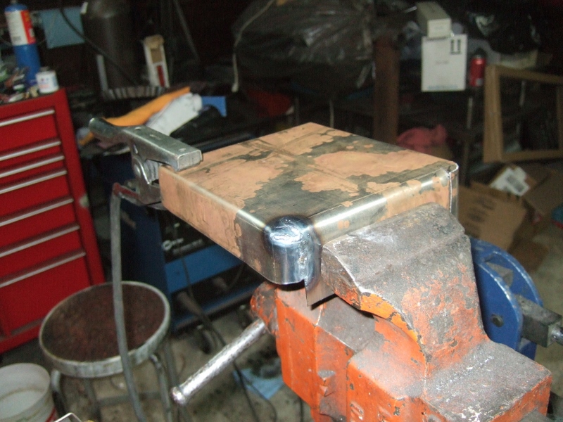

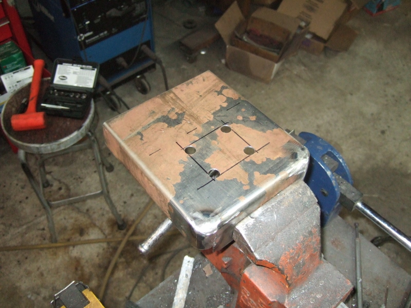

    I have a small project going after it's to dark to pick up leaves. I had to do something after I reworked the shifter handle because the boot was off the little box I had made previously. Anyway, this piece is 18 ga. cold roll made without benefit of all those wonderful machines that fab shops have. The only tools I used that some guys might not have are T dolleys DSCF9653 (800x600).jpg DSCF9654 (800x600).jpg
    Top pic is with 3 sides bent. The top was done last with a dead blow hammer over a 1" dia. T dolly. The vertical sides were done clamped to the table with a piece of angle iron and the dead blow. The bottom pic is with the corners notched, the rolled over the dolly and trimmed and welded.
    Next is the corner holes to make the hole for the shifter stick and above is the "box" after mucho t******* and fitting to the floor contours. I added feet to 2 corners for mounting. The edge in the foreground was bent up and scribed with a Sharpie many times. These pics cover about 6 hrs. actual work. DSCF9657 (800x600).jpg DSCF9658 (800x600).jpg
    The top shows a piece I had to add back in because I couldn't figure it out ahead of time and the last one is almost all of the fitting done. I had to move one side of the shifter clearance hole about 1/8".
    Some of you are thinking " don't give up your day job" ; fortunately I don't have one.:)
