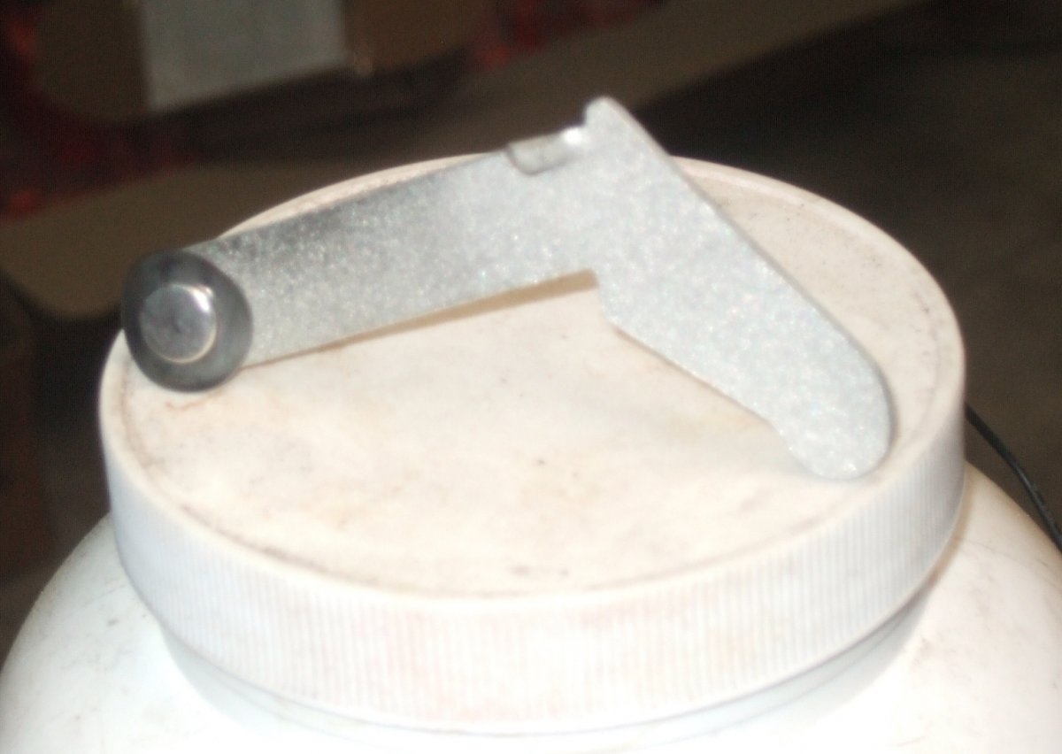

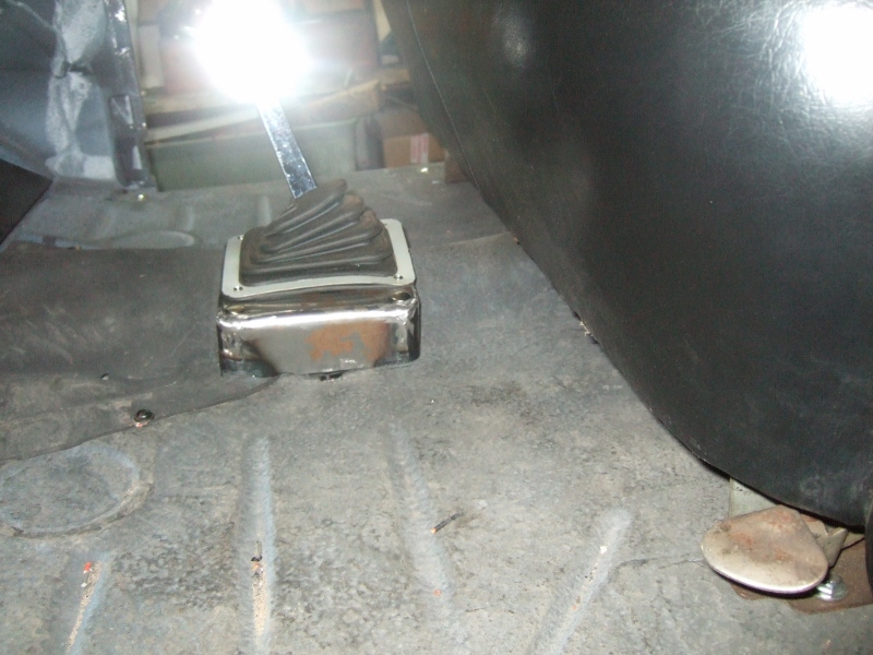

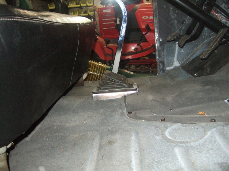

    I haven't decided what color to paint it yet, but it's done. The little chrome ****ons on top cover the access holes for mounting. I've been looking for a black rubber floor mat; if I find one, I'll paint the box black. If I chrome the garnish moldings, maybe I'll plate the box and carpet the floor. DSCF9659 (800x600).jpg DSCF9660 (800x600).jpg

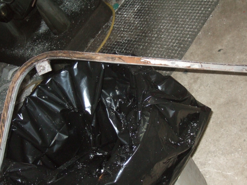

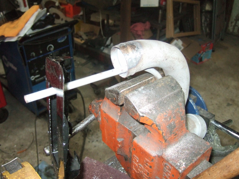

    The small pix are the first box I made and an experiment on fixing a tank filler neck that was "pin holed" at one end. I used silica bronze and the tig and it worked pretty well.

    Looks good Joel! Now you will need a heater since the hot engine air can't blast through that shifter hole:D

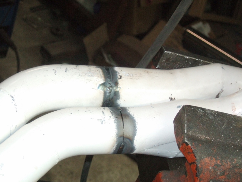

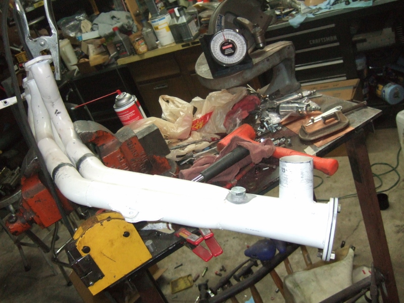

    The heater is a ways down the list, but it's on there. Now , I'm working on the last ( I hope) of the issuea left from moving the engine to correct u-joint angles. I started installing the exhaust, and the left side interfered with the fender/ running board joint.

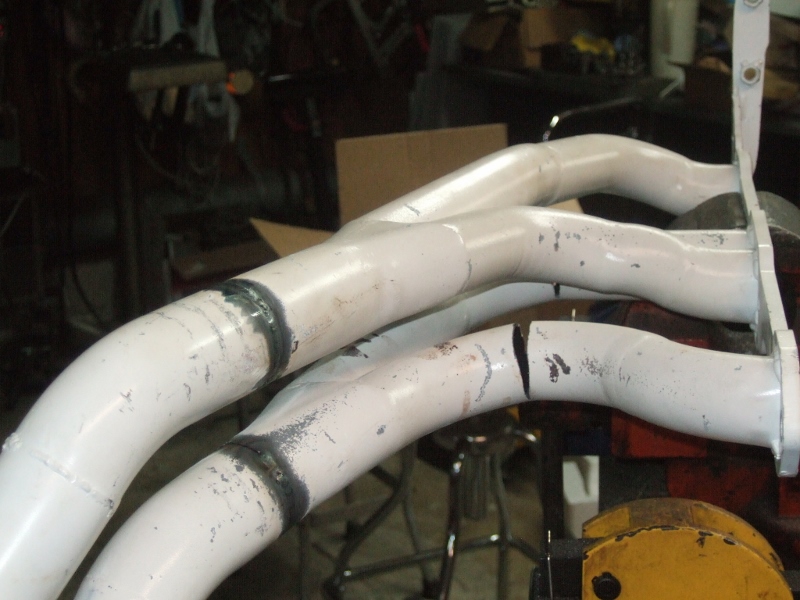

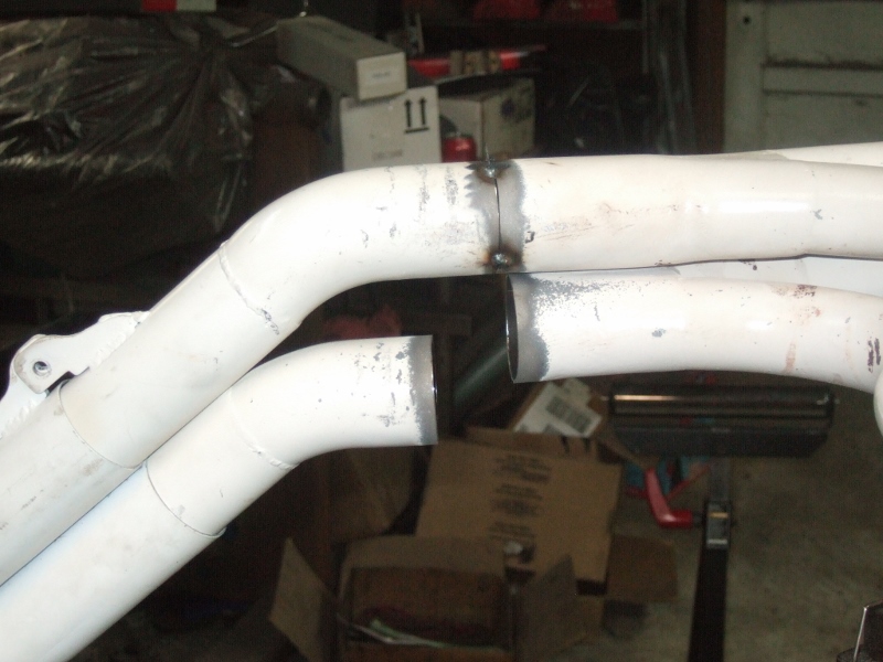

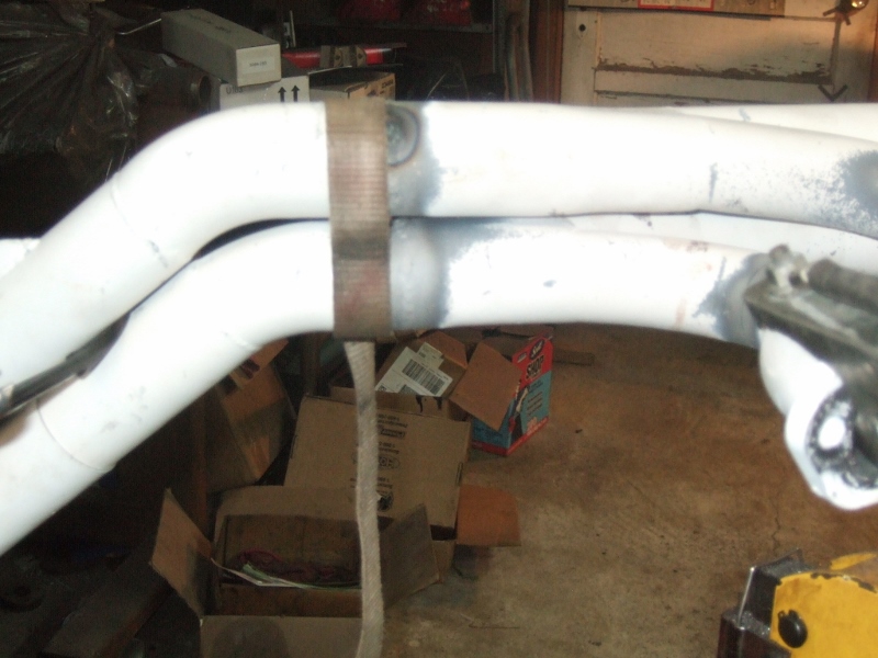

    After a couple of days of studying the issue, I thought I could shorten the headers in section where there is a straight section of 2" pipe. The 2 pipes were too close to weld 360 deg joints; here is how I got around that. DSCF9664 (800x600).jpg
    Next, the top is completely welded and the bottom pipe is done except the space under the to pipe.
    I cut 1" out of each pipe and staggered the joint so I could weld the top one complete. I was able to use the slip on collector and scribe marks to help with re-alignment. I tacked it up and installed it to check for fit. This is the first attempt; I had to cut these and rotate the top slightly and re tack them.
    Above , the bottom pipe is being welded. Also I added bungs for the Air fuel ratio gauge I bought.
    I cut the 2 head pipes, not all the way through, to allow the lower pipe to be bent down enough to finish welding the 2" joint in the foreground. The next pic is moving the pipe back into position using a rachet strap
    Then the head pipe pipes back together.
    The last 2 pix are turning and twisting to get the welding all done. I blasted most of the pipe and am in the process of repainting now.

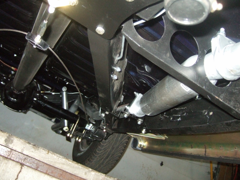

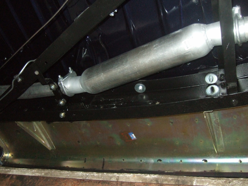

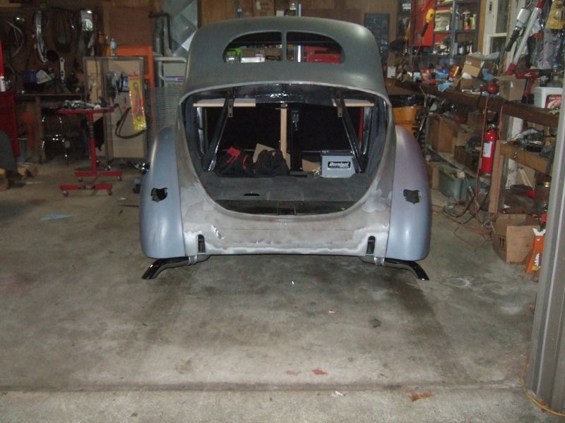

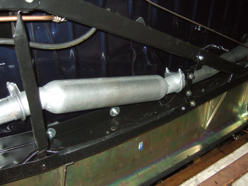

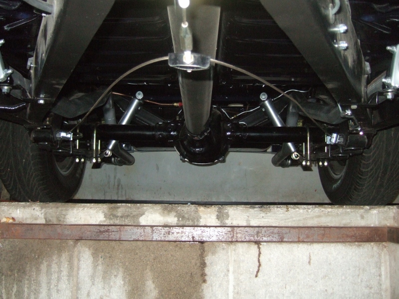

    Here is some catch up on the exhaust reinstall. It should be short and sweet, but....
    I didn't expect the pipes to all fit perfectly after moving stuff like I did, and it didn't. I had tucked the Flowmaster mufflers neatly into the frame, but with the body on, there was just not enough room to wiggle the pipes together. Or maybe, I didn't have enough patience. I spent a couple of days looking at round body mufflers. ( Porter, Cherry Bomb, Thrush, Brockman) I decided to go with Brockman and the last couple of weeks have been tweaking pieces until everything fit. Here are some pix of the system finished and installed.
    DSCF9673 (800x600).jpg This is the compe***ors preview :D and some thumbnails of the details.
    DSCF9674 (800x600).jpg DSCF9675 (800x600).jpg DSCF9676 (800x600).jpg DSCF9677 (800x600).jpg DSCF9679 (800x600).jpg DSCF9681 (800x600).jpg DSCF9683 (800x600).jpg By the way, I can here the solid lifters now.:)

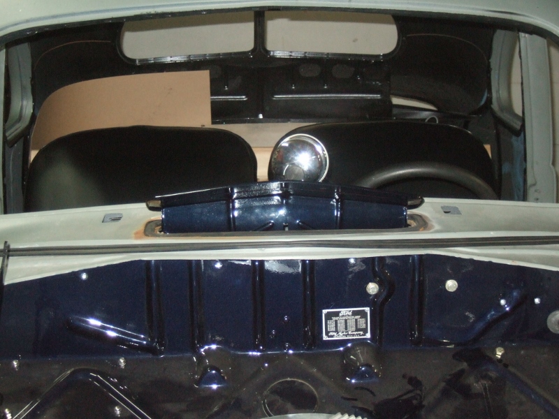

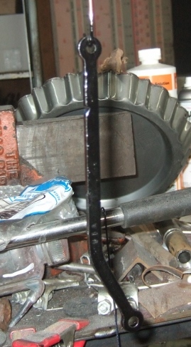

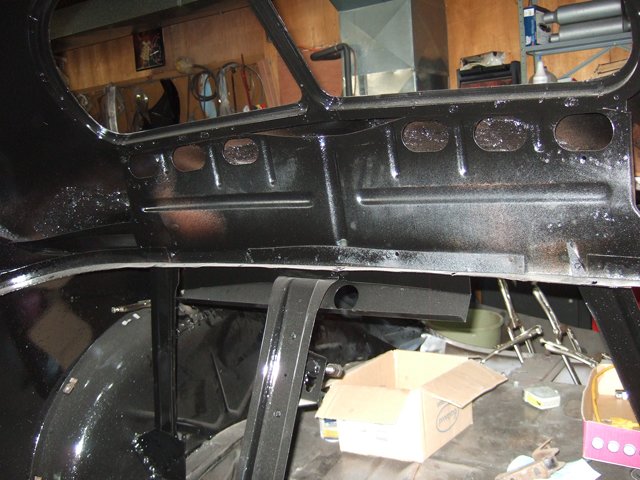

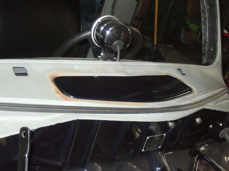

    I installed the cowl vent to get it aligned and the3n I'll have to remove it for priming and paint. It fits pretty good.

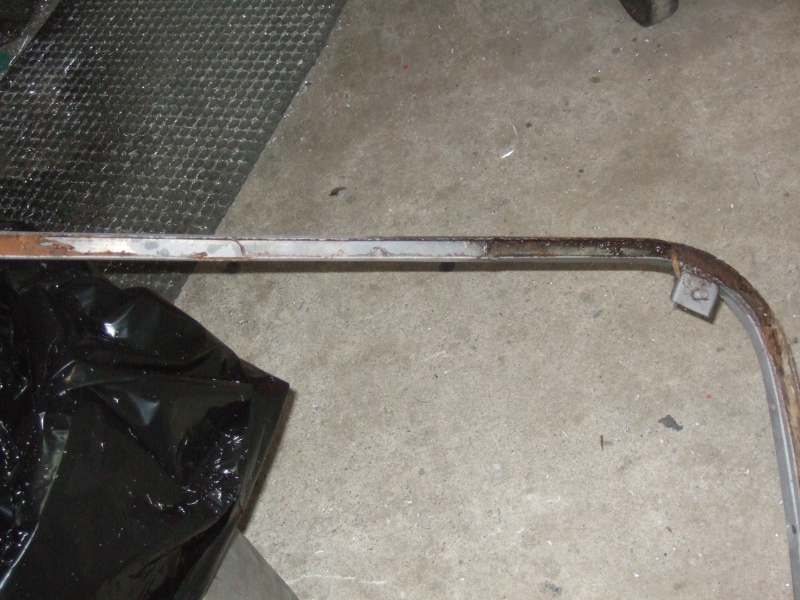

    I've been moving stuff around in the garage in preparation for starting the body work. I ran across the frame for my seat, which I knew needed some work . It's going to need some channel made to hold the tack strip; about 1/2 of the channel is rusted away. I blasted it the best I could and welded some pits. I made I little patch where it was pitted through.
    This seat frame is specific to a 5W coupe and is much different in construction than the sedan/convert./business coupe seat I have in the car now.
    DSCF9693 (800x600).jpg DSCF9692 (800x600).jpg The main part of the frame is not bad; it's just the track that the cardboard roll was pinched into.
    top pic is the adjuster track; it's pretty nice for 75 yrs old. The bottom pic is the frame after blasting; it's hard to see, but about 1/2 of it is undamaged.
    DSCF9696 (800x600).jpg DSCF9697 (800x600).jpg Weld repairs.

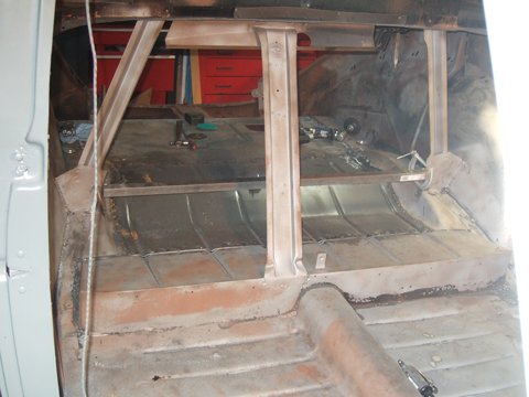

    I'll see what pics I have to show the main difference between a 5W coupe and the business coupe. The seat you have sounds like the Business Cpe/2dr sedan/convertible. Post a pic of what you have. T he Business Cpe has 2 verticle supports, from just below the rear windows , down to the floor and the step in the floor pan is almost directly under the rear windows. EDIT. here are 2 pix of a 5W
    Thanks, I think they are going to be OK. By the way, I talked to a shop in Indy about that SpectraChrome spray on stuff on my window moldings. It looks good in the pictures.

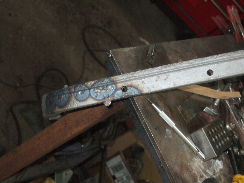

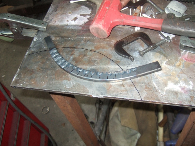

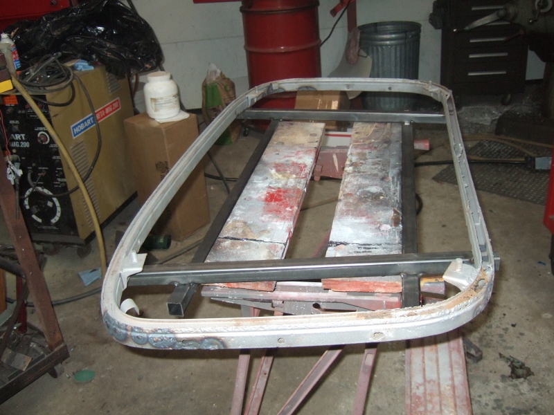

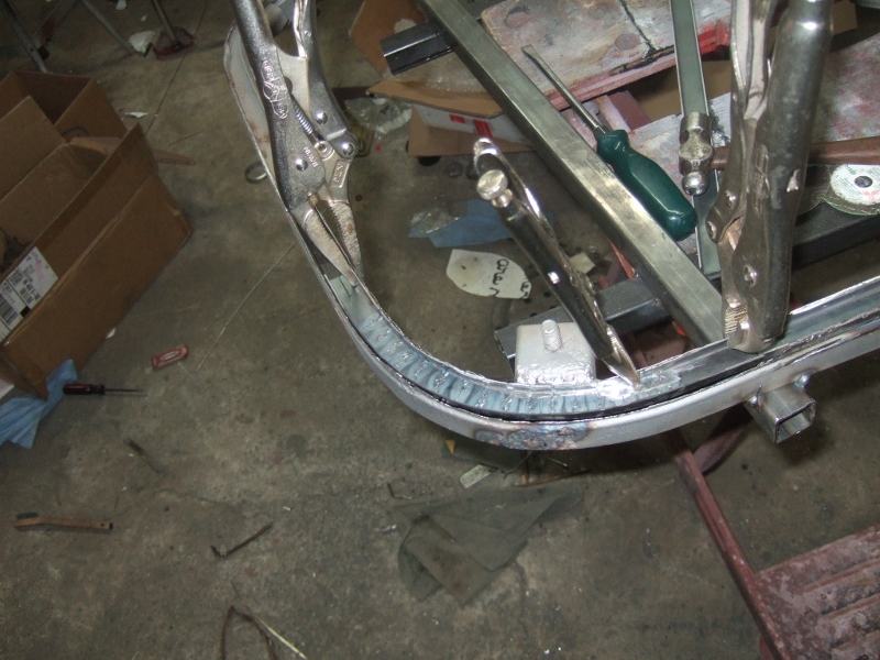

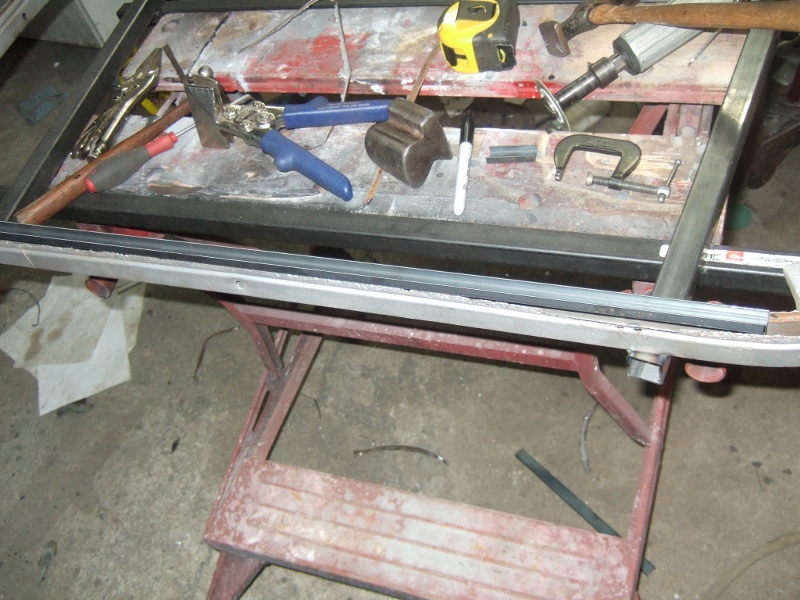

    It has been a while, but I have been working on that seat frame repair. John made me some U channel and gave me instructions on how to fit the corners. I took a few pix of the process. DSCF9708 (800x600).jpg DSCF9709 (800x600).jpg
    I welded some i" square tubing together and tacked the seat frame to it. The bottom pic shows some of the rot left, but the right side channel was already gone. I started with that section first and made just 3 cuts to accommodate the slight contour. See below.
    You can see the outside edge of the frame is pretty eaten up, but I think there is enough to weld to. The next pix is of the corner pieces. DSCF9715 (800x600).jpg DSCF9716 (800x600).jpg
    The top pic is the corner with pie cuts and partially welded and the bottom is installed and tacked in place. This is for a tacking material strip and all will be covered by upholstery.
    The last 3 pix are of the other corner and the last pic is the clamping so I could start tacking. The little indent, shown in the pic, is on both sides of the frame and gave me a little "shelf" to set the new channel on. there is one more little piece, about 3" long and it'l be done, yea!

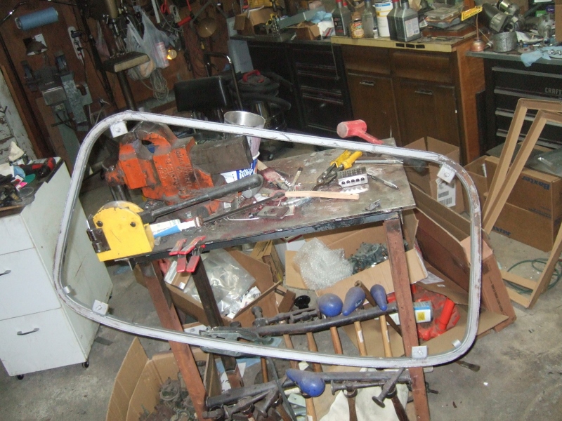

    I have some catch up to post as I have been trying to finish up some small items and procrastinate on the big next step.. BODYWORK. Anyway here are a few pix

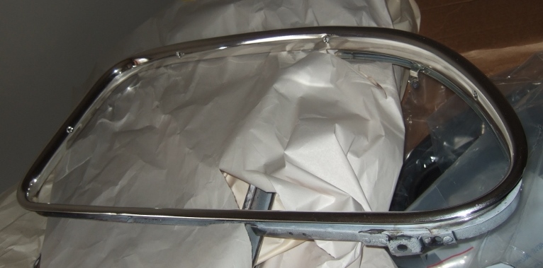

    DSCF9722 (800x600).jpg DSCF9723 (800x600).jpg Hood latch support and linkage. This came up when I got serious about aligning the hood. Below is the safety pawl that I replated using Eastwood's plating kit. DSCF9726.JPG
    The last pic is of the "chrome " garnish done by Indy Paint. I don't think anyone will confuse it with chrome, but it's not bad. DSCF9742 (800x600).jpg
    it probably looks better here than in person.
