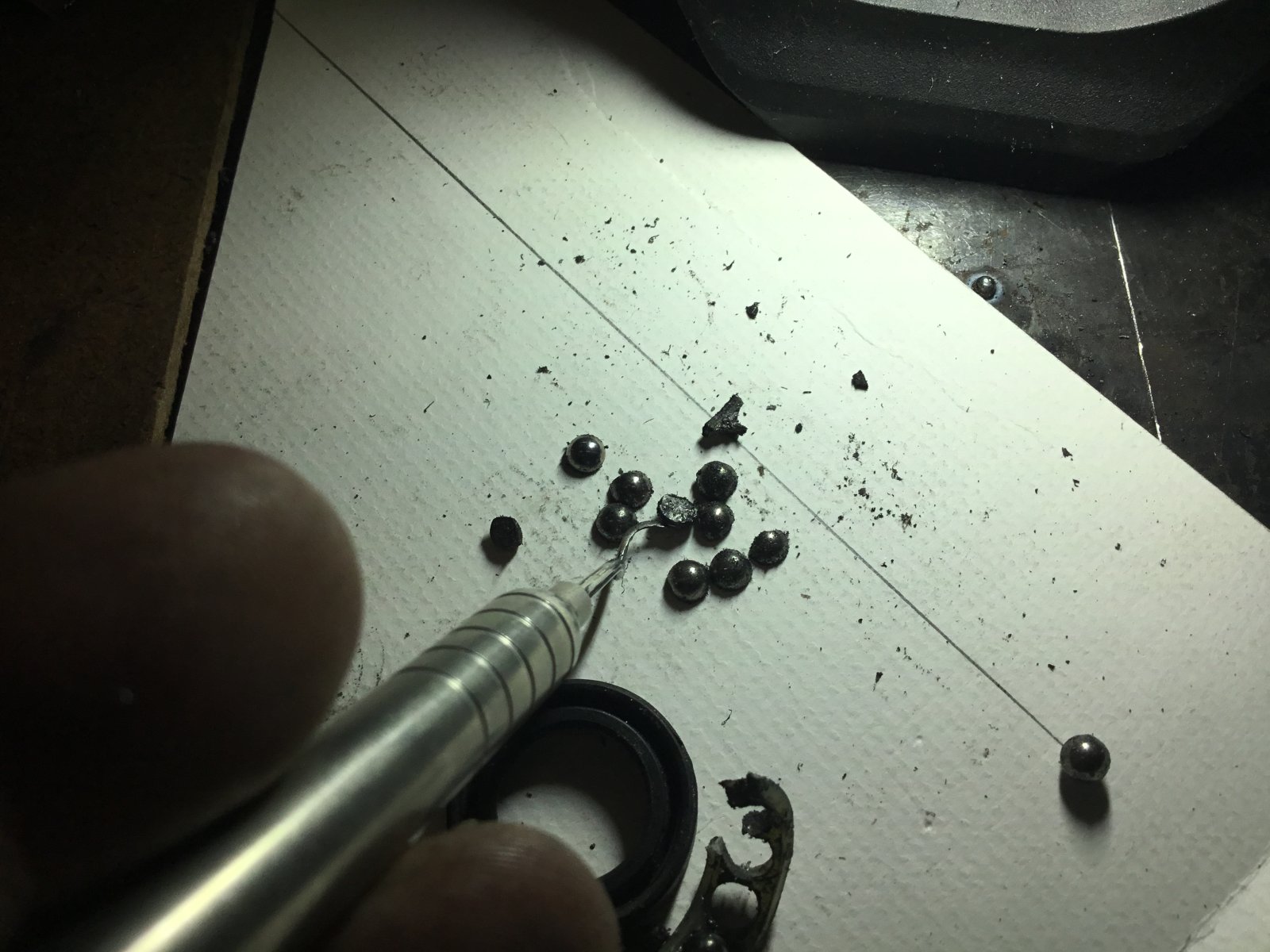

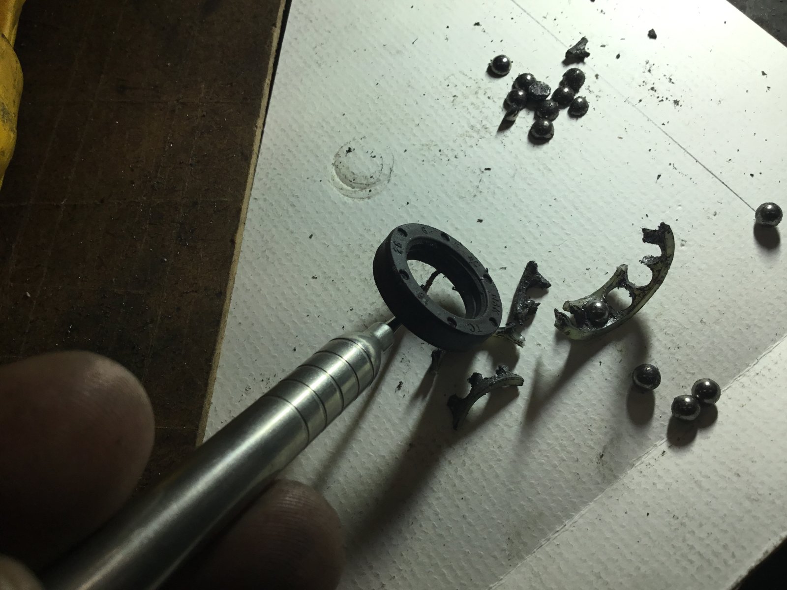

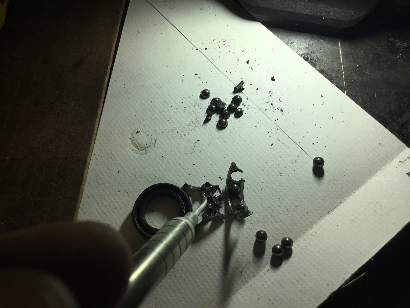

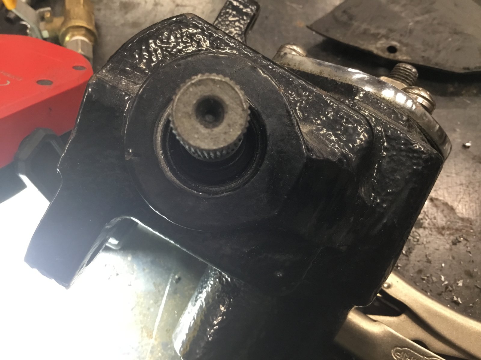

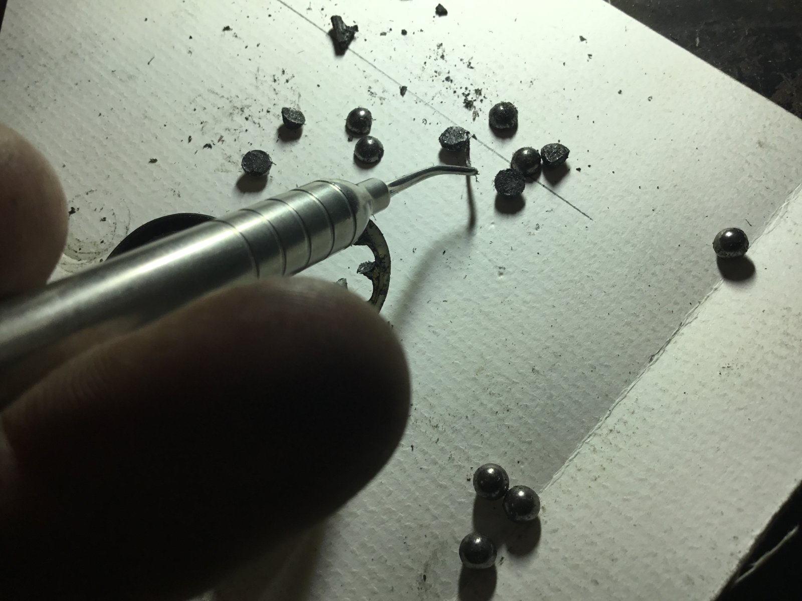

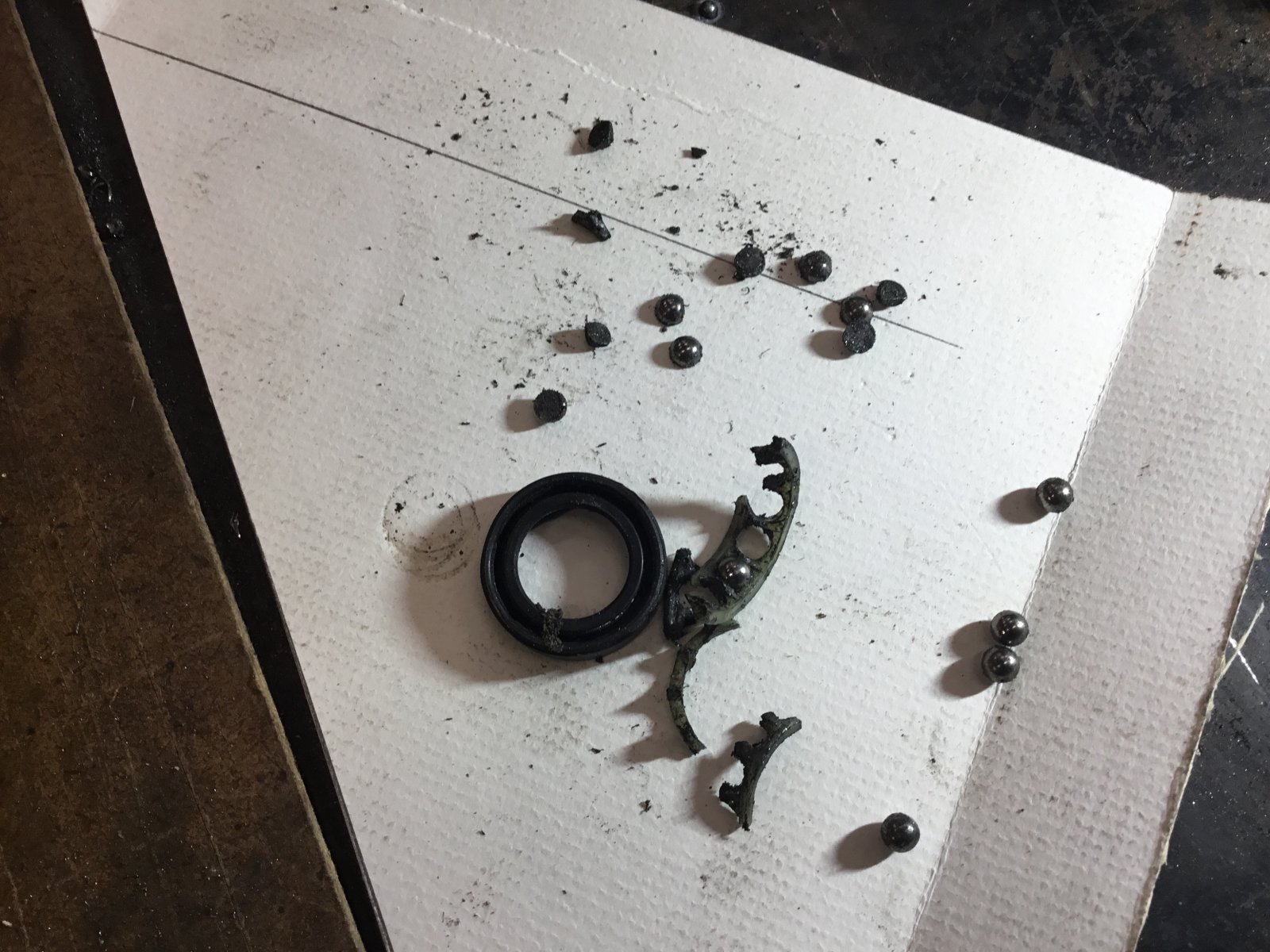

    So, I bought a model A coupe that was someone else’s incomplete project. I believe the fellow building it may have p***ed, and the car was never on the road. It was pretty close, but still needed a lot of little things. Most of the parts were new, the engine was brand new. Anyway, I put it on the road last August and drove it maybe 150 miles total before winter. There was a few teething problems which is to be expected with a newly built car. Most troublesome was the steering felt muddy and loose. The car has a cross steer Vega box setup. I checked all of the moving parts for any slop, and I became convinced that the source of the looseness was the (brand-new) Vega box. I ordered a Borgeson box and figured I would swap it in over the winter. I just pulled the Chinese box today and swapped in the new Borgeson one.
    Here are some pics of what is left of the output shaft bearing on the Chinese box. About 10 of the balls are worn flat. To the point that only half of the ball is left. I am stunned at how poorly it was built. I know this has been covered plenty of times on this forum, but I figured it was worth sharing anyhow..

    A friend of mine gave up trying to adjust a brand new Chinese 'vega' box in a fresh build. He replaced with a used Saginaw and all was good. He stripped the Chinese box and also found the balls were not round. And this was a new box with very few miles! Had to be in the manufacturing.

    Wow - complete bearing failure - what did the race look like - any lube?

    Any mgfr name on that box, or who-sold-it-receipts? Would like to know, so's to "reward" the mfgr/seller w/*no* purchases. &, how are the races & gears? Got me wondering if R&R'g the balls w/decent stuff prior to use, would get something useable(for those that own already). I'm guessing the rest of the box-parts are also junk, but maybe not?

    Haha. Yeah, I put a work light right on the parts, and the camera didn’t much care for it. I am not a photographer. The shop is plenty well lit (my avatar pic is taken in the same area) . I suppose I should add photography to the list of things I am not good at….

    Those balls don't look like they recirculated very well.

    I don’t know the manufacturer. I suspect it is from Speedway as there are quite few speedway parts on the car.
    The US made Borgeson was much less costly than I would have thought (under $400 w/tax and shipping to Detroit). I would have bought the Borgeson one if there was not one in the car already. I have a funny thing about safety components.

    I'm guessing something else failed causing the ball bearings to break. Which is hardly any better.
