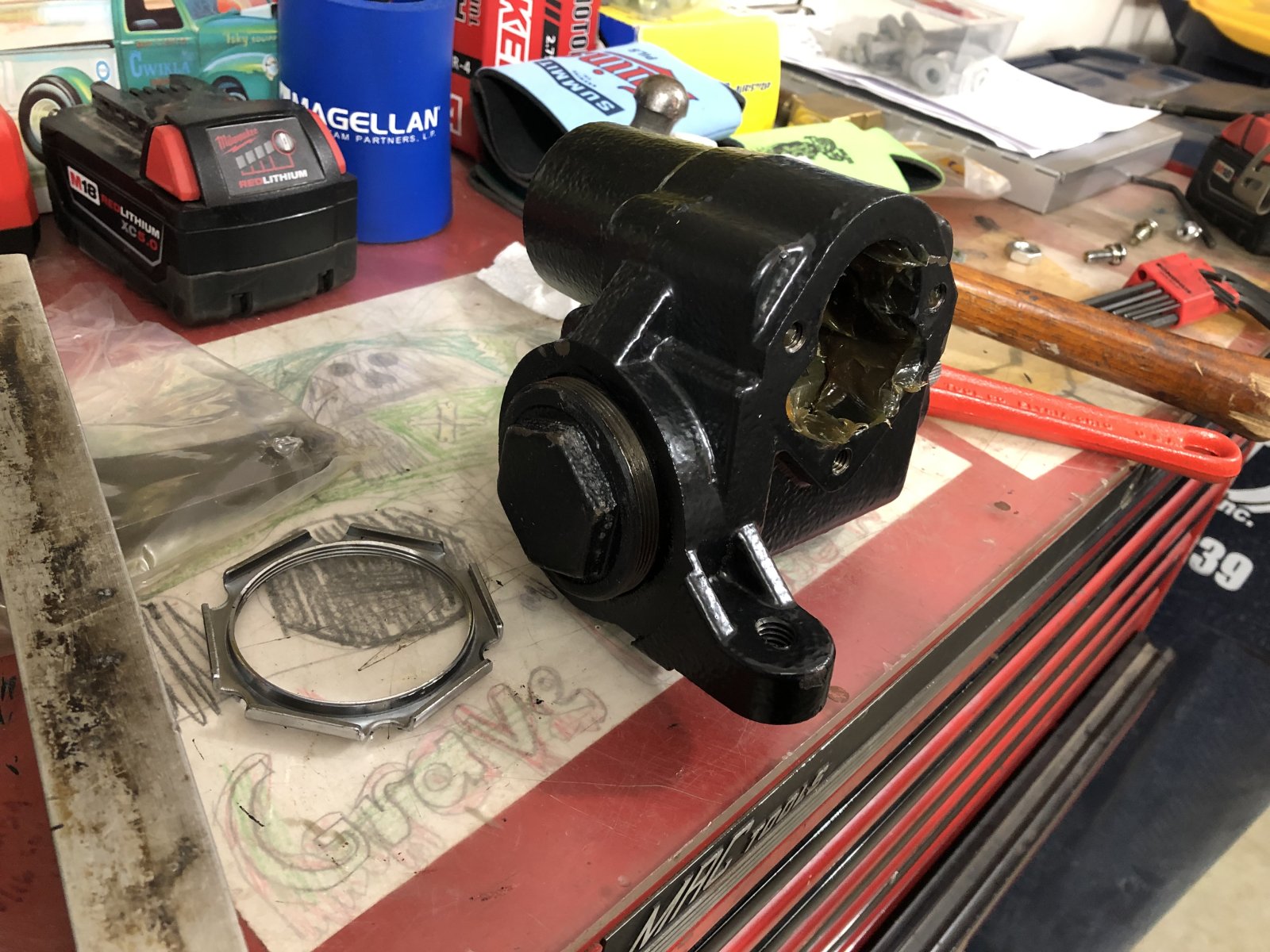

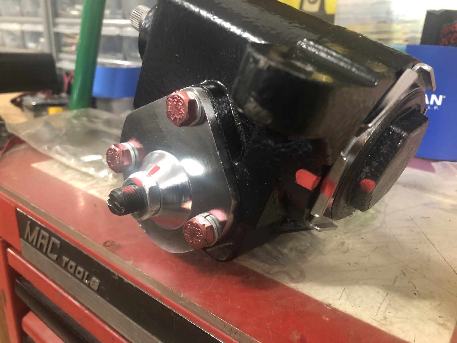

    The fact that it seems no one has looked into this any further than bashing Speedway and China slightly amuses me. I like to compare these conversations to wheel bearings and their proper adjustment because I believe most folks understand wheel bearings better. Ask yourself a few questions…after you adjust wheel bearings, do you drive around the block and then re-adjust them? You know, to “break them in”:rolleyes:. Do you adjust them with the weight of the car on them? Of course you don’t. Maybe you can also grasp that bearings are metal on metal and once set properly, they will not need any adjustment for a really really long time, if even ever. People can also probably understand how that wheel bearing would perform if was set too loose, or even worse, too tight. I think I’ve made my point on that subject, let’s move on to the steering box now. In the steering box, there’s multiple bearings to be concerned with. There are bearings that affect the performance of the box that are adjusted by the big nut / lock ring and then the “normal” adjustment that is controlled by the adjustment screw. According to nearly every person and every instruction manual I’ve ever read, you’re supposed to adjust the box with the single adjustment screw provided on the cover plate. And this, again in my opinion, is where the problem is. I’ll state right now that I have read the Speedway instructions and watched the Speedway video on adjustment on YouTube and they are simply both wrong. There’s some general consensus that the large nut with the lock ring is properly set from the factory and is not to be touched. And it would be such a great world if that were true…we deserve that to be true, as proud Americans. We deserve, if we buy something with multiple bearings in it, to only have to adjust 1 of those bearings (pounding fist on table). God damn it! This is a travesty! USA USA! Sorry , I got carried away…
    So yeah, the big nut “adjustment “ is the problem. The child ***embling the box doesn’t care and doesn’t know that if the big nut is too tight, the box will never be smooth and the owner driving it around the block and continuously adjusting it with the adjusting screw will never be happy. The reason the big nut is often too tight is because I suspect whoever ***embles it…1.) doesn’t know and doesn’t care what a properly adjusted bearing “feels like” (not too tight / not too loose) and 2.) When they tighten the lock ring, they don’t hold the big nut from slightly tightening at the same time. The big nut wants to tighten when the lock ring is tightened and you must hold the position of the big nut while you tighten the lock ring and obviously they don’t do that. The big nut needs to be “right” before moving on to the “normal” adjustment screw.
    Ok, I’m going out to the garage now and am going to switch the cotter pin on my wheel bearings from the “feels right” spot on the castle nut to the next tighter position.o_O

    So, anymore pics of the worm n sector, races, & inside of the box? Guessing the ball bearing chunks tore everything up, but am curious. It had to come apart somewhat to get the chunks out?
    So, in theory, if the balls would be replaced w/quality & w/the correct # of them, & Chuckys' adjusting advice followed, is this PoS salvagable for actual use? I've got 3 low mileage Vega boxes, so don't need Speedy-"stuff", although if the box is alum, & salvagable(safety), it *might* make a ersatz-alum-'vair. ???
