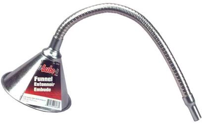

    Attach some hose to a funnel, gets you far enough in to work. Had to do it to a 64 Buick with the filler under the license plate.

    A long neck funnel can solve a lot of problems.

    I know it’s a ot vehicle but my 2007 Ford F-150 you must hang your tongue out the left side of your mouth while having to pee really bad with the nozzle barely in the gas fill 1” to put gas in it. The only vehicle I have ever had where it was almost impossible to put fuel in it. Until I figured that out I had to use a large long funnel.
