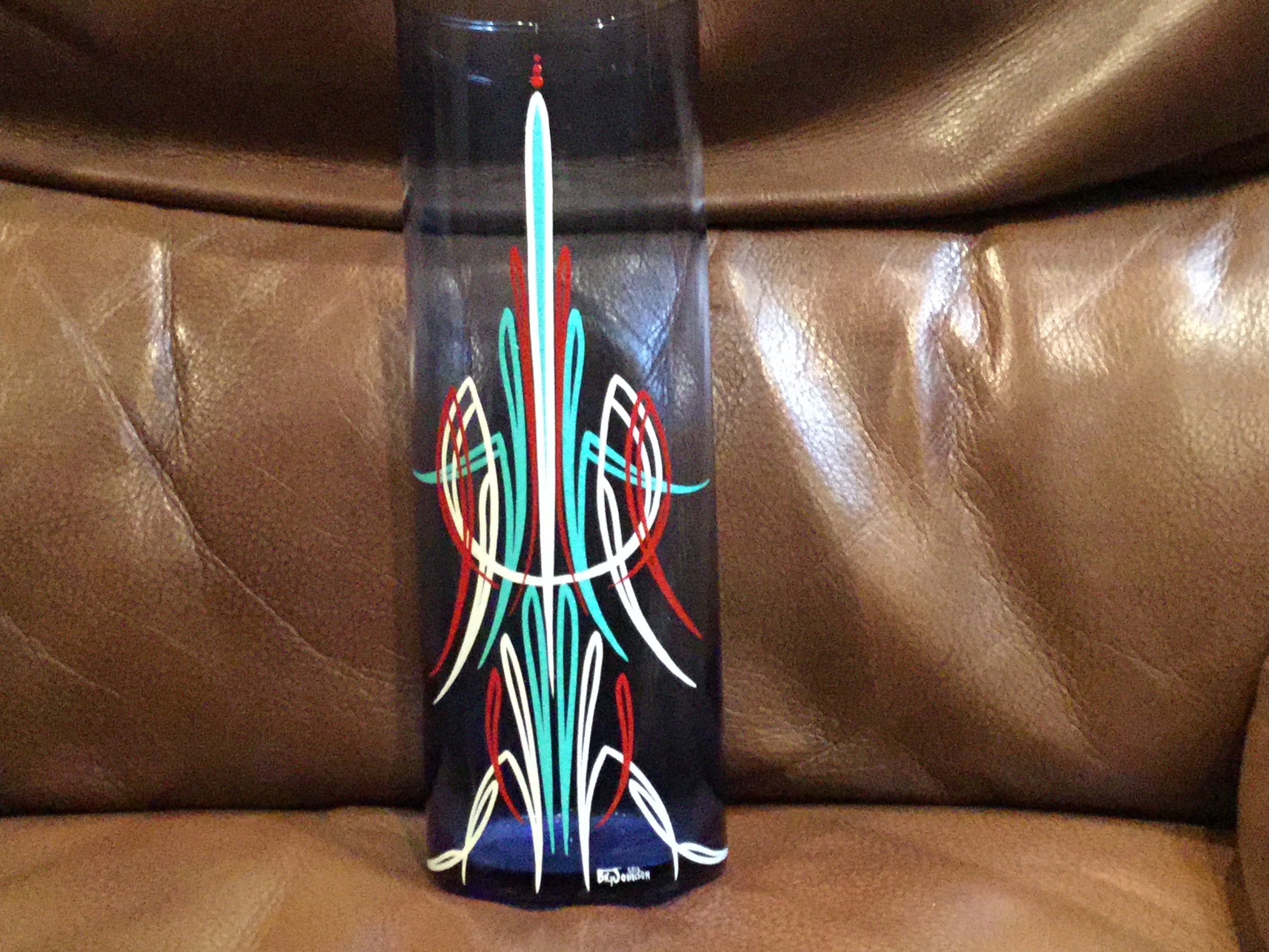

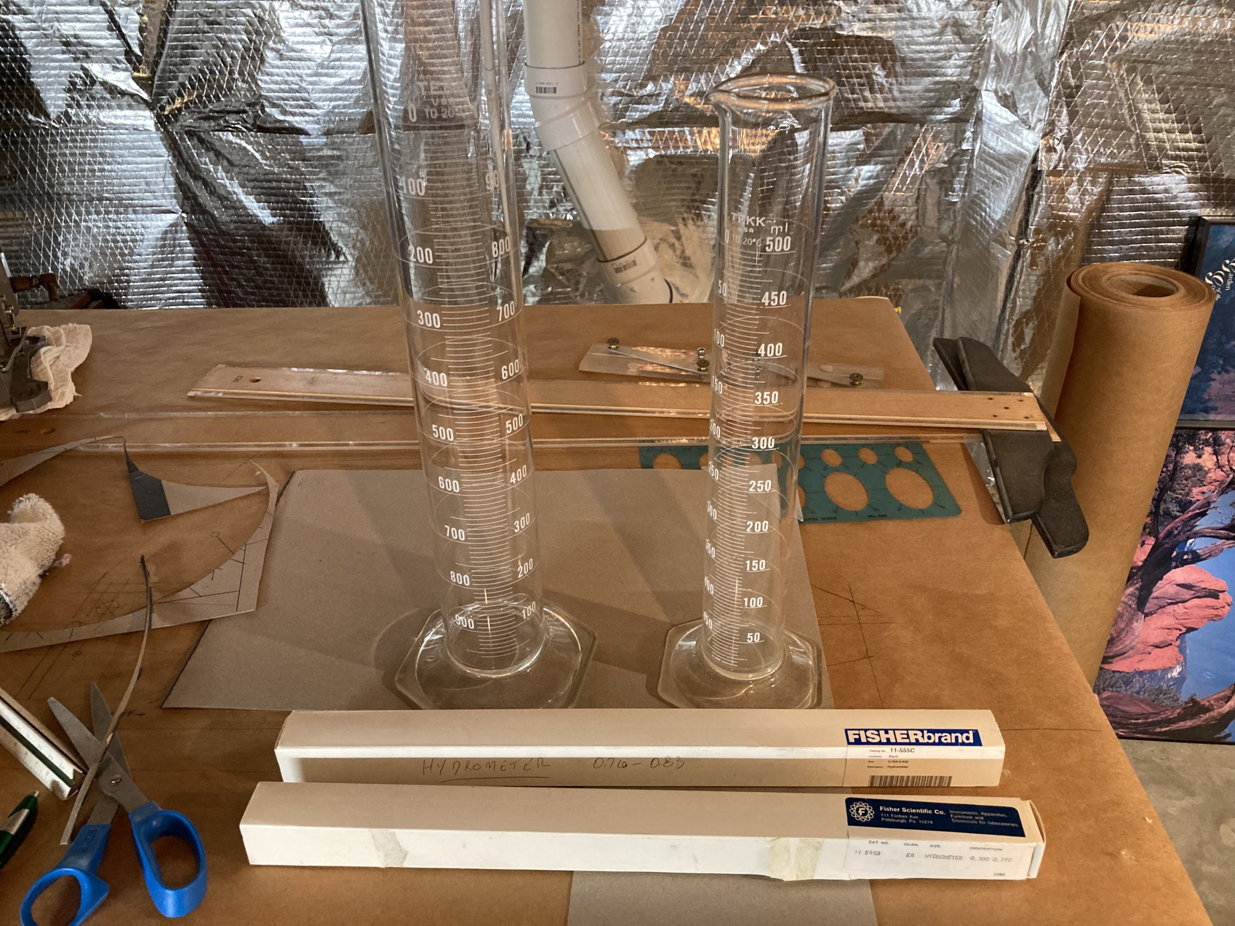

    Quite right. To check the percentage of ethanol in a fuel blend, we used these, graduated cylinders.
    I used them for years in the research lab, and like Dan said, it’s easy to break the azeotrope between gasoline and ethanol by adding water. Once you reach the point where the ethanol has enough water to separate from the gasoline, the 2 will be essentially free of each other. What we did was put 100 ml of fuel in a graduated cylinder and then added 100 ml of water with food coloring in it, to make the separation easier to see. The ethanol from the fuel will mix, breaking the azeotrope, with the colored water, we could see how much of the fuel was gasoline base stock. If it is truly E10 the base stock will be 90 ml, and the ethanol/colored water will be 110 ml. Easy math, we started with 100 ml fuel, and ended up with 90 ml base fuel stock, or 90%.
    This works for E85, but the thing about commercial pump E85 is that it varies seasonally and with the cost of the fuel components. So if you are racing with pump E85, it is important to make this measurement so you can tune for the actual percentage of ethanol in the fuel. The typical range is between E50 and E80-ish, in our experience with it. I believe that the slight shortfall is so that the fuel distributors, who splash blend the fuel prior to distribution, have a slight cushion to prevent over blending, as the regulations stipulate 85% maximum ethanol.
    Our research showed that in modern electronically controlled vehicles the need for ethanol goes away. The original intention was to lean the air/fuel ratio in fixed jet carburetor equipped vehicles. The controls react so rapidly that within 30 seconds, give or take a few, the a/f is back to stoichiometry. The small engine manufacturers have struggled with this for years now, as we all have experienced. But that is a discussion for another day.
    Interestingly if the balance of water in the fuel is below the point where it breaks the azeotrope, but above about 2 %, it will not cause the corrosion we all hate, and will help the aluminum to p***ivate, regenerating the aluminum oxide layer. But the problem is that just likes to absorb water from the air, so don’t count on that to preserve our carburetors…
    Probably more information than anyone wants on this topic, but I lived in this arena for 30 years of my career. Feel free to ask questions, harangue me for doing it, and hopefully it’ll help me get over the bad memories…
