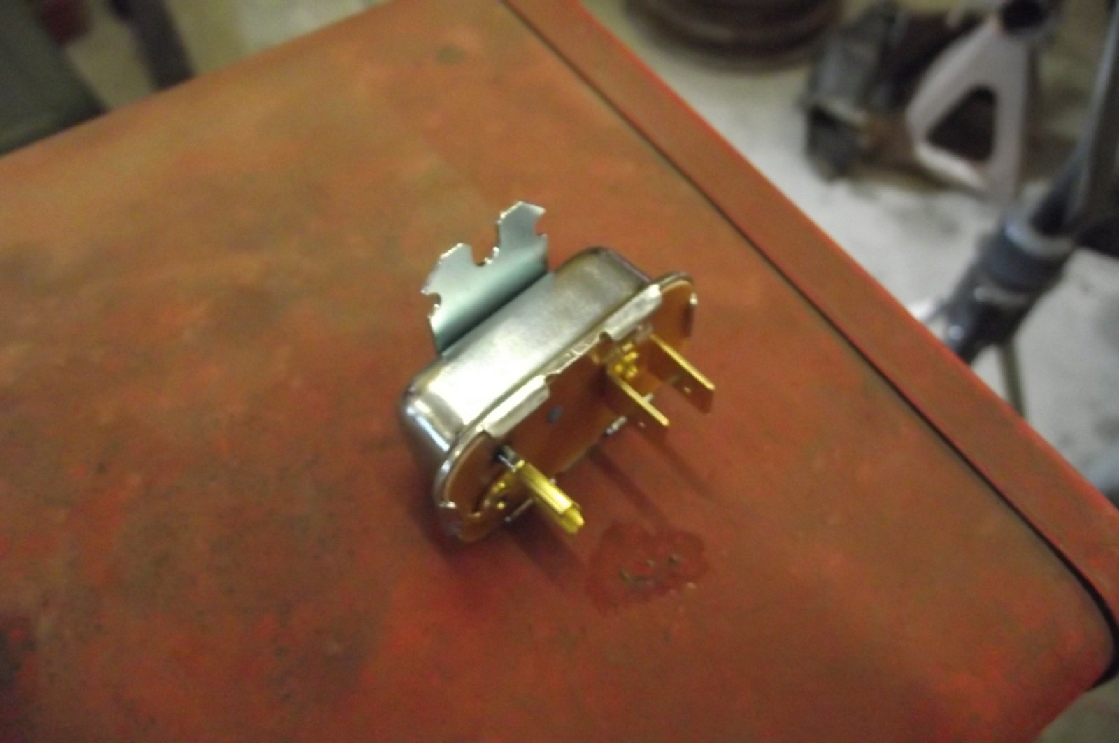

  11. Mike Miller
    Joined: Oct 13, 2008
    Posts: 4,560
    Mike Miller
    When doing a 12 v conversion on a car with a 6v gage and sender I use a small voltage regulator from a late 50s to mid 60s ford, Mopar in those years also used them. It,s a small rectangle on the back of the instrument panel that feeds 6 to9 volts to the gages and works by a bi-metal spring with contact points that open and close to regulate the voltage. DSCF4445.JPG

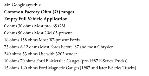

  16. BJR
    Joined: Mar 11, 2005
    Posts: 11,416
    BJR
    If the gauge will not read correctly when you test it out of the tank, it probably has the wrong ohm range for the sender that doesn't match the gauge. See chart below. First number is empty, second number is full reading.

  17. chopolds
    Joined: Oct 22, 2001
    Posts: 6,334
    chopolds
    from howell, nj
    ^^^^^^^ This. Most aftermarket gas gauge senders are made for the GM Ohms range. Unless specifically ordered for another range.
