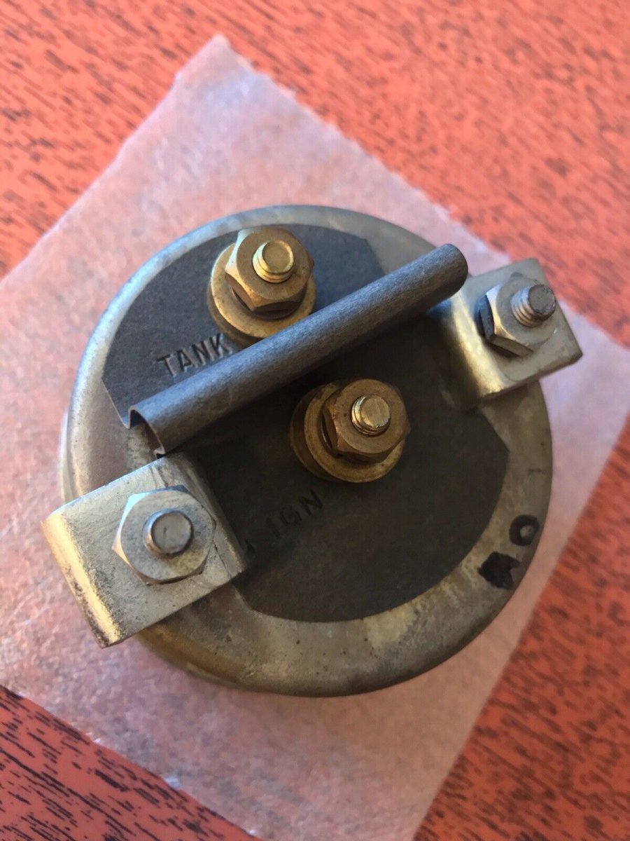

    O n the original fuel guage for a 56 ford truck there are two connections on the back which one is ignition and which one is battery? thanks for your help

    I guess my question wasn't right. I need to know which stud is battery and which stud is sending unit.

  10. Ghost, here is a couple of pics of Stewart Warner Gauges, early and later styles with stampings of wire connections...

    Next time start a new thread instead of adding on to an unrelated 16 year old thread. Looking at the back of the gauge the sender is the outer terminal.
