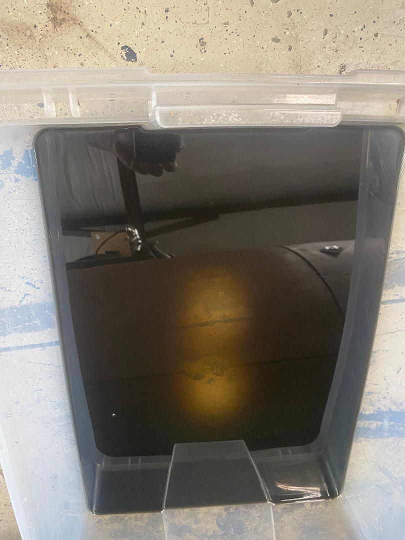

    hey ya'll, working on my 51 vicky with a 1950 truck 8BA and i think i may have a serious problem but i'm kinda new at this and looking for some help.
    i just finished putting the car together and getting it running with an engine that was said to be "new". i have no other history other then to say it looked new, turned over and was complete. also to note was that when i was prepping it to install it, i noticed it was set on TDC, with the marks, rotor and valves all seeming to be in the correct place which i took to indicated the engine was ***embled by someone who knew what they were doing.
    ok so, i started it last week, got the timing set and drove it around the block, maybe 3 miles. it was running for apx 30 mins total. when i pulled the dipstick, the oil seemed thin and was black. i also noticed that it smelled of gas.
    i did some checking on the hamb and someone had posted that it could be the fuel pump so i pulled it and sure enough the diaphragm was old and dry so i rebuilt it. i refilled it with oil, did a compression test and all cylinders were 100 dry, 120 wet give or take a pound or 2.
    so i started the car, drove it about 6 miles, brought it home, dropped the new oil and same thing, thin, black and has a gas smell.
    i ran the old oil thru a paint filter and got a power fine substance that was a very small amount and did not seem to stick to a magnet but the powder was oil soaked so maybe it would stick if it was dry.
    oil pressure has been 20+ when cranking, 40+ when driving increasing with RPM. no smoke at all and no black soot or oil blow by around the pipes. the carb is a single stock ford 94 which i rebuilt. i have the air fuel screws out a turn and a half. i attached a pic of the oil and the plugs which not all but a few smelled of gas.
    so i would appreciate any input, suggestions, or info on what to do next.

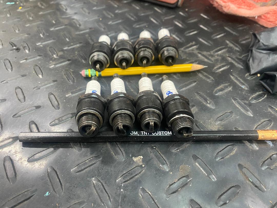

    Plugs look pretty dark to me. Would indicate the motor is running rich. A bad power valve will cause that. With a flathead, I would also verify the fuel pump pressure. 2-3 lbs is about all those old carbs can handle, more pressure they will leak the fuel into the motor after its shut off.
