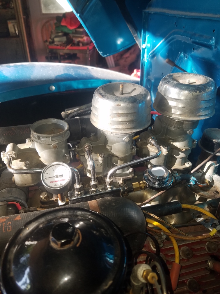

  14. 2.5 pounds max, any more and you wind up with gasoline diluted oil. Charlies speed makes a clean stainless system with a 0 to 10 pound gauge and regulator. also has excellent how to video's
    51 mercules and gimpyshotrods like this.
