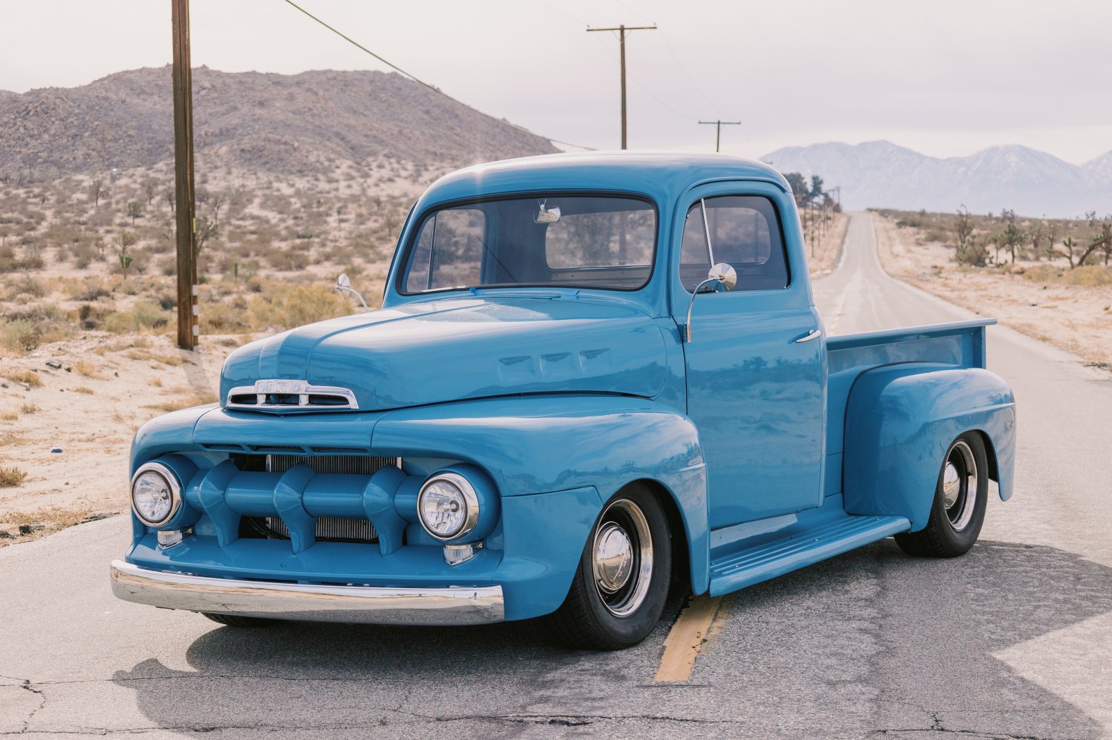

    D41FF790-6D2B-42C4-BE1C-00A139558839.jpeg Hi to all, I have a 52 Ford f1 with a new gas sending unit that malfunctions when its tight enough to stop fumes from escaping, basically if I loosen the screws a bit then I start getting gas fumes in my cab, the issue is that when its tight enough then my sending unit gives me full tank or starts malfunctioning, I loosen the bolts a bit an it goes back to normal. Have any of you ran into this? I have good ground to the sending unit, the tank is bolted to the cab so its also grounded, so what causes something like this? Thank you all in advance.

    Sounds like you might have it handled.......just wanted to say that is a beautiful truck! I also have a '52 F-1, of a similar shade of blue.

    Thanks man, yeah Im loving the color, its not a perfect body, its really a driver

    That truck IS the cat's ***! Makes me want to change MY F-1's '50 front sheet metal back to the '52!
    Hope you find that bug...
