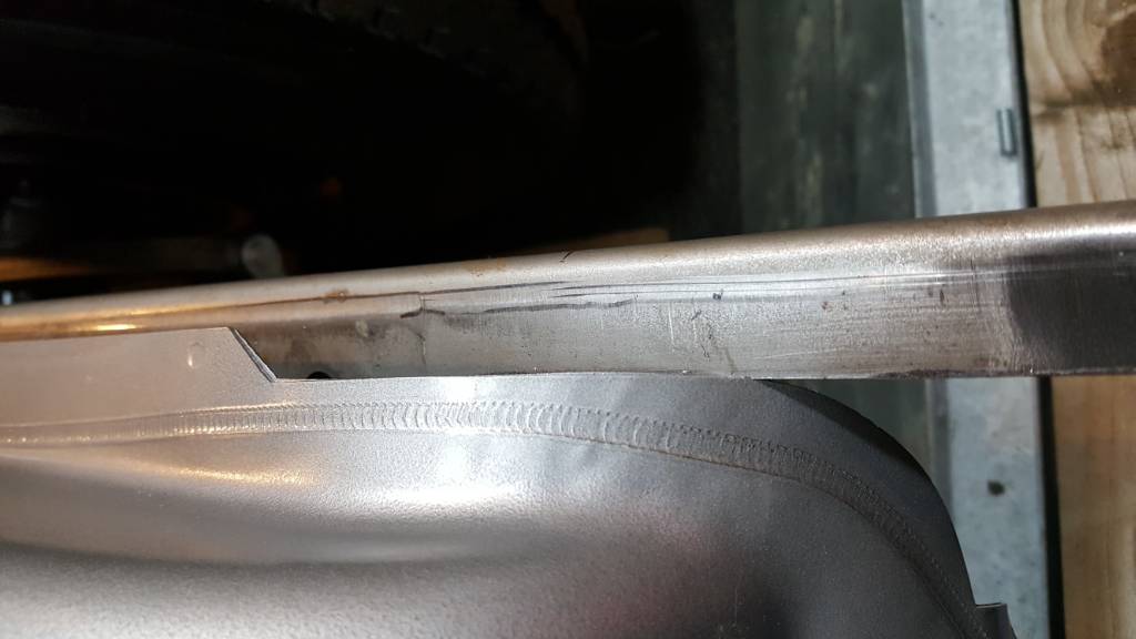

    I just received my tank for the '32 I'm building.
    Now this my be a dumb question but, the flanges on the tank need to be trimmed down a bit.

    you can grind-cut up to that pinchweld seam.ive done it

    If you don't grind the tank you'll have to grind the frame. Otherwise it won't fit. Did the same 20 yrs. ago to get it to fit.

  4. Go for it. Have used a half dozen or so and always had to fit them to the frame somewhere.

    Is your frame the right width?

    Check the frame for correct width at the end of the horns before you cut anything.
    Welding on the frame, esp. boxing, can pull the frame ends in from shrinkage, sometimes as much as 1/2". Solution is to pump them out to correct width with a porta-power or similar.

    Ok guys shaved down the tank flanges and 1/8" from the welds and took a 1/"16" off each frame horn. The does go in witha bit of a push. I think I'm good!

    i wouldn't be afraid to grind a little off. i have also bent the flanges up,down, or in on other tanks to get them to fit.
