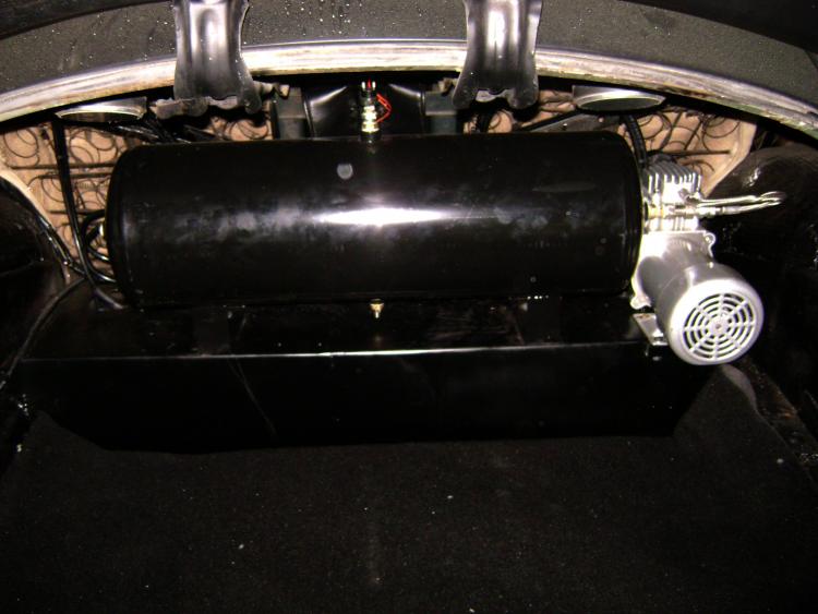

    My ass puckers everytime my air compressor kick on. No I haven't had any problems with fumes yet. Someone told me to put in a bilge vent pump. Ventless cap with a good gasket.

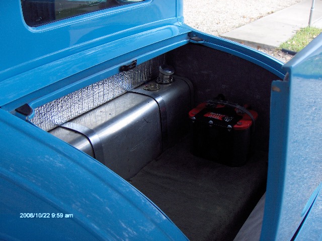

  15. I run a "Tanks" steel tank in the trunk It has an o-ring sealed cap to neck to stop common sloshes, a roll over valve and vented by a hose outside the trunk, I have never even smelled gas in the trunk, seems safe ,The battery is held down with a heavy duty battery bracket with no terminated battery ends in the trunk,something could always happen , but it won't because I didn't try to do it right.,Sam
