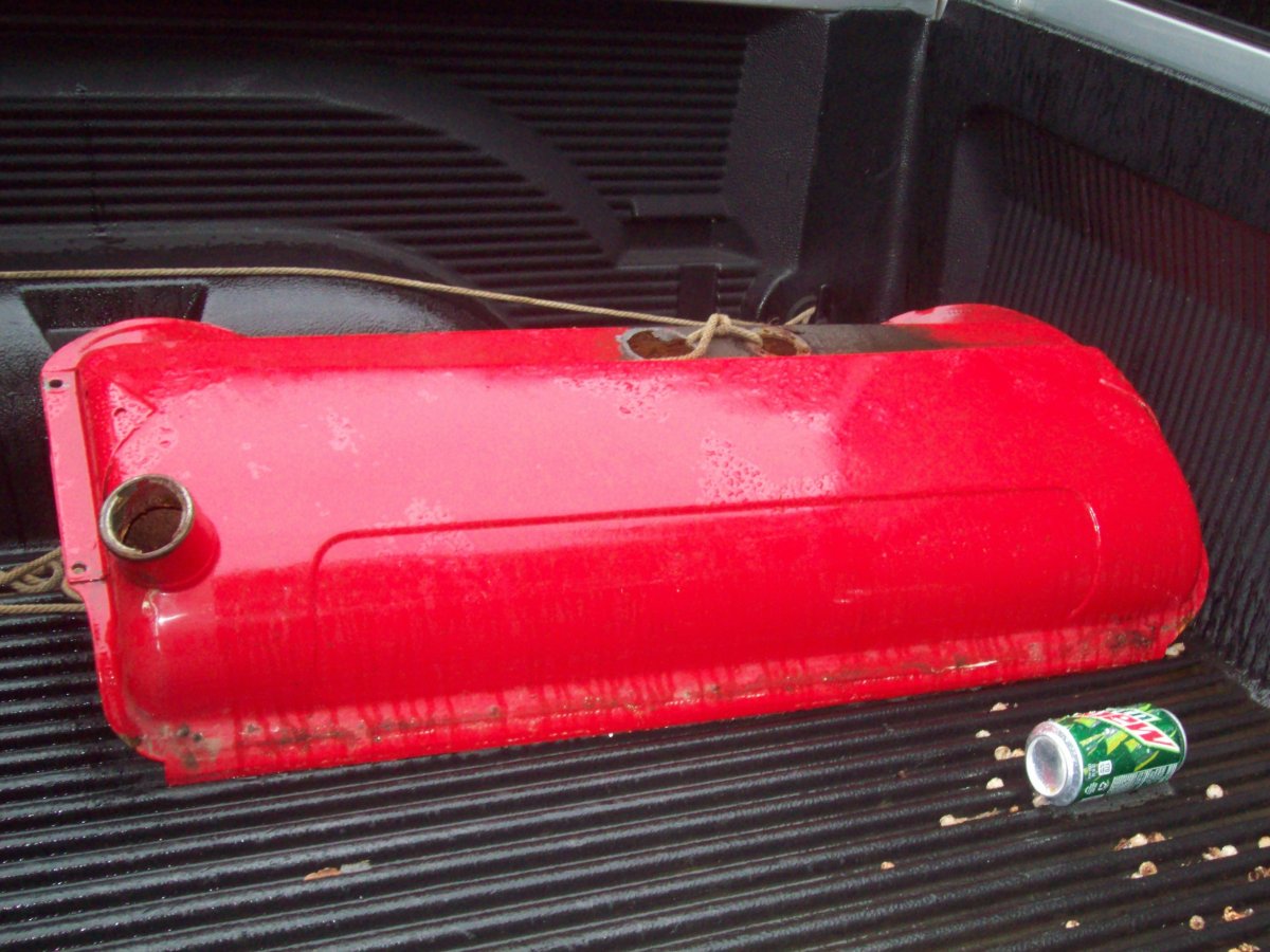

  3. HOTRODPRIMER
    Joined: Jan 3, 2003
    Posts: 64,794
    HOTRODPRIMER
    The sedan is running like a top with the jug of gas,I don't think I'm going to have to rebuild the carburetor.
    I pulled the sending unit from the tank and it's so gunked up the float is frozen,so I need a new VDO sending unit. HRP

  19. HOTRODPRIMER
    Joined: Jan 3, 2003
    Posts: 64,794
    HOTRODPRIMER
    Too late,it's already out. HRP
    It's fugly inside. HRP
  20. pat59
    Joined: Sep 21, 2012
    Posts: 2,361
    pat59
    Yup that's fugly! :)
