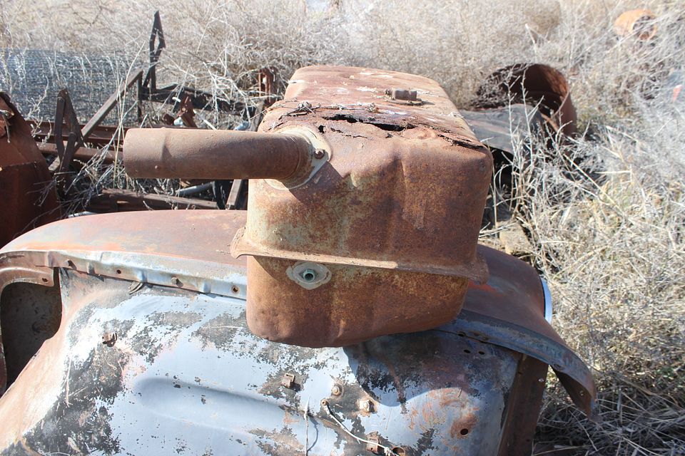

    I have a 48 Chevy truck with the stock tank under the bed, the filler tube comes through the box and angles upward. My question is I am thinking of putting a flush mount fuel filler on the boxside and it is non-vented so I will vent the tank and use a roll over vent in the top of the tank. I am not worried about gas sloshing out with a full tank but am concerned about filling and then having it slosh out. The fill tube on the tank doesn't have much of an angle to it. What's your thoughts?

    In three words IT WILL NOT WORK. It's enough of a pain in the **** to fill it with a stock filler neck with the high pressure pumps let along **** it up to where you can't fill it at all.
    There isn't a pump made that has a nozzle long enough to reach far enough back in that filler neck to get to the bend to run fuel into the tank rather than on the ground. You really don't have any measurable drop from the bedside to the bend where it goes into the tank. This being my old tank that I had sitting out back upside down and a mouse decided that it would make a great home.
    You still have about three inches from the end of the filler neck to the bedside.
