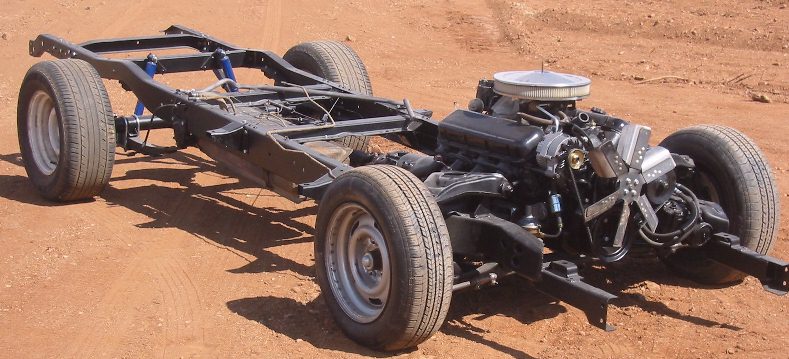

    That's not where the tank is on the suburbans....this is a 57 suburban ch***is, with the stock tank (and a Camaro front clip)
    maybe you could make something else fit?

    No where near ready, but thinking through my AD truck build I plan to hang the original tank similar to what Squirrel has posted above. Yes I have to mod it some but that's the fun, isn't it?
