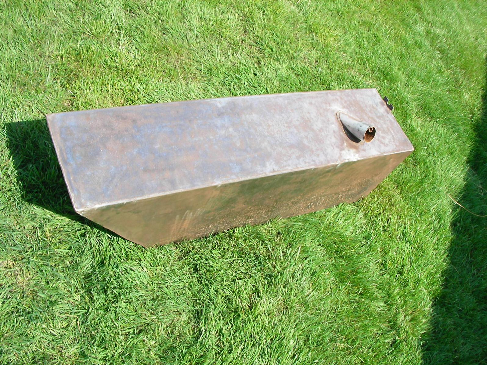

    I have a set of Bed Tanks in my truck and I want to add fuel gauge sending units. Using GM 0-90 guage, looking for a bolt-in sending unit with a pickup, that's the hard part. Tank is 12" deep. Any ideas what stock GM (or maybe Jeep?) has such a unit?

    Now this is going to get real technical. Drill a 3/8" hole in the sender, insert a 3/8" tube that reaches to bottom of the tank, solder it in place. Now you have a sender with a pickup tube.

    Why not get a factory style sock and mount it to your newly engineered pickup tube/gauge sender unit? I think you can buy them from the dealers or auto parts stores.

    Get an oem replacement strainer out of a mid 70s GM product. I have yet to see one with anything other than 3/8" pickup on the sock. When you solder/braze in the pickup tube, use 3/8 fuel line and the sock will push on like stock.
    Regarding filters before pumps, you should be OK with any screen filter. Paper mesh filters are the ones to avoid. I used to use those gl*** & chrome plastic screen filters but finally became leery of gl*** cases and now use AN-fitting style cannister filters with round disc screens. They also make em with push hose ends. A little spendy but the last filter you'll buy since the metal screens are cleanable.
